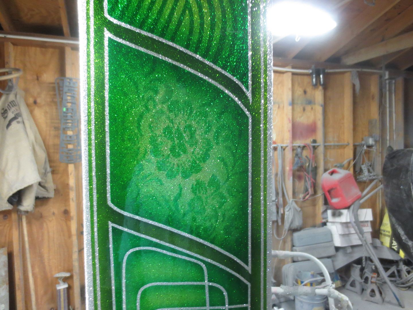

    I've always wanted to try my hand at patterns, so I figure I should give it a go.
    I've done lace before, and sprayed flake but never done anything more.
    So, I laid down a silver basecoat with silver flake, and silver holo flake and got to work.
    First a couple lace panels in the centre.
    Then there will be 3 panels down each side of the roof, each with a different pattern.
    So far I have Fish Scales, and an Endless line done.
    Once the patterns are done, it will be getting Turquoise candy over it.

    That will look great when finished..
    When you spray the fish scales do you just spray in a straight line across the pattern or do you have to arc across each scale individually ?
    Never done them before and looking for some tips:D

    I arc each scale across. I have seen them done straight across, and I tried it that way first on a piece of paper, and it didn't look right. Following the arc looks best IMO.
    I'm all done now. Turquoise candy down, and I added some blue flake it the top coat of clear just for a little extra kick.
    It may not be perfect, but it's my first time doing something like this, and I couldn't be happier with how it turned out.

    as you should be!! This is outstanding work!!
    if anything you may wanna consider for the next one, is the fish scales should go the other way....with the flow of the car, and not upstream.
    but, (as I do this for a living...)...that's seriously nothing anyone else would ever even notice.
    Great job young man!!! :cool: Keep 'em coming!!

    I did think of that, but from the few pictures I looked at, they were done both ways, so I just did it this way.
    Thank you everyone.
    I should have the visor re-assembled and bolted back up this afternoon.
