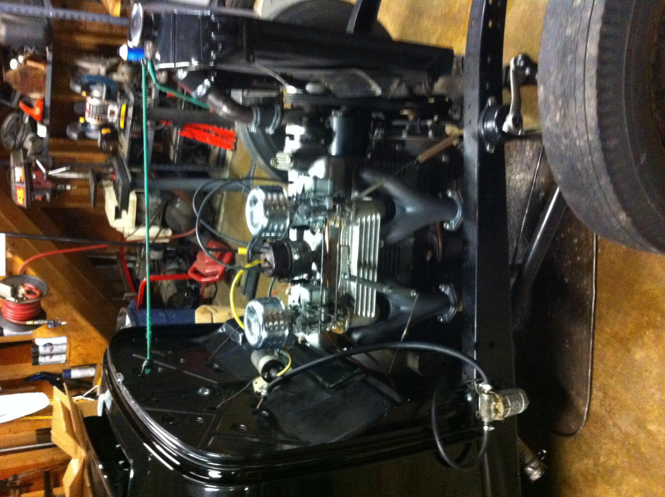

    Cool!! a Light weight car like that should move pretty good with a fast 4 dodge in it. My uncle just built a speedster with hopped up fast 4. I'll try and get some pics.
    I just picked up a 24-25 T roadster that I will be building for the ROG as well. Hopped up B motor and gonna try and run these "new" carbs I just got...

  12. T__N__A
    Joined: May 31, 2006
    Posts: 368
    T__N__A
    Thanks! Ya these were the ones on ebay. I have never seen anyone running them. Hopefully I can get them to run decent!! It's going to be interesting, the throttle bore on these are 2".

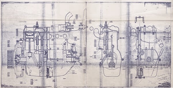

  18. Timberbeast
    Joined: Jun 28, 2009
    Posts: 74
    Timberbeast
    Hope these help
  19. aonemarine
    Joined: Nov 2, 2013
    Posts: 500
    aonemarine
    from Delaware
    What is S O S S?? im new to the model A world
    What I need is a dimension drawing showing the placement of the mains, deck height, cylinder location as well as cam and valve location.
    Yea I know I could take one apart and measure it all up, but dont have one to do that with ATM. I appreciate your help on this.
