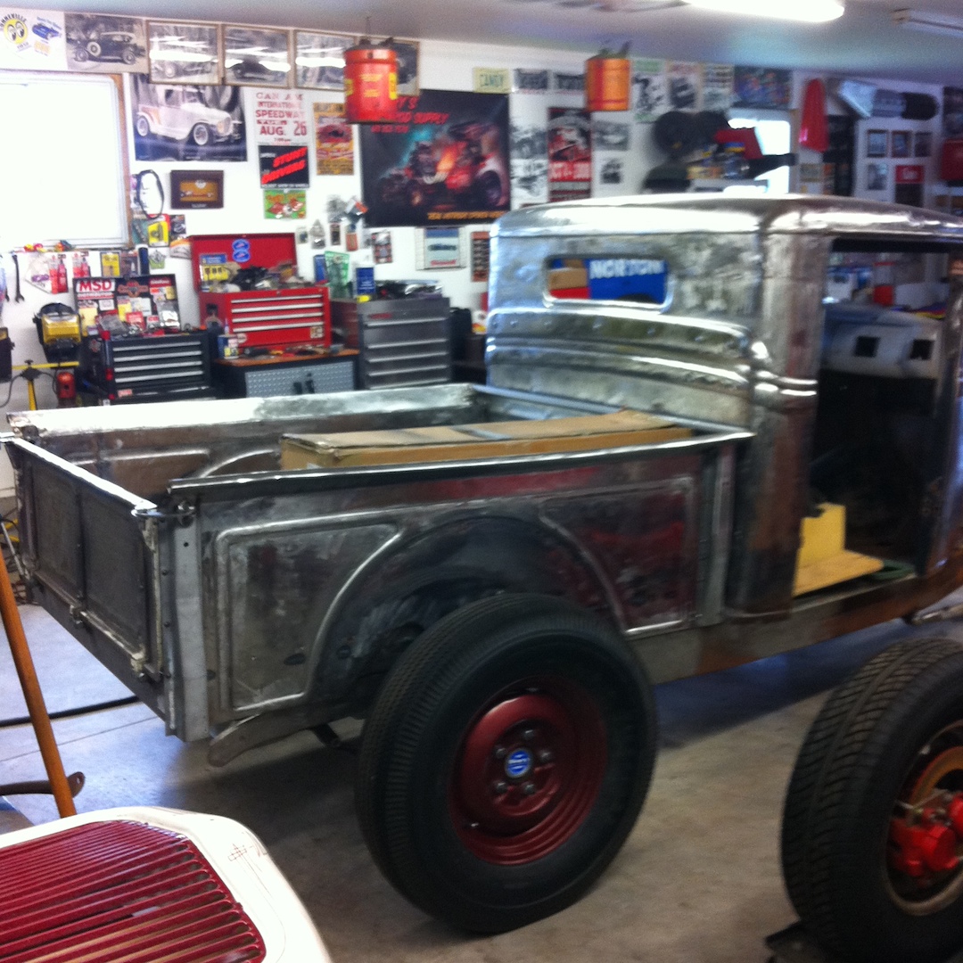

    Way behind my intended schedule for this heap, but there were more pressing events that took higher priority. Back to work now though.

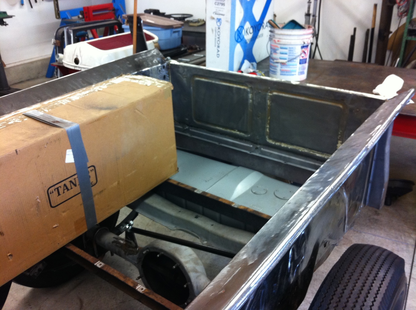

    As alluded to above, I decided to take the bed apart so that it could get fixed properly. It fought me the whole way. It seems that in the past, the front of the floor, bed sides where the stake pockets are, and front panel rusted through.
    The previous owner welded in a big piece of sheet metal. However, he managed to weld it to the floor, the bed sides, the front panel; as well as welding the bed sides to the substructure. It took way longer than it should have to delicately cut everything apart.
    But now that it's apart, I've been stripping off 70 years worth of paint, as well as a liberal helping of bondo. I almost have everything to bare metal, then I'll turn my attention to the cab itself.
    I also got around to stripping the second door down to bare metal. It seems that I've really lucked out. Usually 32-34 doors are pretty rotted and require major reconstructive surgery. Out of both doors, this is the worst that has to be repaired. A little rot right at the bottom centre of the bead. Helps to counter balance the bed a little bit.

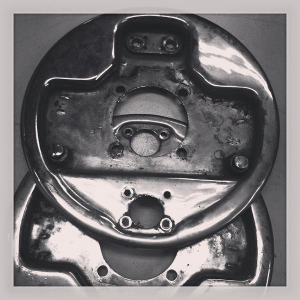

    I also came across an ad on Kijiji for a set of chromed backing plates with hubs and drums. The price was too good to pass up. The backing plates are 'driver chrome' and are a good candidate for painted centres due to some flaking chrome.
    There has been some concern that I am turning into a Gold Chain'er with shiny parts on my hotrod. No worries. These will be swap meet fodder.

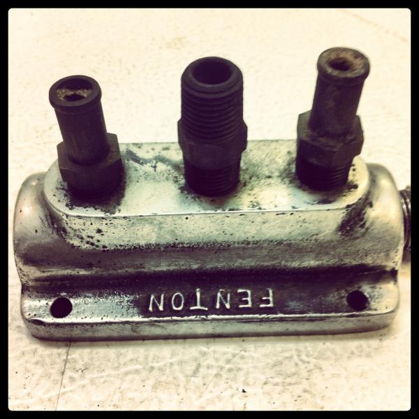

    I have Fenton Valve Covers and a Fenton Starter Changeover for the Olds. I've been searching for a Fenton fuel log for a while now. One recently popped up, and while it was a touch more than I wanted to pay, it was worth ending the hunt. Another piece of the Fenton Olds puzzle.

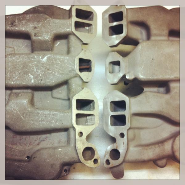

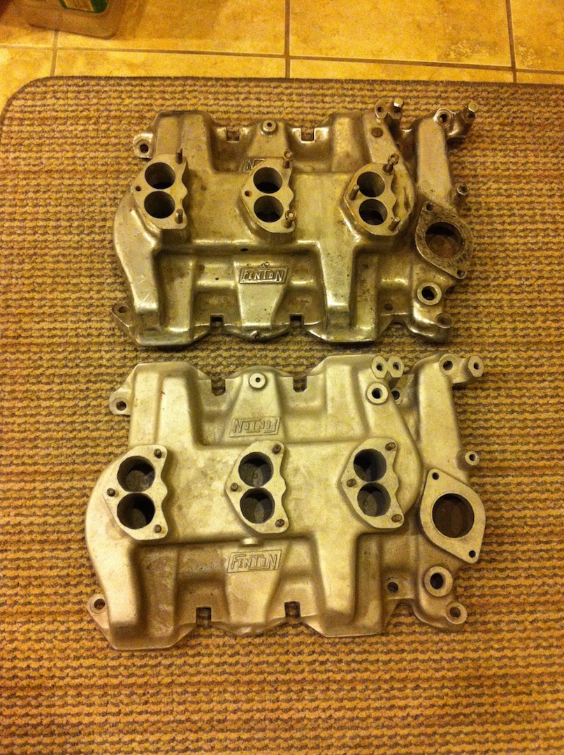

    And here's the thing I'm most excited about... I know that Fenton made a 2x2 intake for the Olds motor. I'd entertained picking one up, but they have the Rochester 4 bolt carb pattern, and I wanted to run Holley 94 carbs. I also didn't want to run bolt pattern adapters. I knew that Fenton made a 3x2 intake for a Y block with the Holley/Stromberg pattern, but I had never seen or heard of one for an Olds. Long story short, I'd fantasized of finding a Fenton intake, but had come to terms with running the Edelbrock.

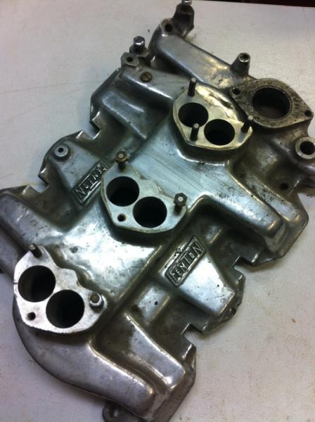

    Recently something popped up on eBay that caught my eye. I took a gamble based on a one line description and some blurry pictures, but came out a winner...
    I now have a Fenton 3x2 intake for the Olds!!! It has been polished at some point, but looks very clean and solid. The Edelbrock is going on the wall; I'm going to clean up this Fenton intake and run it with its old polish.
    Apparently the Fenton 3x2 for Olds is just a Sharpe intake with the Fenton name cast instead. I'm very excited. It also looks like that it has larger castings so that I can open it up and match the ports to the heads. Fenton is on the left...

  5. Thanks David! I'm very happy with it. Would have rather'd it unpolished, but beggars can't be choosers. :)
    Can it. I don't want to have to keep that shit shiny.

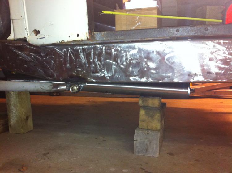

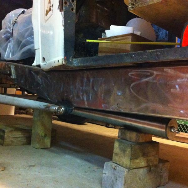

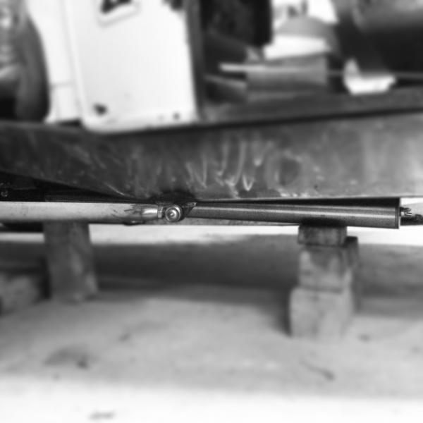

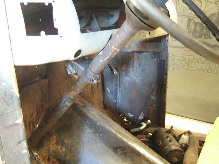

    Matt from GearDrive sent me some of his torque tube driveshafts a while back. I had a rough idea of how I wanted them, but decided to get around to mocking them up. Raining, so why not?
    When they're in, the will follow the same vertical angle as the wishbones. Other than adding a driver, the full weight of the truck is resting on the suspension already.
    If I were to pull the cab off, you would see that the tubes also shadow the contours of the frame, narrower under the manifolds of the engine, and wider as the frame widens for the cab.
    They end at the mid-point of the doors, and will have down tubes that connect to a full length exhaust.
    Thankfully, the transmission crossmember is 'humped' to clear the exhaust on a stock Oldsmobile. These same humps are the perfect size for the torque tubes and allow me to tuck them a little higher up under the frame.
    And just to see how they'd look from a distance... I'm about 10 feet back from the cab, and am crouching down for this picture. They'll just be visible aft of the wishbones, and below the frame. Exactly how I wanted them. Still easy to reach the caps though, for those times I want to run it uncorked.
    And lastly, a little plug for Matt (SaltFlatMatt) and GearDrive here on the H.A.M.B. He's a solid dude, and makes a quality product. I know I don't have a good picture of them, but these torque tubes are a thing of beauty. And the machined caps look awesome. I'm really, really happy with them.
    If you need exhaust, talk to Matt.

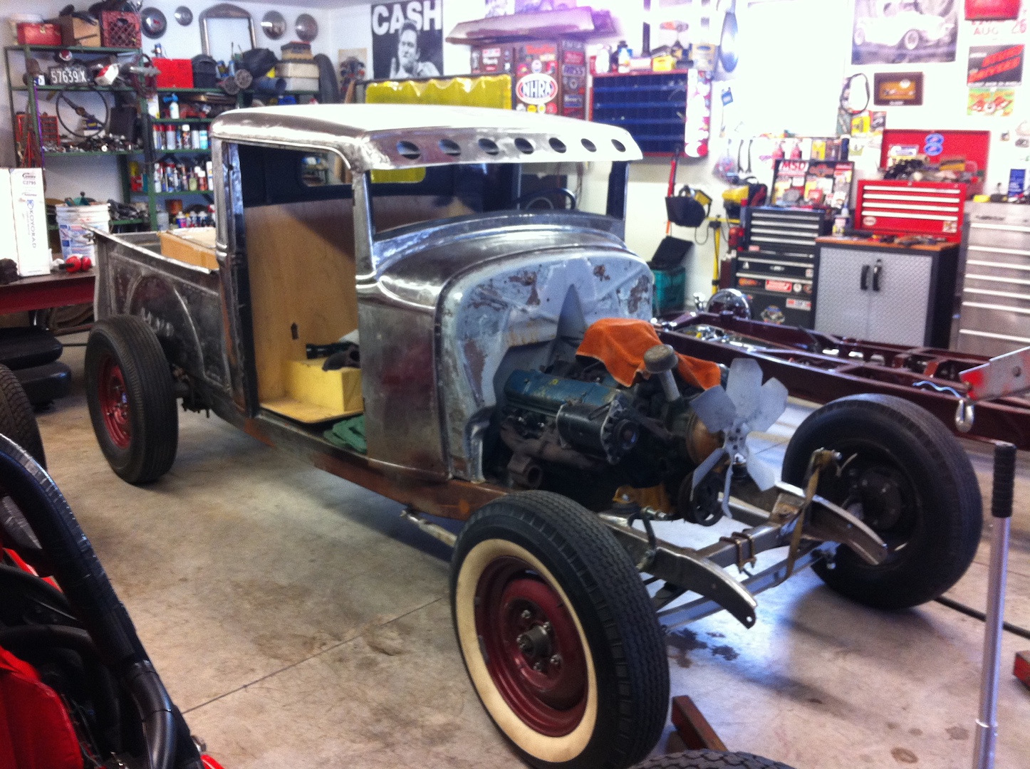

  8. Lots of life has been happening in the past few months. I was aiming to have the cab stripped down in August. Obviously that didn't happen.
    My parents are boaters. They have hundreds of hours of experience with cleaning up and refurbishing the teak used in railings, floors, and many other applications on boats. That process usually involves stripping off the old varnish, sanding, staining, and revarnishing. Anyways, I co-opted them into giving me a hand on the truck. I promised that I only needed them the first part - stripping off the old.

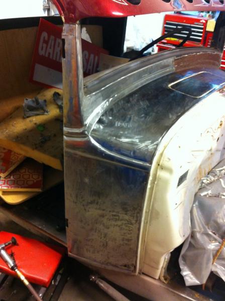

    We hit the cab hard on Saturday and Sunday. 70+ years worth of paint is off the entire cab (except for the passenger half of the firewall), and only the brown primer under the original black lacquer remains on about half the cab.
    The metal is turning out to be in surprisingly good condition, considering this is a truck.

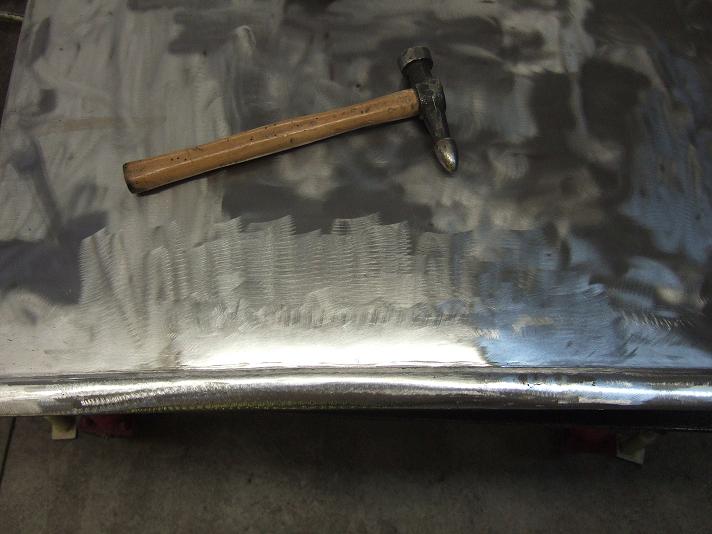

    The chop will need to be cleaned up, as it was poorly cut, and poorly welded.
    A few small dents in the cab, though nothing bigger than a quarter. There are two areas of rust through, both on the cowl, just above the rockers. You can see the hole on the drivers side in this picture here… right behind the firewall. The passenger side is a match.
    After we got down to the brown primer, I got out the compressor, some surface prep discs and took things down to bare metal. Got about half of the cab done last night, should have it all finished Saturday of next week. We'll strip the roof next Saturday as well.

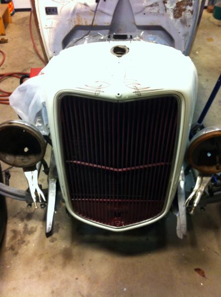

    I also added a second headlight. Obviously they aren't permanent yet, and one is a little cockeyed, but it's an approximation of the finished product. Excuse the cropping of the picture, I couldn't back up any further in the garage for a better picture.

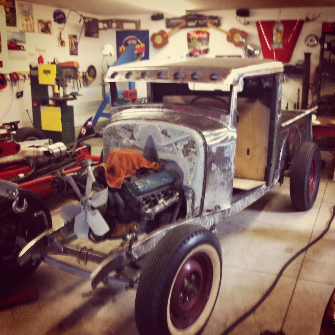

  16. More progress this weekend. The cab is completely stripped of all paint. The roof got done as well. The entire cab is almost down to bare metal... Just the roof and a section of back need the brown primer sanded off. Unfortunately, I forgot to take pictures.
    I got some practice taking off and putting on tubes and tires. I pulled the rear 6.00-16 Garfield whitewalls off the 40 rims, and put on the 7.00-16 Firestone Deluxe Champions. They're the right size rears that I want to run. Unfortunately, a picture of how the frame sits will have to wait, due to the snow we got this weekend. I wasn't opening the garage door for nothing.
    I also pulled the tires off my spare 40 Ford rims and off of two of the four Wide 5 rims I picked up for the FutureCoupe. Those old tires were so dry and hard, they fought me to the end.
    The cab and bed are just about ready to go to The Candy Factory, and as soon as Neil has space for me, I'll be taking things down for rust, dent and chop repair.

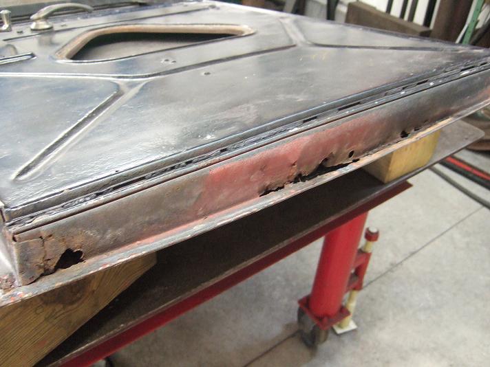

    The doors held up miraculously well. Normally, 32-34 doors are rare as hens teeth, and finding solid ones is even more difficult. Luckily, mine one needed a bit of work.
    As they were...
    Underway...
    And good as new.

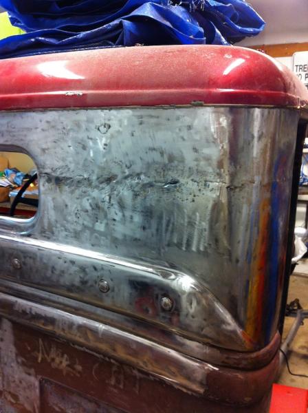

    On the cab itself, the chop desperately needed to be cleaned up. The drivers side cleaned up really well, but the passenger side needed a lot of work. The metal was so brittle and work hardened, that it was necessary to cut out a strip on the passenger side, and replace it with new metal. Untold hours later, the chop has been cleaned up nicely.
    The small area of rust on the cowl also received attention...
    And finally, the dent in visor on the passenger side was erased from this truck's past.

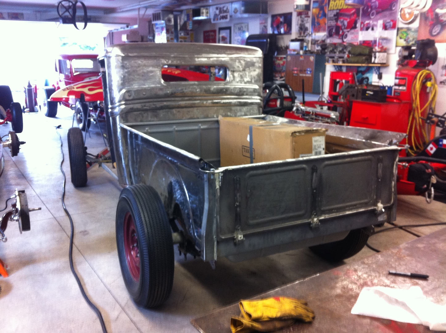

  26. By September, a trip over and see how things were progressing was necessary. Of course, having a chance to catch up with Neil, and picking up my broke ass trailer were also part of the plan.
    With the metal work done and the bed back together, it was really starting to look like a hotrod again. Seeing the truck really lit a fire under my ass to get going and get it done.
    Here is how she looked when I first walked into the shop.
    The Candy Man's been busting ass and doing a hell of a job on the truck. I'm really pleased with how it's coming together. But he needs his shop space, so work continues. Next up was headlights...
