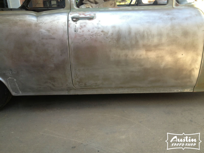

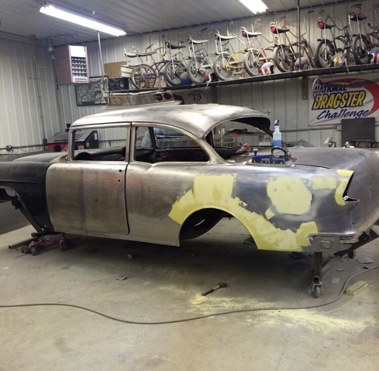

    We started by sanding the body down to bare metal to get a better look at what he had (also because bare metal is cooler than army drab). We uncovered a few small bad patches, repairs and some bondo but all in all he really has a great car. The front fenders seemed to be the worst.. but not an issue since Steven decided on a full fiberglass front end.

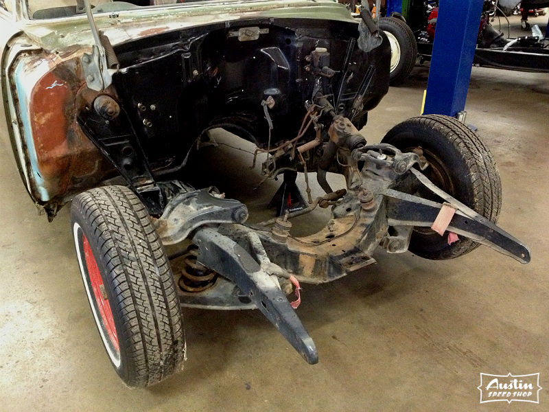

    Now to start slimming her down starting with the heavy independent front suspension. Before we start we used several jackstands and shimmed them leveling the car out. It would have been ideal to put this on a frame bench but it is occupied for a while. Once the car is level and properly supported, I inspected and measured the chassis for damage and squareness. I laid out the axle center lines and also laid out a frame center-line to use for future reference.

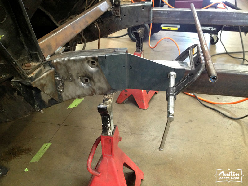

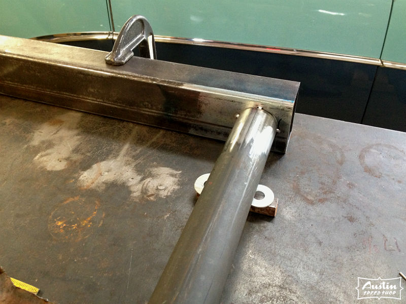

    I braced up the front frame rails then proceeded to cut the front clip off.
    Here we are making the front frame stub. I picked 2x3 square tubing and 2” round. Dont mind the rust flash she came right off.
    I laid it out square on a level fab table and brace it down. I happen to have some left over DD steering shaft that is the perfect height for laying out the round tubing in between. I used a couple washers to chuck the tube up to keep it in place.
    I tacked the front tube in, constantly checking for square. I weld a brace on the back of the frame stub to help insure nothing moves . Then I proceed to weld the tube fully in.

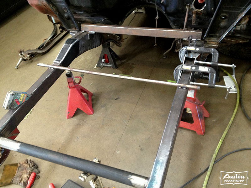

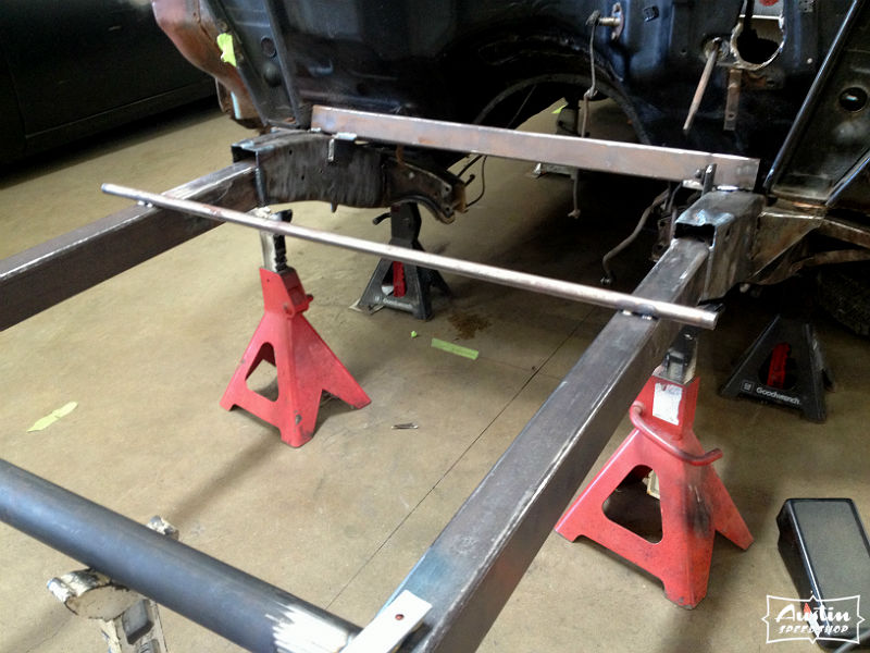

    I then fit the stub into the frame. I purposely left it long so i could slide it in and out till I got the proper length. I left a decent amount inside the frame but wasn’t to much so I didn’t need to cut it down. Plus it allowed me to plug weld it in.
    Once it was square I welded the side, I cut the surrounding frame material and bent it down to meet the stub, I then welded it all around.
    I then made these plates to gusset the frame for extra strength and to clean up the appearance of the transition between the two.

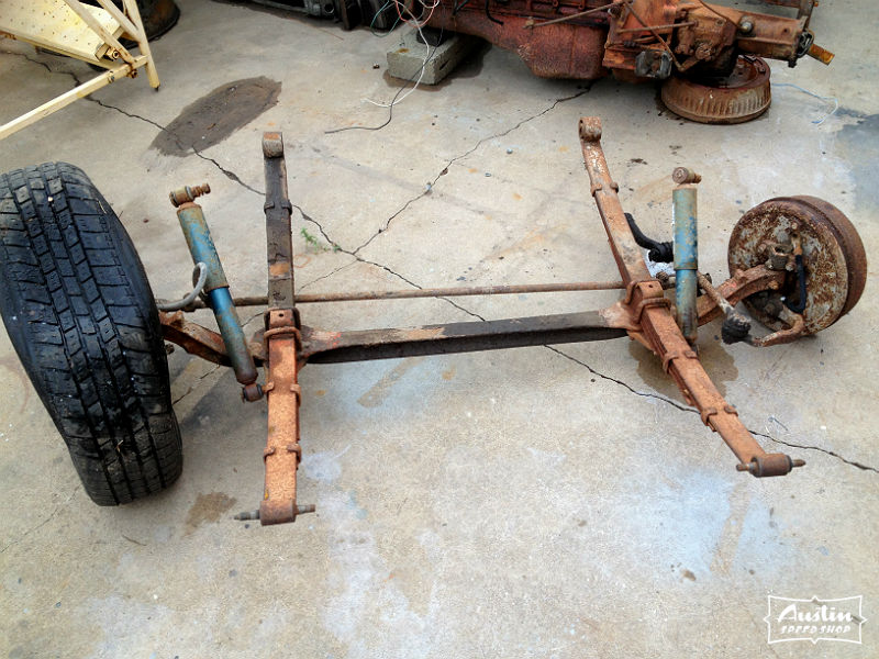

    I think the 1st series looks good with stock sheet metal and not as skinny front tires. The 2nd series seems to look good with the fiberglass front and a skinny front wheel… this is all a matter of opinion. If you are unsure just take the front in place and see how she looks.. You can also run several other axles, econoline, ford truck, early ford, or aftermarket or home made tube.. there are plenty others but you get the idea.. all pose their own issue
    We decided to run the 2nd series because; skinny front wheels and tires, fiberglass front, availability of parts and disc brake brackets that use chevy calipers. The other MAJOR reason is the spring mounts on the axle match up perfectly with the width of the front frame stub, eliminating time for extra brackets and puts the springs in a strong safe place under the rails.
    Using the chevy truck u-bolts and plates I secured 2 model A stock height leaf springs on each side. Add a set of shackles bushings and and a couple brackets (checking for square constantly) we then tack the front end on the frame stub. Things to be aware of are shackle angle and axle caster. We decided to run the front axle a little forward of stock.:D

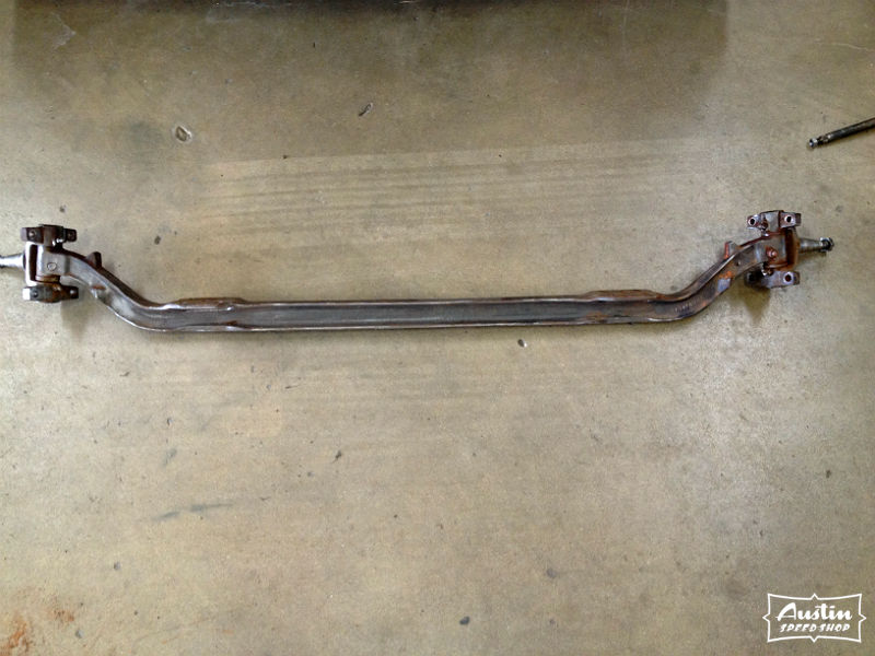

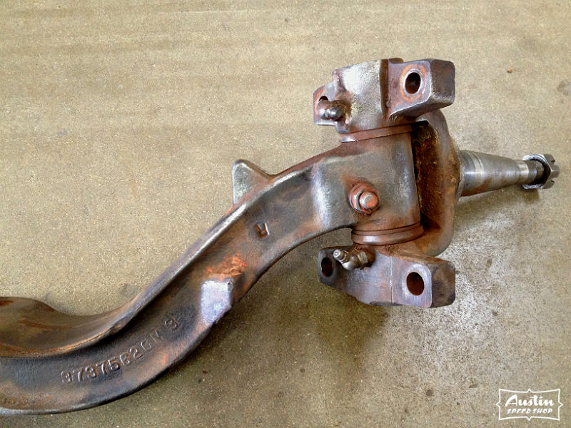

    So for reference on Chevy axles
    I did some rough measurements, I didn't break out the micrometer on this one so I apologize if these are not dead on.
    1st Series
    King pin top center to center 50"
    Spring perch center to center 26.75"
    2nd Series
    King pin top center to center 53 5/8"
    Spring perch center to center 32"
    Also you will notice in the picture that 2nd series has a lump that acts as a steering stop and the 1st series does not.. just in case you are on craigslist or at a swap meet.;)
