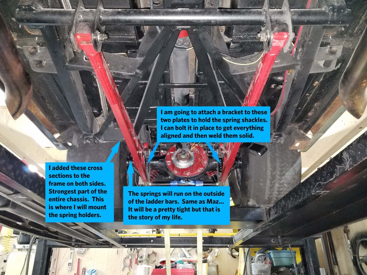

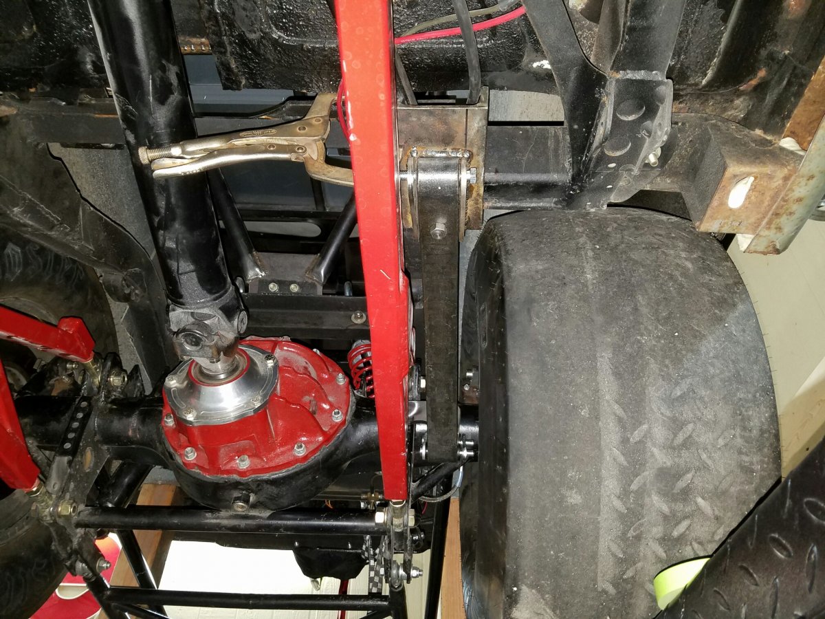

    Lots of work to do today to start converting the Austin's rear suspension to a proven design from the past. I spent a few late hours last night making plans and so it's off to the shop this morning to make it happen. Thanks Ric!
    REFERENCE PHOTO
    THE PLAN
    If it works we will dub it the Panneton - Plant it a ton! :p:p:p

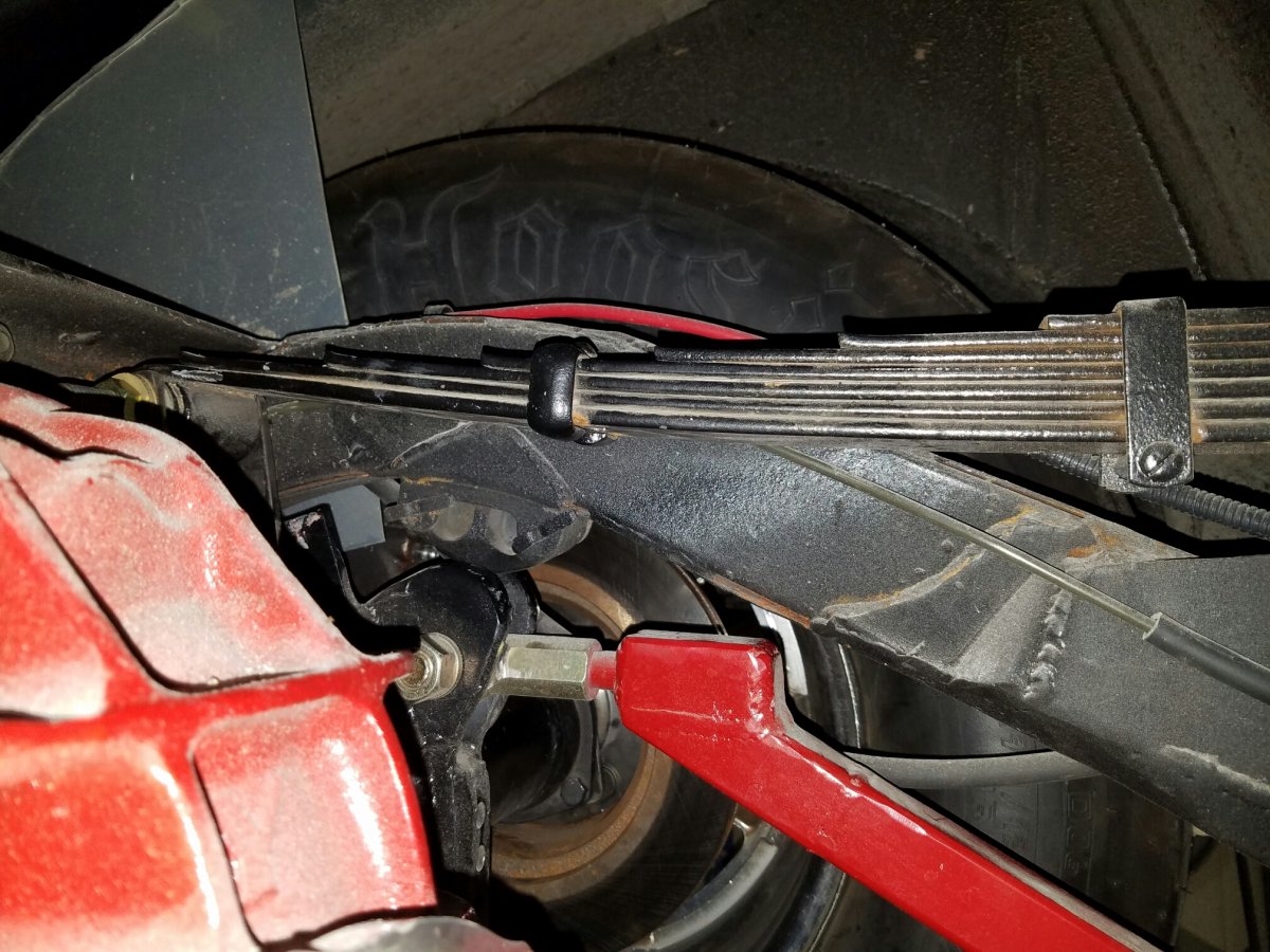

  10. image.jpeg If your out of room in front of the rear end, mount the springs behind the rear end, like this car has.., it runs low/mid 9's with a tunnel rammed 377 & 4 speed!

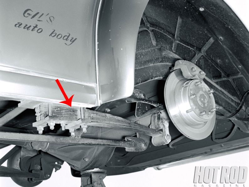

    Do you have room to go under the frame like I did on my 38 Plymouth gasser (top) and the picture of the one I stole the idea from (bottom) that was pictured in an old hot rod article? I ended up grabbing the other halves of the springs out of the scrap iron bin and intigrating them into the pack to stiffen up the springs. Screenshot_20160828-164428.jpg

    Worse back there....shocks, wheelie bars and parachute etc. I think we are good though. I built the front mounting plates today. Chasing Springs tomorrow.
    It looks like Maz's Willy's was sprung pretty heavy. I am not sure what weight I should shoot for out of the box (I know we will have to play with them a bit after we get them on). I have a friend that builds Springs so headed his way in the morning.

    Yes on the "under frame question." We will be right under the corner on the chassis...very strong area.

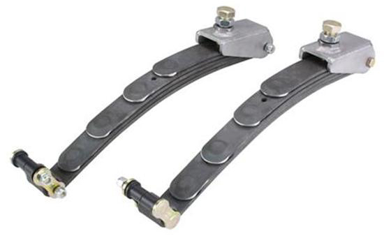

    After talking to my friend at the spring shop, his prognosis on price is not very good. I did some research last night to see what was out there as far as pre-fab quarter elliptic and found a cool set from Posie. After talking to my spring guy this morning he was going to be about twice the price of the Posie kit to build a custom set. So I decided to order the Posie Super Glides and see how it goes. Besides, I really like their mounting bracket which will work perfect with the frame plates I fabricated this weekend and they are nearly the exact length I need.

    The gone postal Willys coupe that was at hamb drags has these springs on it and they work goo

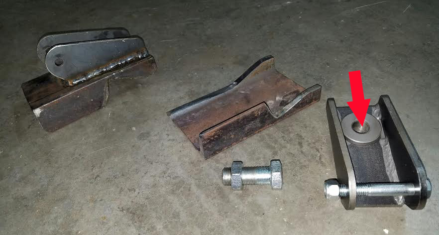

    I also found some really cool shackle mounts when I ordered the spring kits. They are an axle weld on for transverse spring but they are crazy heavy duty and have the shackle perch lined up exactly were I need them. I am going to cut off the rounded axle area and install them on the unused vertical mount system that is already on the axel housing. When we are finished they will stick out perpendicular from behind the ladder bars. :cool:
    I also snagged a cool bent but solid Panhard bar to get up an over the drive shaft and ladder bars plus a 9" Ford mount. I am pretty excited. Everything will be here tomorrow so watch for updates soon on the install.
    mad mikey and loudbang like this.

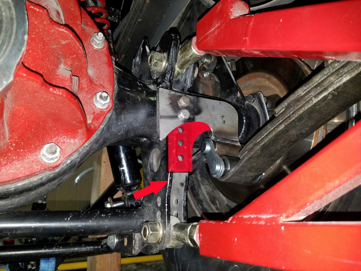

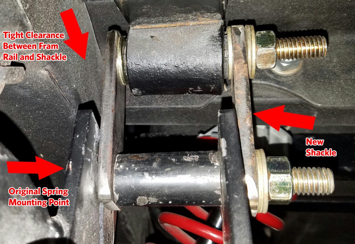

    Well we got the goods yesterday and started mocking it up under the car last night.
    The new brackets are really cool. They come with an adjustment screw but we do not have the room for it under the Austin so we stared by grinding the bung off and making the bracket perfectly flat. Then we put our home made plates in place and took measurements. After feeling comfortable with the placements we marked them and welded the new brackets to the plates.
    With everything clamped in place to check clearances you can see where the new springs are going to live.
    They are going to fit like a glove!
    The only thing left to do before we lock them down is a bit of strengthening/fab work to the shackle mounting bracket. We are going to ad something similar to the red piece above. When we are finished we will be able to bolt this bracket to the rear end and not have to risk warping the housing trying to weld something else to it. This will also put some adjustment opportunity back in this system.
    loudbang and mad mikey like this.

    Just buy looking at the pictures it looks like your welds are a little cold.
    Are you using a 110 volt welder? If so take a torch and do some pre' heat before you weld.
    loudbang and Deuced Up! like this.
  24. Deuced Up!
    Joined: Feb 8, 2008
    Posts: 4,206
    Deuced Up!
    You are amazing James...yes the I am using Dad's Lincoln 125 this week as the gas feed line on my big welder some how sprung a leak. I am going to blast back though those welds again before we do any finish work. You know I almost didn't post those photos for that very reason, but I figure who will even notice! LOL :rolleyes:
    bigmikes50chevy and gonmad like this.
