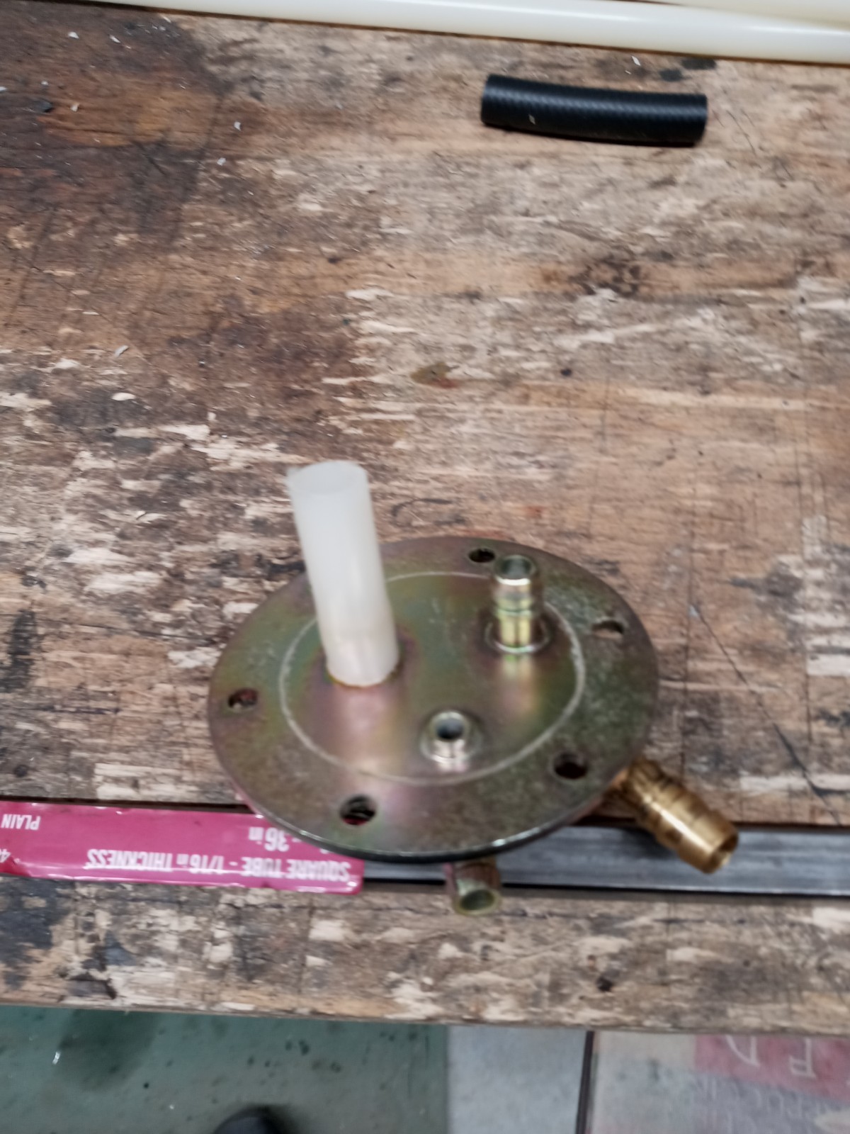

  4. Picked up the new fuel pump today and started looking things over. Looks pretty straight forward. I opted to use the existing plate from the tank rather than buy and revamp the Honda pump assembly. That decision was driven by the fact that I have a 1/4 inch return line from the fuel pressure regulator and I am using another outlet for the tank vent. Therefore, I decided to make a new hangar bracket to support the pump and will weld it to the bottom of the existing plate.
    Pulled the plate off and removed the two plastic tubes coming from the 3/8 outlets.
    Glad I am making the change as I had been using the 1/4 outlet for my fuel return which is not what Tanks had designed. Guess they wanted the extra 3/8 outlet to be the return. Regardless, I am changing things around now. I shortened the last tube and will now use that for the tank vent.
    I had a strip of 1/8 inch flat bar hanging around so I cut two pieces 14 inches long and tacked them together to make a V channel to support the pump.
    And then attached it to the plate
    Mocked up the pump next to see what I would need for tubing.

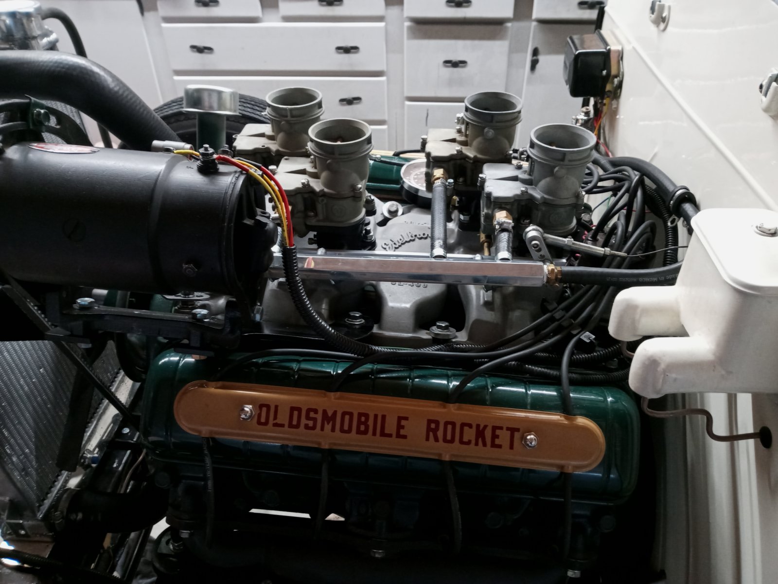

  5. After much do diligence I have managed to get all four carbs detailed and set in place. Got everything plumbed up and ready for fuel.
    Filled the radiator up and discovered a big leak in the thermostat housing. This seems to be a repeat thing so I removed the housing and found that it's base appeared to be warped just enough that it may have been the issue. It rocks just a bit when placed on a sheet of glass. I filed the surface down to the point where the rocking was eliminated and reinstalled it. No more leaking! Now on to the fuel. Turned on the new in tank pump and fed fuel into the system. As soon as the fuel bowls filled, we had gas everywhere where it was not supposed to be. The brief moment I had to look at the fuel gauge said it was going past 6, not good at all.
    I have a Holley regulator so obviously some adjustment was in order. I backed the adjuster all the way out hoping I could get it really low and sneak up on the 2 lbs I needed for those sensitive 97's. I lit off the Olds with the pump off to clear things out. She fired right up but ran rough as hell. Couldn't get her to smooth out so shut her down.
    Figured I had better pull the plugs. They did not look bad, only one was a bit wet but I did find two wires that were not on tightly. Probably from when I had pulled the plugs when the engine was removed a while back.
    Put the plugs back in and gave the carbs a shot of fuel. Now she fired up and ran a bit better. Adjusted the timing a bit-that helped it idle better. Then she died. Guess I need more fuel in the carbs but nothing is working now. I can here the pump whinning but no delivery. WTF!

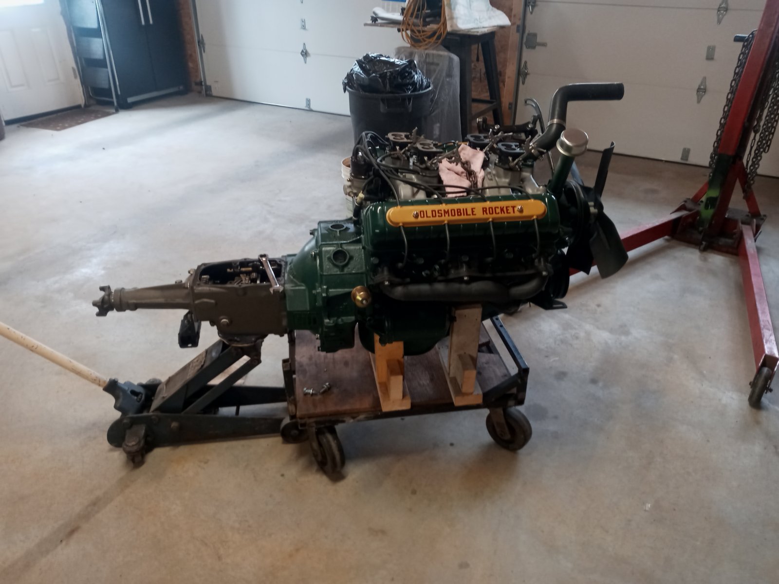

    This morning I finished pulling the eng/trans. Got it down to about a 4 hour deal working alone.
    Pulled the tranny off and did a visual on the internals. Some chipped teeth on the 1st gear but nothing jumps out at me other than that. Will have to see where I go from here.

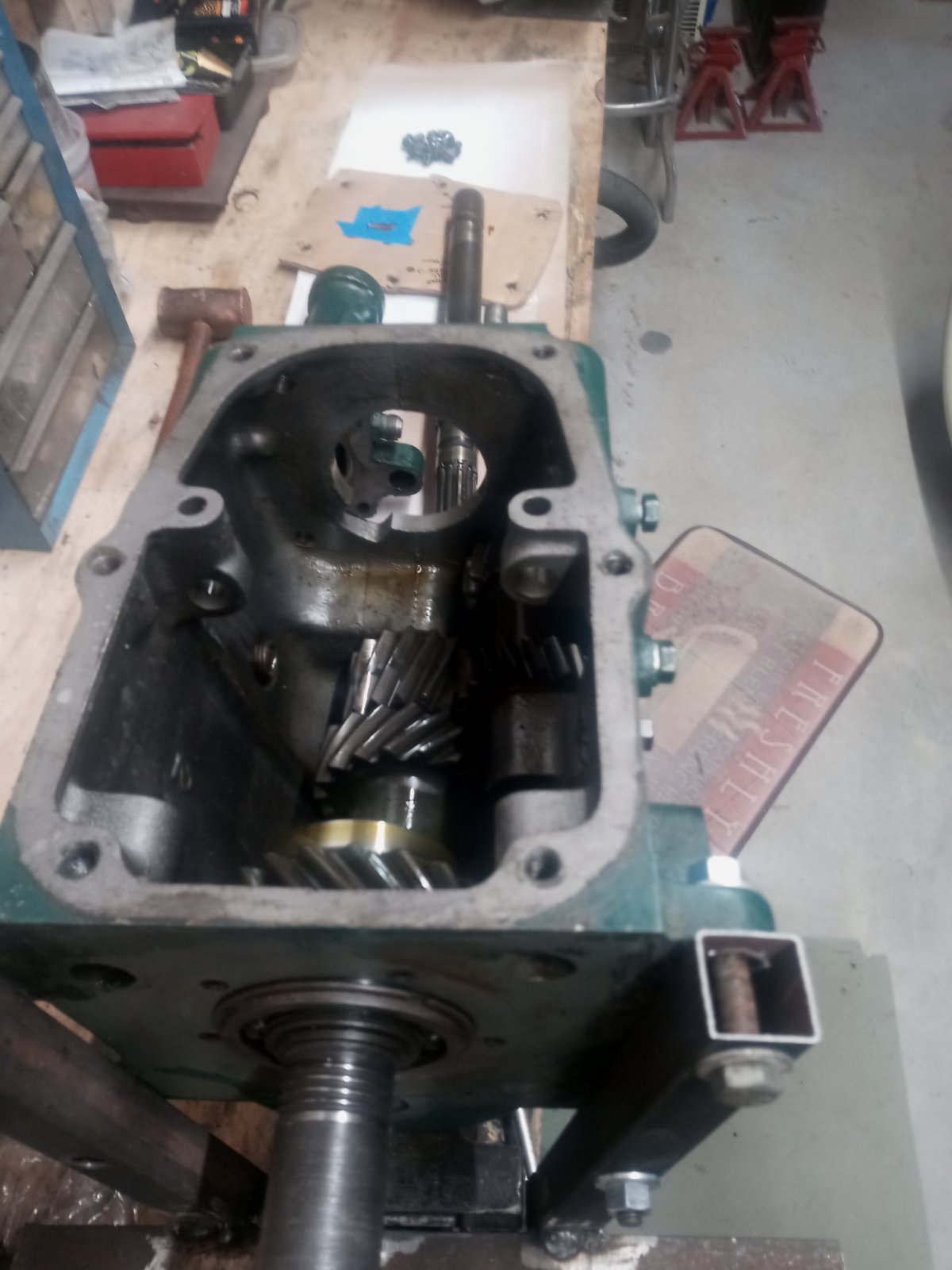

  16. Yesterday I pulled my other tranny off the shelf and decided to tear it apart since it only had one issue as compared to the one currently attached to the Olds. Fairly easy tear down once you get by that ugly circlip on the front of the output shaft. There is hardly any slop in the 2nd gear on the shaft, everything else looks to be in good shape. I have found a nos 2nd gear and have a lead on a nos synchronizer. Going to proceed slowly and check all the fitments and clearances but so far I am not finding much that jumps out at me.
    Cluster looks to be in great shape and has acceptable end play so I am leaving it in place. Reverse idler looks good also. Now I will go thru each piece carefully to see if I can determine why this thing is kicking out of 2nd.

    lets get up to speed here. Reinstalled the tranny and put the engine back in the car. Got out on the road and ran it around enough to get everything warmed up. The transmission still pops out of 2nd on coasting. Not what I expected but par for the course lately with this build. Still having issues getting the engine to return to idle. Seems to want to hang around 900 rpms and my clutch chatter is getting worse.
