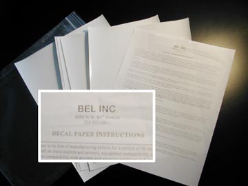

  2. whizzerick
    Joined: Nov 13, 2002
    Posts: 1,109
    whizzerick
    The paper: many sources offer it. It's used for model building. This one is for inkjet printers.

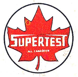

    whizzerick
    The art: grabbed from the web. A distinctively Canadian icon.

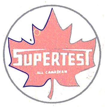

  4. whizzerick
    Posts: 1,109

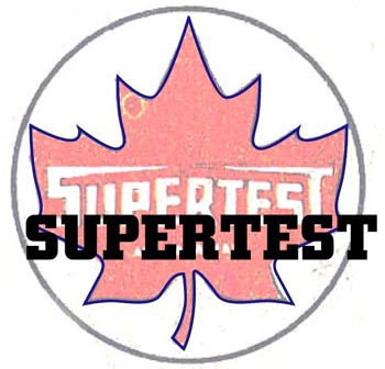

    whizzerick
    Tweaking in Photoshop: Better definition will help us later on. Rotating till the text is straight.
  5. whizzerick
    Posts: 1,109

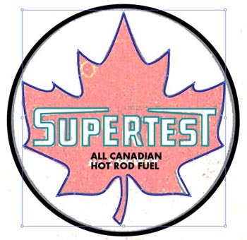

    whizzerick
    In Illustrator: our image in the background. We'll use it to guide us while tracing.
  6. whizzerick
    Posts: 1,109
    whizzerick
    Bezier curves: learning how to use bezier curves will give you a LOT of confidence while tracing.
  7. whizzerick
    Posts: 1,109
    whizzerick
    Tracing: using a contrasting color to see where we are going with the lineart.
  8. whizzerick
    Posts: 1,109
    whizzerick
    Flip: this design is almost symetrical. Flip it to finish the leaf.

    Font: Close enough. Let's work on it.
  10. whizzerick
    Posts: 1,109
    whizzerick
    Modify: Getting there...

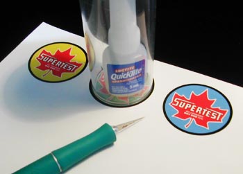

    whizzerick
    Printing: A 99$ inkjet printer, NO fancy stuff here.
  16. whizzerick
    Posts: 1,109

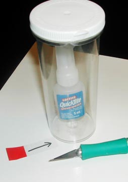

    whizzerick
    Cutting: You see? It's much simpler to make a nice cut this way.

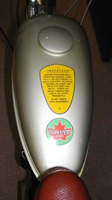

    whizzerick
    The object: The tank on my 1948 Monark Whizzer could use some color.
  18. whizzerick
    Posts: 1,109
    whizzerick
    Apply: Soak as per instructions, apply CAREFULLY! This paper is ultrathin.
  19. whizzerick
    Posts: 1,109
    whizzerick
    Results: Looking good, right next to that N.O.S saddle!

  28. whizzerick
    Posts: 1,109
    whizzerick
    I'm done! I'll be glad to answer any questions:
    - 30roadster: these are NOT waterproof... A thin coat of Krylon Clear will help them resist smearing. They are fragile but, hey, why not change'em on a weekly basis to keep it fresh?
    -Django: Do a Google on Decal paper, I order mine from Florida. 20$ a pack of 50 if I remember well?
    -36couper: That'd be difficult for me these days. I'm already behind schedule with most of my clients... I HAD to take time for a tech post, tough...
    Fellas, remember that this is a 'decorative' process and that you'll have to experiment with it. It is rewarding, though.
  29. whizzerick
    Posts: 1,109
    whizzerick
    Elrod, I discovered that stuff when a buddy asked for artwork for his Vintage Wurlitzers (10¢ a play) !!! It IS available clear. If you need only a portion of white, you can cut a piece of white decal paper and place it underneath the CLEAR decal your doing. It is very thin paper, the 'bump' hardly shows.
