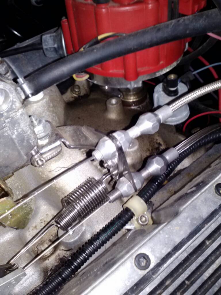

  11. 48 Poncho
    Joined: Jul 24, 2005
    Posts: 702
    48 Poncho
    from Tennessee
    Forgot I had these on the phone. Hope these will help you help me!
    48 Poncho

    It might be my eye's but it doesn't look like there is a lever bolted to the carb linkage itself.If you have the TV cable hooked to the linkage that came on the carb that is the problem

  13. gimpyshotrods
    Joined: May 20, 2009
    Posts: 23,336
    gimpyshotrods
    Please stop calling this a kick down cable. It is almost everything but. It is called a throttle valve cable, or TV cable.
    And yes, you MUST purchase and install the geometry correction bracket in post #3, or you risk burning up the transmission.
    The pull range and angle on the Edelbrock carburetor is correct for a TH350, not a 700R4.

  15. gimpyshotrods
    Posts: 23,336
    gimpyshotrods
    If you did not specifically purchase it and install it, it is not there.

  18. Gregg Pellicer
    Joined: Aug 20, 2004
    Posts: 1,347
    Gregg Pellicer
    If you didn't bolt one of there on that is the problem[​IMG]

    All I see is the parts that come with the carb. There is another piece you are missing. On a 700 you can't just connect the cable to the carb linkage unless its a totally stock setup. You don't have that since its an aftermarket carb.
