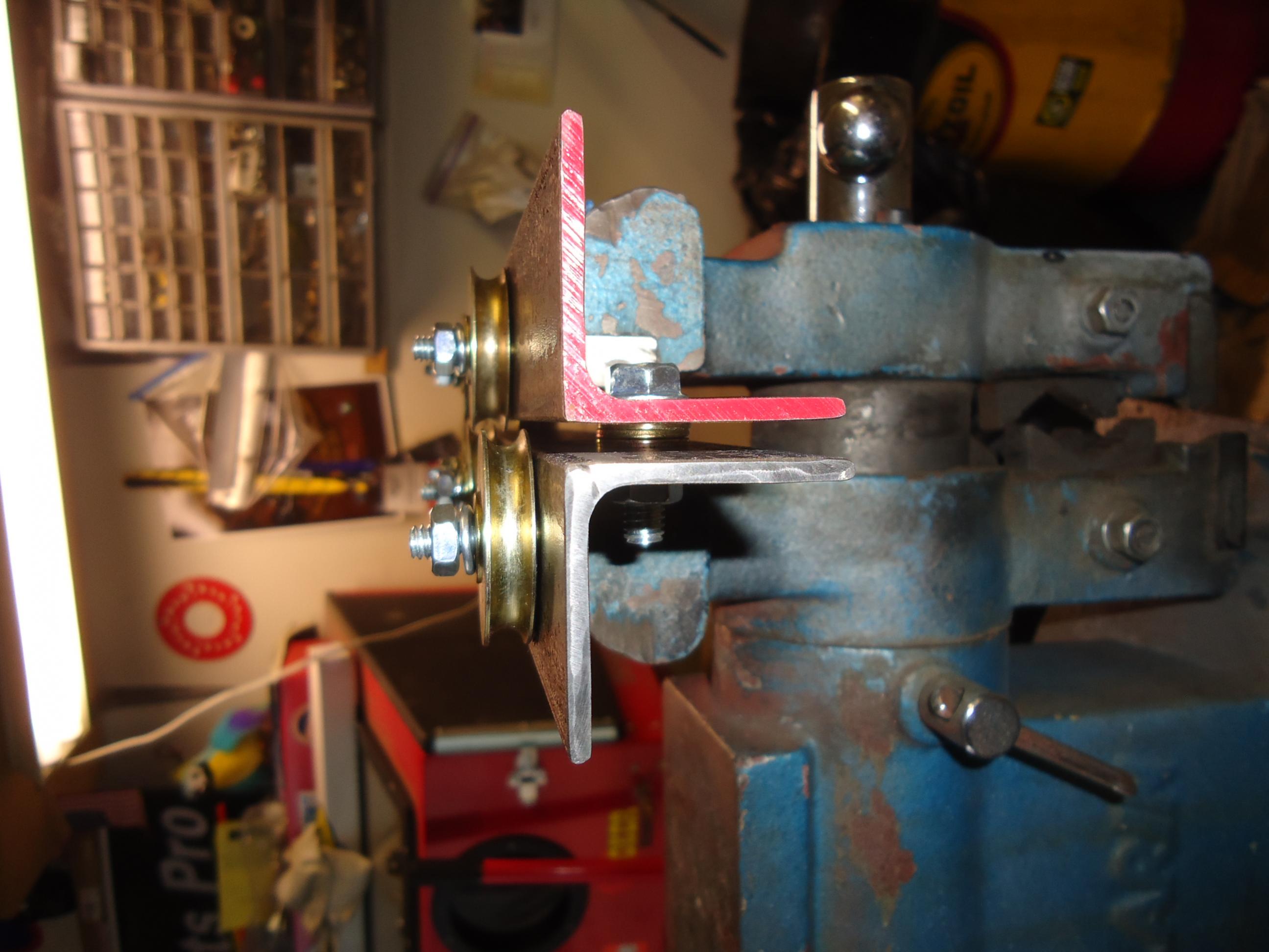

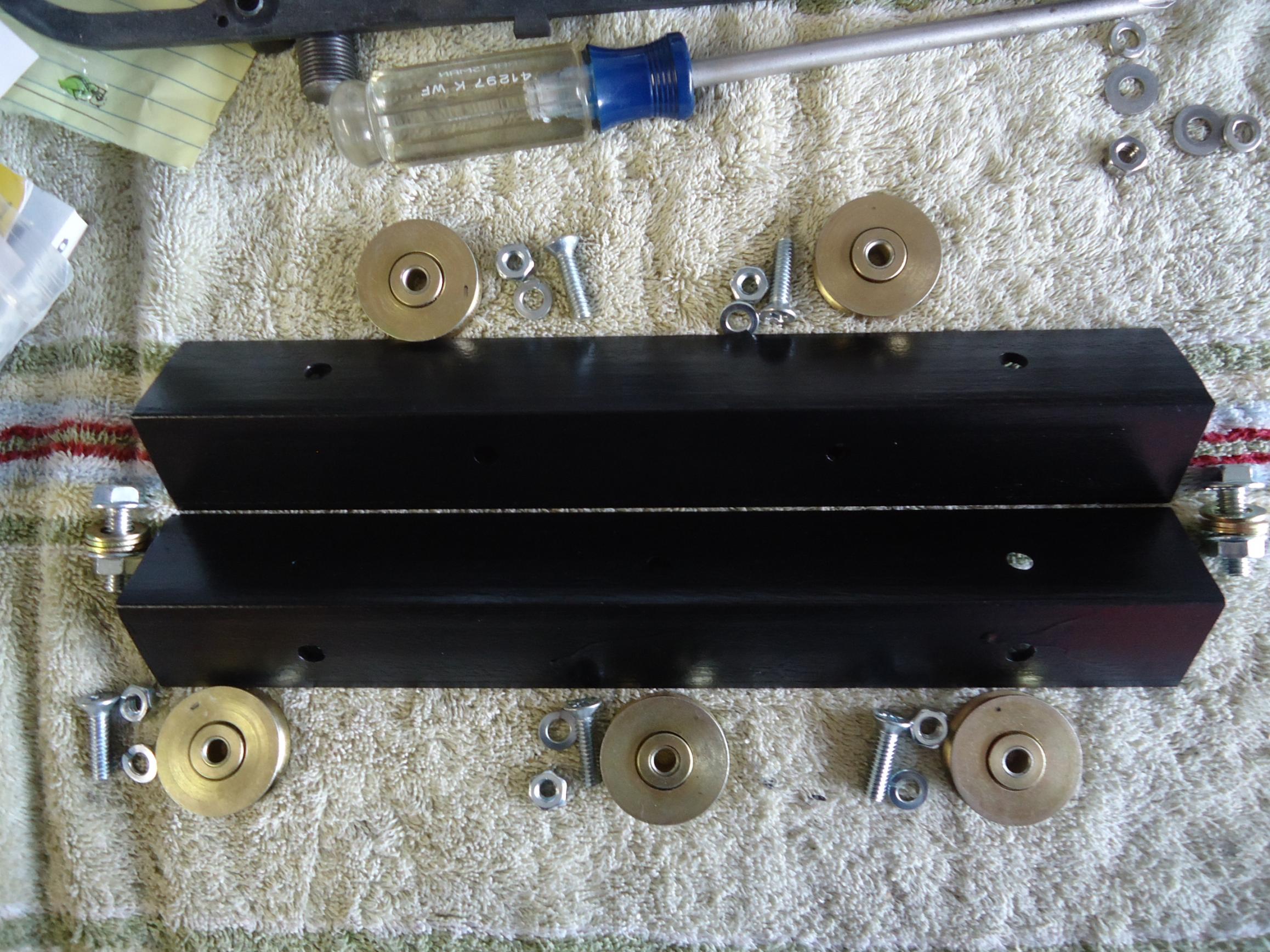

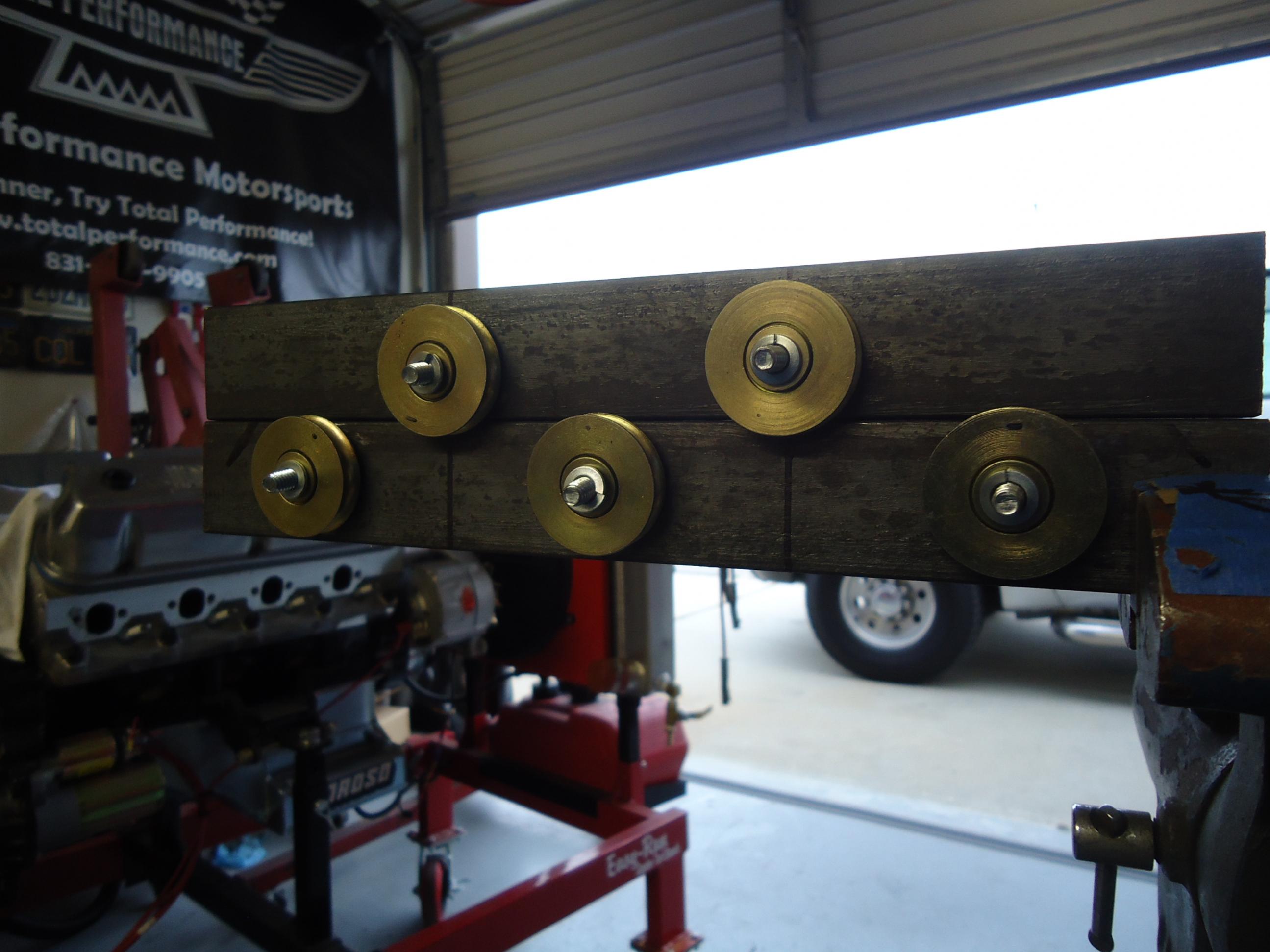

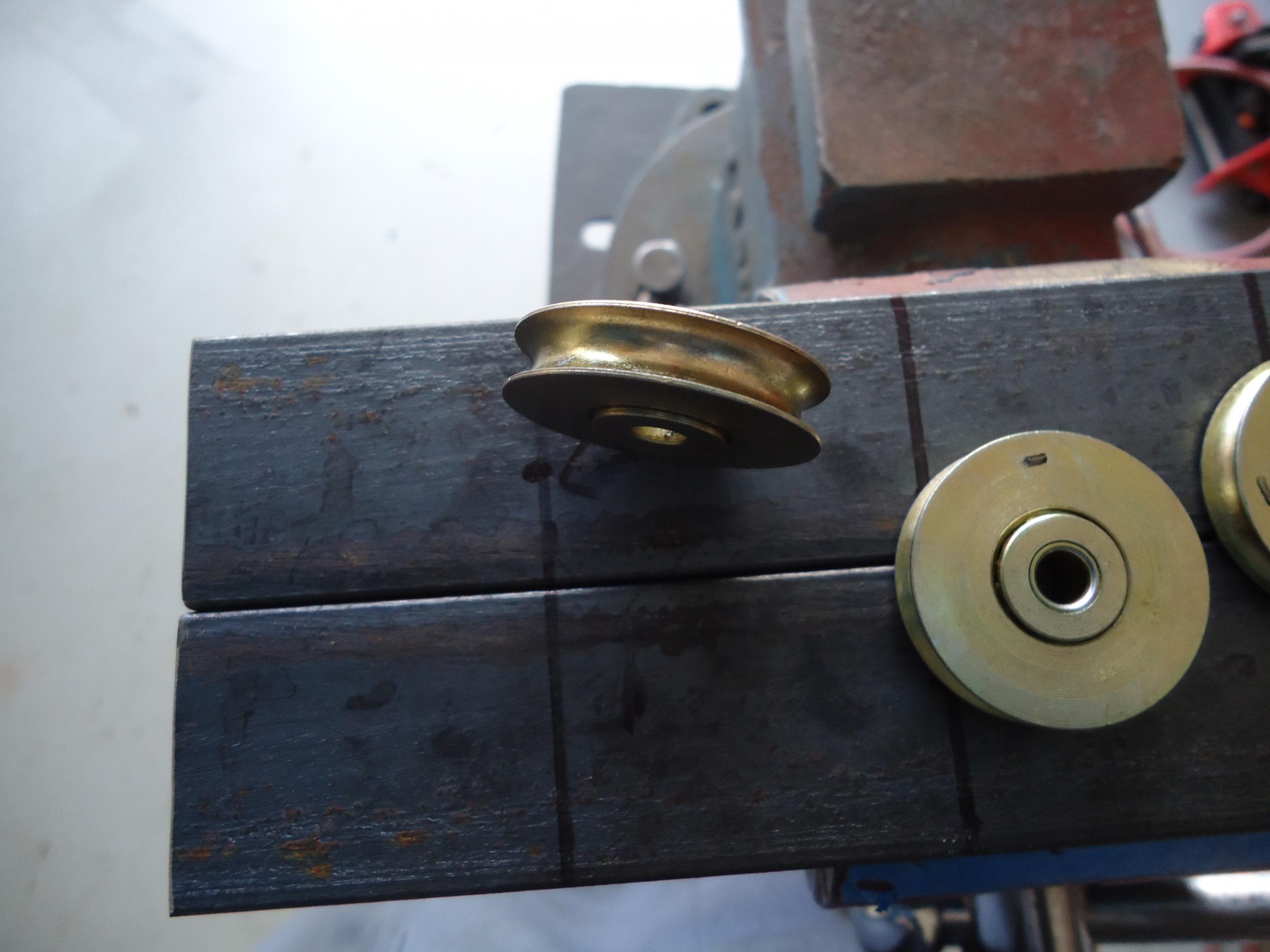

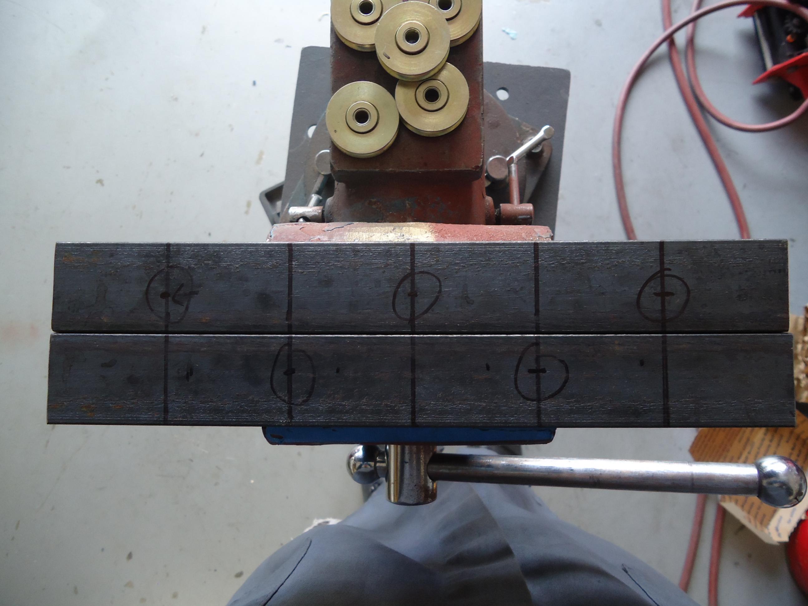

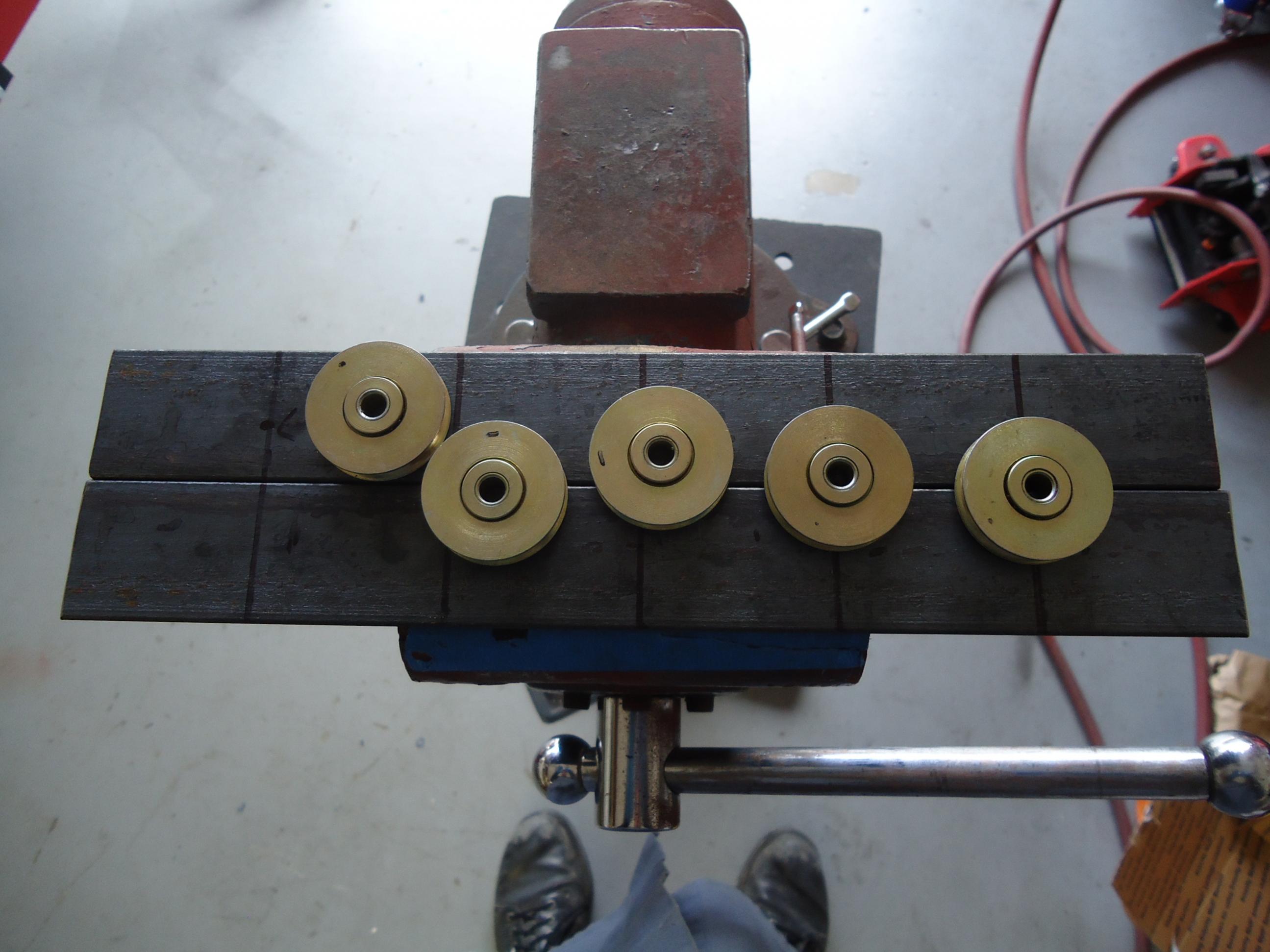

    Quick tech article on how to build a tool.
    I broke my blue 350.00 rolled tube straghtener and needed one fast. So I went and built one for about 30.00 bucks that did the same thing and I was able to keep the rest of the cash for the car. I thought i'd pass it on so here goes!
    What you need is as follows;
    A couple pieces or one you can cut of 1.5 x 1.5 inch angle iron about a foot long.
    5 -screen door rollers 1.5 inch, they come in steel and plastic. I'm doing stainless so I went with steel. Make sure you get the ones that are ball bearing and not solid.
    5 -1/4 - 20 machine screws
    5 -lock washers and 5 hex nuts
    3 - 2.5 inch bolts (whatever you have around) and the 2 lock washers and nuts or lock nuts to go with it.
    Place the two 1ft pieces of angle in the vice and mark them across the surface side to side every 2 inches as on the pic.
    Mark the rollers from the center of the bolt hole to the inner most area of the roller where the tube sits. Your going to want that to be at the edge of the inside of the angle iron where you will squish them together. You cant really blow this unless you get them to far apart. If they are to close when your done you can space them out with washers. I like to make them a bit close myself. You'll see where my marks are on the rollers. Note there just sitting there and not in the correct location in this pic.
    Total Perf-

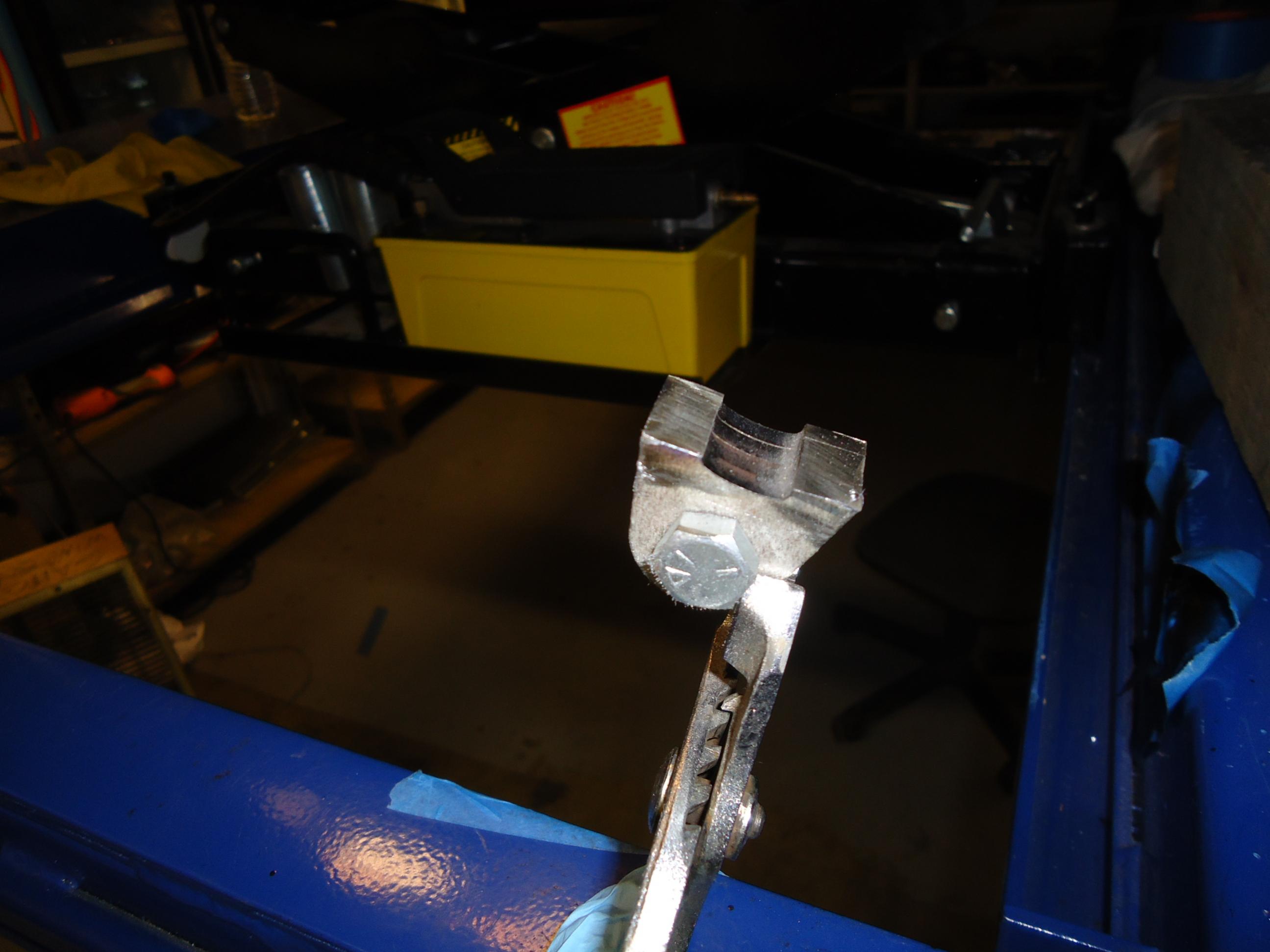

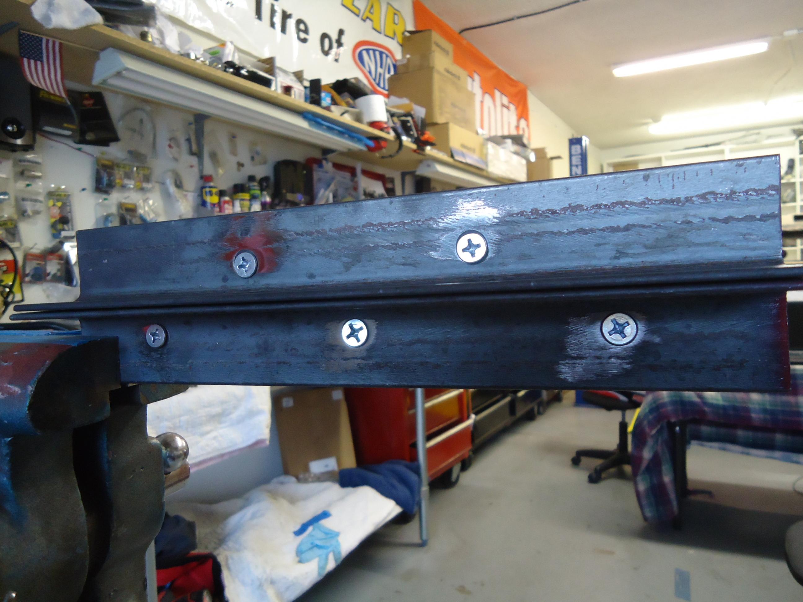

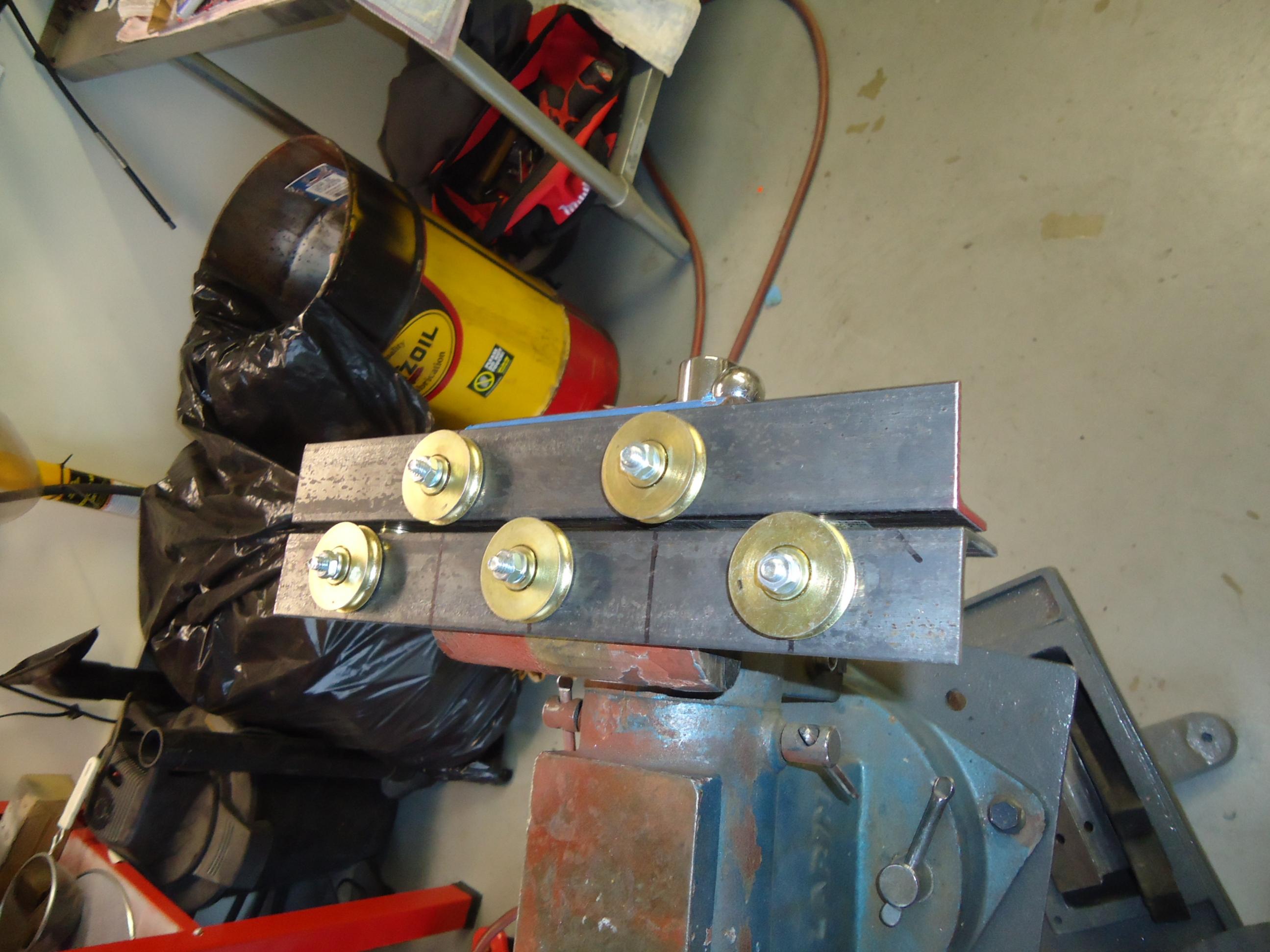

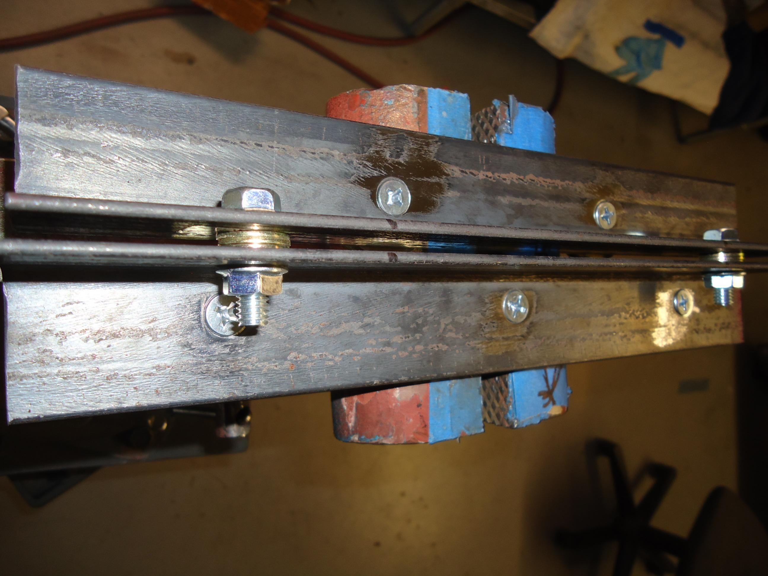

    Part 2

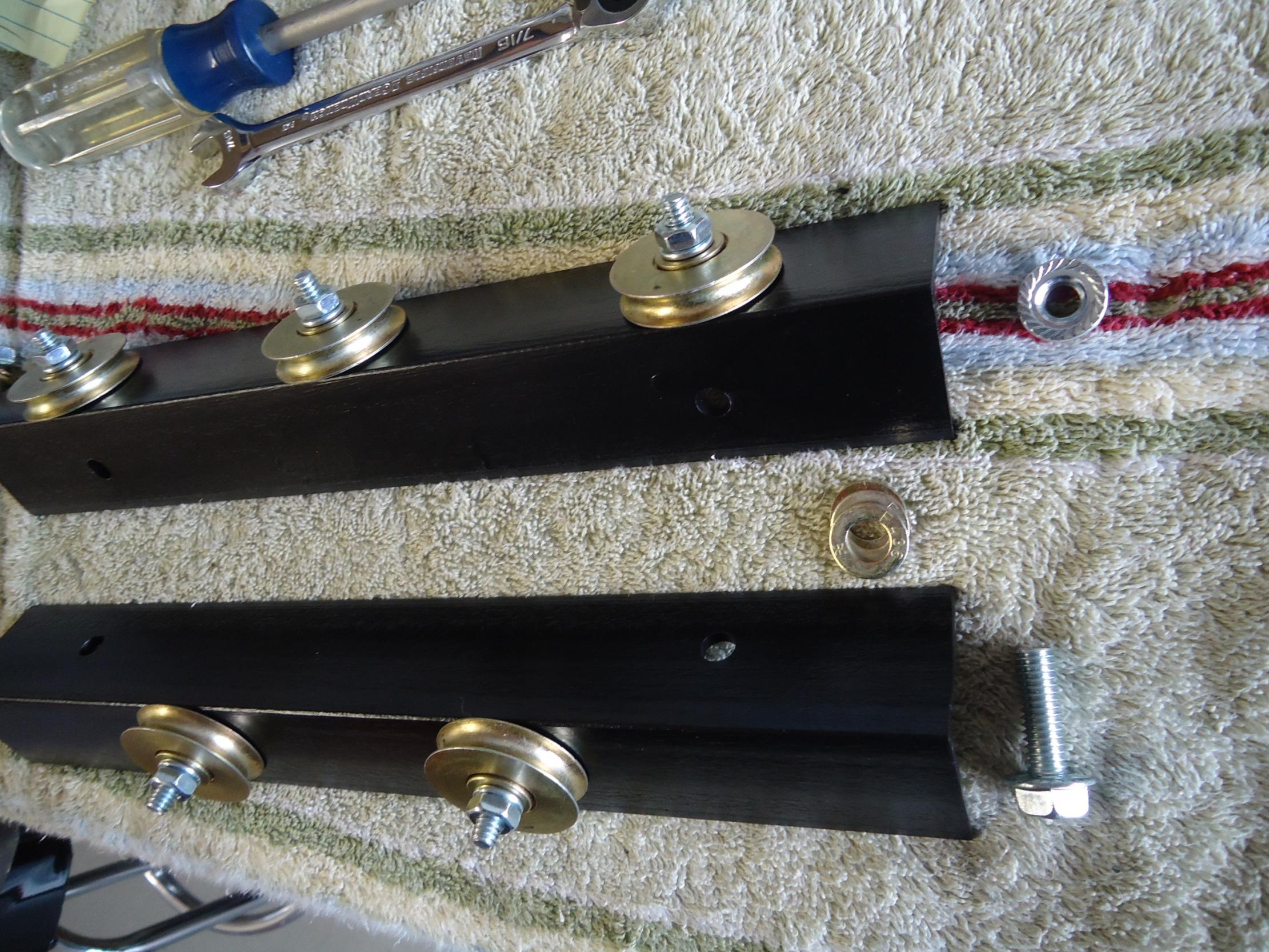

    After you have the rollers spaced out and layed out correctly center punch the roller holes and drill the holes.
    After they have been drilled out correctly use your countersink or an oversized drill bit to countersink the heads of the roller bolts so they will fit in the vice flat. Be sure to counter sink the correct side. See pictures.
    Now move on to the other side of the angle iron that fits into the vice and drill your 2 holes. (When you lay them out, make sure you take into account the vice or clamping surface you will be clamping it into so that you get a solid flat surface and your new bolts wont get in the way.)

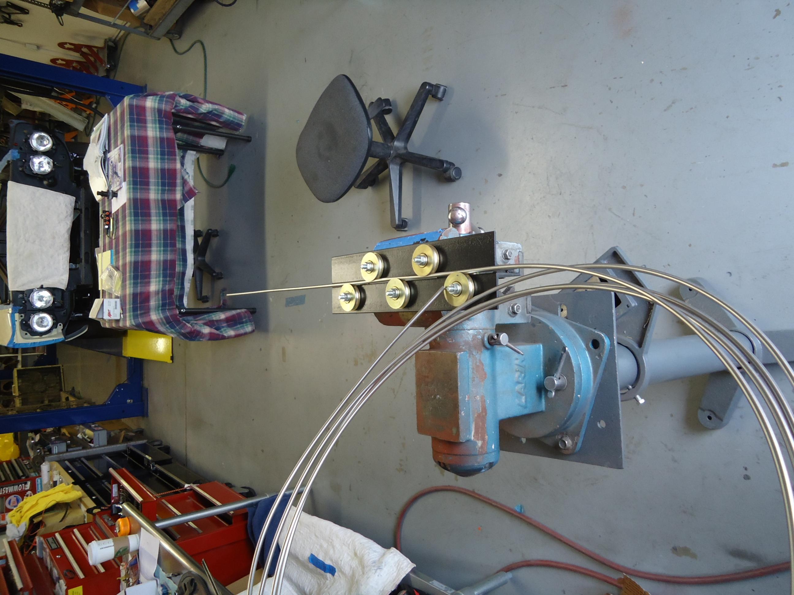

    Now put your new line straightener together and test fit your complete unit. I used 3 washers on the clamping bolts to space the two parts out to get the right fit. Space to your own specifications.
    Total Perf-

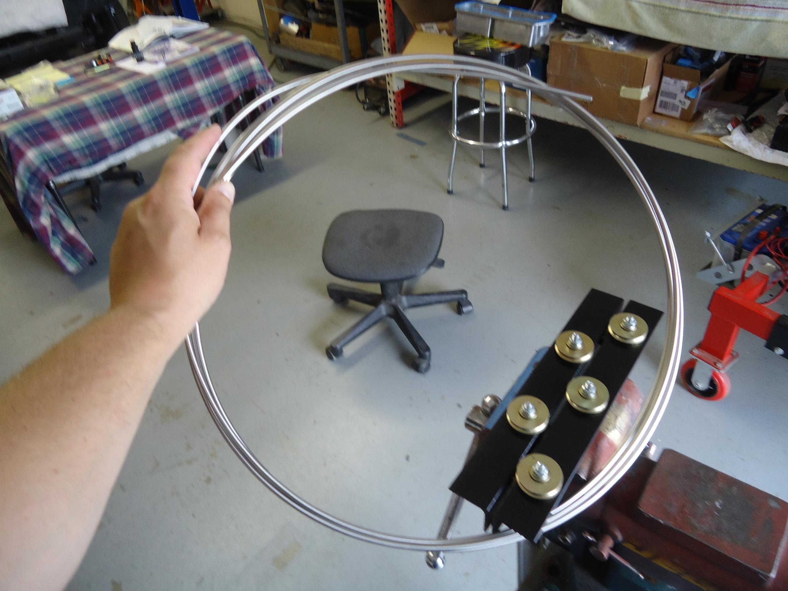

    Part 3
    Now its time to Paint the part whatever color you feel. I like good ole' Dupli Color Engine Enamel Black.
    Now you can straighten any type of brake line, fuel line etc. Just space out the two angle iron pieces and if need be step the roller size up to accomodate larger tube.
    All set! Hopefully you can put this to use and save yourself a few hundred bucks and have a great end product.
    Hot Rod Ingenuity!

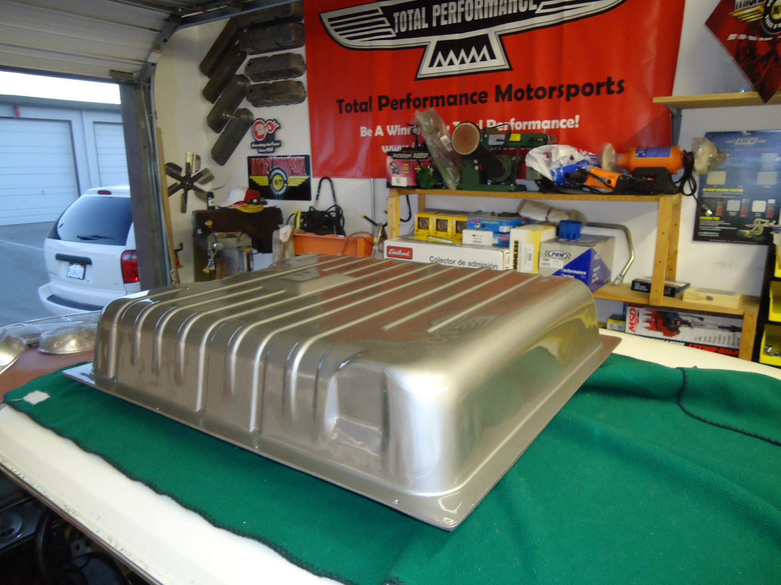

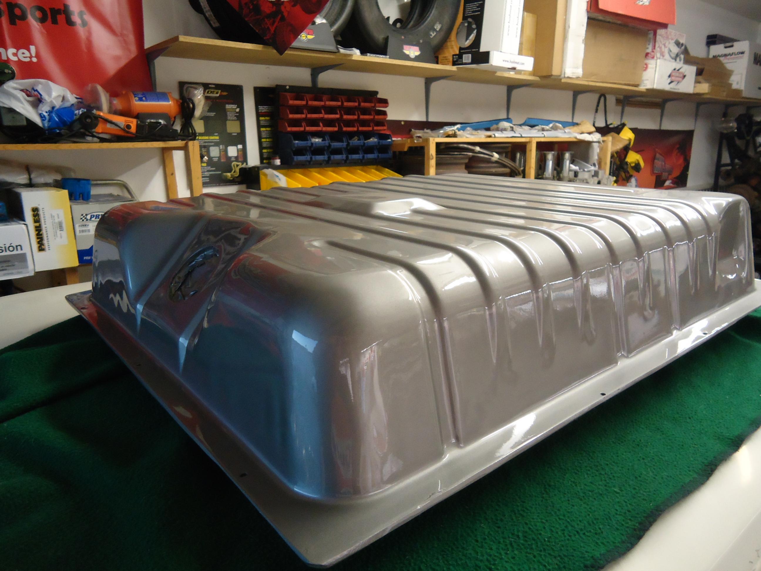

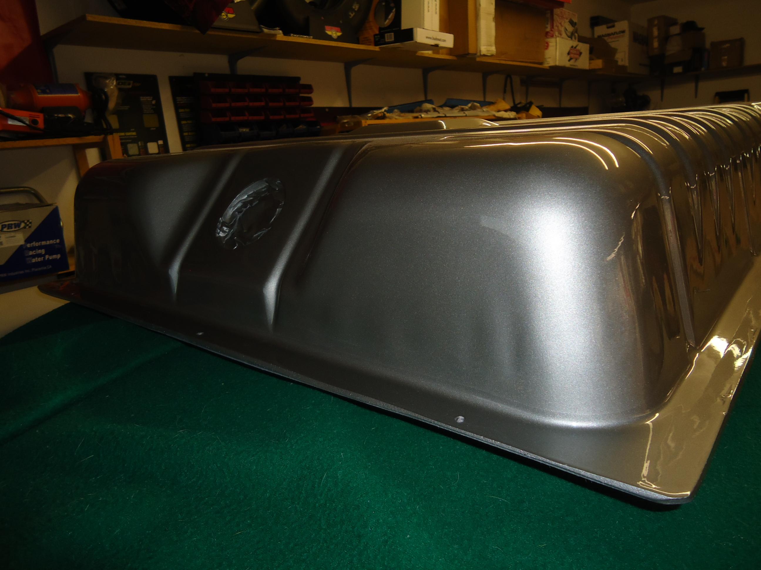

    Here is a shot of the fuel tank Alain shot late last month. Its a Crites fiberglass tank that we ended up using the CREEM sealant in to make sure it stay's alive with modern fuels.
    This tank looks as if it was steel. Alain did such a great job on this glass tank I couldnt believe it. Perfect color for under the car. Thanks again Alain for your awesome work!

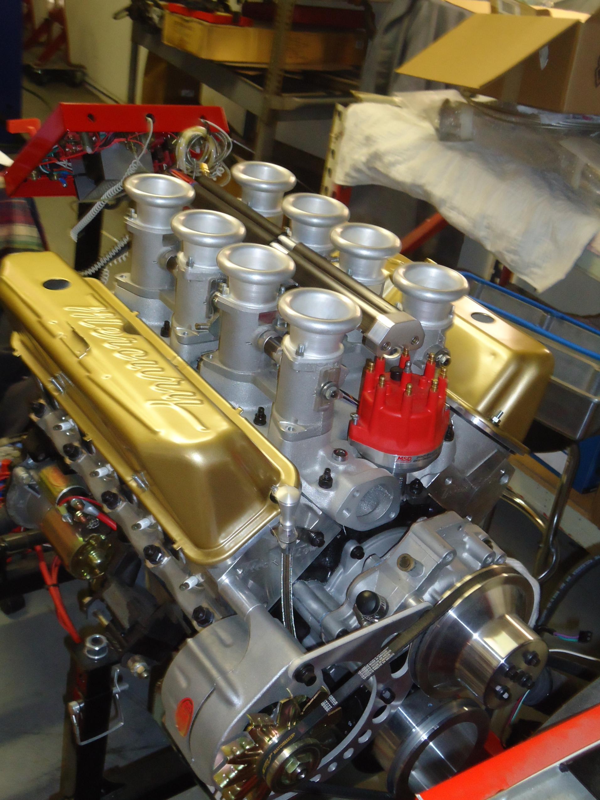

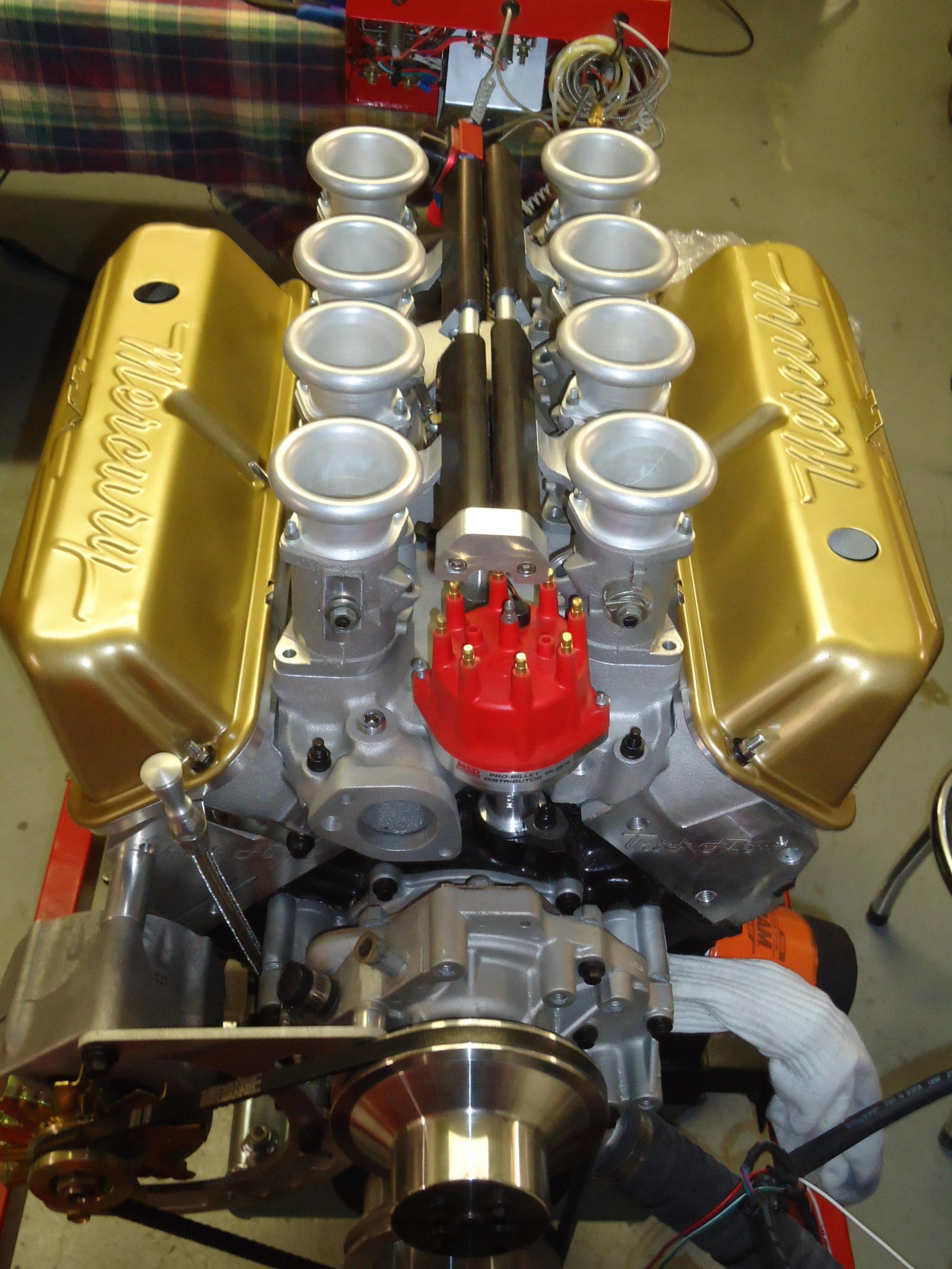

    I decided to throw up a few of the pics with the valve covers were going to use and the injection sitting up there on top of the motor. The shop lights really was out the color of the valve covers on camera. If you think of the deep gold color of a Hertz Shelby GT350 stripes then your really close.
    I do want to paint the dist cap though. Way to red!
    Also the injector covers im using are from C. Cook Enterprises. They have an awesome clean yet race ready look! Pic Below-Were going with the natural unpolished look for the Total Performance "PSYCLONE" though!
    Gary Wallace over at Monterey Peninsula Powder Coating did a great job on these covers. Gary also did the 4 bars on the rear as well. Great stuff. If your in the area give him a shout at 831-422-7600. He can give you what you want and do a great job doing it. Gotta support the guys who support us!

    The fuel tank looks real good. I also like the detail on the engine. You'll be driving soon.....Al

    Aaron;I love those Mercury script pentroof VCs,I tried to use them but they hit the master cylinder with the taller deck 351W!!! That tank looks great as does the engine!! ROY.

    Aaron- where di you source the pent-roofs covers? They are bitchin!

    Hey Roy! I had to have them on the car, I just love them! I picked up a set of the Ron Francis adjustable engine mounts to get me the clearance I needed. Fingers crossed!!!

    Hey Dale! Great to hear from ya! They are mid 60's Mercury Maurader covers for the big block 427/390. I have an aluminum adapter plate to retro-fit them to the small block heads. Give me a call or an email and I'll lay out all the info for ya. I may even have a few sets sittin' on the wall. Be happy to help.

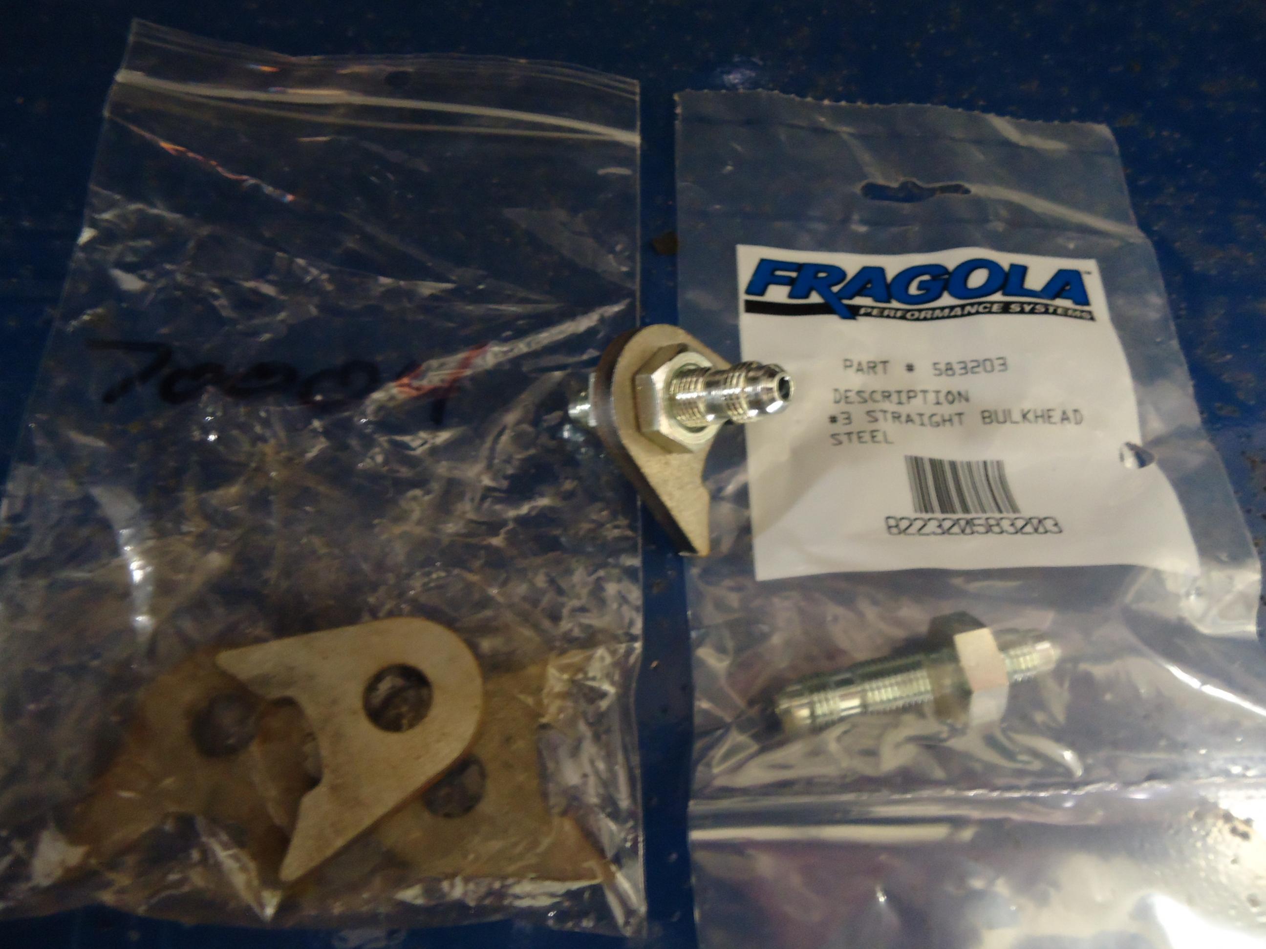

    I forgot to post these pics of the brake lines going in the car. I decided to do the stainless lines with the 37 deg fittings for a clean and for ease in servicing. Also I needed to to give it the look I needed. You saw the line straighnter I made to straighten the line. The other tools I have are a milti angle hand bender, a 180 deg brake line hand bender, bending pliers, large and small cutters and a rigid 37 deg flaring tool. All of the tools are made for stainless tube bending and work great without breaking the bank. I'll try to remember to post a pic of them all for reference.
    Anyhow, I needed a few frame tabs and had a few of the welder series tabs laying around and they worked perfectly! pt # 70004. Here's a pic of the units and a pic of them as I ground them down together to achieve the same mounting angle.
    Total Perf-

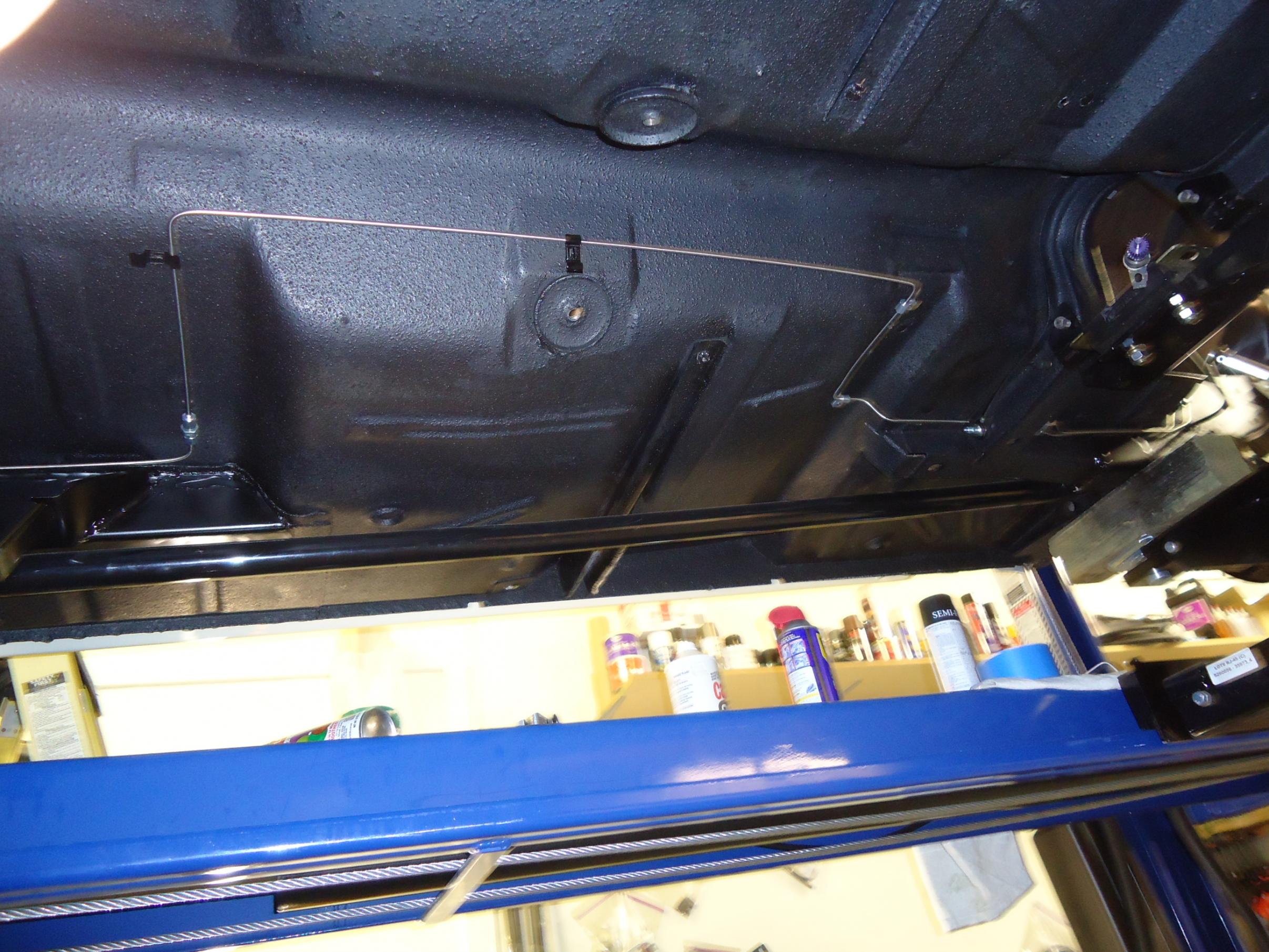

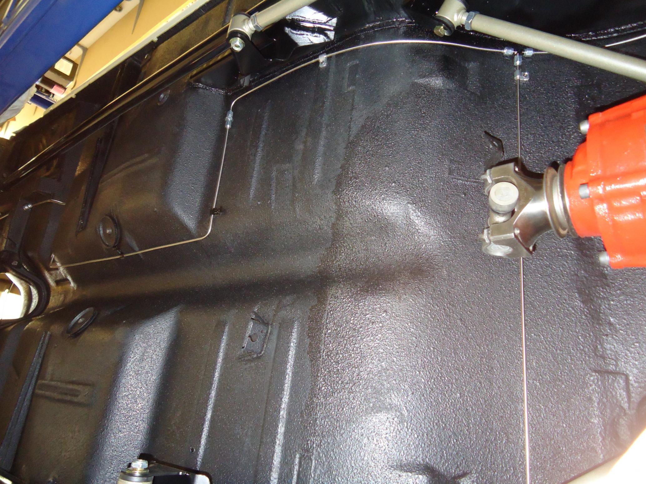

    I found a few more pics of us doing these stainless lines on the PSYCLONE. We plummed it in this fashion in the rear rather than going alont the rear end for a few reasons. 1) it looks really awesome this way with a clean rear 2) It makes it easier on such a small car to get mufflers under the car rather than have the line running from the body to the rear end right in that location 3) with the air suspension the flex lines make it a snap to drop straight down to the caliper itself.
    I think the color change on the underside of the car was from a cleaner I used that wasnt quite dry at the time I took these pics. Its not there anymore.

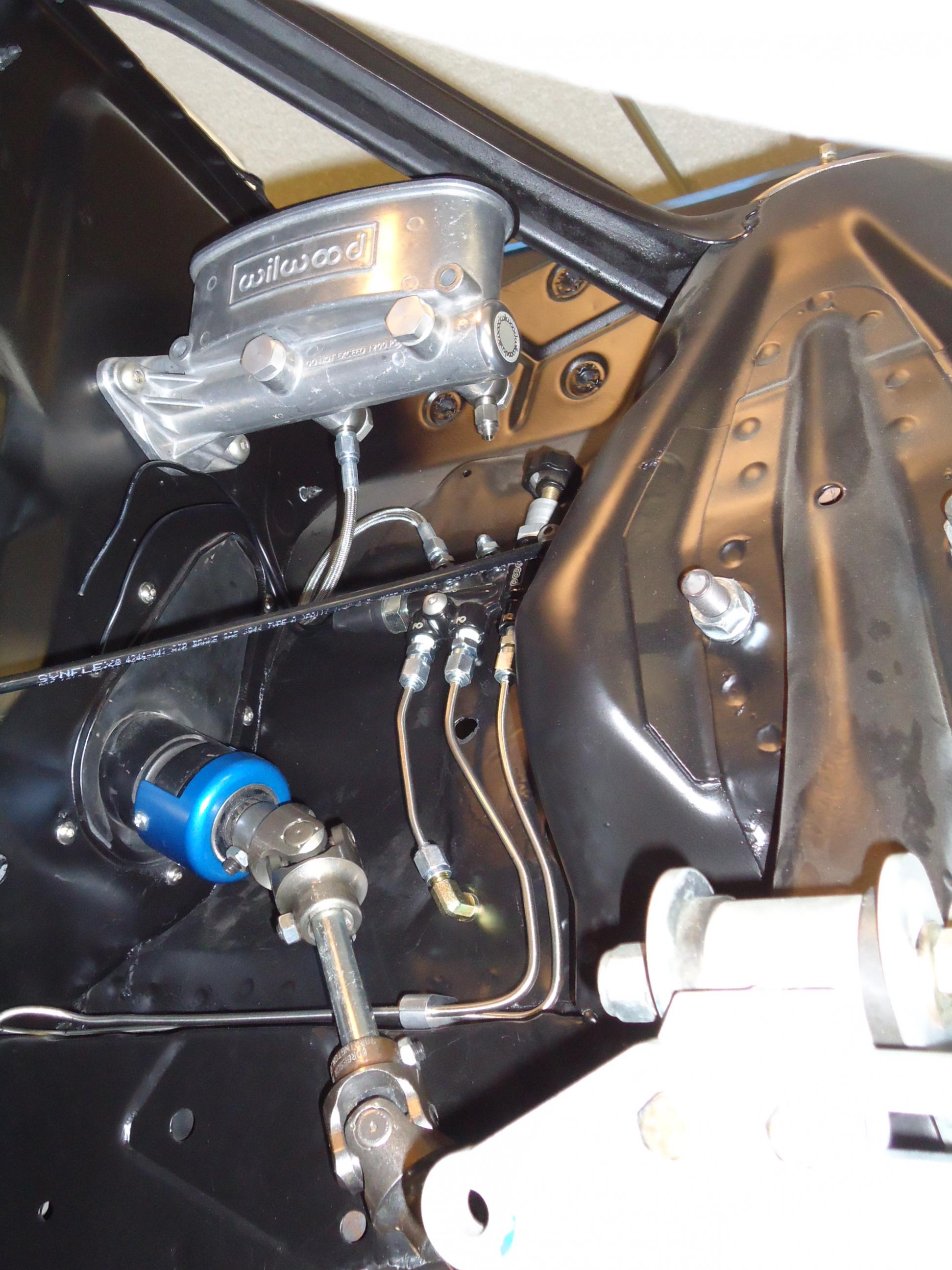

    Just a quick instructional set of pics for guys who are building the Comet/Falcon of these 64/65 years. The tireas and wheels i'm using here are the Billet Specialties Bonneville G and Toyo tires that measure just a hair over 25" tall and right at 9" wide. If interested I can send you info on the B.Space etc if anyone wants it.
    I have full turning radius through both compressed and extended suspension. You can see the factory coil spring shield/support is in place and fits over the bag and will JUST clear the tire when it is in its dropped configuration.
    Hope that helps anyone that may be interested!
