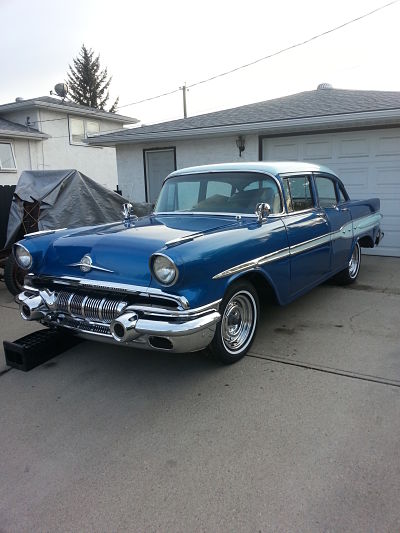

    rsz_img_0901.jpg rsz_img_0903.jpg First off, this isn’t really a build thread. It’s more of a chronicle, and a kiss ass plea for input on a couple things that you’ll see as this rolls along. Up until recently, I have done very little of the building, I was mostly a director during the major parts of the project So it’s kind of unfamiliar territory for me. All I’m doing is the re-assembly, and making it run. And making all of it’s fiddly bits function. I’m still undecided if I’ll have a go at the interior or not. Here goes.

  13. Looks great, the chrome really pops with the blue.

    Thanks guys, oldrelics, I hope so too, and Jeff, that might be the best thing the painter did was talk me into the color change. So, that all said, I'll try to get this updated a bit. The first order of business to take care of was to unload all the parts that were stored inside it from it's move. Then, install all the body mounts and get them shimmed properly, which the body guy had neglected to do :confused:, despite being told that I had only fired 6 of 'em in to bring it home, and giving him the box full of the remainders. My wife helped with this, and questioned why I thought working on old cars was "fun". I guess jacking up a side of a car, installing mounts, dropping it down, tightening bolts, repeating on the other side, and then undoing all the bolts and shimming mounts wasn't the best intro into working on cars. She hasn't been back out since, to work anyway. After that was completed, I reinstalled the rear bumper, somewhere around 16 times. It just wouldn't line up, I finally disassembled the 3 piece bumper, and reinstalled the pieces individually onto the brackets, it's pretty good now. I ordered repro wiring harnesses through Danchuk Manufacturing, a tri-five Chevy parts outfit. More differences were discovered installing the rear lighting harness, but I was able to modify it by robbing the sockets off of the remains of the car's original wiring. Further up the line, the headlight switch is different between a Chevy and a Poncho, as is the heater switch, but the Chevy light switch fits like a damn, and I think I can modify the Chevy heater fan switch to fit. The dash harness isn't in yet, as the dash has kind of spiraled into a project all it's own, or maybe 3 or 4 separate mini projects. The trunk got shot with GM trunk paint, which I realize isn't stock for the car, but it really cleaned it up back there. pontiac0215 019_opt.jpg

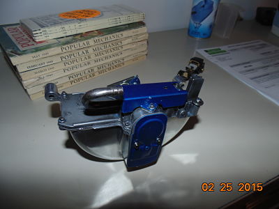

    So, off came the wiper motor. It's the standard vacuum unit, which I have no background in at all. My '59 Ford had one, and it worked pretty good, so I was never in it. I did a little research here, and found this http://www.jalopyjournal.com/forum/threads/school-me-on-vacuum-wipers.957815/. This is where this sort of turns into a diary of a madman, which would have been the thread title, but I was afraid Sharon Osbourne's lawyers would be on my front porch if I had, lol. I took it apart and turned this pontiac0215 006_opt.jpg

    For those interested, I will post a breakdown of the wiper motor rebuild on the thread I mentioned, to make it easier for everyone to find vacuum motor info, since it's pretty generic.
