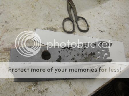

    OK, we did some work on the rider side front floor today. Here's a pic of where we started The floor, inner AND outer rocker panels are shot, and so are the body supports that hold the body to the frame! Lots of work here.
    Here's a picture . You can see that EVERYTHING is rusted out here.
    Dana went to work tearing out what was left of the floor. This is an uber crappy job.
    Here is one of the body supports, you can see the end has just rusted away.
    Another photo of the brace after sandblasting.This is the portion we have to re-make
    We first welded on new sides, They are a perfect copy of the originals
    Then the bottom was tacked on and then fully welded
    Here's a pic of the old rusty end, and the new end grafted on....
    We have two more braces like this to repair, and then we can replace the inner and outer rocker panels. Lots of work, but we're having a blast!
