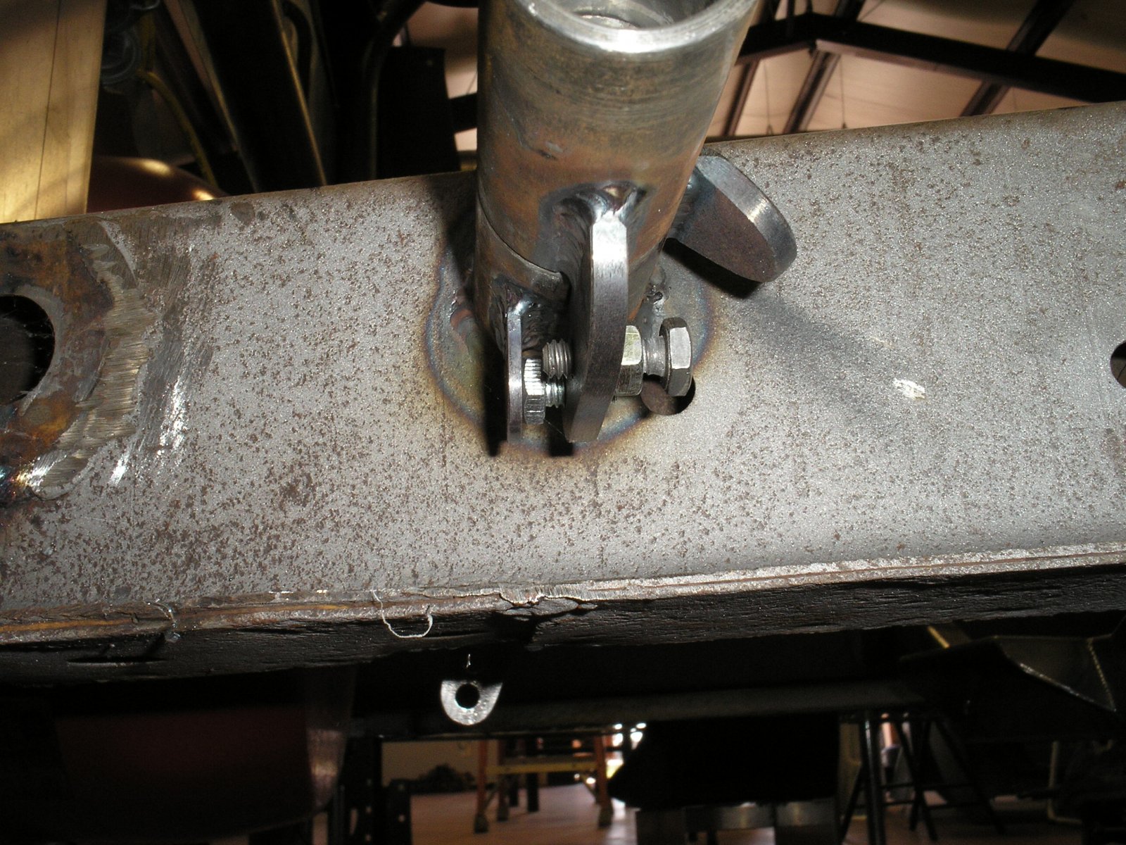

    Earlier in the build I showed pics of the gas petal build and the very important adjustable petal stop. It's just as important to have a clutch petal stop, many pressure plates have been ruined because of no petal stop. Here's a few pic's of the way I did the clutch petal stop on this build. This is the petal with the stop welded on the bottom, hard to tell in the pic but there is a bolt run in from both sides. it will make more since in the next pic. studebaker 005.JPG

    The petal back in the car in the out (or all the way back) position. Note the stop is thinner material on this side because there is only the load of the return spring here, and we are all about weight. studebaker 003.JPG

    Now in the all the way down position. The metal 3/16 moly on the down position and .090 in the out position. Also note the bolt for the heavy load is closest to the petal so not to bend the bracket. Also adjustable both ways. studebaker 004.JPG

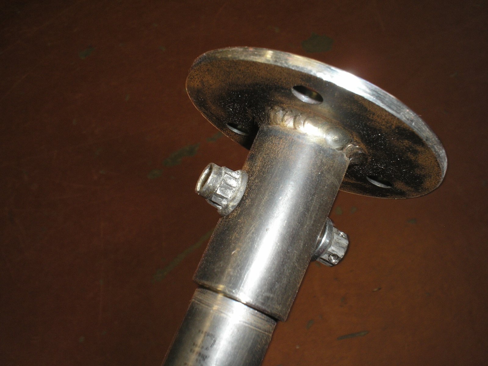

    The steering wheel mount, we make these to where the steering wheel will unbolt with just one bolt. I think the quick release wheel mount that you can buy from mail order looks a little out of place on a 60s car so we do it this way. You could use a push pull pin instead of a bolt for quick release. studebaker 007.JPG

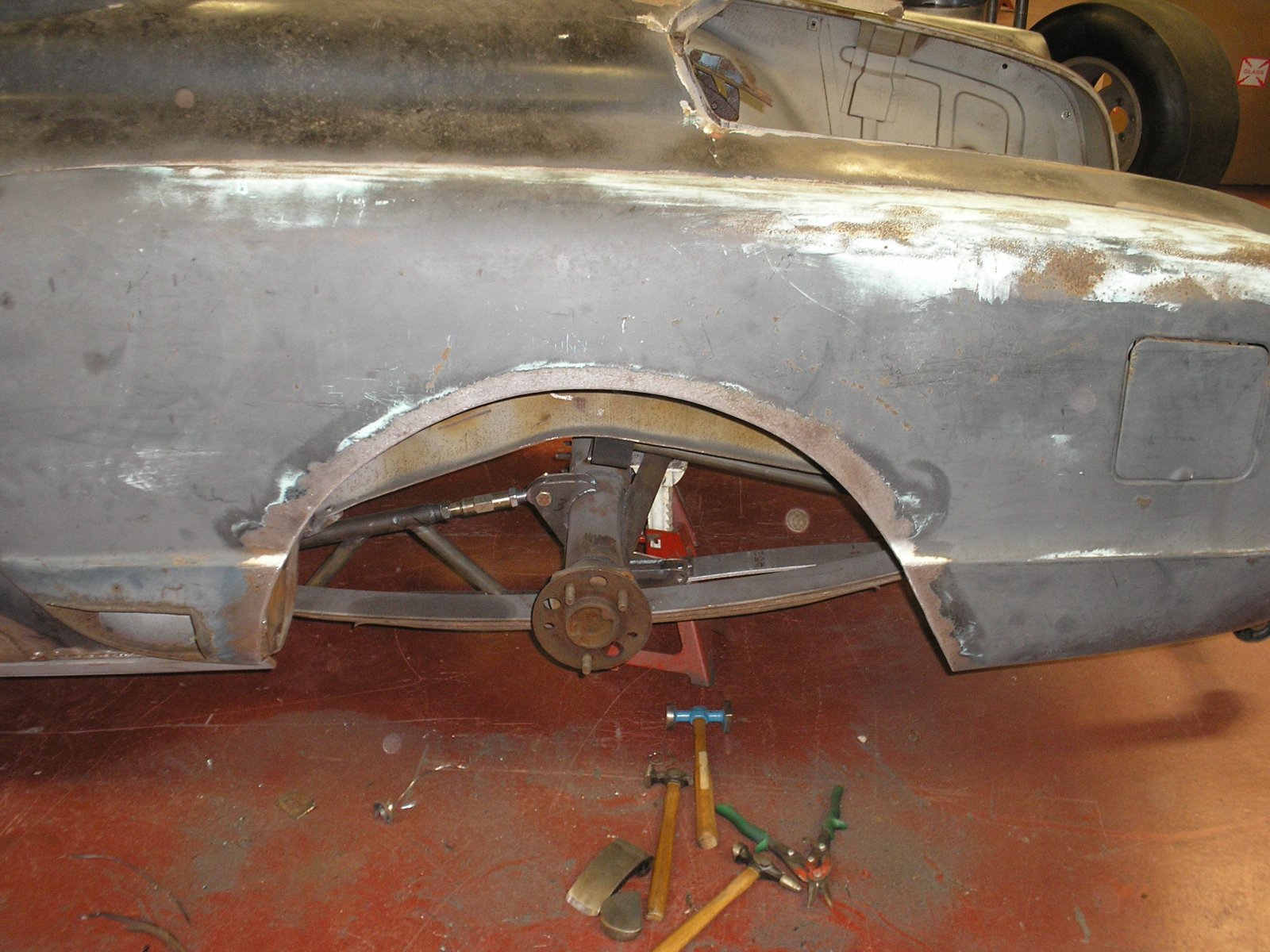

    A gasser has to have the wheel opening cut, not really but they do look cool when they are and most were back then. We thought this car would look better with out a flare on the out side of the opening, give it the old cut out at home look. So I left 1/4" extra and rolled it under for strength. I had to go very slow not to change the shape on the quarter. This will be all the picks in order you will have to look close to see the change, might blow them up to see better. studebaker 001.JPG studebaker 002.JPG studebaker 003.JPG studebaker 004.JPG studebaker 005.JPG
    volvobrynk and AHotRod like this.
    kiwijeff, 69fury, volvobrynk and 2 others like this.

    How much tire-to-opening clearance do you allow?

    I like the look of your radiused fenders.
    But if you wanted a flair of some kind, Ive always thought that the fender lip from a late '60s or early '70s GM pickup would be just about perfect, and would blend into the "step" of the Stude quarter.
    Again, I still like the simplicity of your approach.

    You can have all you want but they get to looking funny if you get too much. I put stops on the shocks so they won't hit if you go over a bump.
