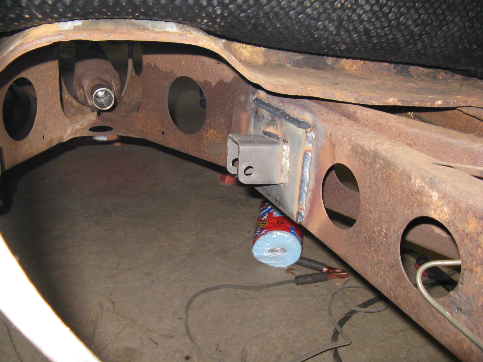

    Ok. It's better than the first time. I basically did the same thing but used 1/4" flat bar this time. The mounts ended up in differrent positions and, therefore, had to be shaped a little different but not enough to tell from pics. Next weekend, I'll make my transmission cross member and, maybe, mount my rear axle. By Labor Day weekend, I should have all the fabricating and mechanical stuff done. :rolleyes: Maybe.

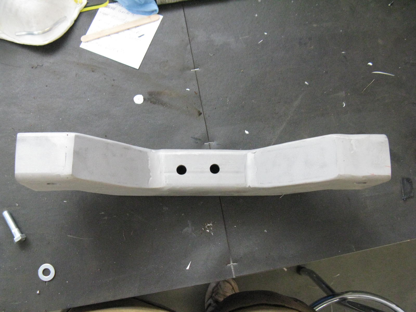

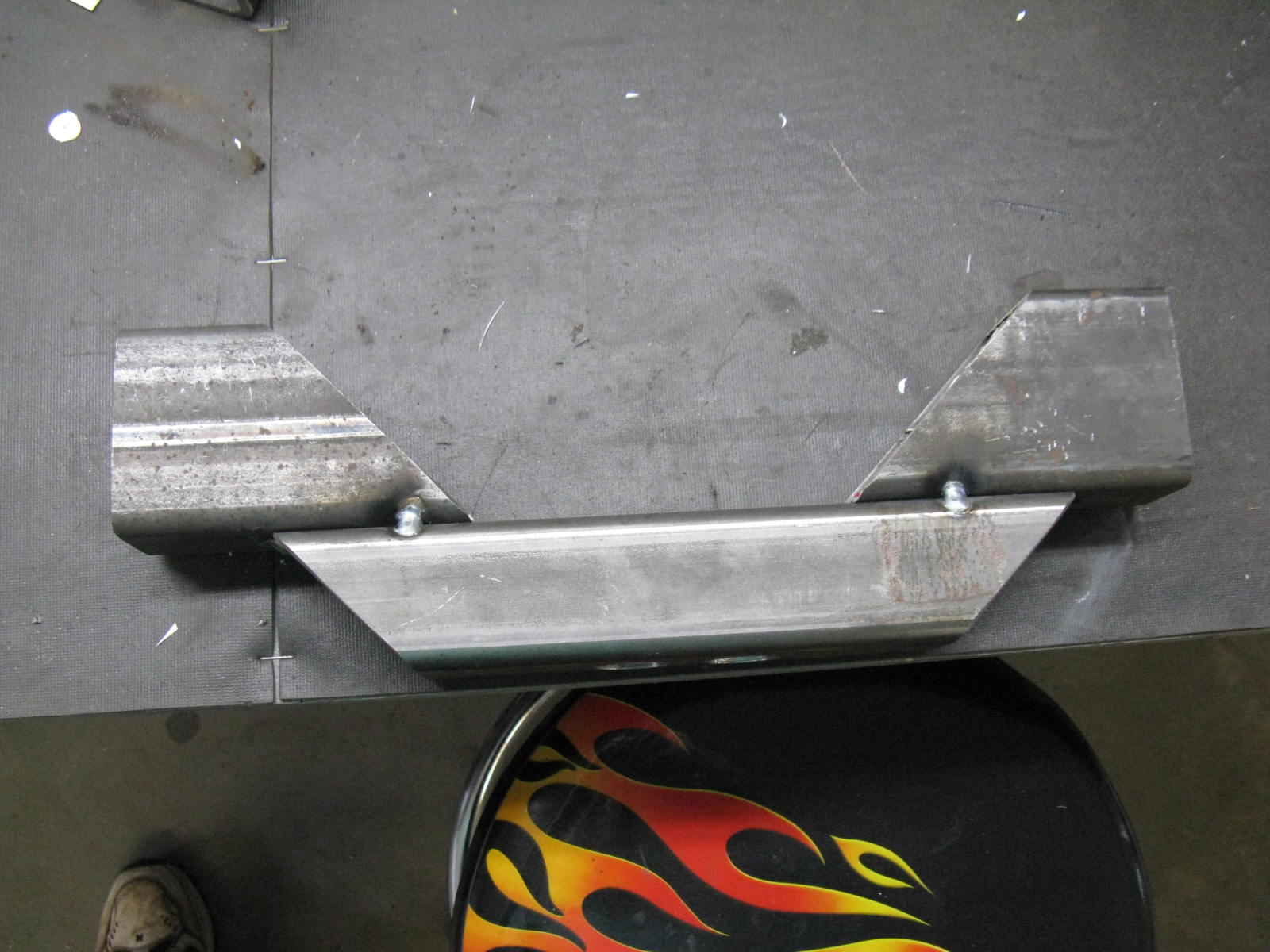

    I bought a transmission mount for a '68 Chevelle, NAPA part number BK 6201024. It sells for a whopping $8. The center to center bolt holes were an inch short, so I welded a longer bracket to it, after cutting a relief area that would clear a 7/16" flat washer.
    Then, I used some 2X2 and 2X3 tubing to construct the crossmember. It's stout! I used some scrap from work, so it didn't cost me anything. I used 2 1/2 X 2 1/2 for the frame brackets, welded to a 5 X 6 X 3/16" plate. The bolts that hold the member up are 1/2".

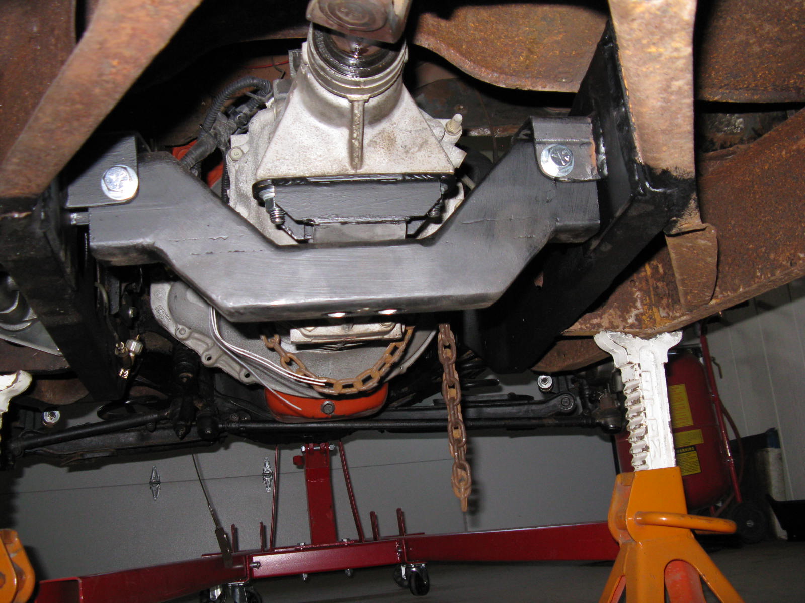

    Finished Product. If a shop quotes you $500 to build one of these, it's not too much. It takes a lot of time to do it right. Note that the frame rails are not parallel, therefore you must build the brackets with the correct angle cut into them.
    I'll post some installed pics tomorrow, after the paint dries. Assuming I can get a picture whilst lying on a creeper underneath the car on jackstands. Since I got the brackets welded to the frame, I'll assume I can do that. I sure will be glad to get this sucker rolling again where I can get it on my lift.
    I plan to install the rear axle next weekend. Feel free to post any relevant links on setting the pinion angle, etc. Does the angle stay constant as the springs are compressed? I think not.

    Looks really good! Well thought out and put together too! Basically, with pinion angles, you want them to match. say your engine and trans are installed at 2 degrees down, your pinion needs to be 2 degrees up. Your looking for parallel. The way I usually do it is a bit more work, but it gets it right. I pull the old stuff out, put the new saddles on the springs, drop the new rear into them but don't weld yet, center it up and make sure the springs are straight, DOUBLE CHECK the above, tighten the u-bolts down snug. Put the car up on 4 wheel ramps so that the weight is on the suspension and the car is as level as you can make it. Set the pinion angle with the aid of a small soft hammer so you don't damage any thing.DOUBLE CHECK that your axle is centered in the frame, ( I usually measure between frame rail and backing plate on each side) DOUBLE CHECK that your springs are still straight, DOUBLE CHECK that your pinion is right, then tack the saddles to the axle. Pull the rear back out and carefully weld the saddles to rear housing,( I usually weld 1 inch at a time and skip from side to side so I don't get too much heat going.Oh, weld both sides of the saddle in the same direction too.) put it all back in and your set. The main thing is to get it to ride height before you dial in pinion angle, because you are right, it does change as the suspension moves up and down. For shocks on the back, mine lay forward, and before I sprung for my high tech Bilsteins, I had great luck with KYB kg series rears for a '63-'78 Corvette. I used the stock lower spring plates and the lenght on these worked out perfectly.

    Man I hate to mention this, 'cause I think everything is welded and solid, but any chance of moving your trans cross member up a bit? These things with just a bit of lowering have a tendency to drag on stuff, I d hate to see you take out a pan or trans. Sorry to mention it this late in the game. Chip

    I might have to agree on the depth of the trans mount. You did a right nice job but it sure looks low.

    It's not that low, RR. It just looks that way since I was lying on a creeper. It's higher than the oil pan and just barely lower than the bottom of the transmission.
