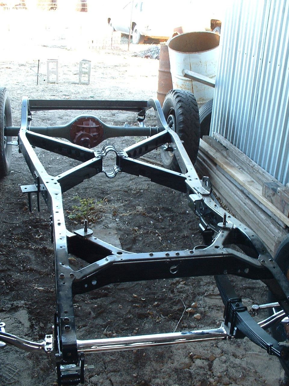

    Here is the most recent status of my 1940 Willys Coupe Build.
    I now have a rolling chassis, just have to set the rear end angle then send it out to get painted. Also get the Labber Bars Chromed!
    Let me know what yall think.

    looking good, nice axle keep it going!

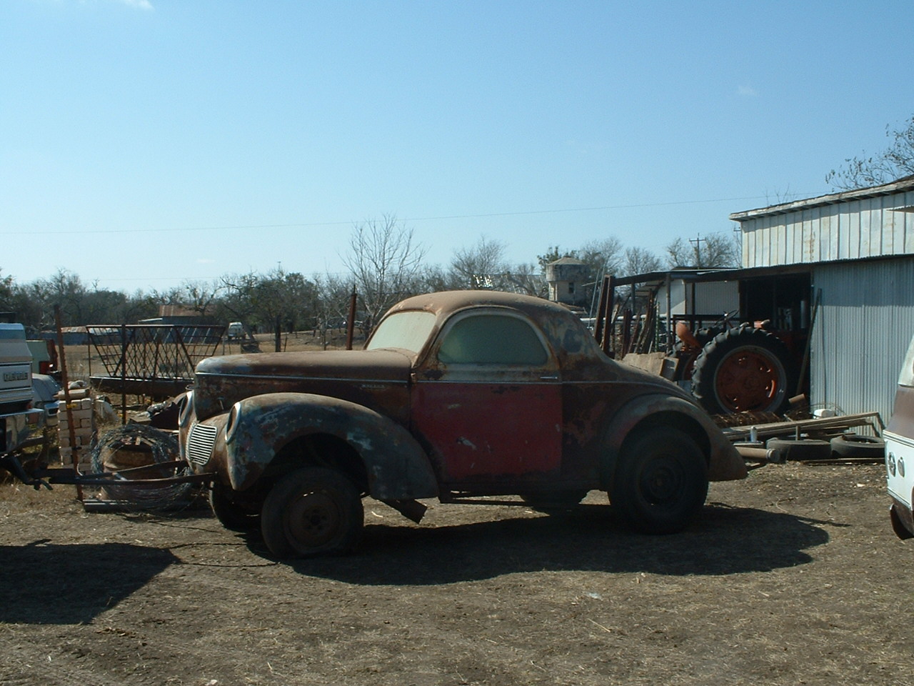

    Thanks guys, Here is a Pic when I pulled it out of the barn to start the rebuild.
  7. ME.GASSER
    Joined: Sep 18, 2007
    Posts: 3,627
    ME.GASSER
    That is so cool!! Give us some history on it if you can.

    Thank You,
    Only history I have is that my Dad built it in the 60's. Has a 371 Olds with Hilborn injection and a B&M Hydro. Been in San Antonio area forever.

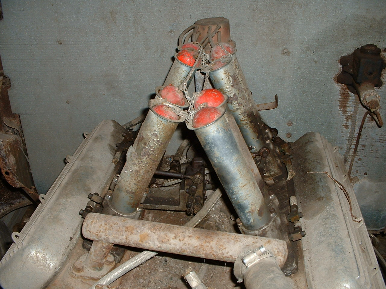

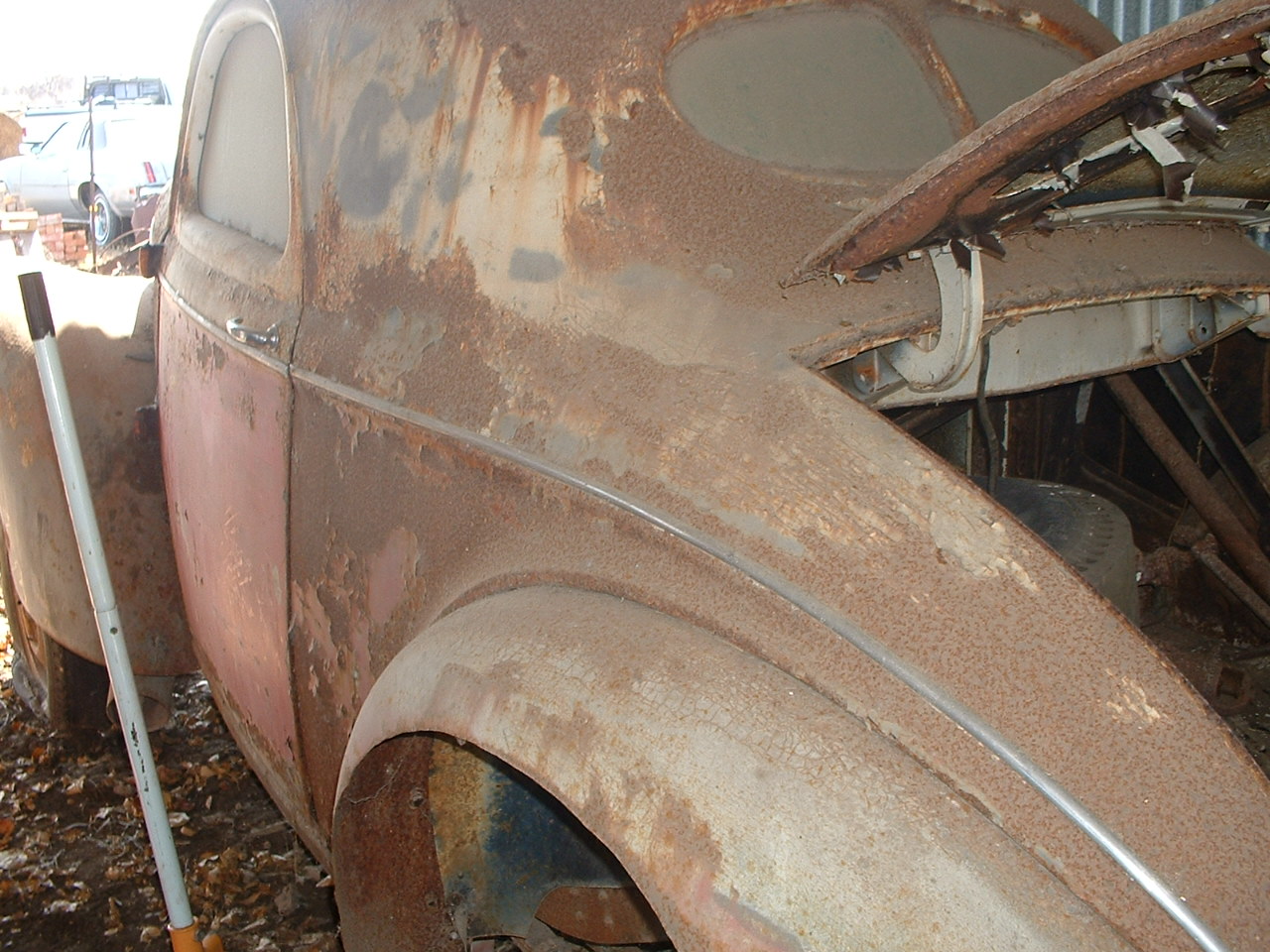

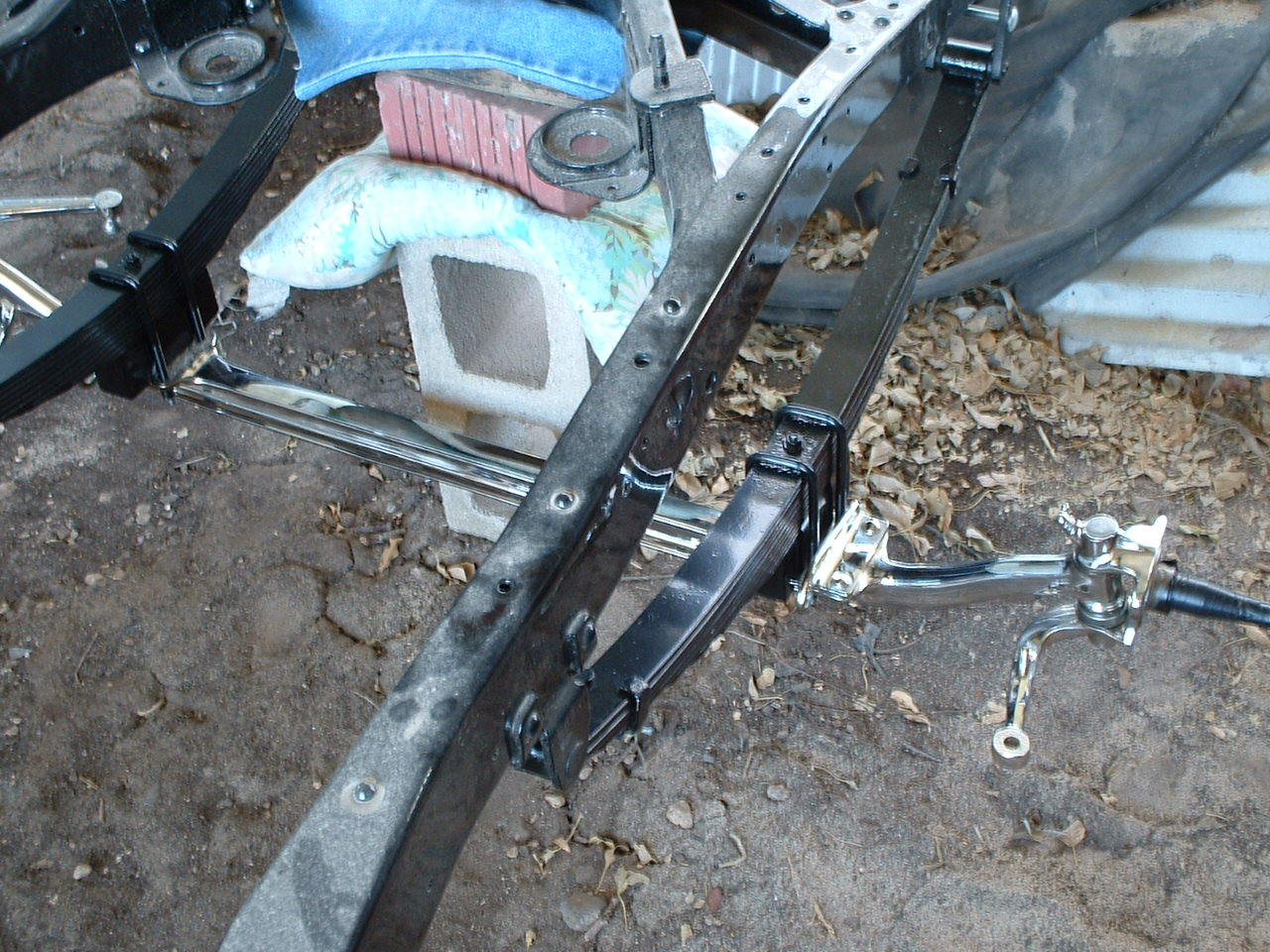

    Here is some more pics of the car.
    One you can see that it is a pretty decent body.
    One is what I found when I opened the hood!
    One is when I was boxing the original frame.

    A suggestion for your frame boxing plates.....I narrrow mine so that a slight interference fit holds them INSIDE the "C" channel of the frame. Inset them
    1/8th inch. Doing this leaves you a nice solid edge/corner for a strong weld.
    Plus, it strengthens the frame considerably over a welded plate. Also, I used
    .100 thick material.....a closer match to the original frame material, and a bit
    easier to cut, shape, fit, than .125. Good luck....been there/done that.
