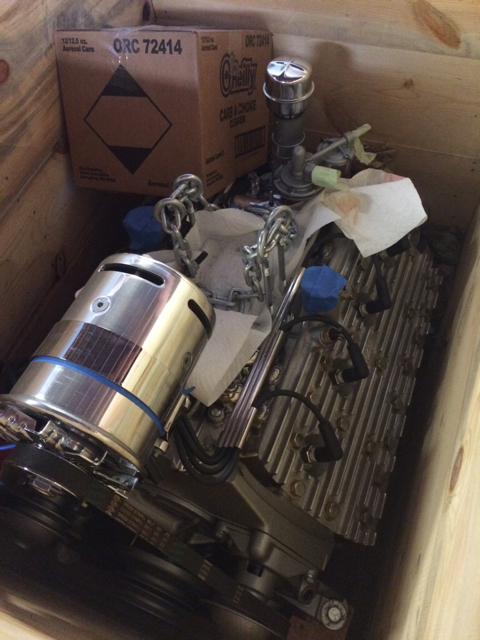

  13. sluggo1936
    Joined: Feb 28, 2012
    Posts: 46
    sluggo1936
    from Colorado
    Thanks Ol!! I appreciate everyone's suggestions! Here's the 31 cuz everyone likes pics! ImageUploadedByH.A.M.B.1423509885.839887.jpg ImageUploadedByH.A.M.B.1423509937.070839.jpg ImageUploadedByH.A.M.B.1423510000.210121.jpg ImageUploadedByH.A.M.B.1423510028.448775.jpg
