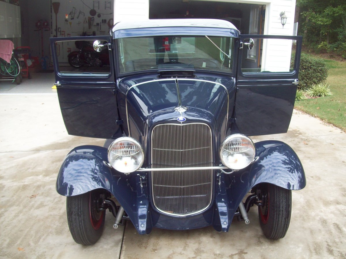

    When I did this one, it was a stock Model A 4 piece hood. I set the grille to match the hood then mounted it. I had to pull the light bar slightly forward. I hooked a come a long to the bar and a pole and slowly worked it forward

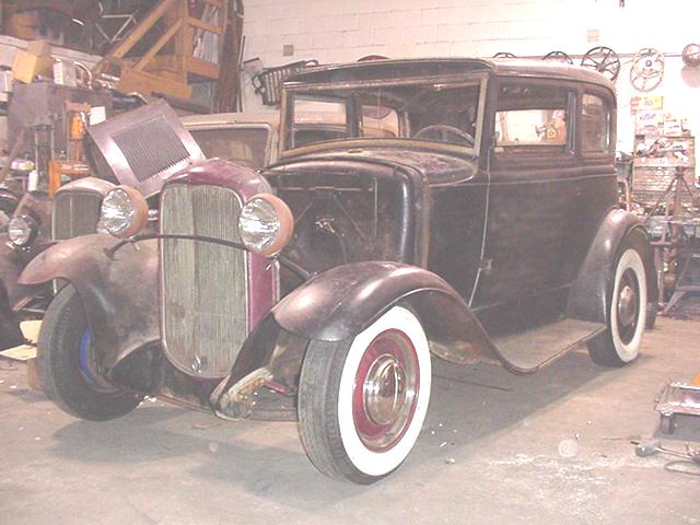

    heres mine, I had to cut the bottom corners a little to fit over the crossmember.
