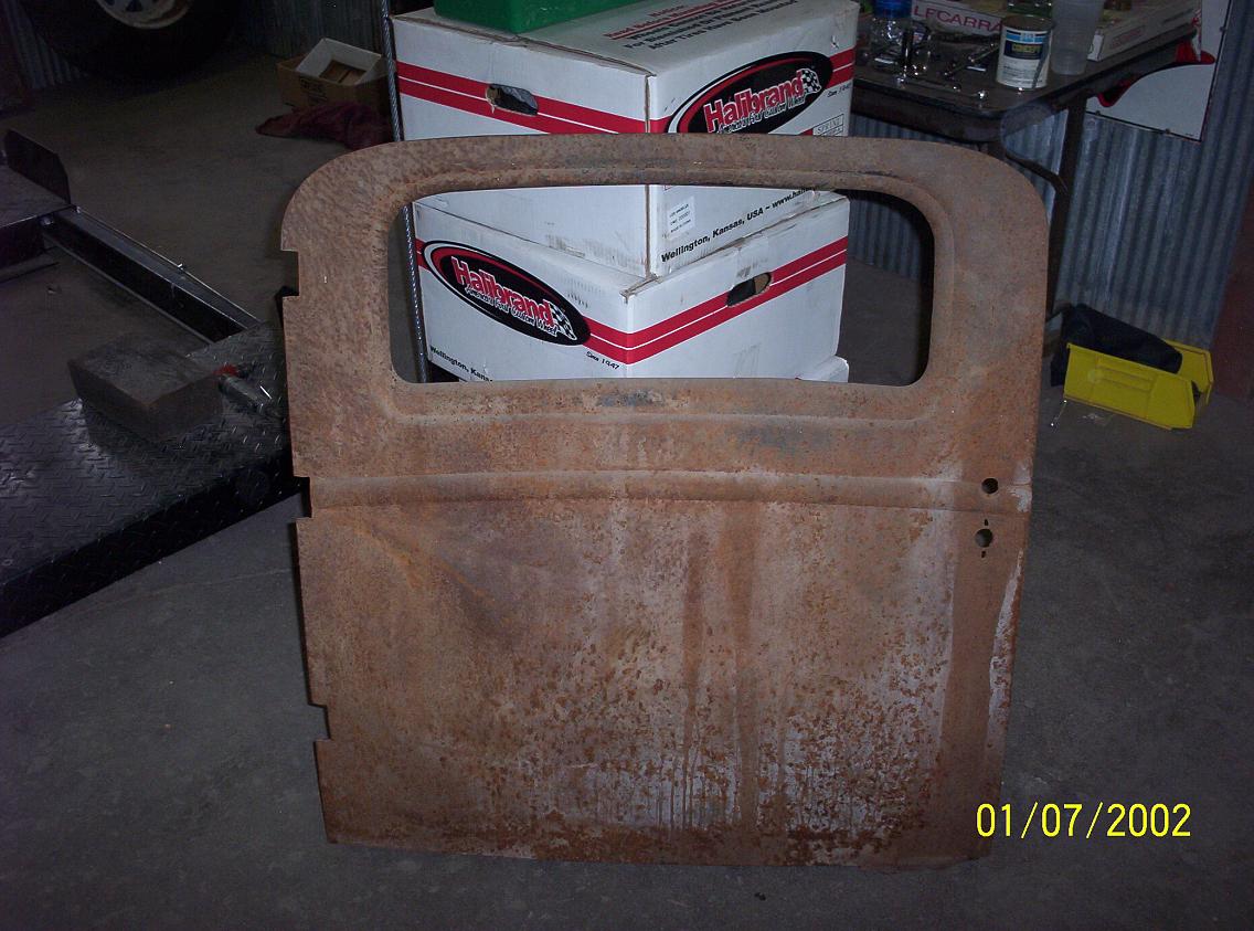

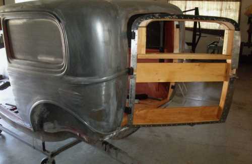

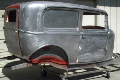

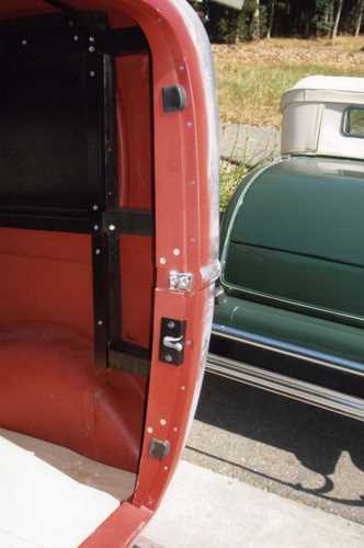

    Here is my friends new man made delivery with a kit from Doug McRae in Kansas. Jim Hendricks did the super metal work exactly like Henry did it. The rear latch and key are very difficult to duplicate. George made the latch and Jim made the die for the dimple in the belt line. No extra rear panel was needed or used by Ford.
    Nice work.

    I was told by the shop in Mich that he used the sedan rear panel cut oversize to make the door and added metal to the body to make the jam. You can see that process on their website. I have always assumed that Henry would use a center body section to make the door and just fold the body tin around the jam, it would have made the job easier. How stupid of me to have assumed that. Thankyou Pew for enlightening me.

    By the way not all 32 deliveries had the dimple for the rear lock. I saw both styles of rear door last week on original 32 deliveries.
