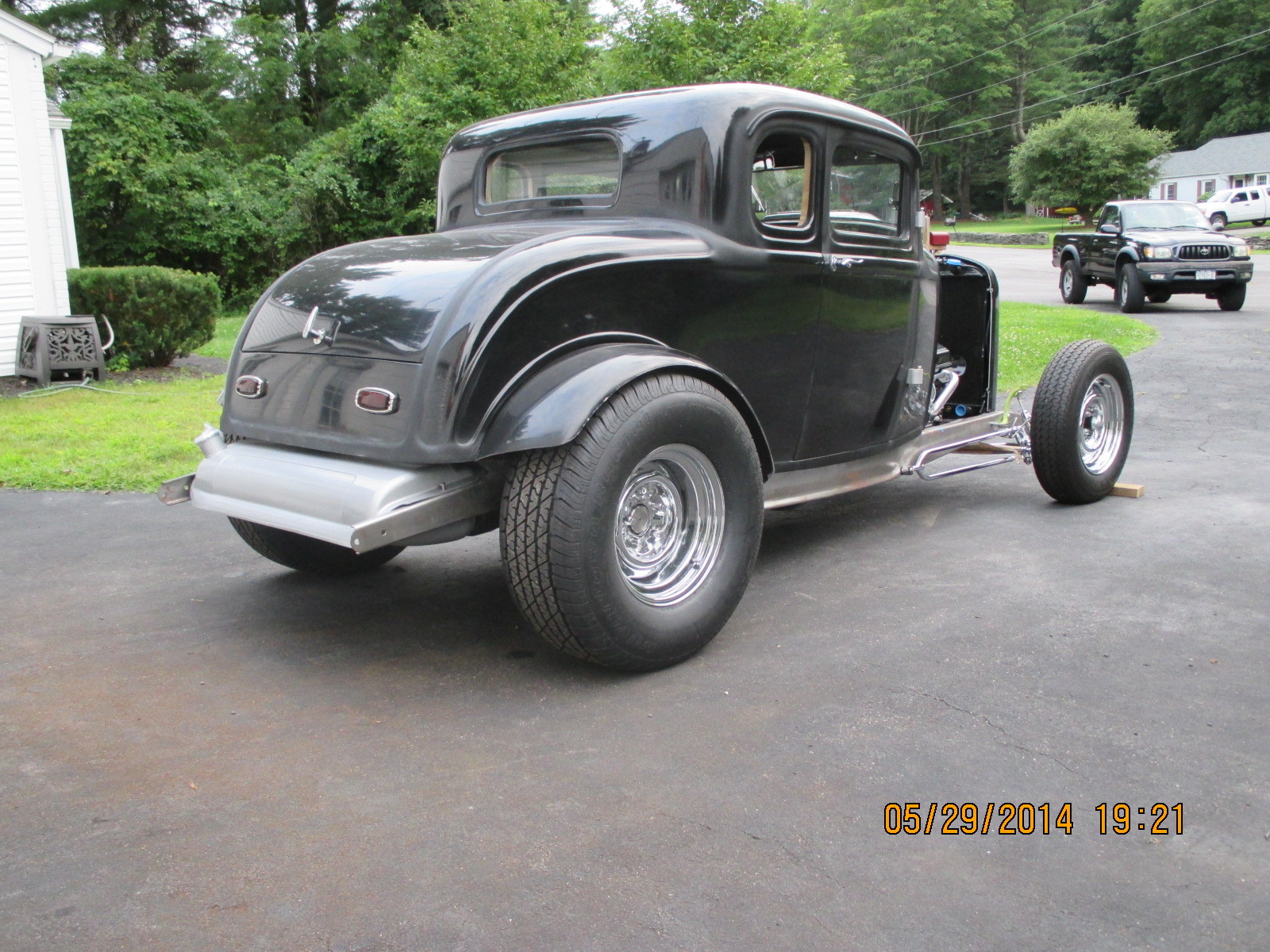

    Good to know. My plan for now is to finish the chassis mock up this summer and fall, blow the chassis apart for final welding and detailing, and paint it over the winter. For now, I'm planning on putting the body, unpainted, back on to drive it next summer and do the bodywork then, and then paint the body the following winter...this is plan A

    If you are going to put stock type windlace around your doors, you may want to pay attention to the gaps. I had the guy that is going to do the interior on my pos glass body come over to have a look-see and he said that unless I wanted to run really big windlace that I would have to close the gap up. I built the interior edges up so I could use the standard 3/8" windlace. I know the body that you have is far superior to mine, but the gaps in the pics look pretty big. Not being critical, just trying to help. Dennis D

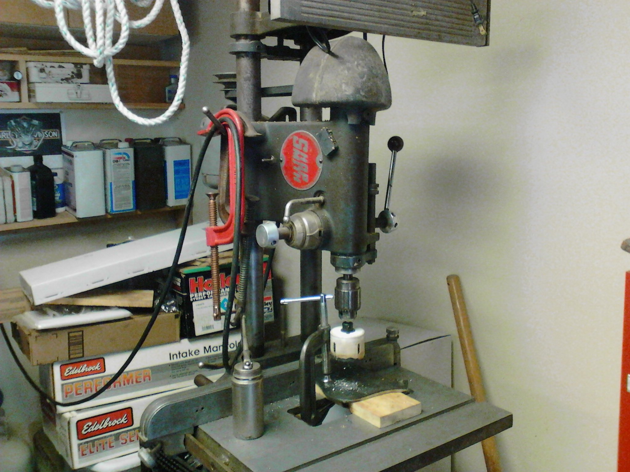

    IMG_20140716_161845.jpg My old man's (RIP) Shopsmith model 10e, made between 1949-1953. Still used and abused daily.

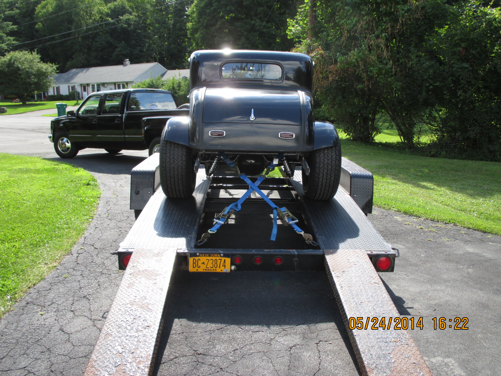

    Jig made from an old bed frame to hold engine in place so I can trailer the car to the welders for motor mount install. Also holds engine in correct position for welding.

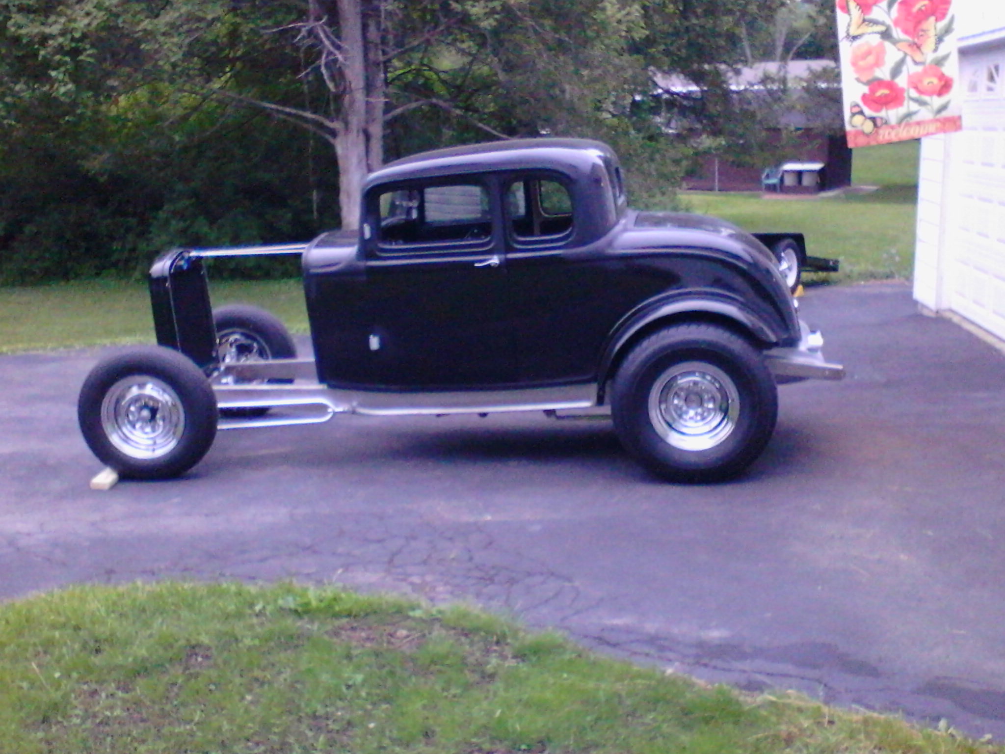

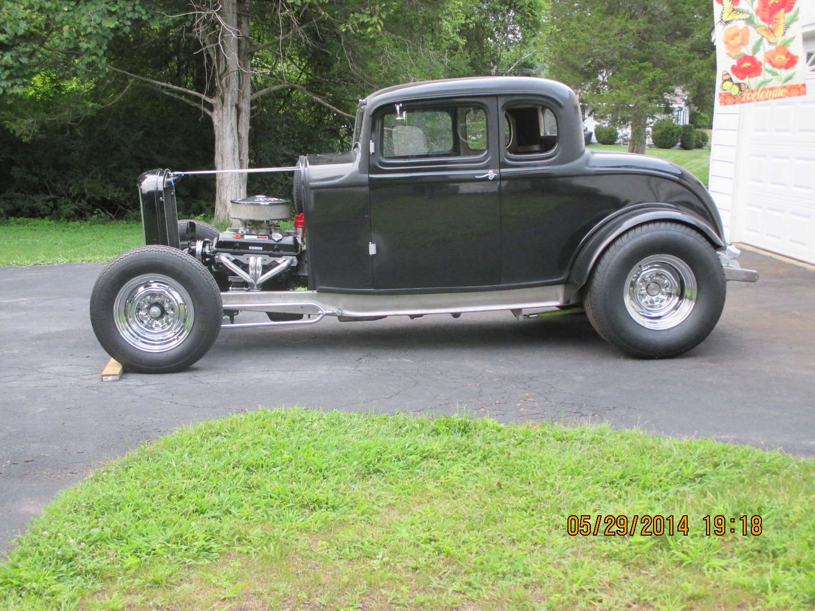

    Changed the rear coilovers from Carrera's with a 11" installed height to a QA1 with and 8" installed height and got it down a little further. The old coilovers, even with the spring adjustment backed off all the way, where too high and left to much of a gap between the tire and fender. For my taste anyway. Plus the longer shock, when backed off all the way was no longer in the correct position to correctly utilize the stroke of the shock. Since the car was now so much lower I had to relocate the panhard bar mount from the top of the differential, to the side of the diff for trunk floor clearance. I shortened the panhard bar and rethreaded it. I may actually have to cut the trunk floor for a little more differential to trunk floor clearance, and put in a hump. We will see.
    Top picture is with the old shocks, bottom with the new. Thinking I will bring the rear back up just a little.

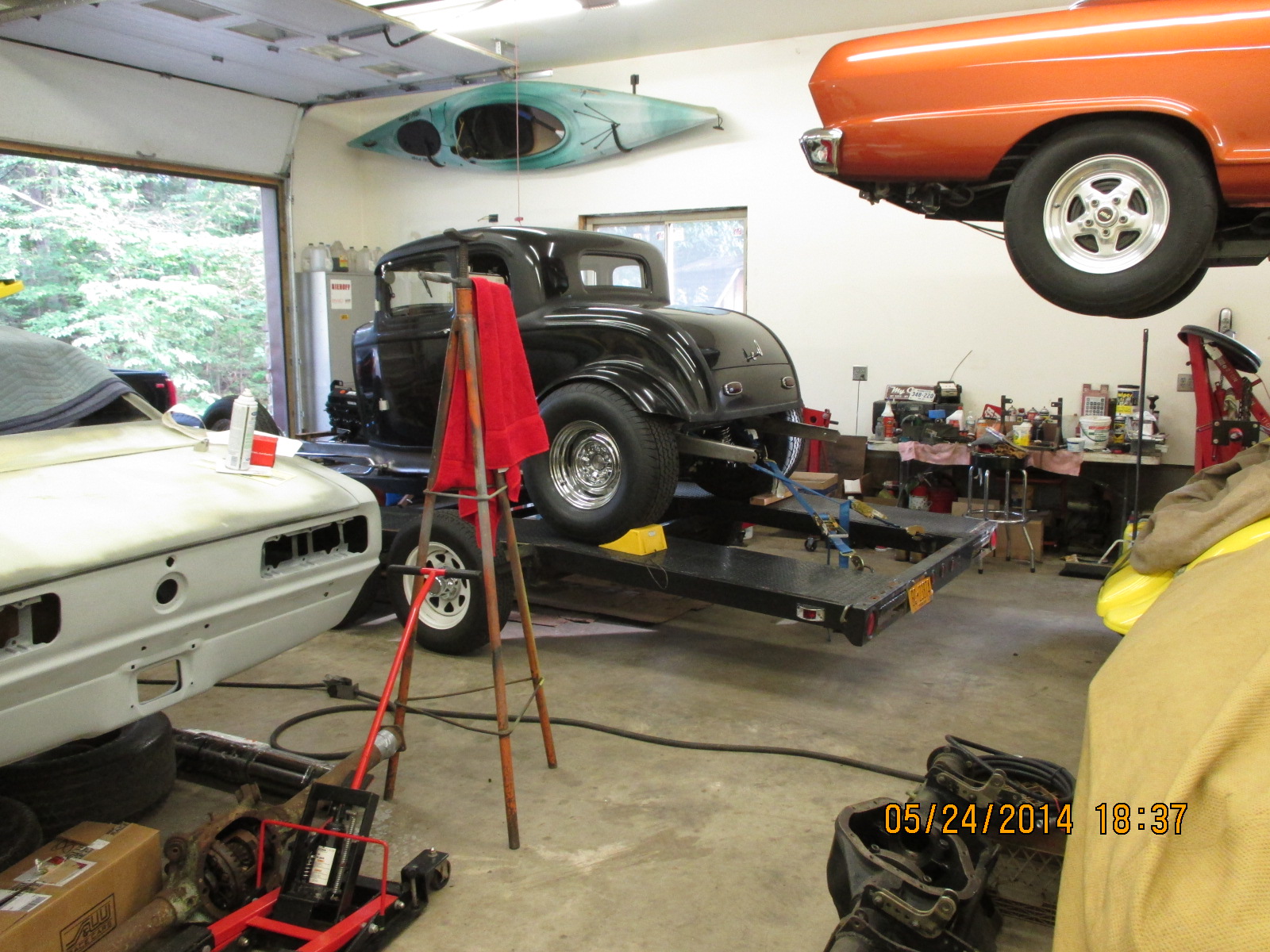

    20140524_162240.jpg 20140524_183716.jpg Loaded up and headed to get the motor mounts welded.

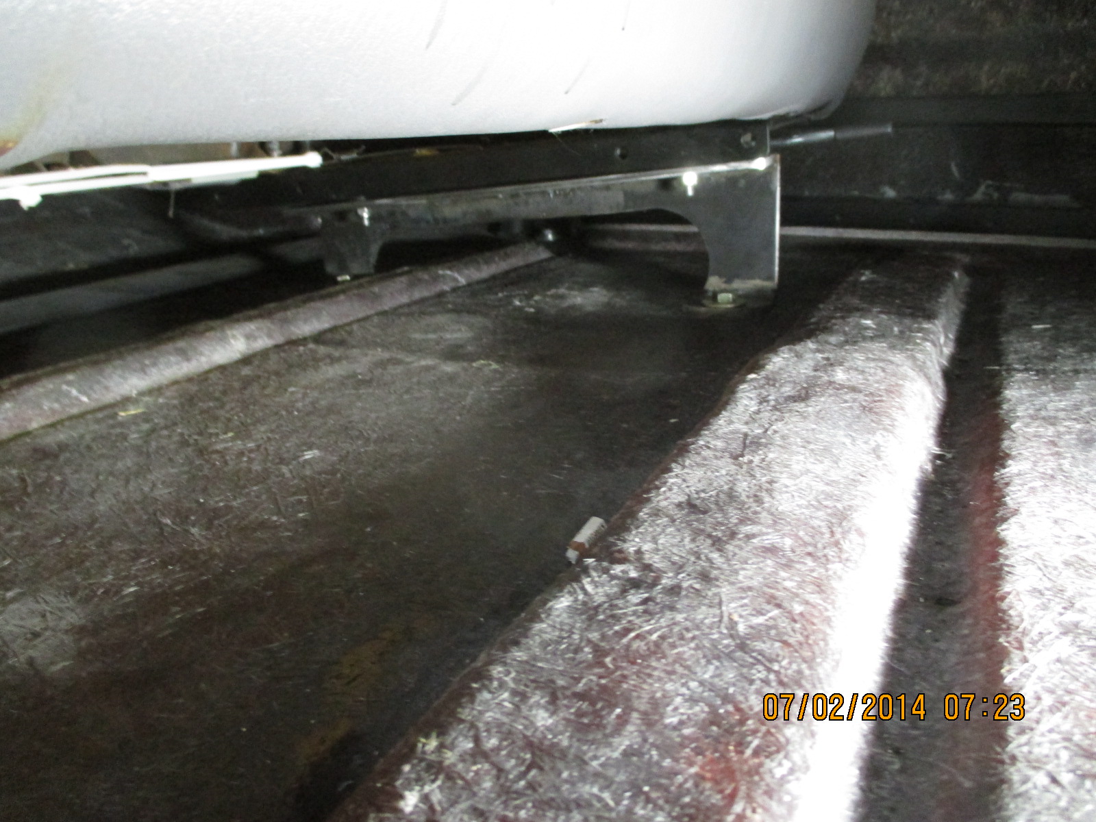

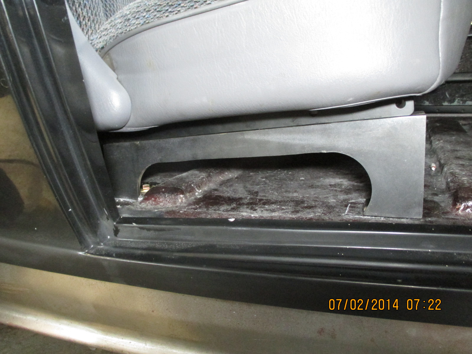

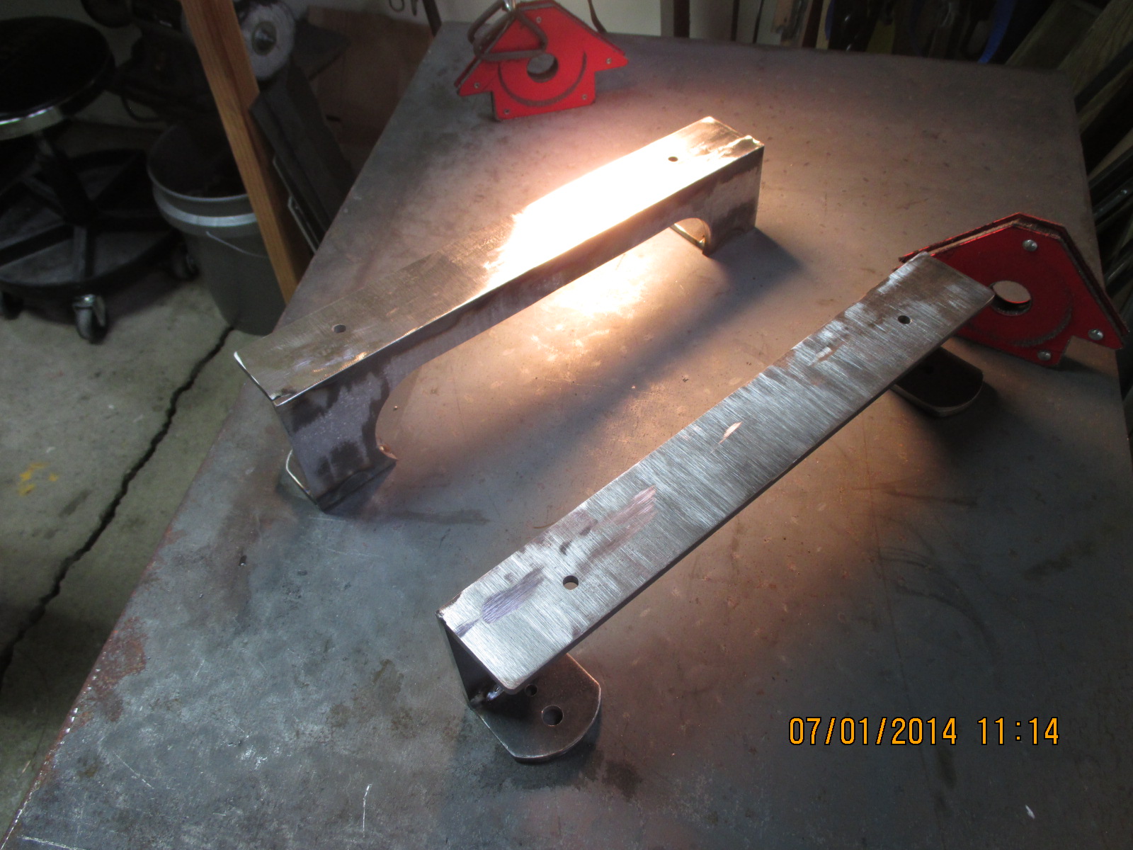

    Seat mounts.

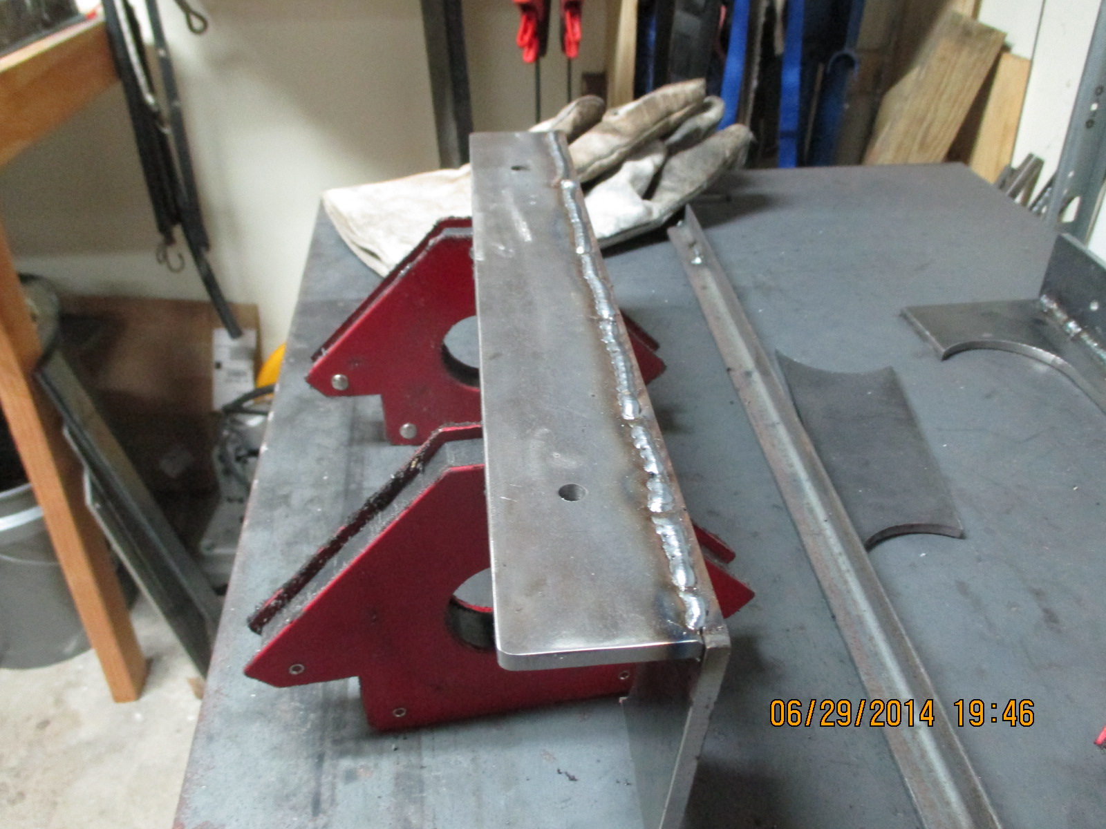

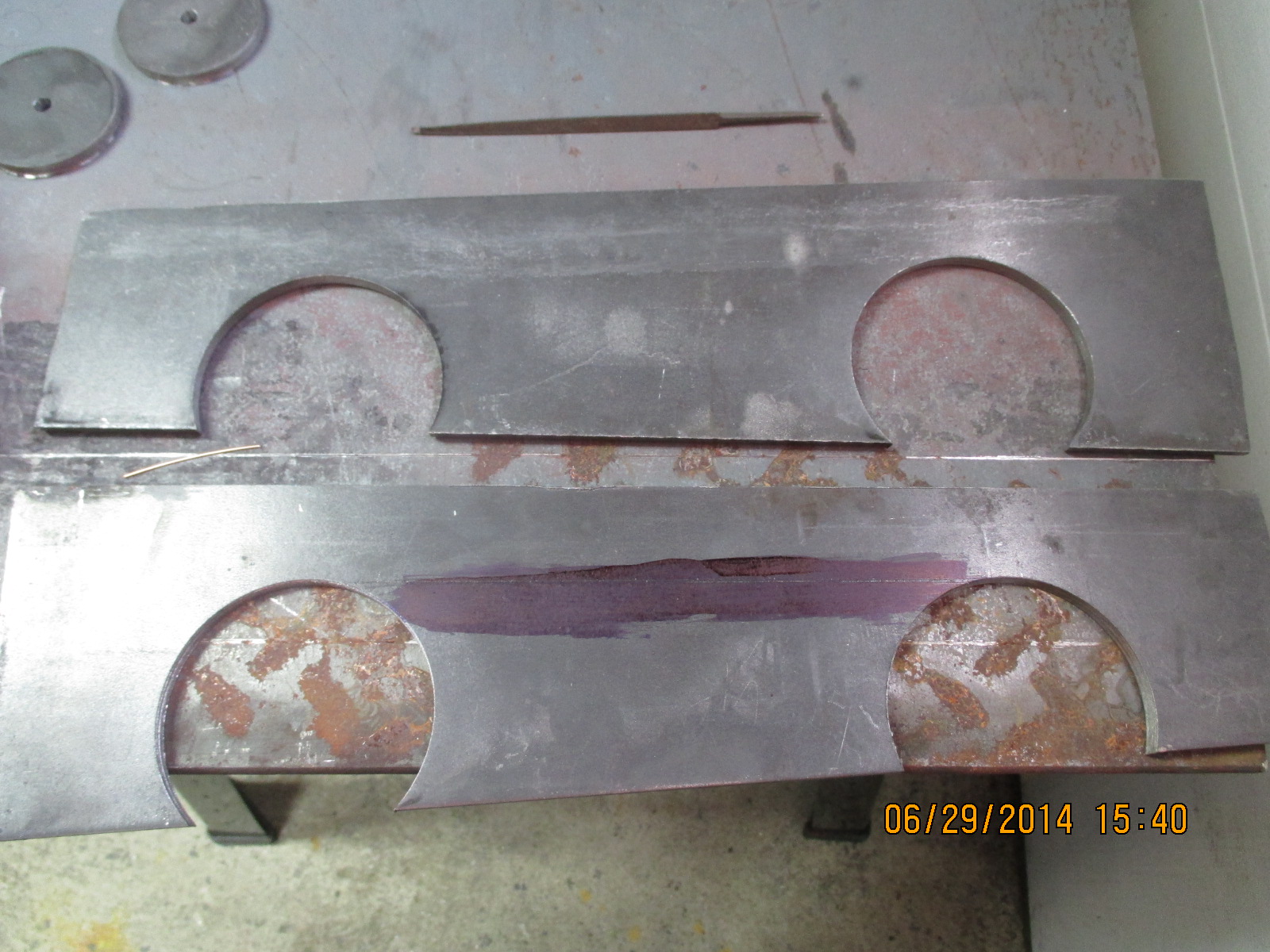

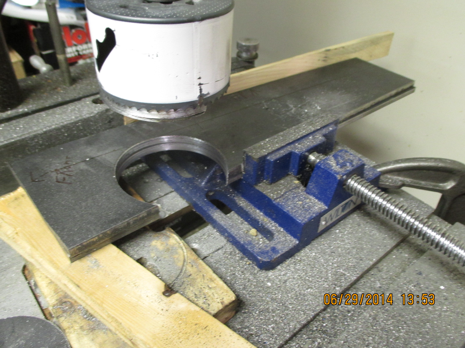

    2" flarbar welded to top. cut out the middle with a jigsaw and a couple of blades...
  21. Novaron
    Joined: Mar 12, 2010
    Posts: 188
    Novaron
    from New York
    Tabs made from the circles I cut out.

    Mounted with washers for now. I will add welded in tabs to the crossmember later when the body comes off for paint.

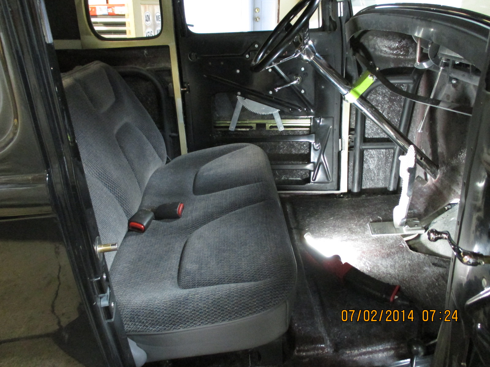

    ...Limeworks 32" hotrod column, 4" limeworks drop, Grant 13.5" Classic Cruzin 502 wheel with 3.5" dish.
  24. Novaron
    Posts: 188
    Novaron
    from New York
    Plenty of clearance.

    Next up is Moon pedal linkage and getting the brake pedal squared away. Kind of weird its mounted on the Lucky 7 frame on the left side of the column, where the clutch would be. I mounted the column high enough to clear the brake pedal which is a Harley brake pedal from an older project. 20140702_072415.jpg
