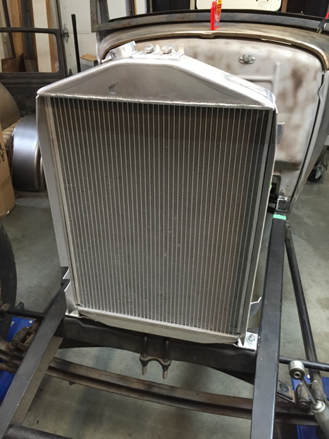

    So wondering if anyone has a suggestion on the type of paint to paint the rad. I wanted the performance advantage of aluminum but don't want the look so will be painting black. ImageUploadedByH.A.M.B.1448253789.001246.jpg

    A couple of options... There is a few threads on the subject and Eastwood makes it for the purpose in flat or gloss.
    http://www.eastwood.com/eastwood-radiator-black-paint.html
    http://www.jalopyjournal.com/forum/threads/ok-to-paint-an-aluminum-radiator-black.712059/
    http://www.jalopyjournal.com/forum/threads/painting-an-aluminum-radiator.990310/
    http://www.jalopyjournal.com/forum/...-aluminum-radiator-cooling-efficiency.151362/

    Our Radiator black was formulated to give the correct "sheen" as found on classic cars especially 30's-40's cars. I use it on all of my builds to hide an aluminum rad! P.S.- We're an alliance member

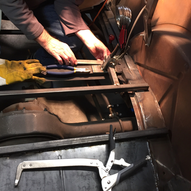

    Been working on the trunk and designing the floor. After humming around different ideas we decided to build a raised area by welding in the 1x1. We will put in separate pans in front of and behind and the have a piece that lays over top with a bit of a curve. Perhaps a little more complicated than needed to be but wanted to do our own thing. Looked at the "humps" you can buy but not a fan of the look. The front 1x1 will be the landing for the gas tank as well. Looking at it tonight I think I will build out more frame going towards the seat to support the tank better. Also got the hurst motor mount I bought off stogy this week. Sandblasted nice and clean. Not a lot of factory welds on it so thought I would throw a few more on. Needs to be able to handle the 700hp small block that it will be bolted to...... Okay probably more like 450, I don't want to get into too much trouble but still, a few more welds made me feel better AND I like my welder! Ha ha

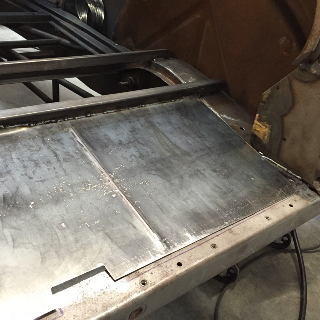

    Progress report! Got the back trunk pan fitted and burned in today and built out more frame where the fuel tank is going to sit. We went with 16 gauge for the floor pans, perhaps a little overkill but with just the two beads we rolled in that pan, it has very little flex. The flat pan that will go on top of the raised frame we built will be removable. Was thinking fastening with heavy machine screws. Anyone have a better suggestion? Best part of the build still continues to be Sunday's doing this work with dad! He is having lots of fun though he wouldn't ever come out and say it. I get a little bit of work done during the week but not much between work and family. Would love to take a couple weeks off and see how much work I could accomplish in that time without interruption. You know you're an addict when you dream of taking time off to work on the car!
