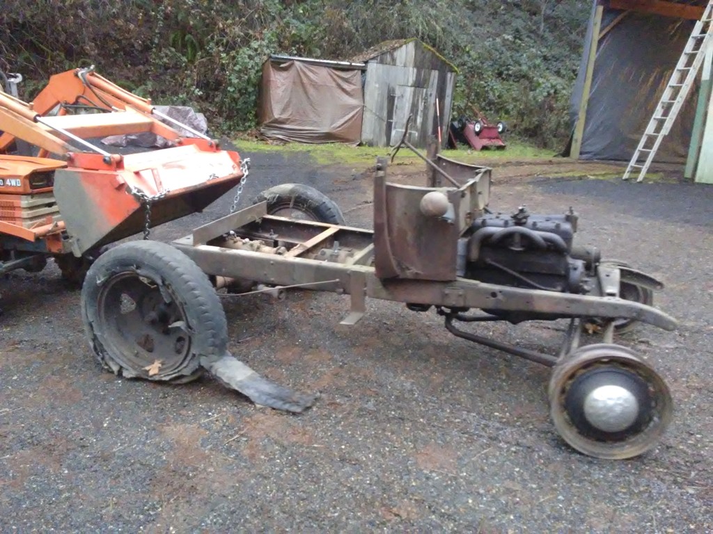

    The doodlebug when we first started on it;

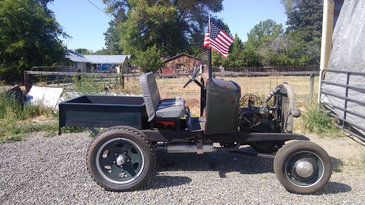

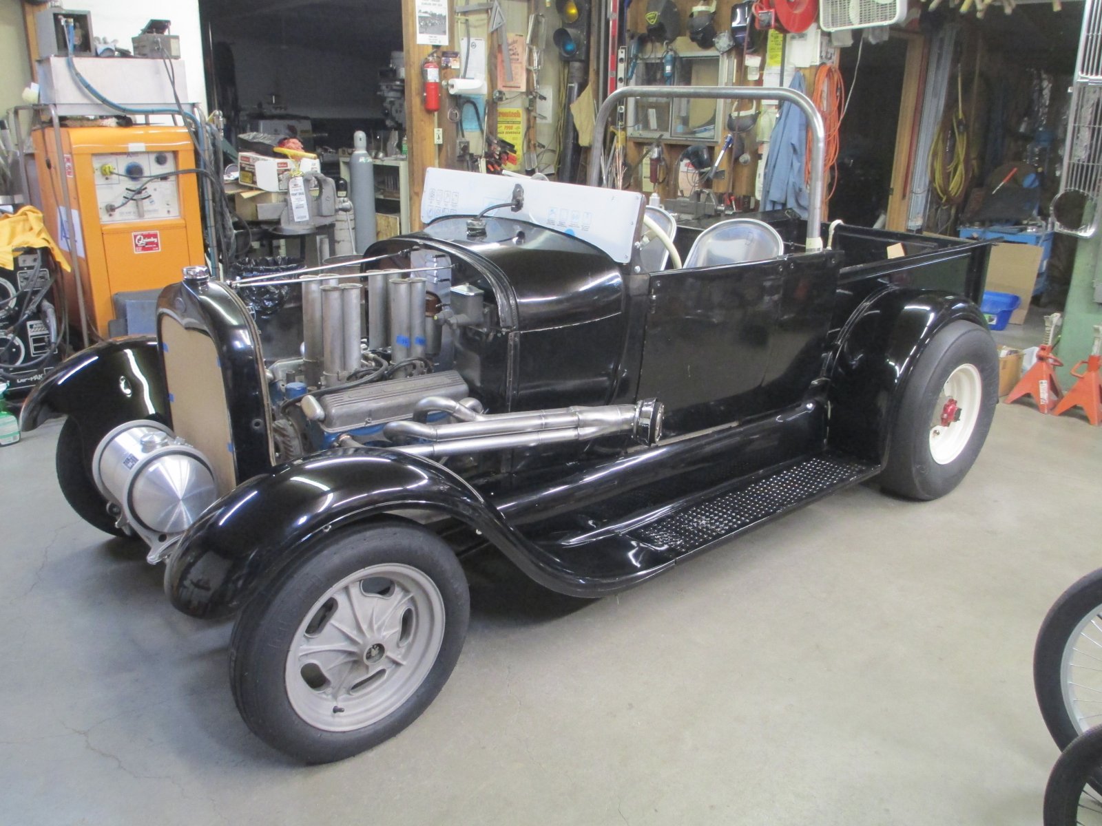

    Doodlebug completed and ready for parades and local cruises, it only took 6 years to get here;

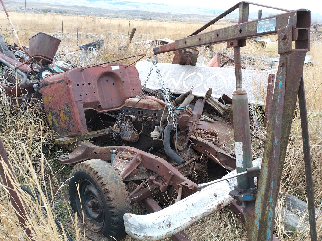

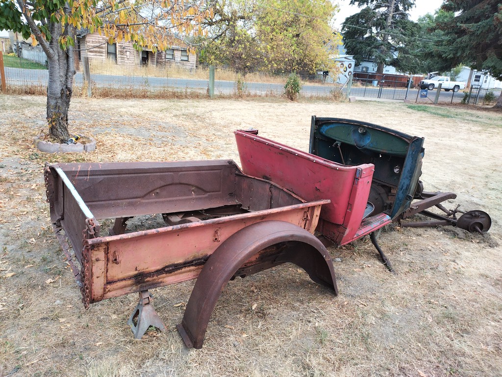

    The RPU project begins;
    IMG_20220922_151200_HDR-XL.jpg IMG_20220922_134627_HDR-XL.jpg IMG_20220922_132359_HDR-XL.jpg

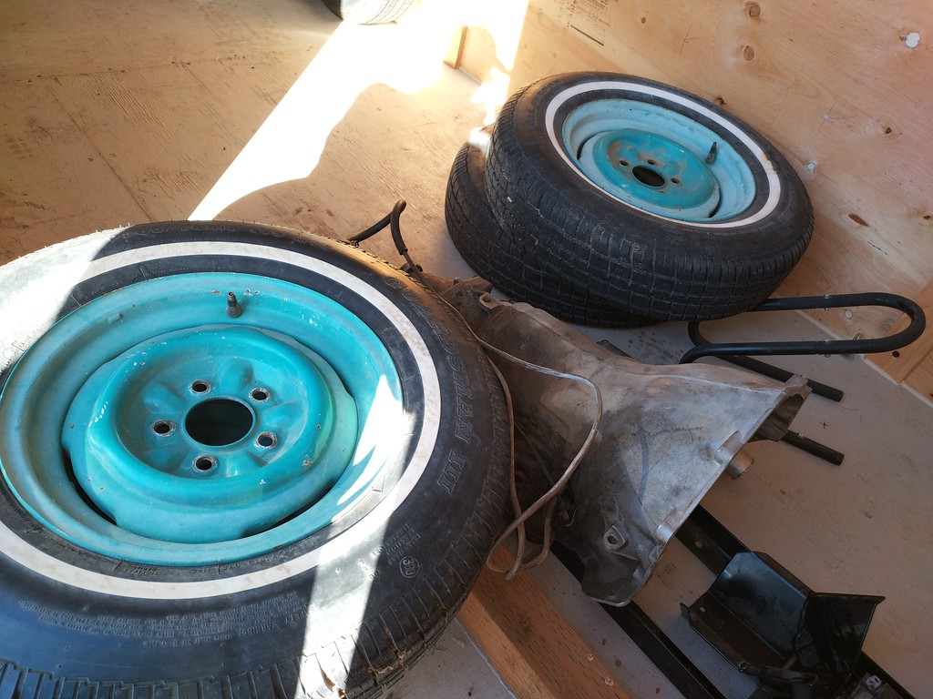

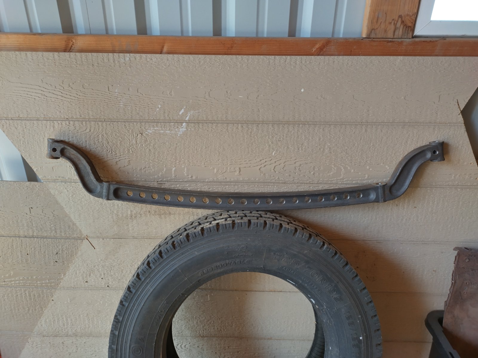

    The engine will be a '60 truck 283 we salvaged from a ranch in the Keating Valley, it will be rebuilt, have power pack heads, a single 4 barrel, possibly a Duntov cam and not sure about exhaust yet.
    Transmission will be a TH350 that we horse traded for and the rear end is out of an S10 with rear disc brakes.
    Front axle is a Speedway drilled drop axle, a factory second bought cheap. Wheels are from a 56 Chevy.
    A few more pics of these various parts are attached. 283 1.jpg 283 2.jpg rear end 1.jpg rear end 2.jpg rear end 4.jpg wheels and th350.jpg

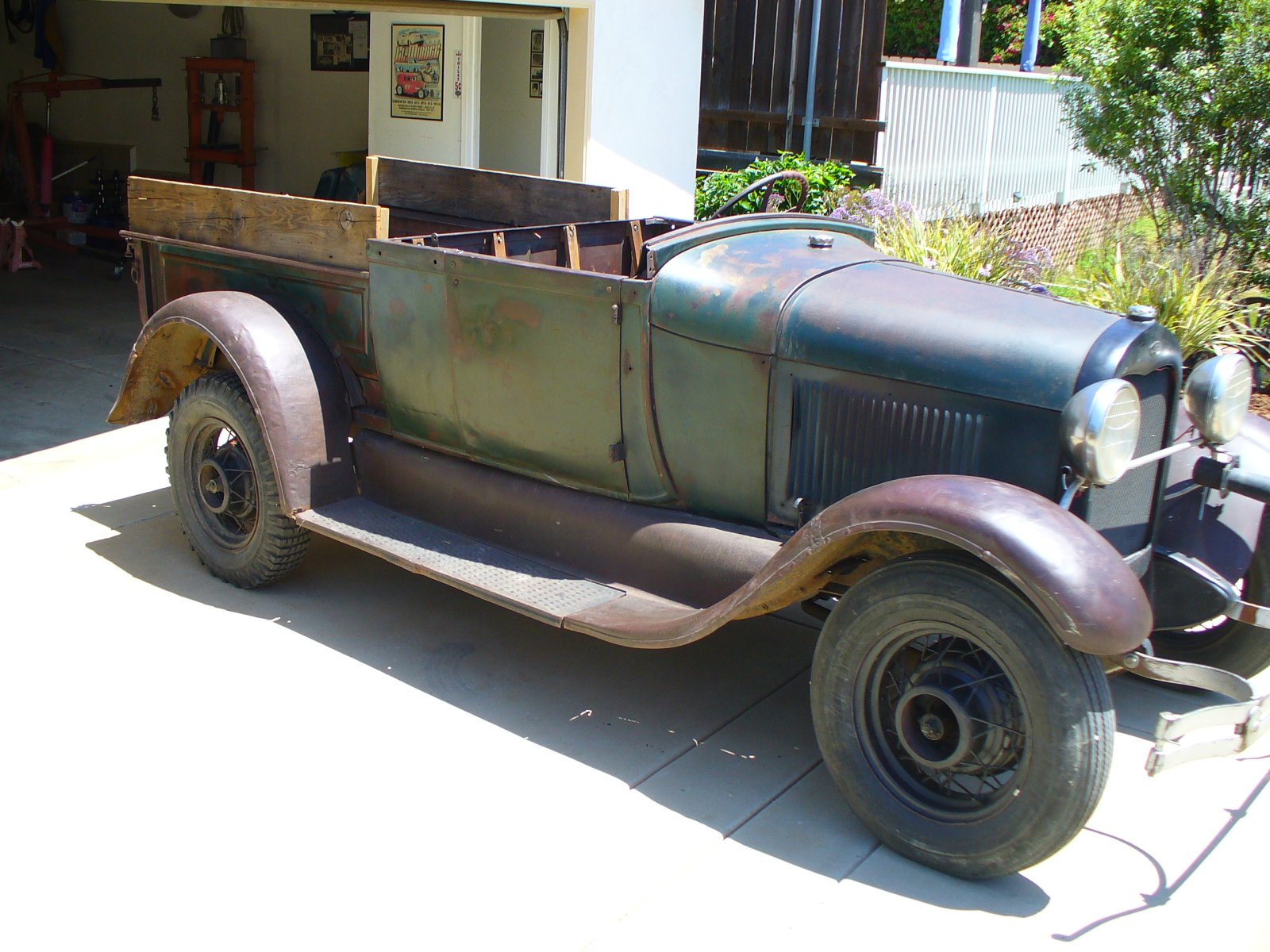

    I'll be following your story. I'm in the same situation. I quit racing, and had to have something to do. Facebook Market Place forced me to bring this one home. roadster pickup 001.JPG

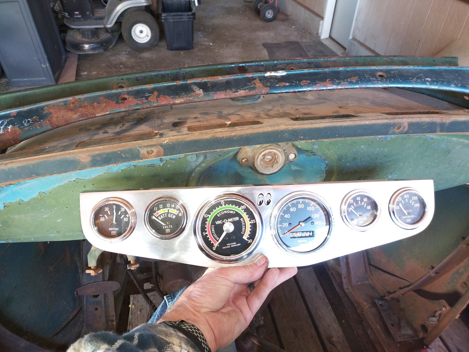

    Attached is a pic of the gauge cluster I'm planning to use. My brother found it at a garage sale a couple years ago. It's been sitting on the workbench since then, taunting me to build something to put it in. IMG_20221012_152235.jpg

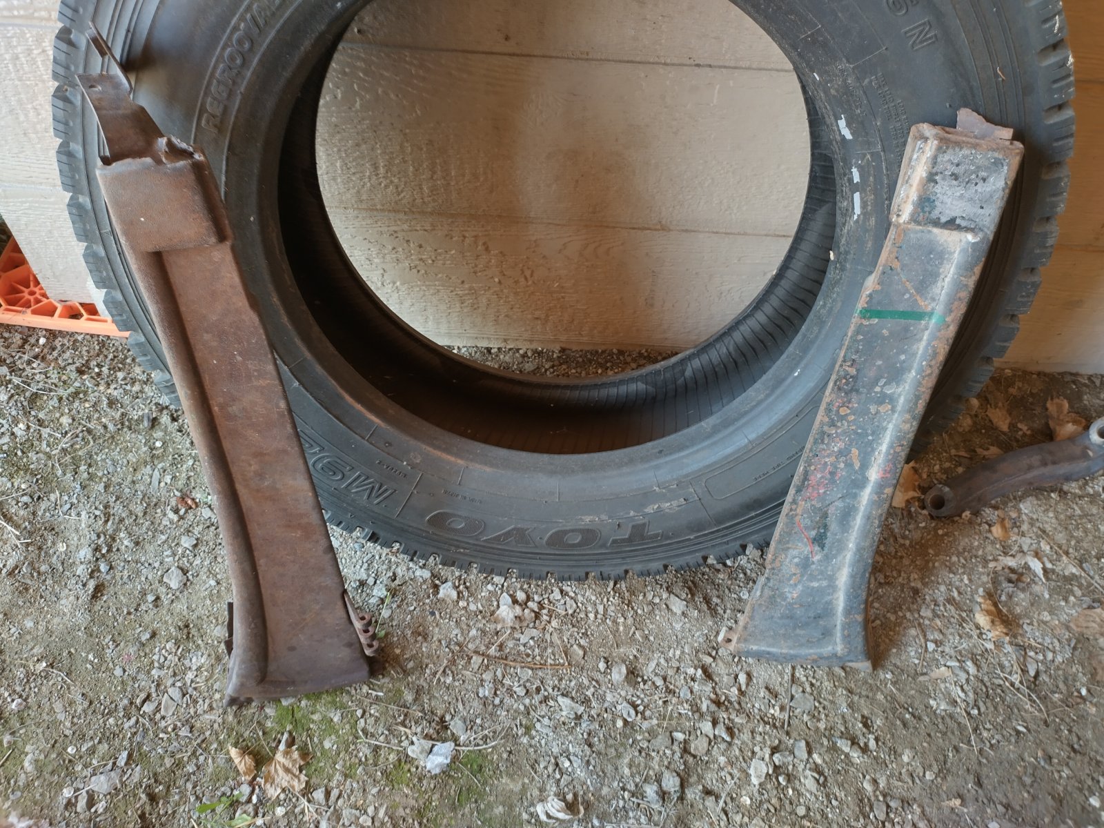

    So far this project has been parts gathering and trying to do that in a meaningful way. In other words, as I try to find parts and pieces, get things I'll actually use and not just end up on a shelf. The drivetrain is pretty well set; 283 power pack, TH350 and S10 disc brake rear with parallel leaf springs. The front suspension will be the Speedway drop axle and components as needed to have Chevy bolt pattern and small disc brakes.
    The body, as it sits right now, is a decent closed car cowl that will be converted to open car with the appropriate pieces, roadster doors (have decent LH door and crusty RH, but Martinbuilt just sold me a decent RH), a Phaeton forward tub half and a somewhat crusty but savable pickup bed.
    The biggest question is how to make the Phaeton body piece look right and possibly get rid of the weird "Step" where the rear doors would have bolted on. Cutting and welding sounds simple enough, but has anyone done this before? Pitfalls? Pros and cons?
    BTW, I did talk to a guy at the Idaho swap meet (at Firebird drag strip), he said he had an RPU rear body section and had just sold it when I got there. He said he sold it for $100. I didn't fall to my knees and start crying, but almost. Sigh.

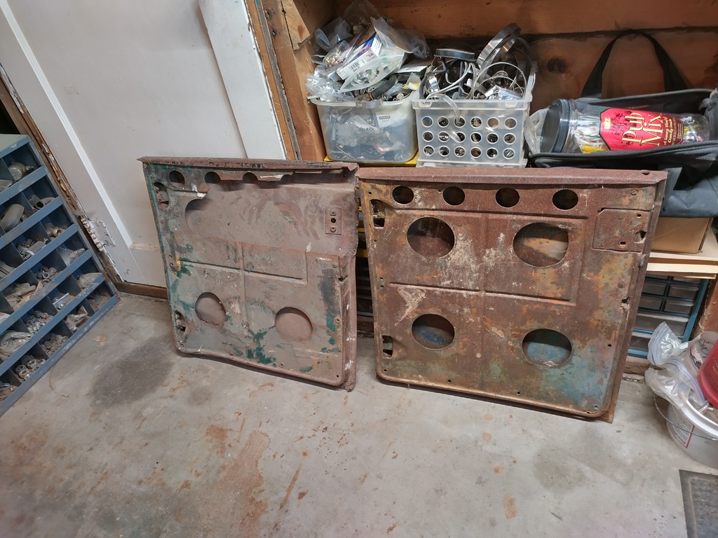

    RPU RH Door outer.jpg Bought a right hand roadster door from @Martinbuilt and it is far better than the one I had. I'm very appreciative and would never have made that connection without this forum. Door pics attached, you can easily see why the door from Martinbuilt is a big improvement.
