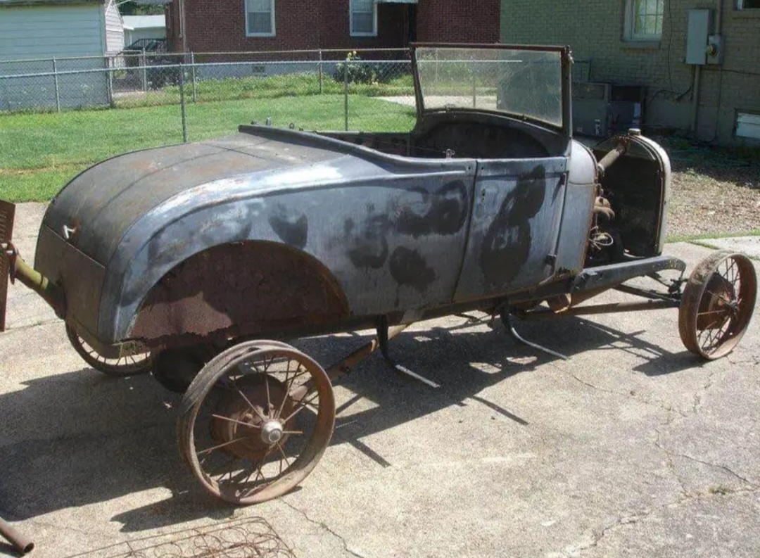

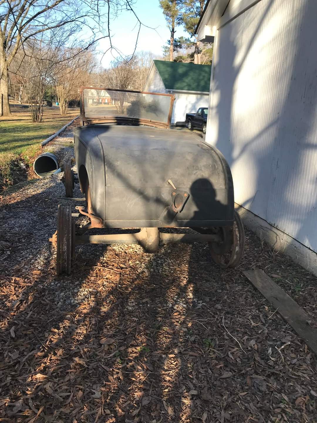

    This is the picture from the FB marketplace ad that made me fall in love with it.
    The other pictures from the ad are also here. Overall, it was a fairly solid car. It still needed attention but it was a good start.

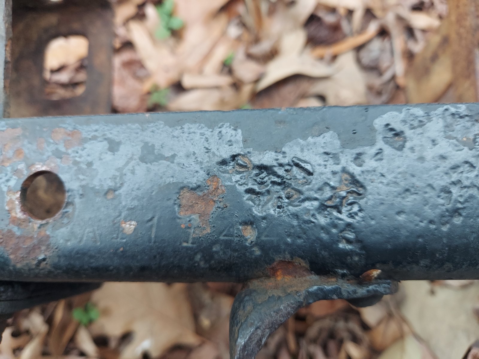

    Thanks to everyone for the warm welcomes. I did some digging and while I can't definitively confirm on the frame, I'm assuming it's very likely that everything is all original. Based on the ford garage website, it's an early '29 car.

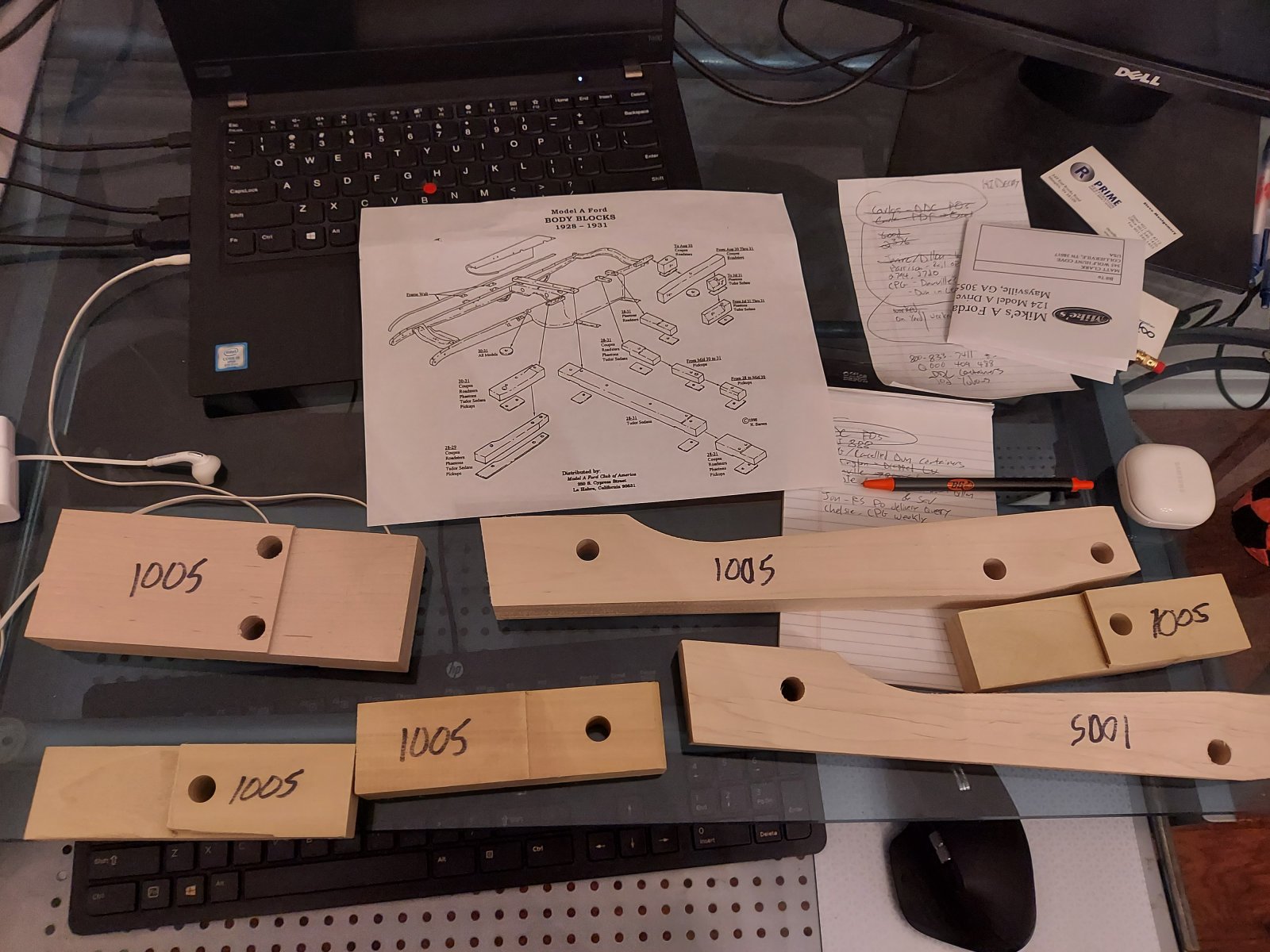

    I did also get some wood blocks to mount the body and start figuring out where that should be before it all gets blown apart.

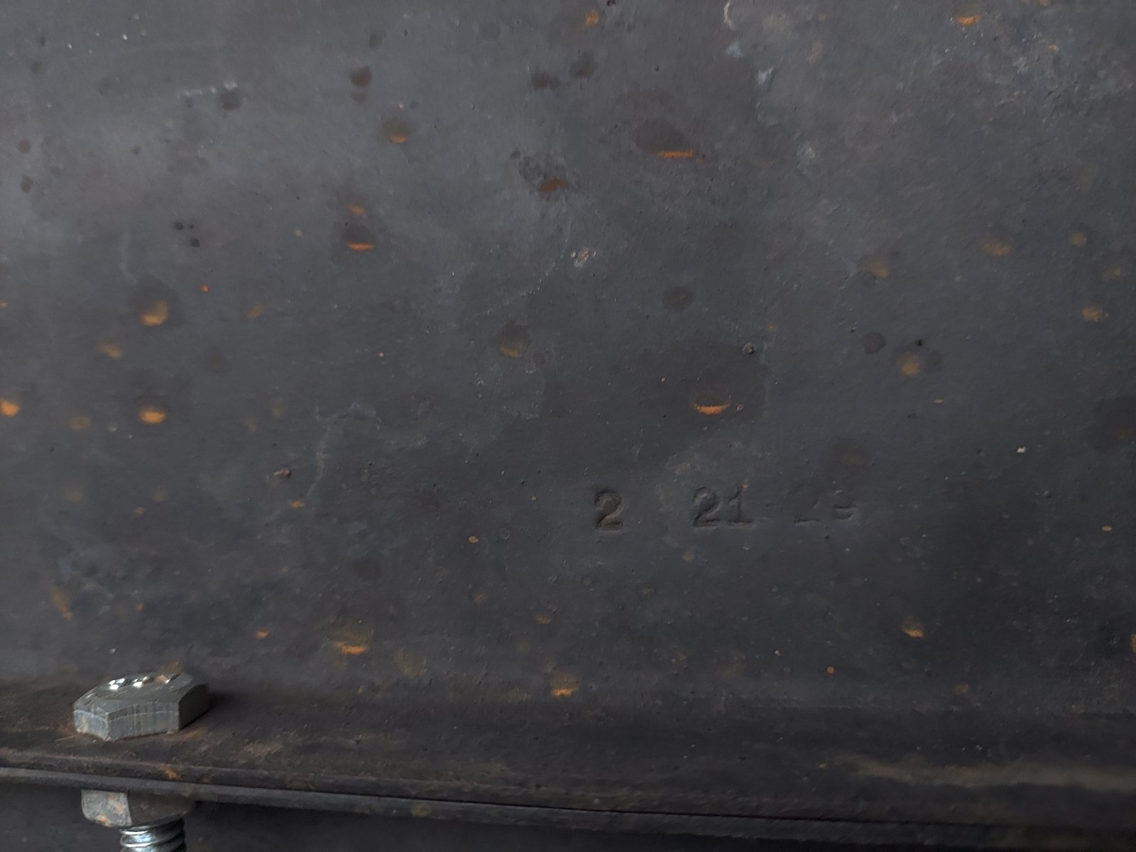

    Hey @ZerroHalfcup, can you share more about exactly where you found the serial number and date on the frame? Thanks!

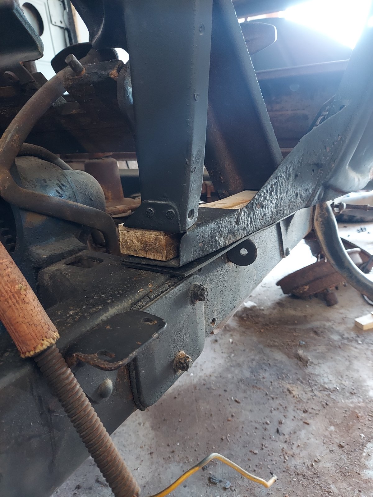

    For sure, mine was on top of the driver side frame rail, immediately after the two front bolt holes to mount the body. In the previous picture, the bracket that makes an L away from the frame is this rounded eyelet on the side of the frame below. The arrow is pointing to the area on top of the frame that it was stamped. You can see the inside of the engine mount in the previous picture as well. I hope this helps.

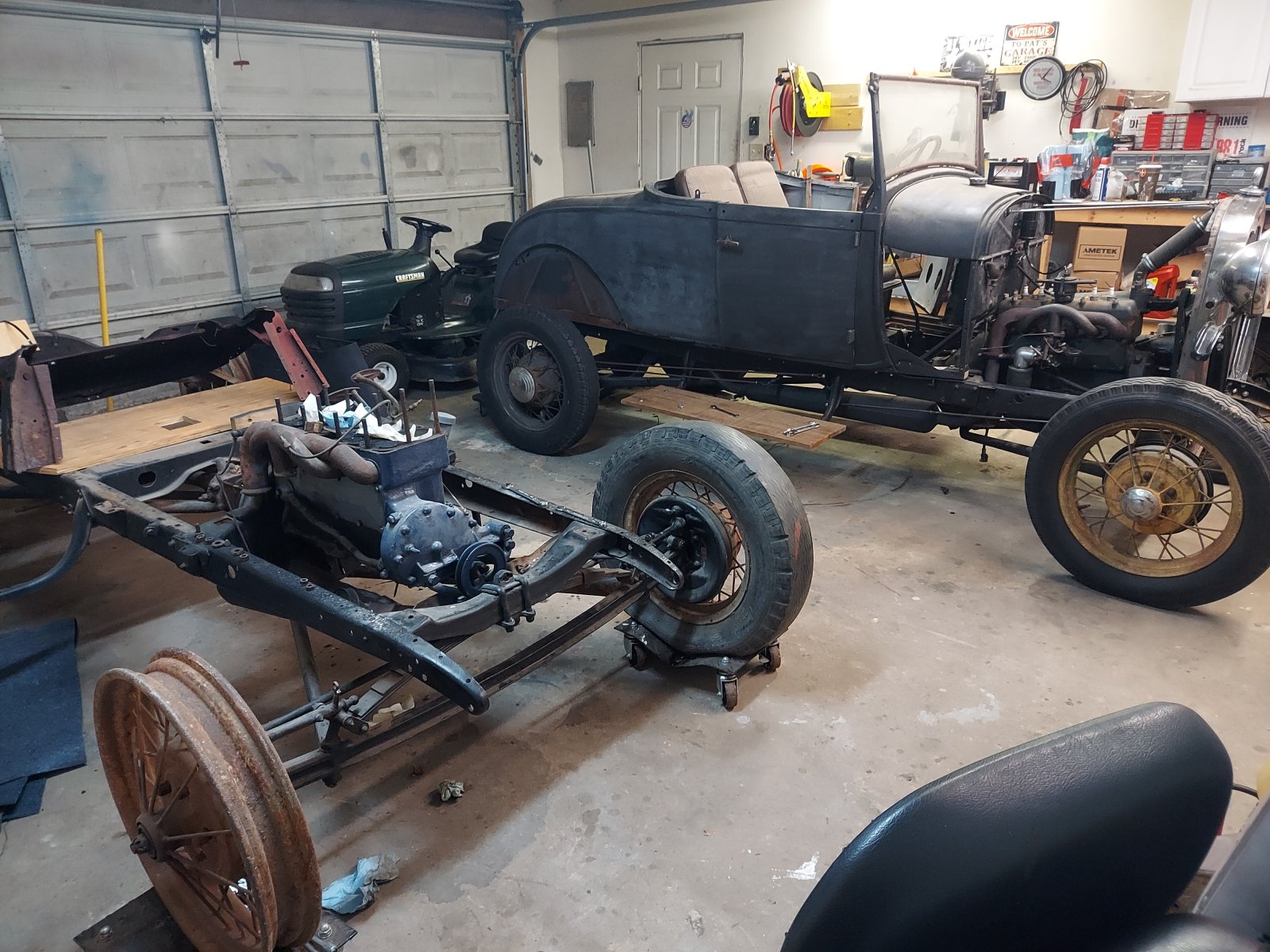

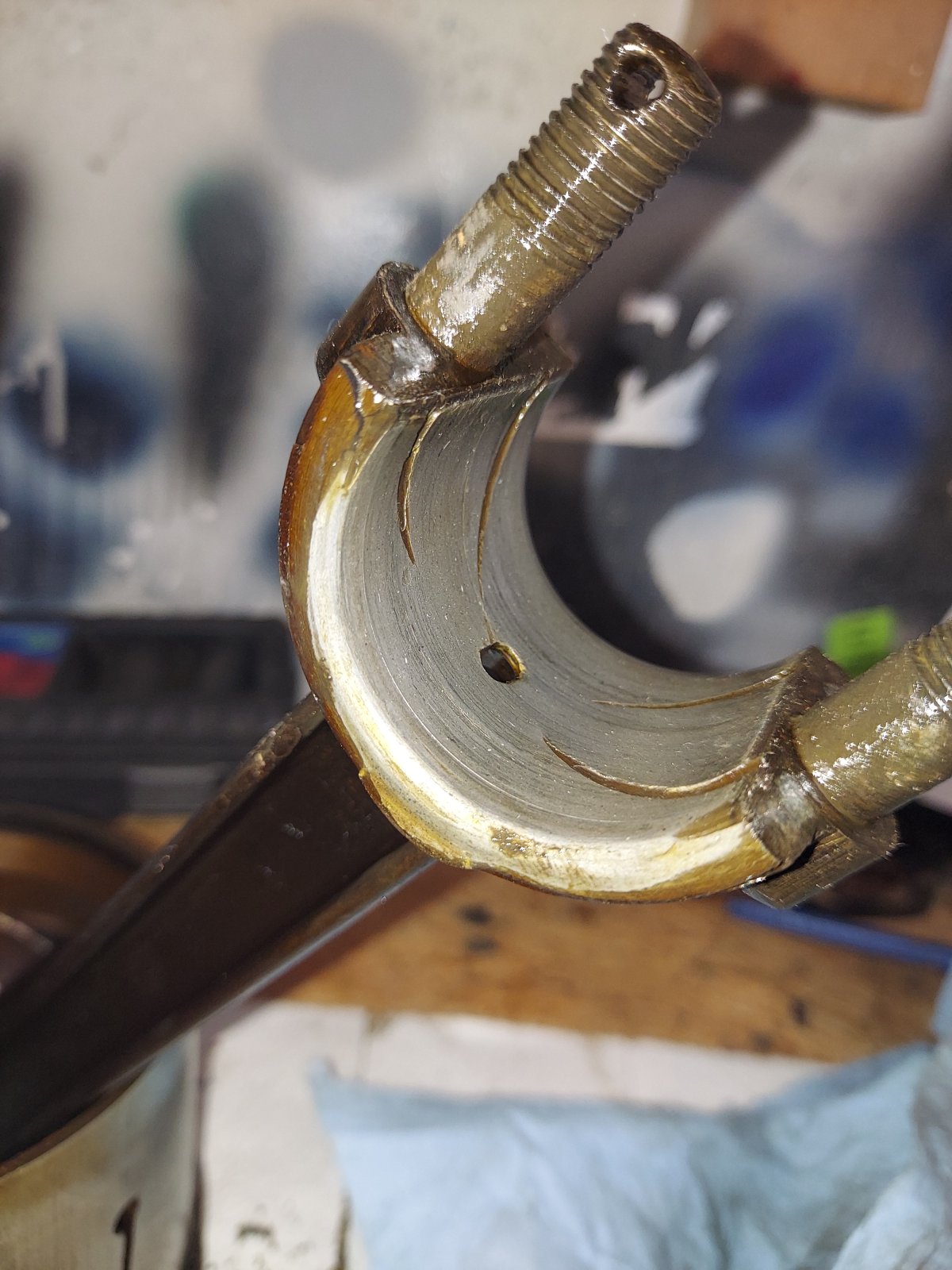

    I started to go through the engine to see if I could just do a quick cleaning, re-gasket and re-assemble. After pulling the rods and finding the babbitt like this, I decided it probably needs a lot more than a good cleaning if my goal for this engine was longevity.

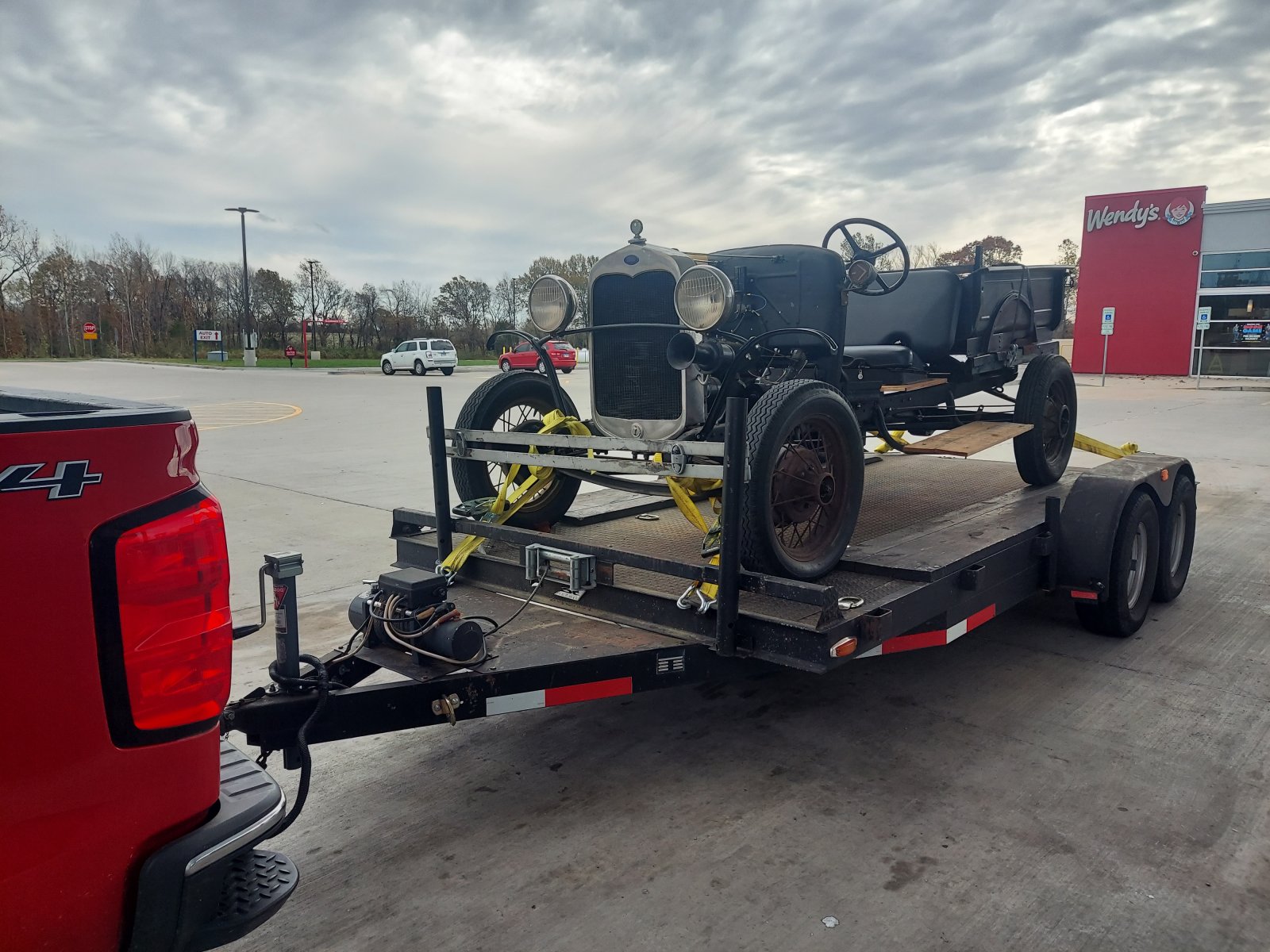

    While scrolling through marketplace for a solution, the best case scenario happened. Only 4 hours away was a running and driving "model a". A friend of mine is building a 30 PU so he bought the firewall from me, and another friend is building a 32 PU so he bought the bed. It was a win for all of us since that left me with a ready to go frame to drop my body on.

    I got the body swapped over thanks to help from my dad and it is really starting to look like a proper car now. Better pictures are to come. During this process, I noticed a crack on the front crossmember of the original frame and decided to yank the engine and front axle. This front cross member was smoked.
    I did a double check over every corner of my new frame and it checks out good. This made me feel even better about getting the new frame and drivetrain.
