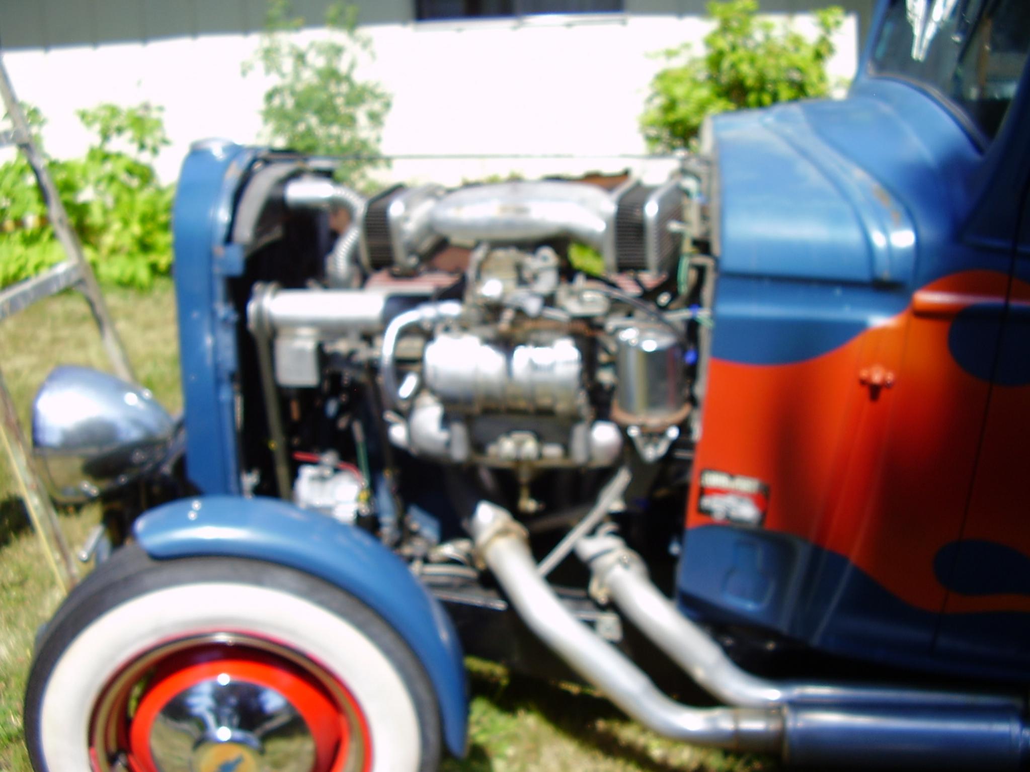

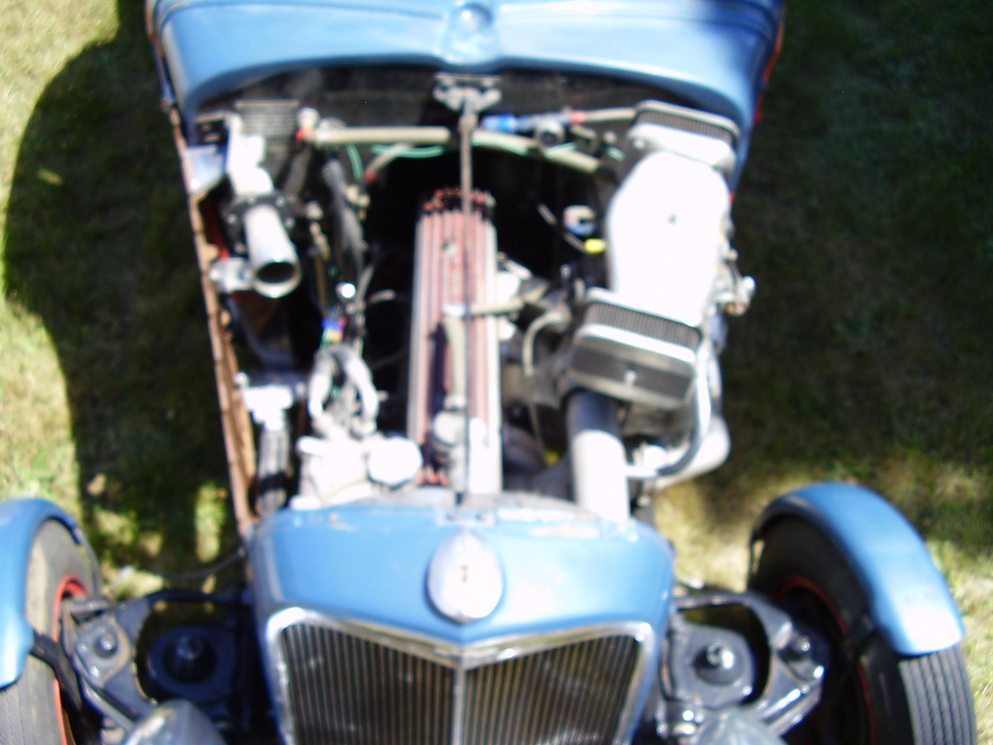

  2. Sorry the pic isn't any better, I shot this one at OCIR back in the early 80's
  3. Little Terry
    Joined: Oct 17, 2007
    Posts: 658
    Little Terry
    That's an interesting soultion. Never seen one mounted at an angle liek that before. Thanks for sharing.

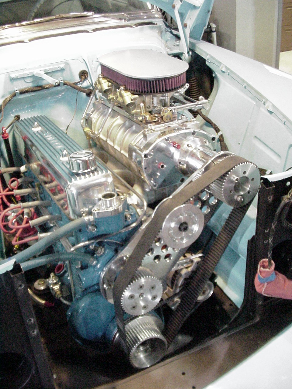

    HI. I'm the guy with the blown six in the 54 Chevy shown in No Name's post (#25). It's a 261 truck motor out of a school bus that I hung a GM 8V-53 blower on to with a couple of Holly 500cfm carbs on top. Been driving the thing for about 5 years and it runs really strong. Made everything from the drive assembly to the carb adapter. Not your 1-800-Summit kinda project, but worth the effort. Here's a construction pic and one running.

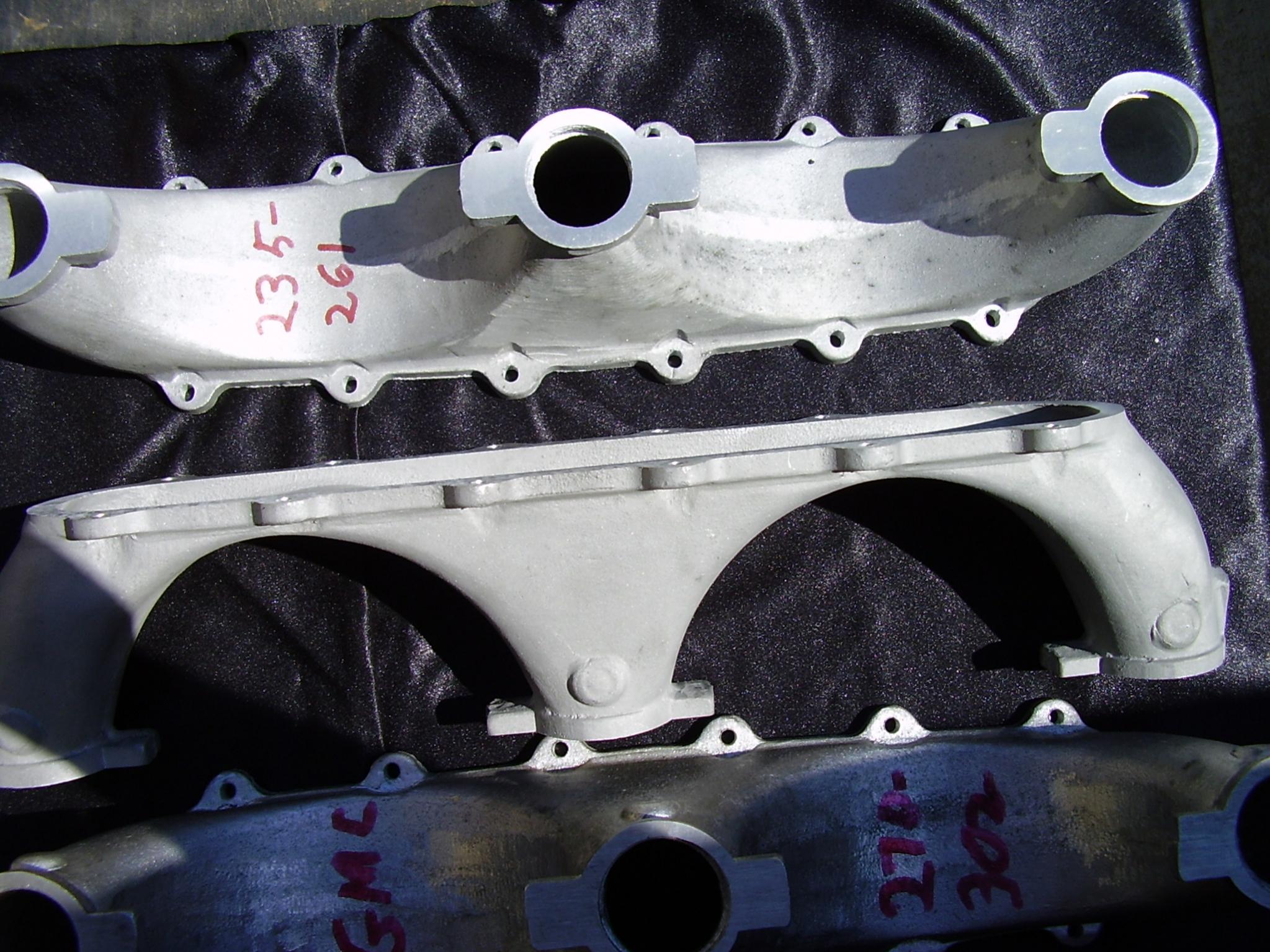

  14. 33-Chevy
    Joined: Nov 30, 2007
    Posts: 267
    33-Chevy
    See enclosed pictures. We make manifolds for Chevrolet 235-261, Chevrolet 250-292, GMC 270-302. I got the rights and design from Carl Sparkman who designed the original about 25 years ago.
