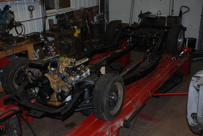

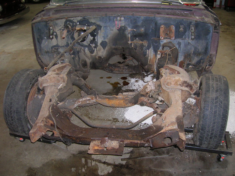

    By now it was starting to get quite obvious that rust was pretty extensive. The car had sunk into the dirt and the bottom 8" or so between the firewall and rear axle were heavily corroded and damaged. Not unusual for a Minnesota car. At that time, I had more time then money, so I figured I would give it a go to see if I could bring this thing back.
    I started with the chassis. Please forgive me, but I did not take very many pics of this process. The plan was to repair the frame, build a triangulated 4 bar for the rear, and convert the front to rack-and-pinion power steering and disc brakes. I also repaired the center sections of the frame, and ground out and re-welded the center joining weld along the frames entire length as it was rusted, cracking and starting to seperate in many places.
    The rear 4-bar mocked up. I used the original spring and shock mounts to keep it simple, and fabricated my own bars using a universal bushing kit from Energy Suspension.
    Painted Frame
    Front suspension with rack and pinion.

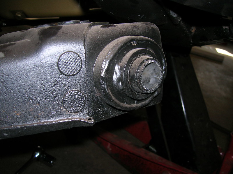

    For you '62 Merc fans, you know about the Anti-Harsh front suspension that Mercury used on these cars. The lower control arm has a special set of inner bushings that allow it to move laterally as well as pivot to help absorb hard impacts. This is the one place where the chassis differed from a Galaxie. Since these bushings are very expensive to replace, I decided to convert the car back to the much cheaper Galaxie setup.
    I made a set of weld-in plates that would support the Galaxie bushing.
    Completed Chassis

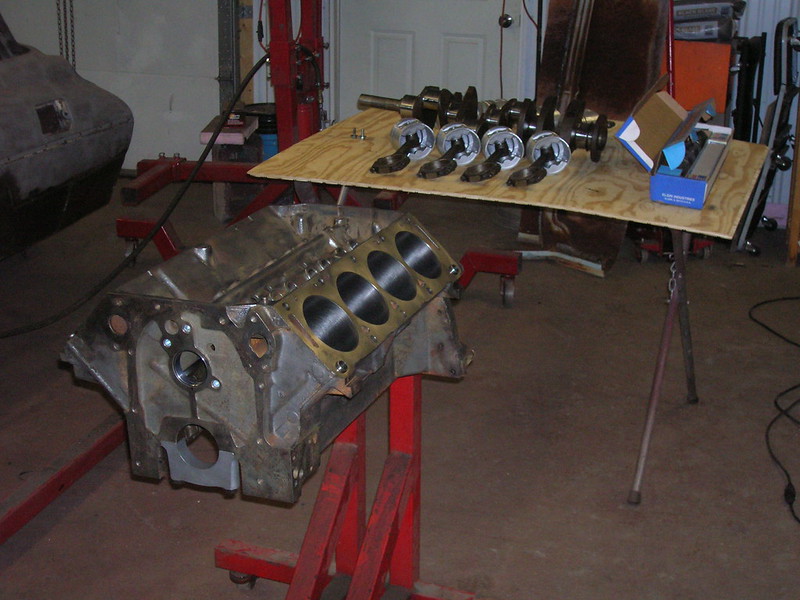

    By this point, it was time to get motor tore down and off to the machine shop. The FE turned out to be a fairly generic 220 hp, 2 bbl 352. The plan was to convert it to 4 bbl, and build it up with an emphasis on low end torque. The wagon is a big heavy car, and I wanted the power down were I could use it. Also, there was talk of maybe using the car some day to pull a nice camper.
    Dennis Roy in Grand Forks, North Dakota started the engine work. Dennis was an old time Ford guy and had built more FE's in his life time then I could imagine. If you walked into his shop, he had a 410 FE on the stand in the doorway that you had to squeeze around just to get into the place.
    Cylinder #1 needed to be sleeved due to some rust that would not clean up at 0.030. Other then that, the block was in good shape.
    Unfortunately Dennis ended up having a massive stroke and passed away a few months later. My engine was now stuck in legal limbo as his children went through the business and tried to figure out were he had left stuff. Dennis was the type that kept everything in his head and never wrote anything down, so this took awhile to figure out. Finally I got the disassembled, motor back. Cylinder #1 still needed to be sleeved, and the block needed to be relieved to fit the rather large valves Dennis had stuck in the heads. So I brought the parts up to Hultgren's Engine and Machine in Hallock, Minnesota so they could finish the work. Gary and Stephen finished up the machine work, and discovered that the heads had been ported too far to fit the large valves, they would not be comfortable running them and recommend replacing the heads. So, a set of Edelbrock heads were ordered.
    Iron heads with the stainless 427 MR valves.
    With the machine work done, I brought the motor home and did the final assembly.

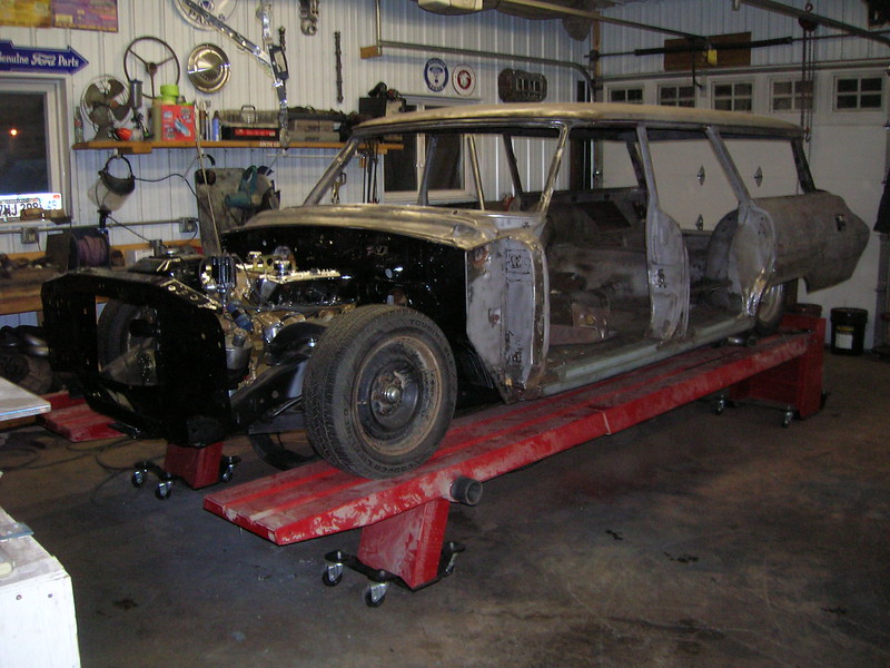

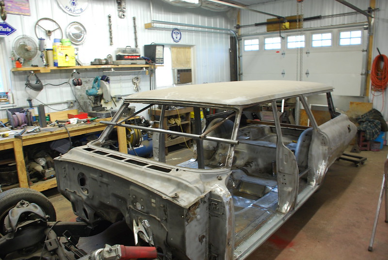

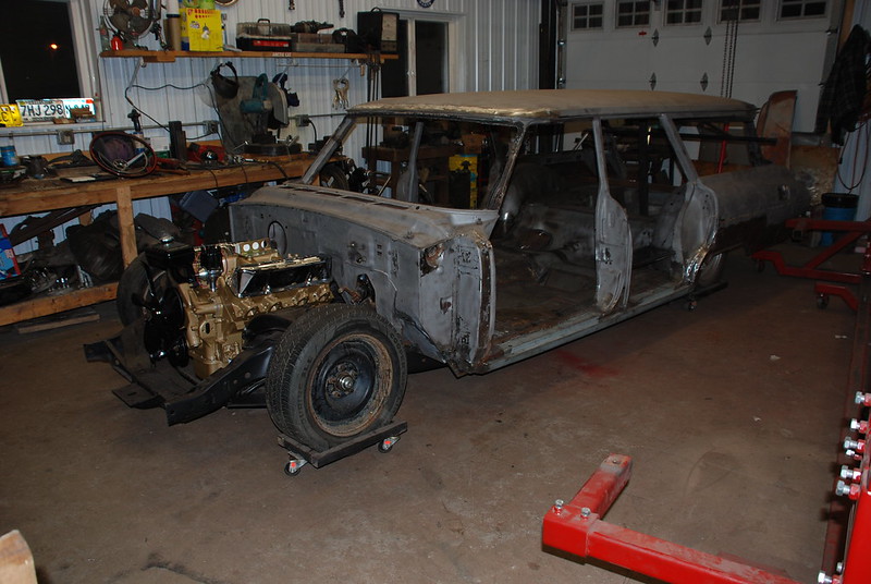

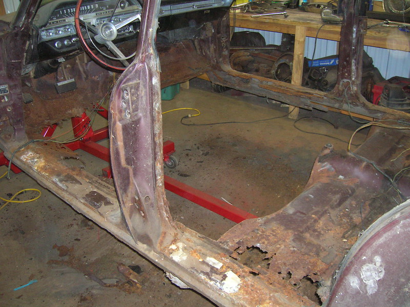

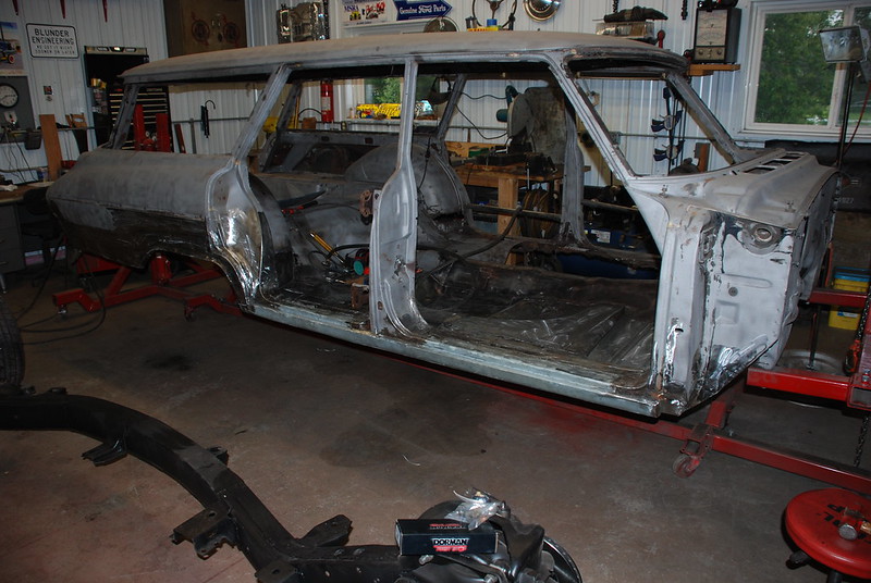

    While the engine was away at Dennis's Engine Shop, I figured I had better get started on the body as there was ALOT of rust repair to do.
    There was no way I was going to tackle the floor repair on this big of a body with out a rotisserie. Once again, I was a bit short on funds, and I wanted a big heavy duty rotisserie, so I designed and built one.
    Now, I could get the body stripped and see just how extensive the rust was.
    Sand blasted clean.
    As can be seen, new rockers, quarters, and a floor were in order.
    Piece by piece, it came back together.

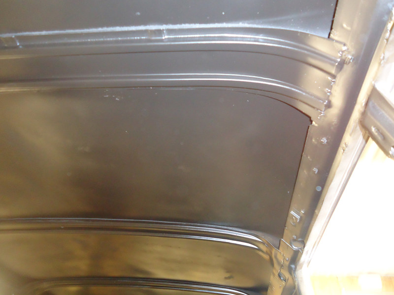

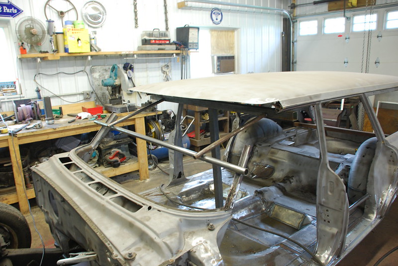

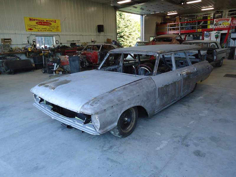

    Eventually I got the floor, rockers and quarters replaced and was able to get the body back on the chassis.
    Using the chassis to stabilize the body, I could now replace the windshield and tailgate headers that were rusted out from mice nests. I ordered a rust free roof from a junkyard in Arizona and got to chopping.
    This is what the original windshield header looked like. Not good. The tailgate header was actually worse.
    All Better now.

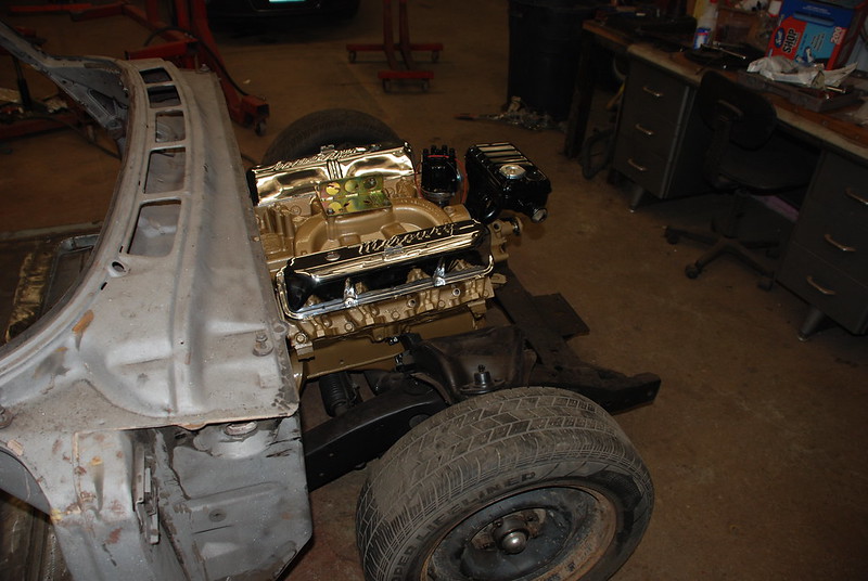

    With the headers replaced, it was time to start fitting up the motor, trans, and other under the hood components.

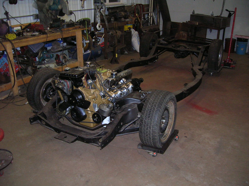

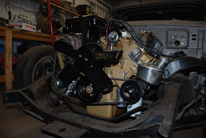

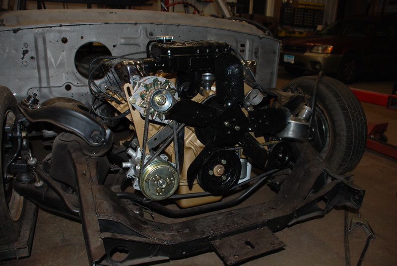

    Motor in for fit up.
    Steering Clearance
    Accessories mounted. The wife wanted air-conditioning, and I didn't want a big old ugly compressor sitting up were it was the first thing you saw when the hood was opened. So, I mounted it in the original generator location and put an alternator above it. Now the compressor is down low and out of view.

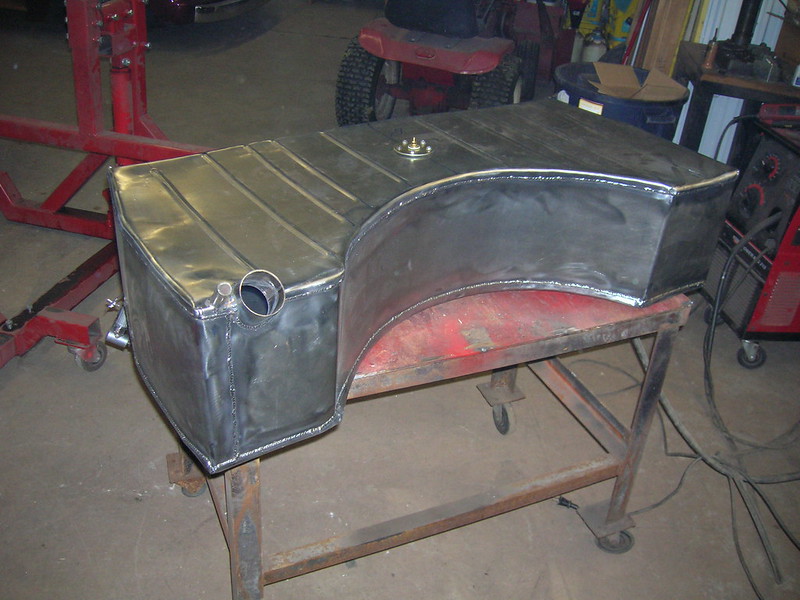

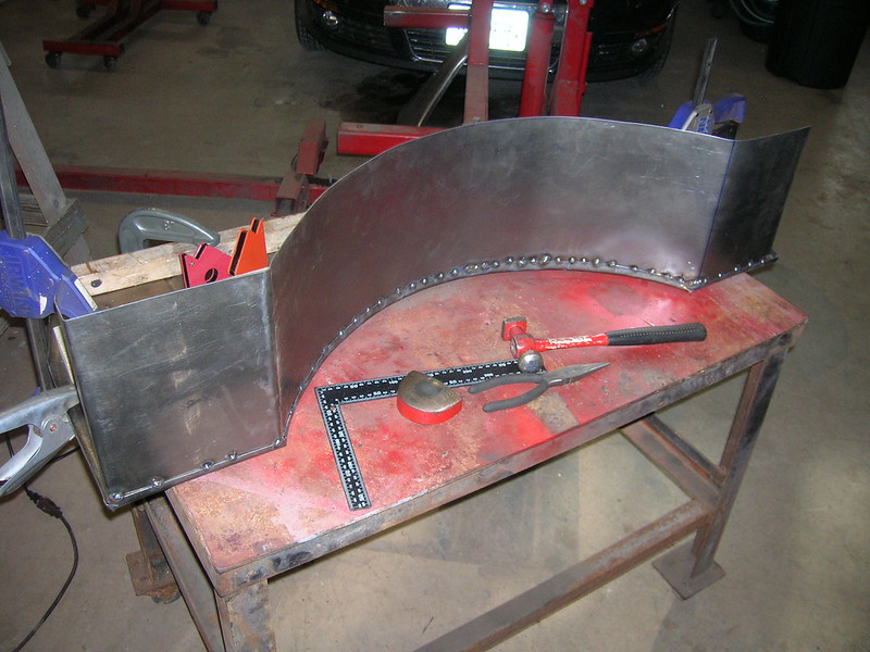

    The original fuel tank was a study in corrosion, so it had to go. The problem was that wagon tanks are not reproduced. 2 or 4 door, no problem, lots of options, wagon - not so much. So I decided to make one.
    The original suspect.
    Top and bottom.
    Flanged
    Bead Rolled for stiffness.
    Sides
    Welded.
    Finished and ready for paint and interior coating.

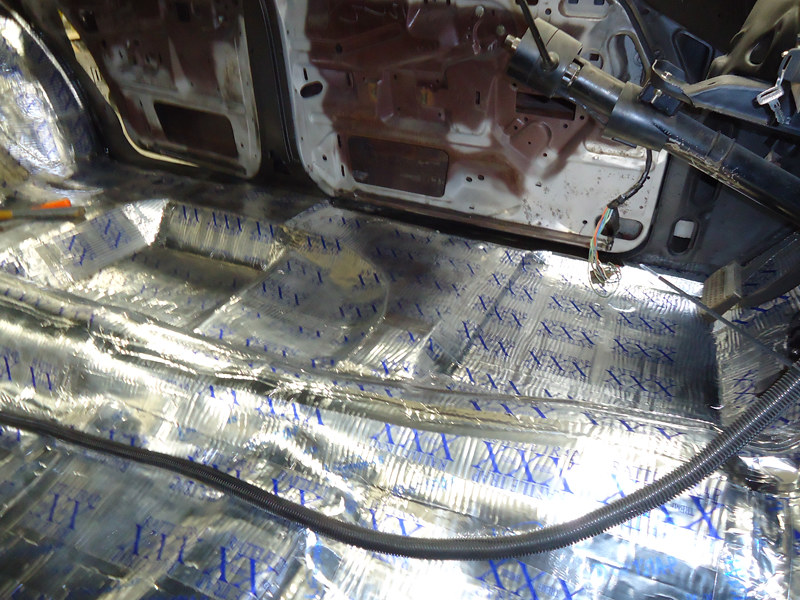

    The body went back on the rotisserie for under coating and firewall paint.

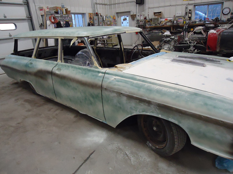

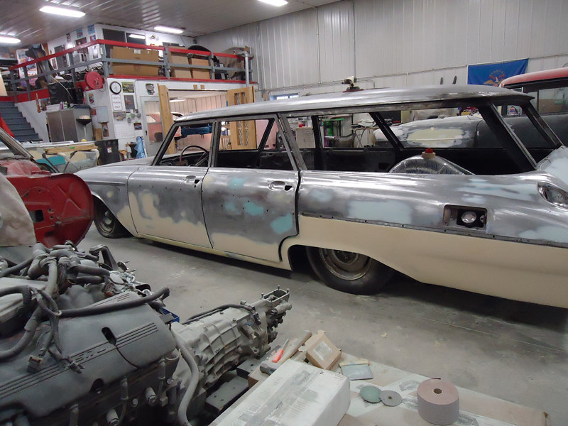

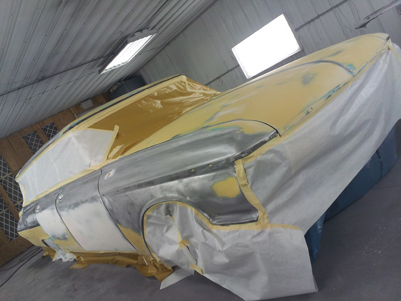

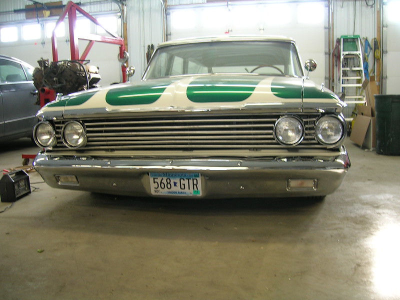

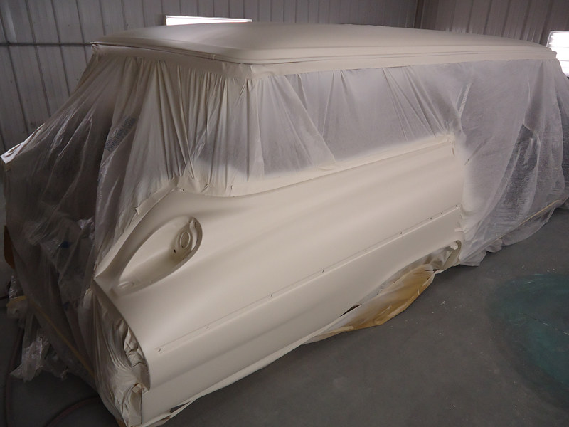

    By this point, the car had a date with the painters and I need to finish up the doors and front fenders. A little sand blasting, some more under coat and paint, and the wagon was starting to look like a car again.
    In June of 2013, I dropped the Merc off at Northern Muscle in Reynolds, North Dakota for final body work and paint.
    The plan was a two-tone panel paint job inspired by Watson and few of the other greats of the early 60's. Interior Sealed and Fat-Mat applied
    Filler being applied.

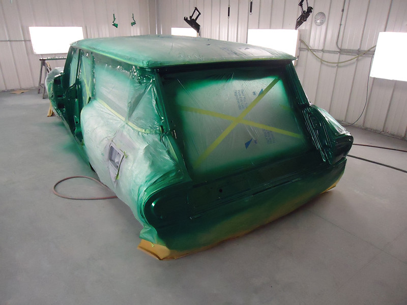

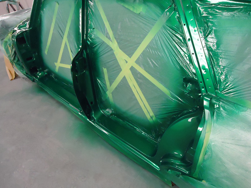

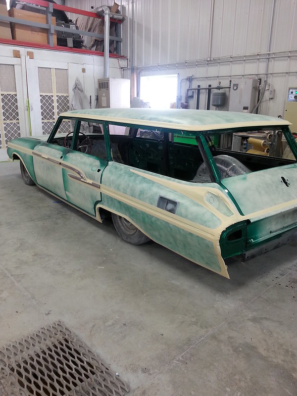

    Masking and Primer

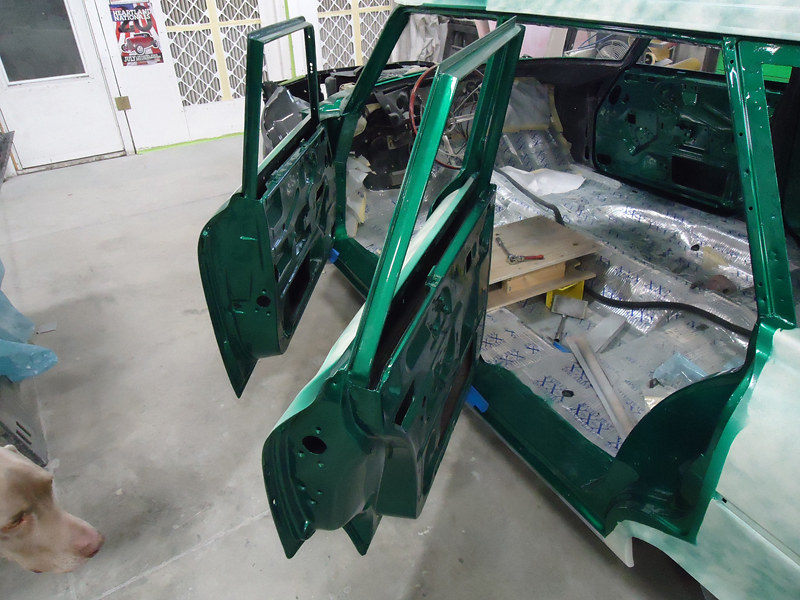

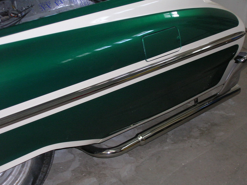

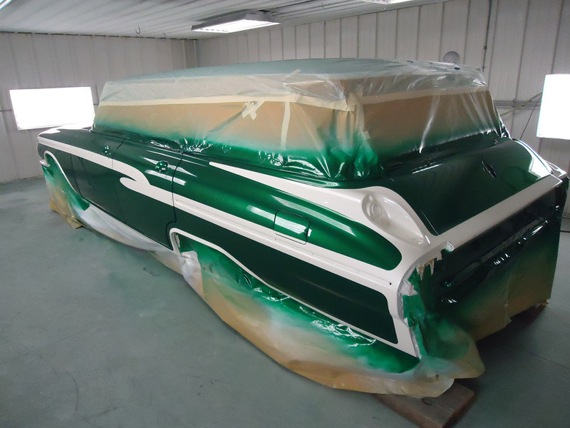

    We used the guide coat to start laying out ideas for the scallops, and two-tone
    Color Time.
    Pearl White Base Coat
    Door Jambs
    More Masking
    The roof
    Let the fun begin
    Paint Complete.

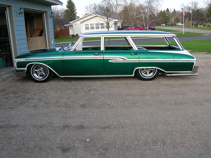

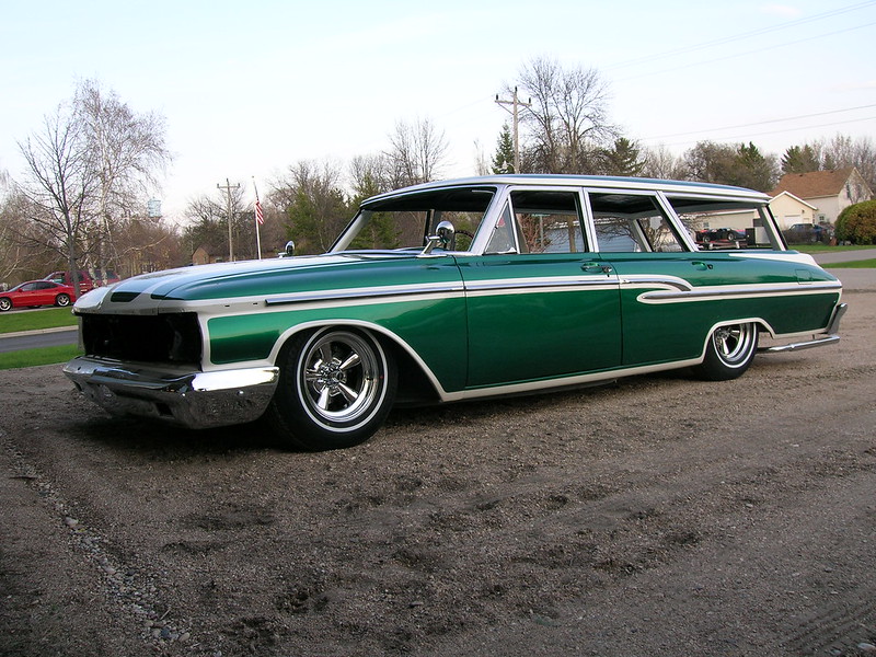

    I brought the car home Feb 2014, and started final assembly.
    Bellflowers, of course
    Stainless all polished and ready for glass. It also needed a new set of shoes. 15" Supremes and pinner white walls should fit the bill. At the same time, JR Plating in North Branch, MN was working on all the pot metal, replating it and getting back to perfect.

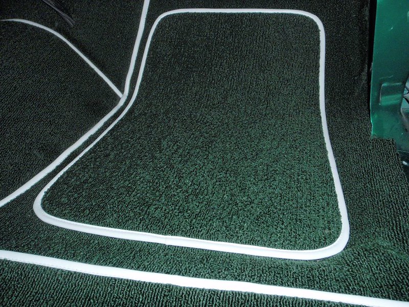

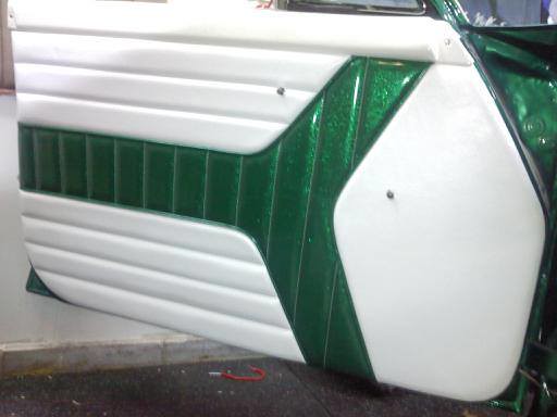

    Headliner (prior to trimming)

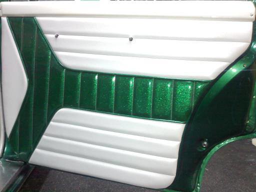

    Carpet and Floor mats.
    Door panels.
    Back Seat.
    Cargo Area

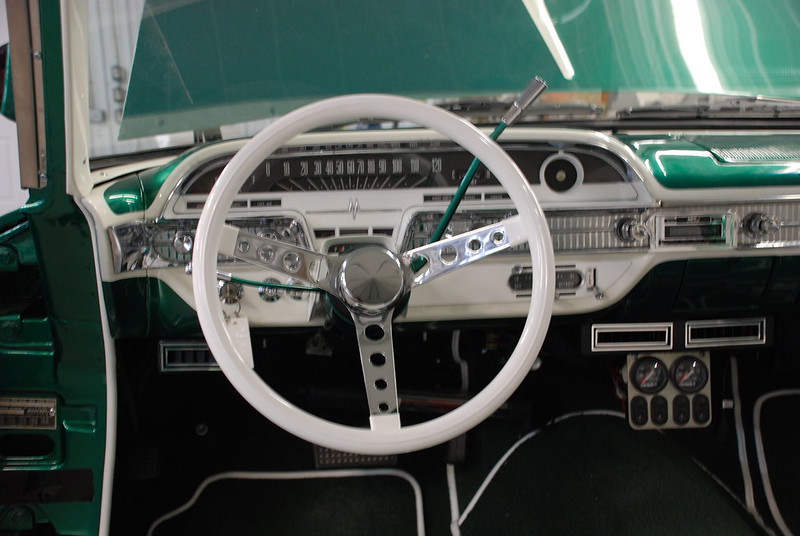

    By October, Stich Bitch had worked her magic, and I hauled the car home for one last time. It still need the dash and grill to be finished up.
    Stainless tube grill.
    Dash

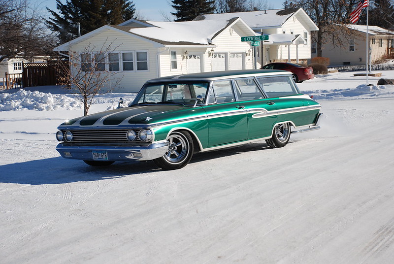

    And here we are, present day, lots of snow on the ground, and I am waiting for it to warm up a bit so I can take it in and get the front end aligned and AC charged. I have driven the car a bit, for shake down and to burnish the brakes. So far, it drives really nice and should be a fun cruiser this summer. I will keep this thread going as the last few things get updated.
