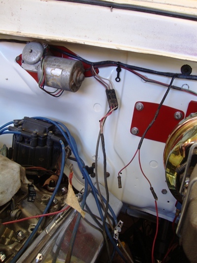

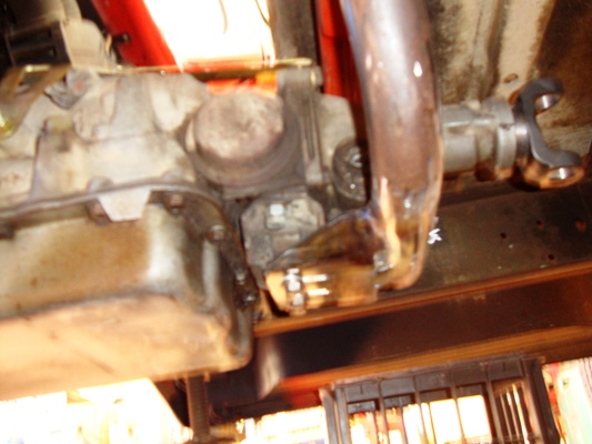

    Well tranny and engine mounts made now.
    I off set the tranny tube member so I would have room to attach the speedo cable which at one point before making the mount looked like the tube would block access to the attachment point on the tranny.
    Time to pull the engine out now and finish the engine bay and fit up the power steering pump, a/c and alternator brackets.
    Just trying to figure out what color to paint the engine???

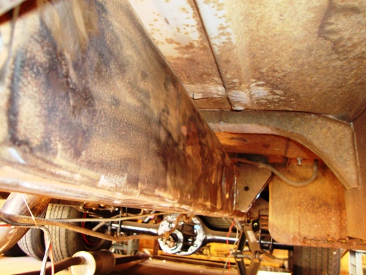

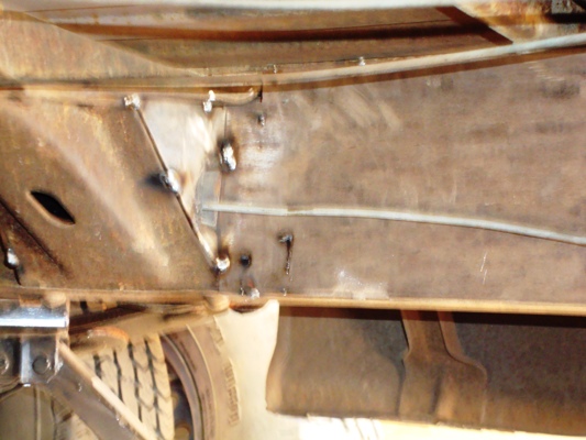

    Boxing plates cut and tacked into place.
    I have boxed from the radiator crossmember back just in front of the front leaf spring bolt on points.
    Sure looks real tidy under there now.
    I got a welding guy much smaller than me coming over to squeeze under there and mig it top and bottom.
    I struck a problem where the short park brake cable comes thru the chassis right up front.
    I heated and shaped the boxing to a half circle almost to scoot around the pre-existing arranges which I did not feel like modifying this time round.
    Plus I welded up all the non-used holes that seem to be every where in this chassis, should help to keep inside the boxing a lot dryer.
    If ever I do a body and box build in the future, at least most of the chassis work will be well advanced

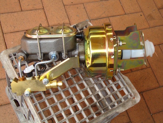

    When installing my new brake booster and master cylinder I decided I did not like the way it protruded into the engine bay, so I decided to since I was now running an auto tranny to move the brake booster and master cylinder into the old clutch location on the firewall and join the clutch and brake pedals together which is idea given to me from another HAMB member several years back.
    This move gets the brake stuff closer to the fender side and opens up the engine bay and by joining the 2 pedals provides that large brake pedal area allowing braking with either foot.

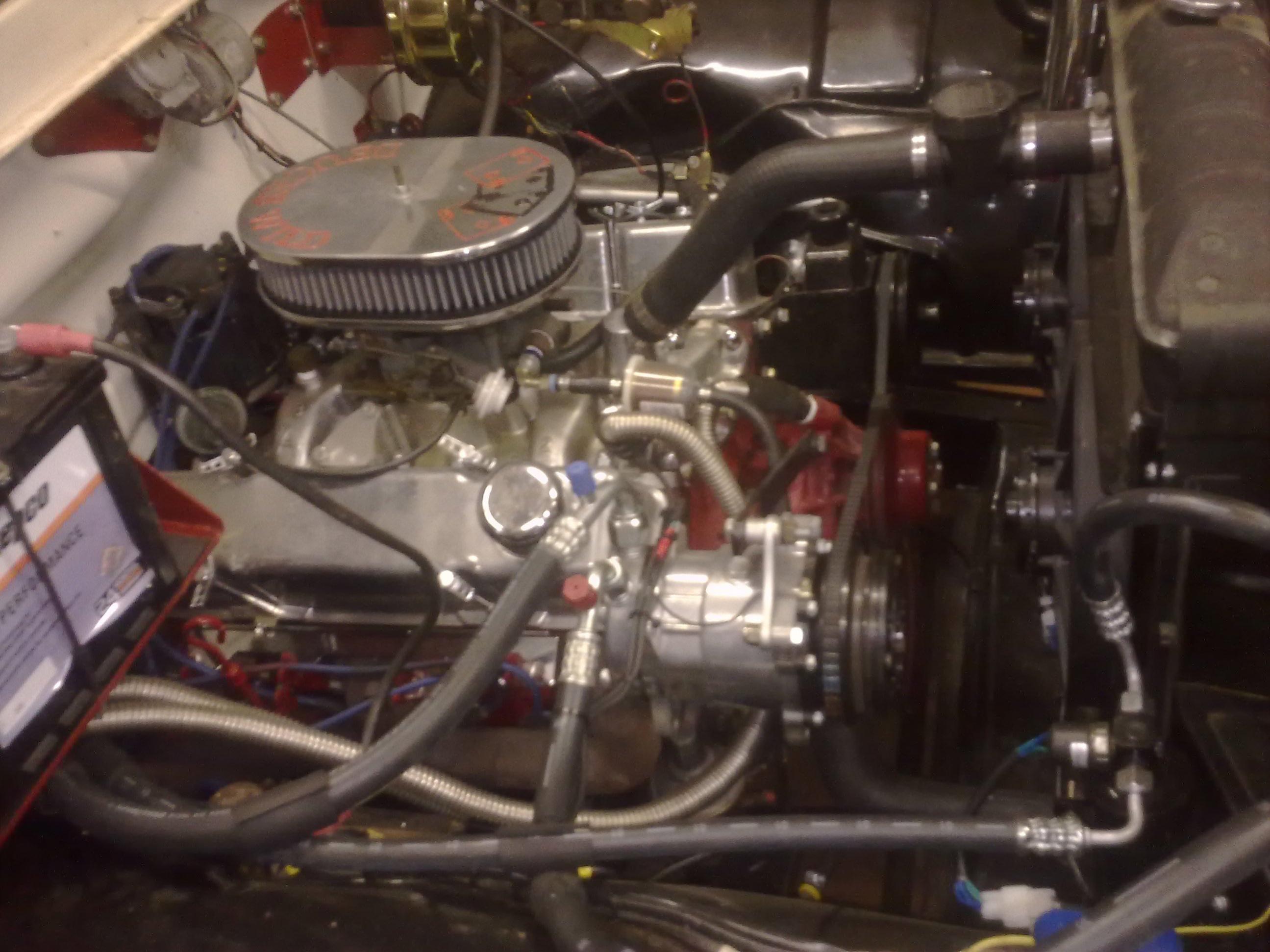

    The next thing I did was to install a/c just to add a little comfort on those hot days.
    I know some folks dont accept a/c in these kind of project but that is the way it going to be this time, at least I have a heater for the cold days as well.
    Any way, I decided to try and stay period correct and chose an early Mustang under dash unit for the purpose.
    As you can see it worked out fairly well.
    Got me an after market pair of thermo fans and a thru the firewall a/c adapter gizmoe and late model rotary compressor.
    Not the prettiest of installs but it does work great.

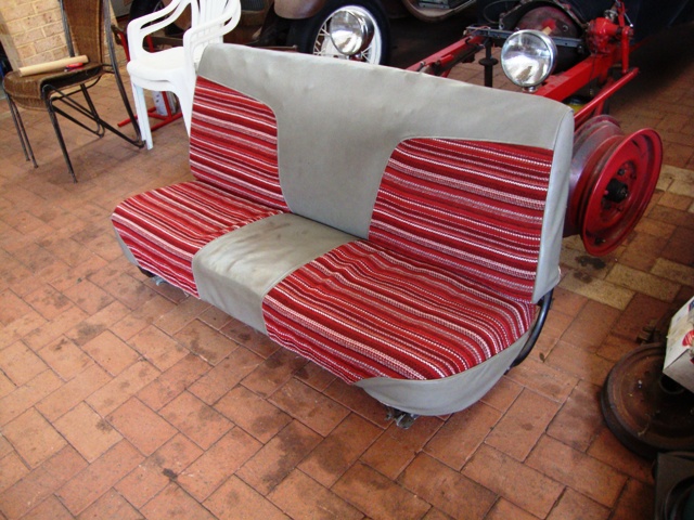

    I decided to modify my front seat since the original which looked great was just past its use by date comfort wise.
    The foam had lost its elasticity and was crumbling especially where the sun came in on it thru the rear window.
    The drivers side base was also shot springs and foam wise so it was either a rebuild or a swapout.
    I chose a swap out.
    Just by chance I found this rear seat from some kind of van/SUV and decided to take a chance on it since the price was right.
    After taking a few check measurements it looked like it would work with few adjustments and I got seat belts, headrests, plus a slim line back which helps with the legroom issues in these pickups.
    Fortunately this seat tilted and was hinged so I figured it may provide me with the opportunity to have good access under my seat for storage of stuff like my tools and jack and since I was using a SBC engine I'd probably need a tow rope at some stage in the future.
    I built up an enclosed seat riser using the original seat mounting points and transfered the hinged stuff onto it.
    I decided to remove all but the center seatbelt bolt on points and transfer them to the floor as per what was already installed in my F100 by a dealer at sometime previous.

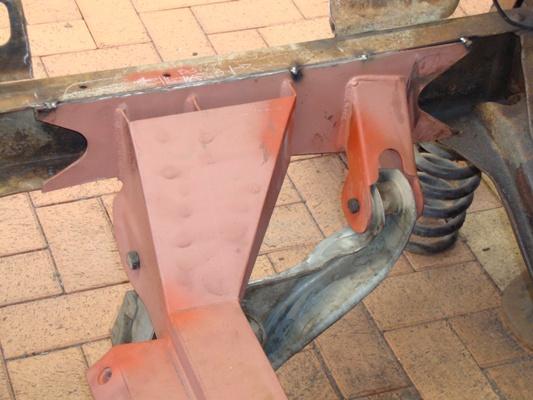

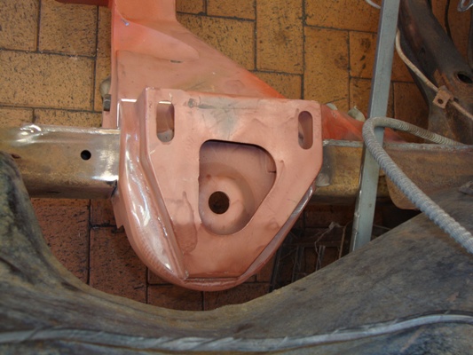

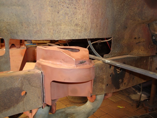

    Here are a couple of pic's of the Industrial Chassis Inc Dakota kit I used. It is a great kit and simple to install and setup.
    I take my hat off to Steve from Industrial Chassis Inc for such a great innovation.
    I am having some tranny work done so I have not driven it heaps yet but is sure drives nice in my book.
    I used the V8 version coils and also used the stock swaybar up front.
    The power steering is good, just takes a little getting used to after the old Ford manual steering box.
