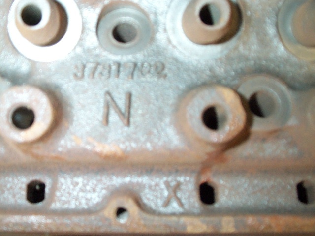

  23. dmarv
    Joined: Oct 10, 2005
    Posts: 977
    dmarv
    Alliance Vendor
    from Exeter, CA
    OK, here are some pics. One shows the combustion chamber, which I had cc'd at 56. The other shows the twin tower end casting. The last is the casting number.

  24. HEATHEN
    Joined: Nov 22, 2005
    Posts: 8,593
    HEATHEN
    from SIDNEY, NY
    Yes, those are high $$$ heads. You can buy many engine parts with the proceeds.
