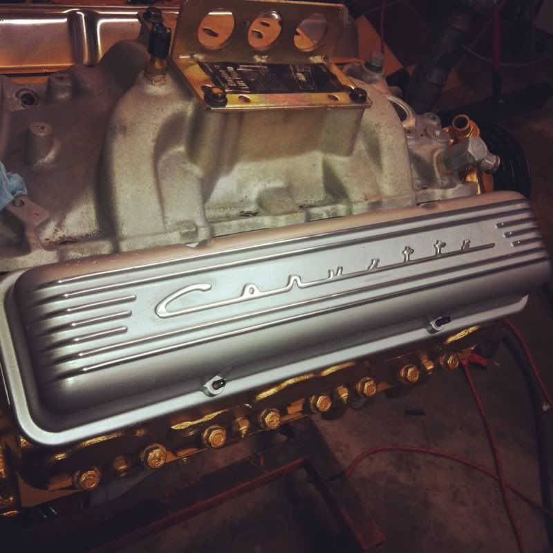

  4. Quick update: getting the motor ready. I still need to drill the back of the intake for the PCV. I drilled the front for the oil fill tube already.
    The valve covers were a little on the rough side, but I spent several hours on them and look pretty good. Junior Stock was able to dig out an exhaust manifold for me, this one is a right side rear dump, used on the driver's side to clear the steering box. I also got a speedway hurst style mount and have everything to bolt up the trans. I need to replace the clutch throwout bearing and inspect the trans/change the oil before that's ready to bolt up.. Little by little!
    I was in AutoZone and VHT Gold Flake "kissed me back" as my grandpa would say, so that's what the motor got for color.

    Doesn't even look like the same motor.

    Looks good Dan, I like the Gold!

    Excellent!!! I agree with Roothawg...it doesn't look like the same motor!! Love the gold and all you're doing with this car. Keep the updates coming!!!
