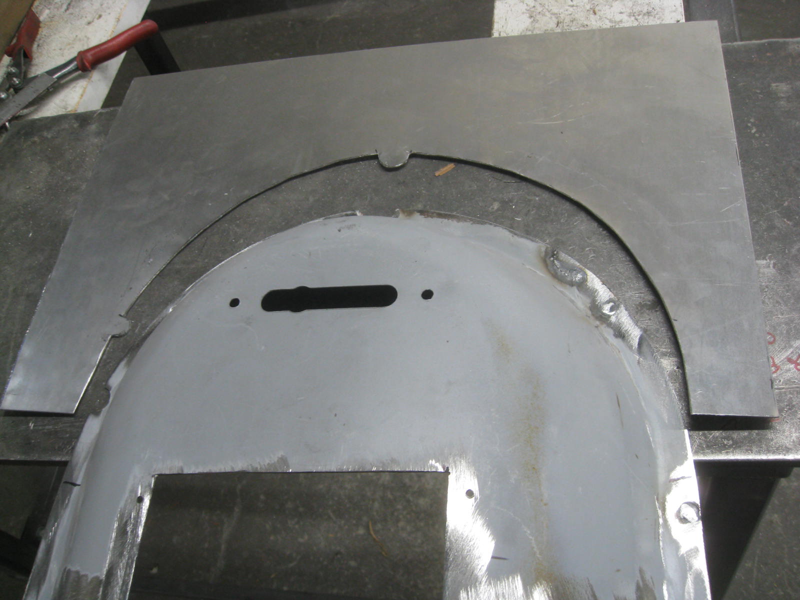

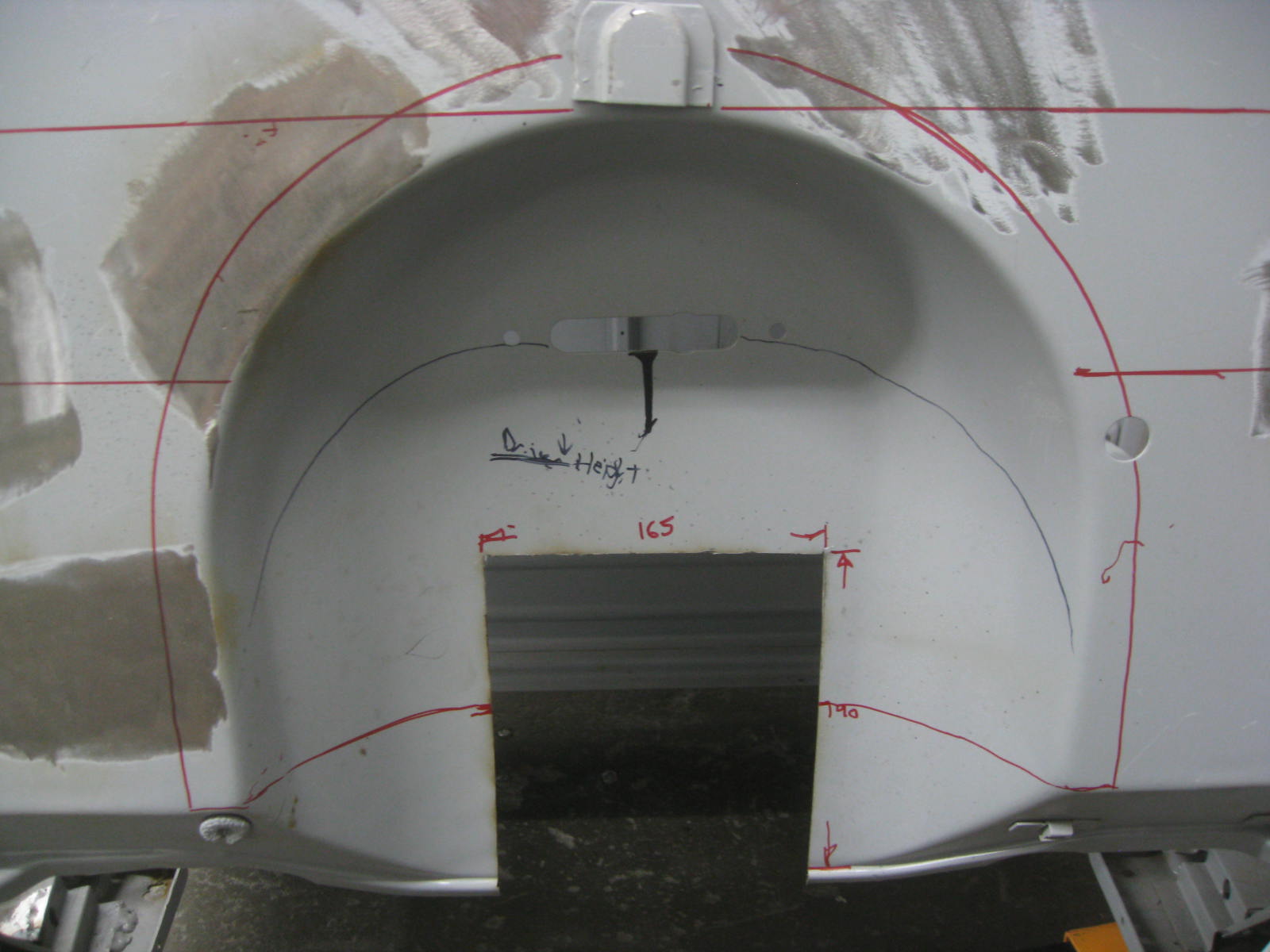

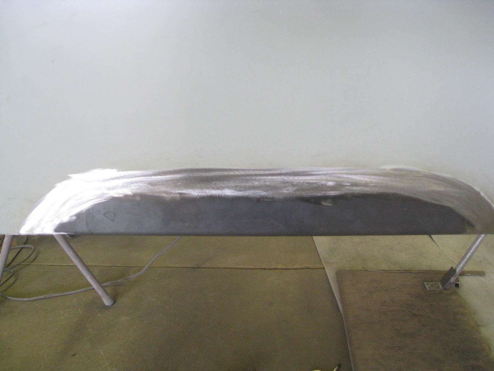

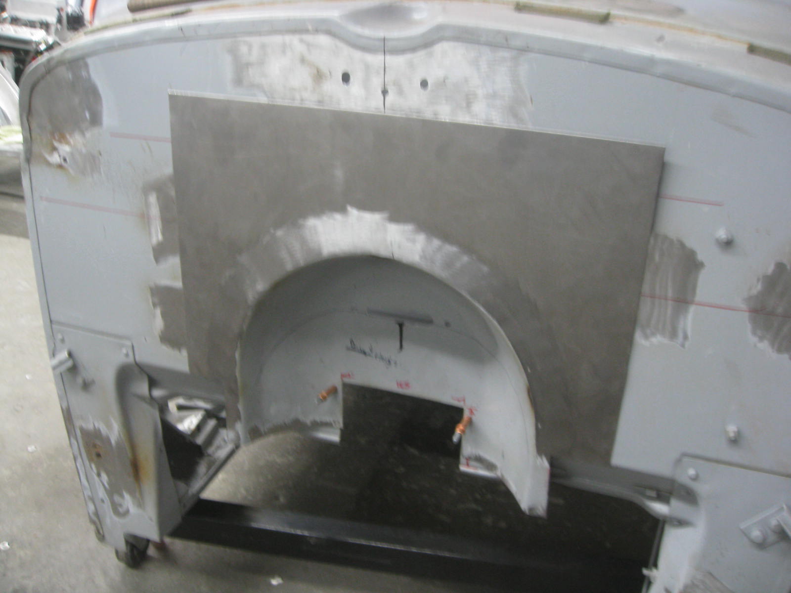

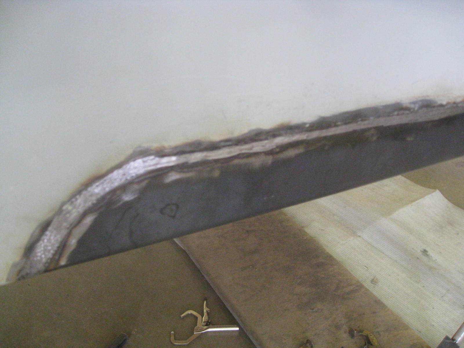

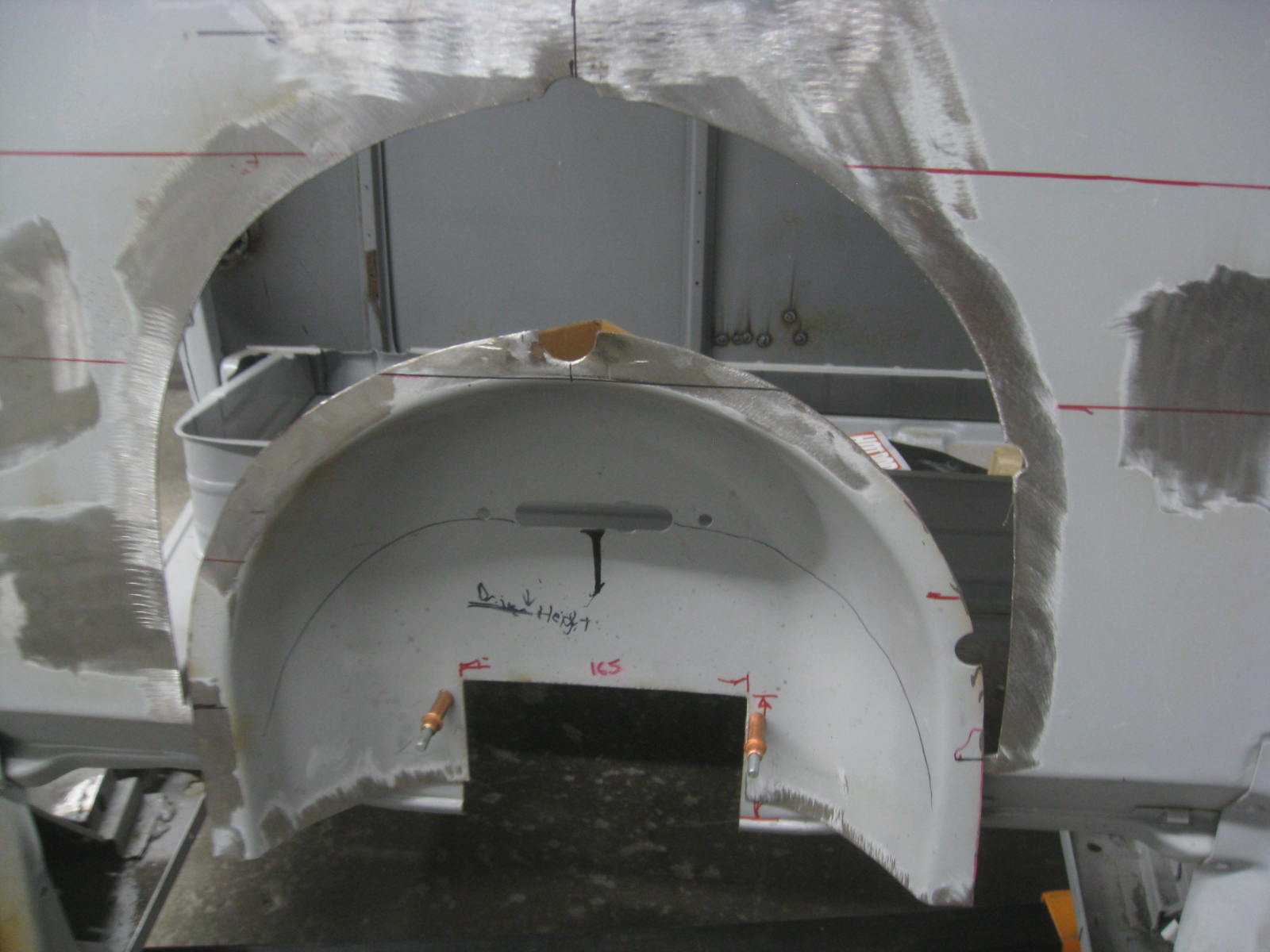

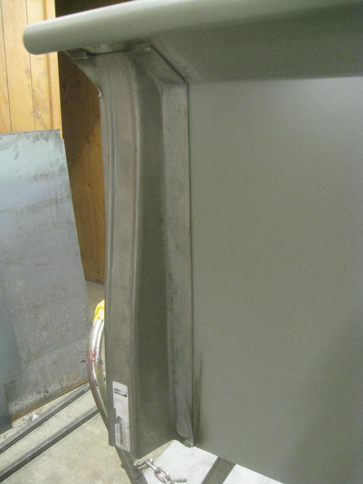

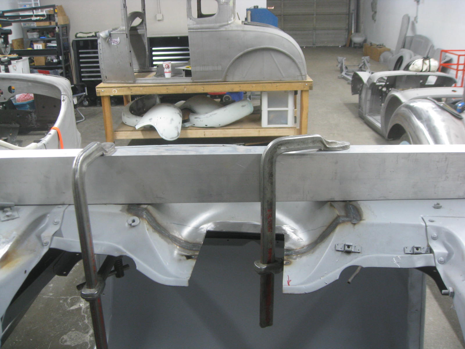

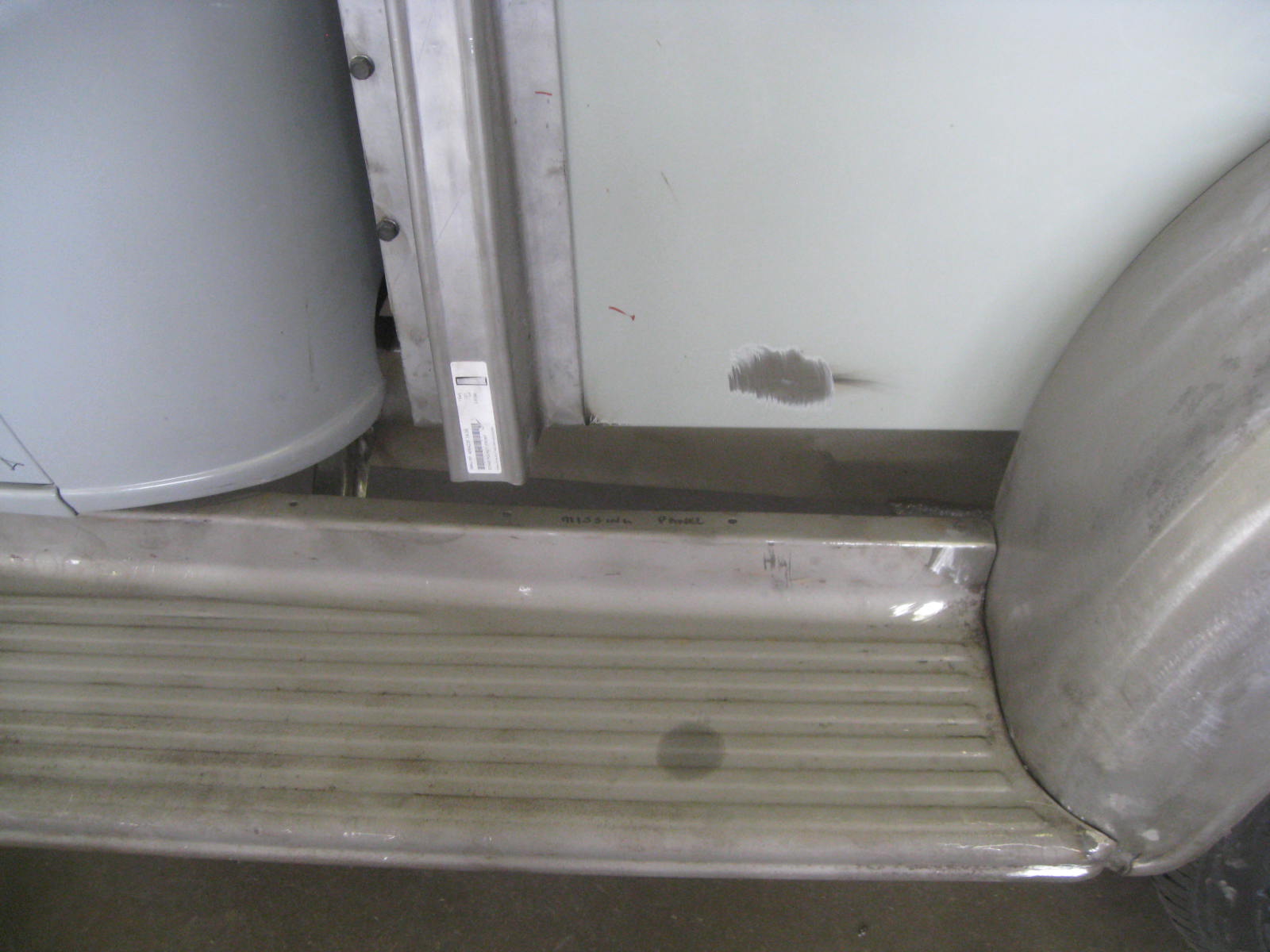

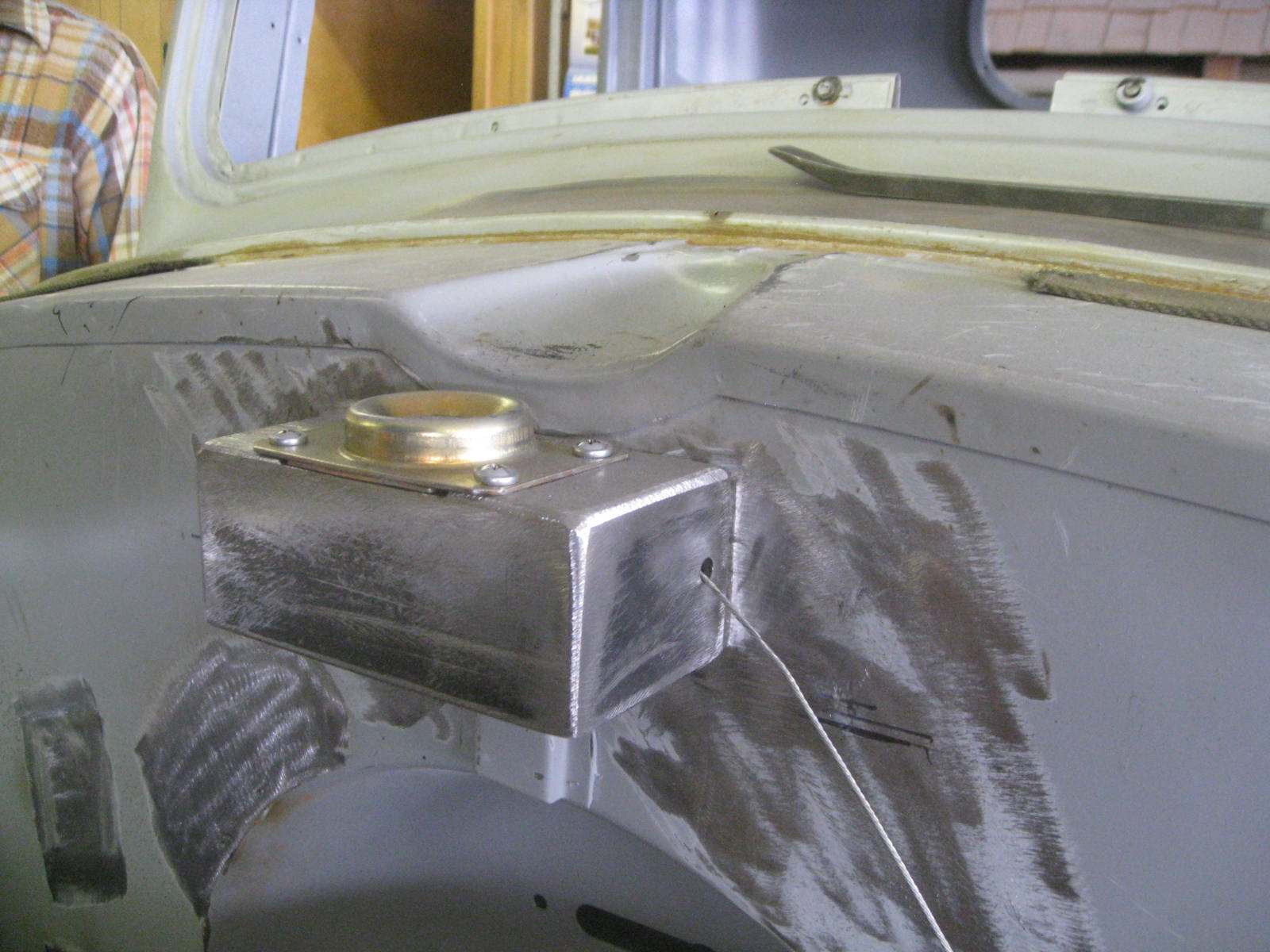

    First photos shows the rear bed cut out filled in as the cut out is not in aline with the wheels once the bed is mounted.
    Next photos show running board damage to be repaired.And finally the bed stake housing on the new bed changed out for the original style.

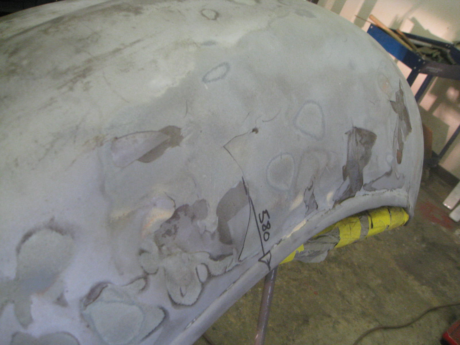

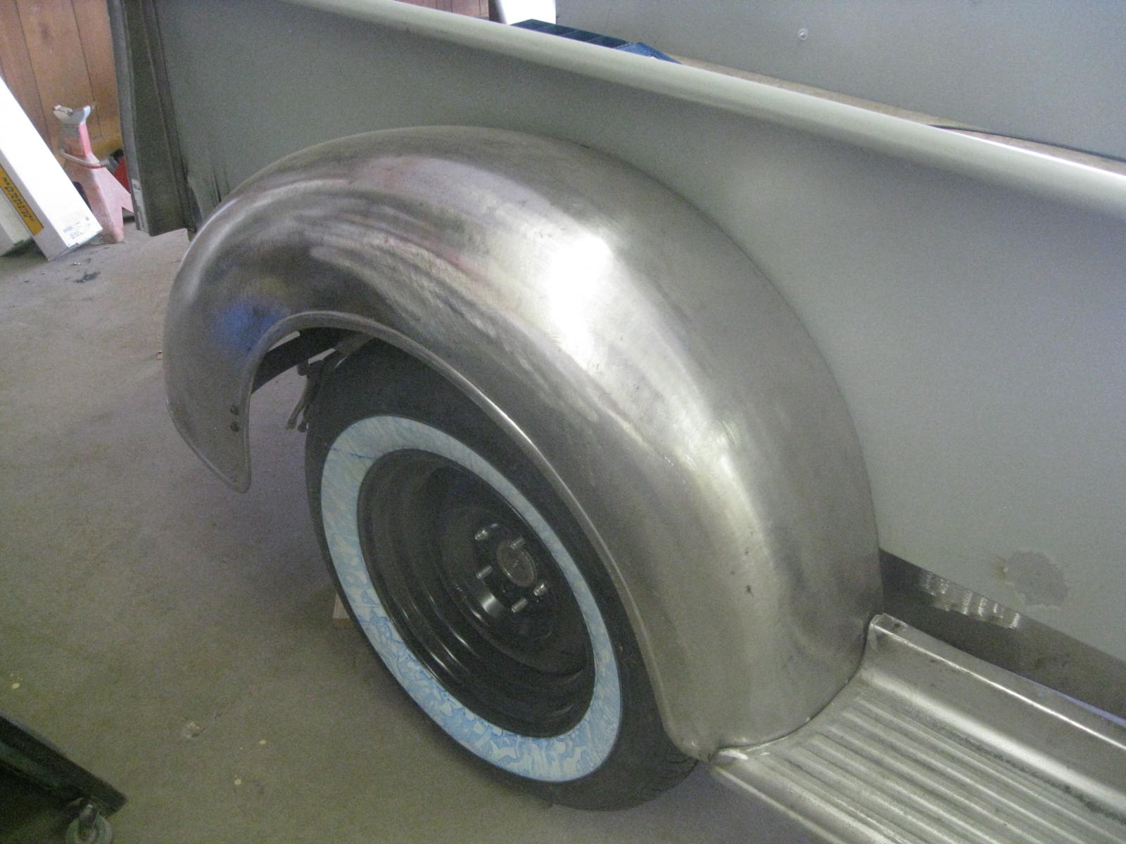

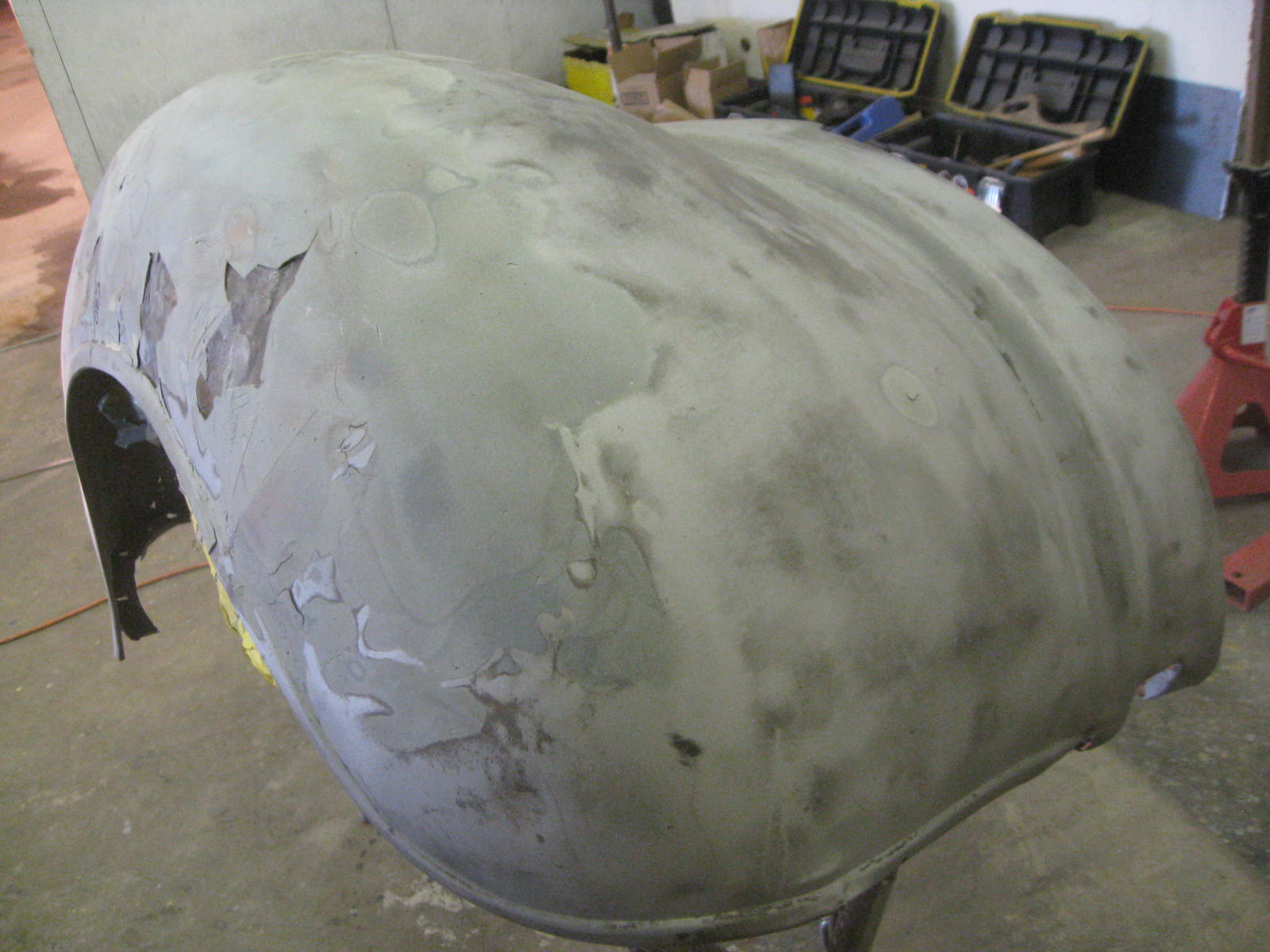

    So onto the RH front fender.So Newberry Motors bought an original 38 truck fender to replace the one that came with the truck.After mounting ,with ease, i discovered there we're very subtle variations in what i believe could be a 38 car fender?
    So i swopped out the fenders and everything looked good and panel gapping maintained.Now i have to repair and metal finish the original fender.I will have the fender shipped out to my workshop in Denver to complete as i ran out of time in Michigan to start.

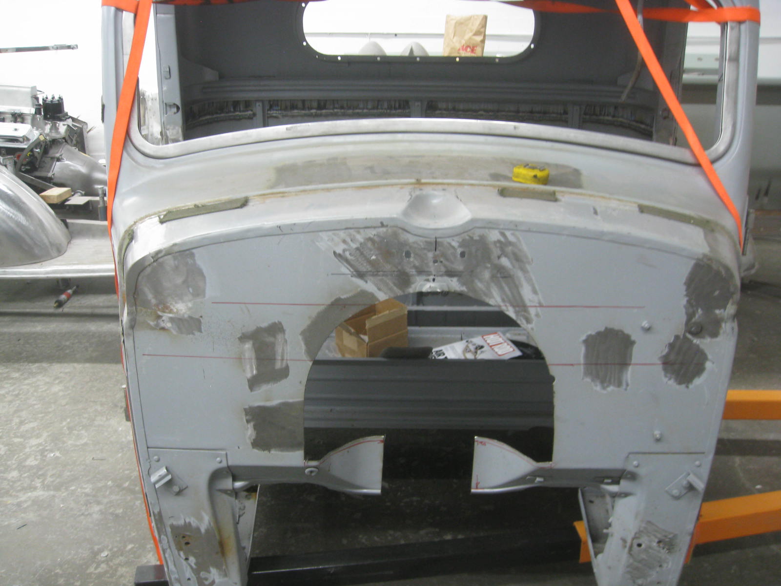

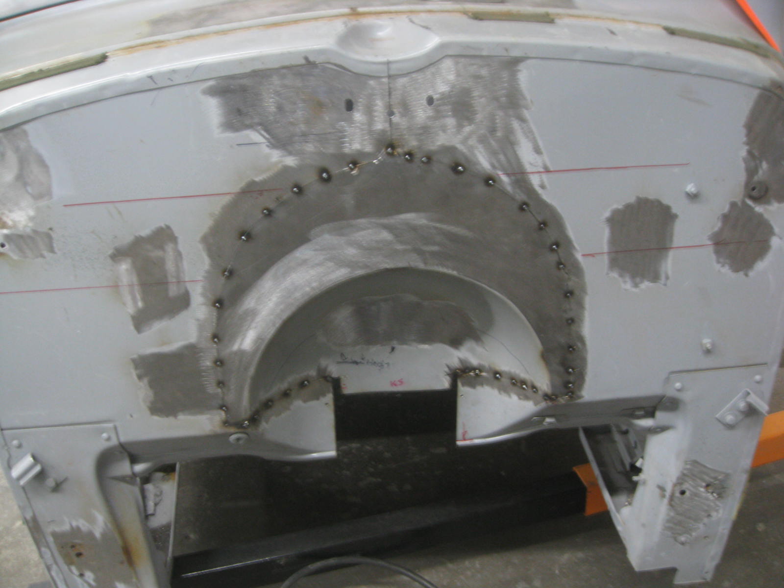

    Inner Structure plus hood release.A closer panel will be made to cover the hood pin mechanism later.Inner panel spot welded to hood for extra rigidity.

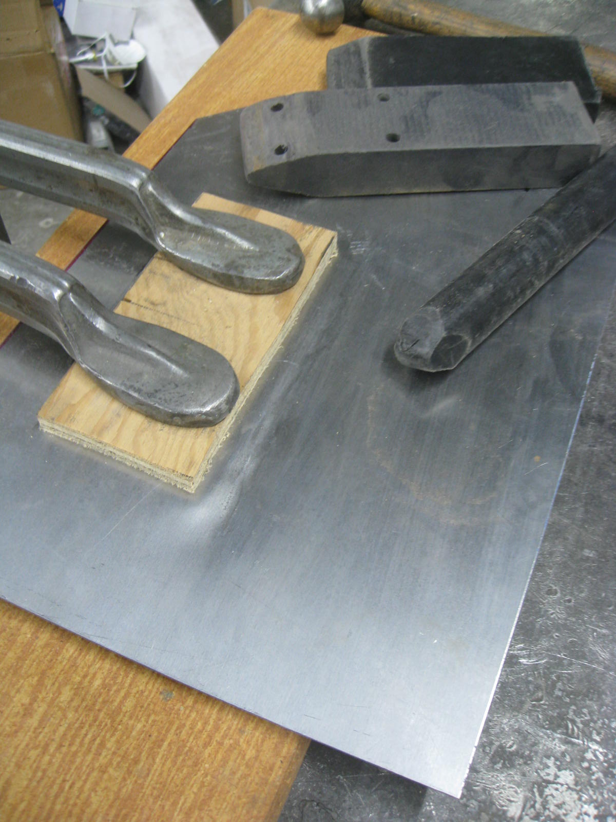

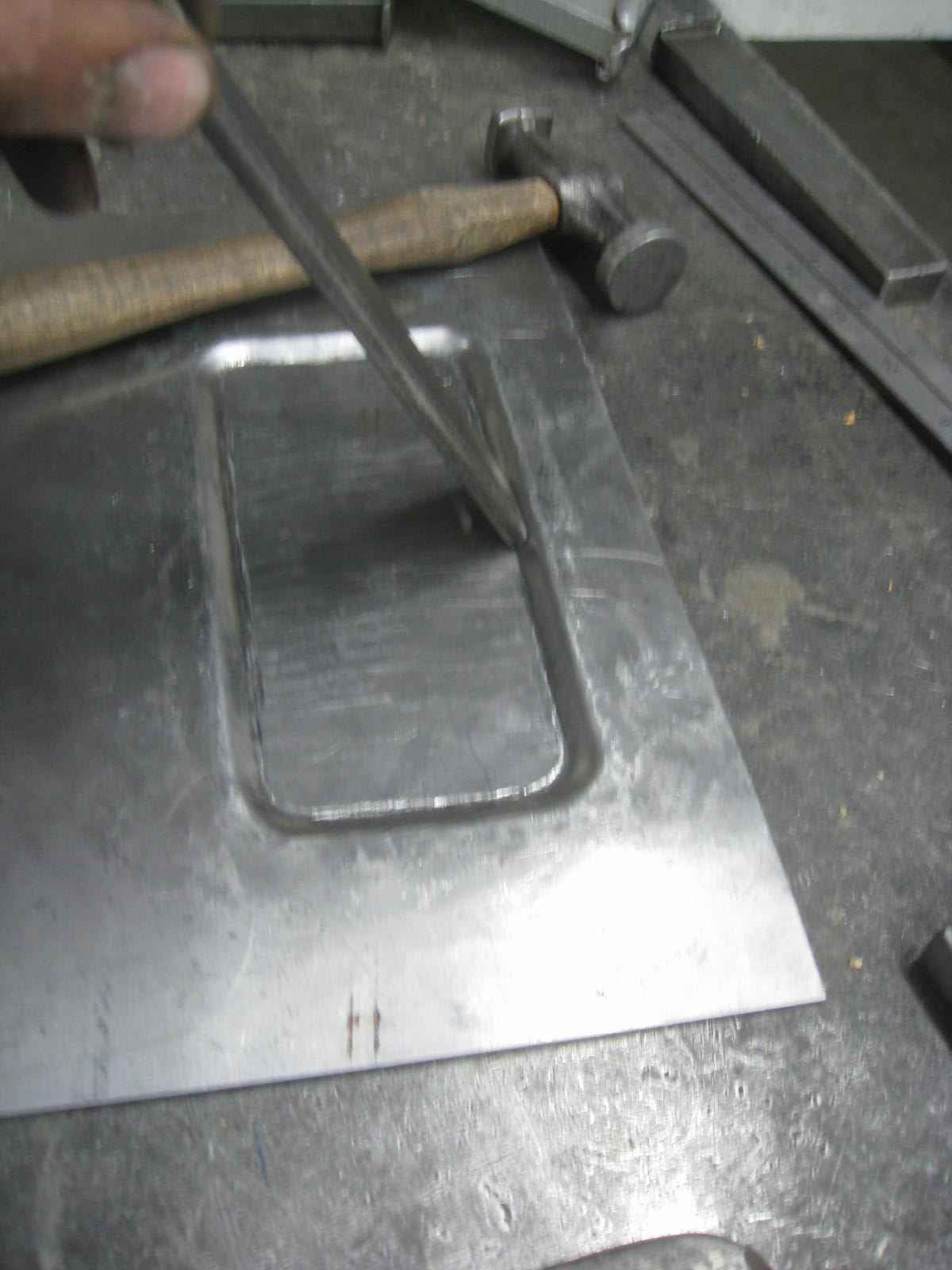

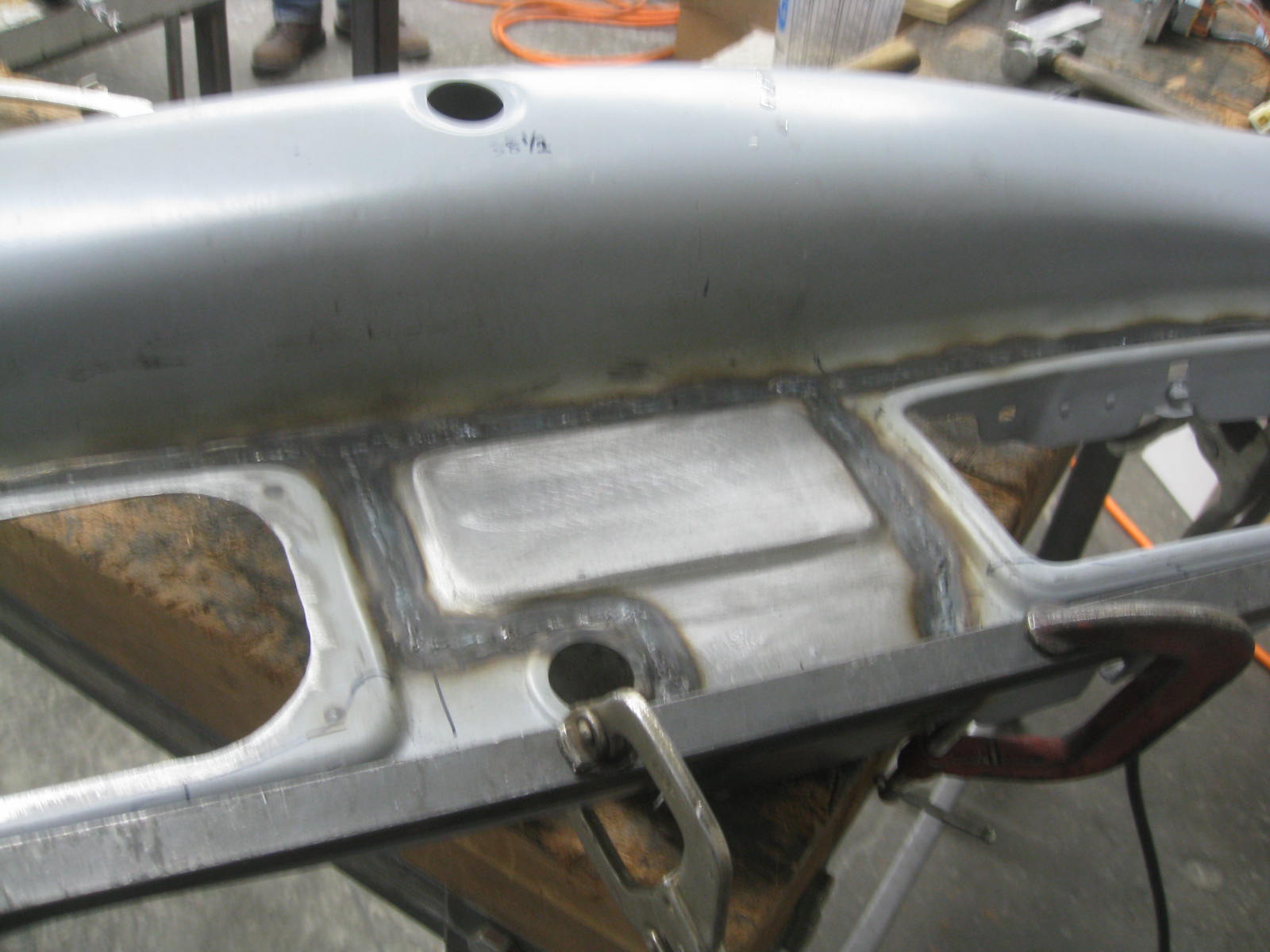

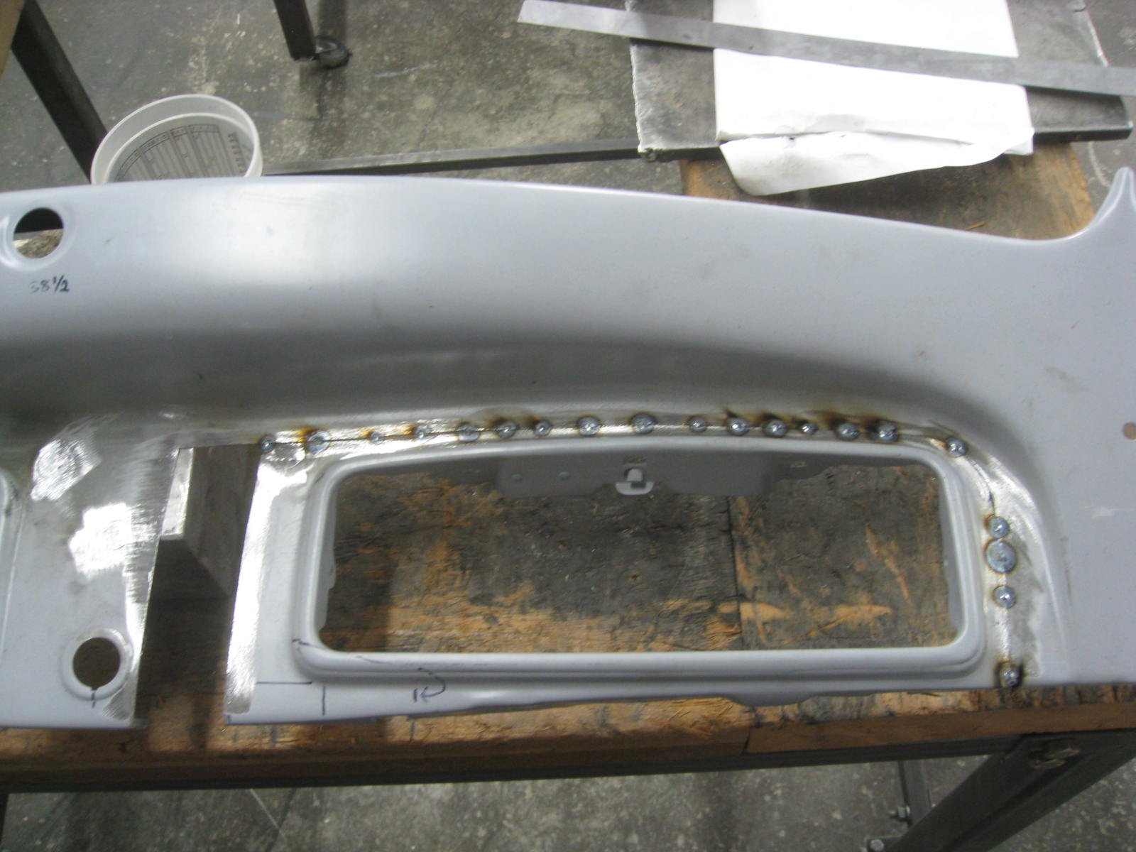

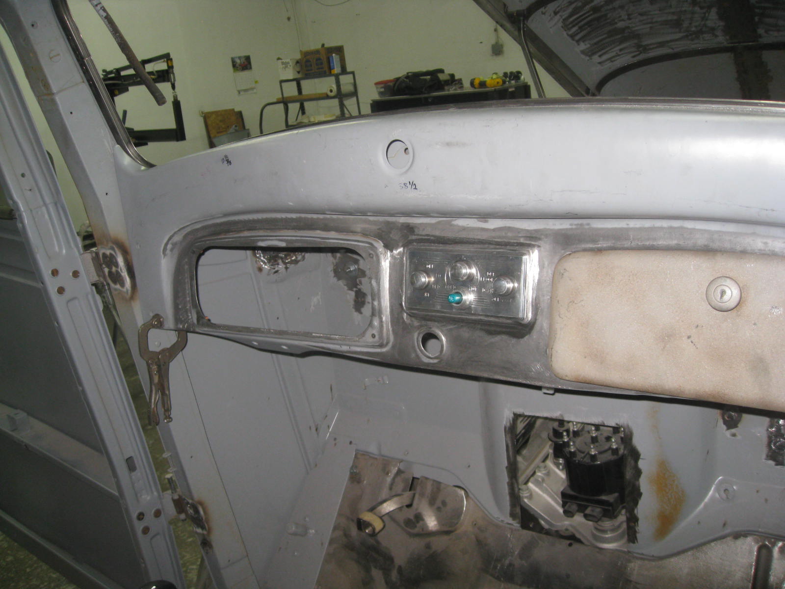

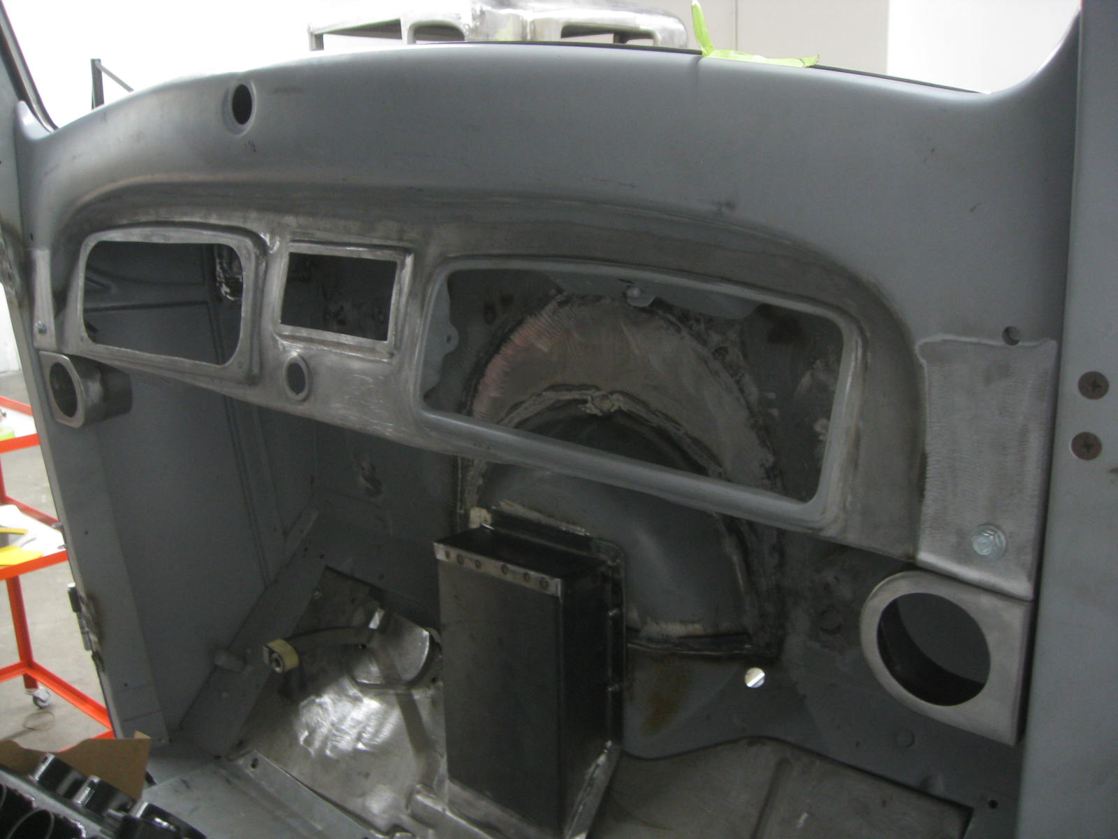

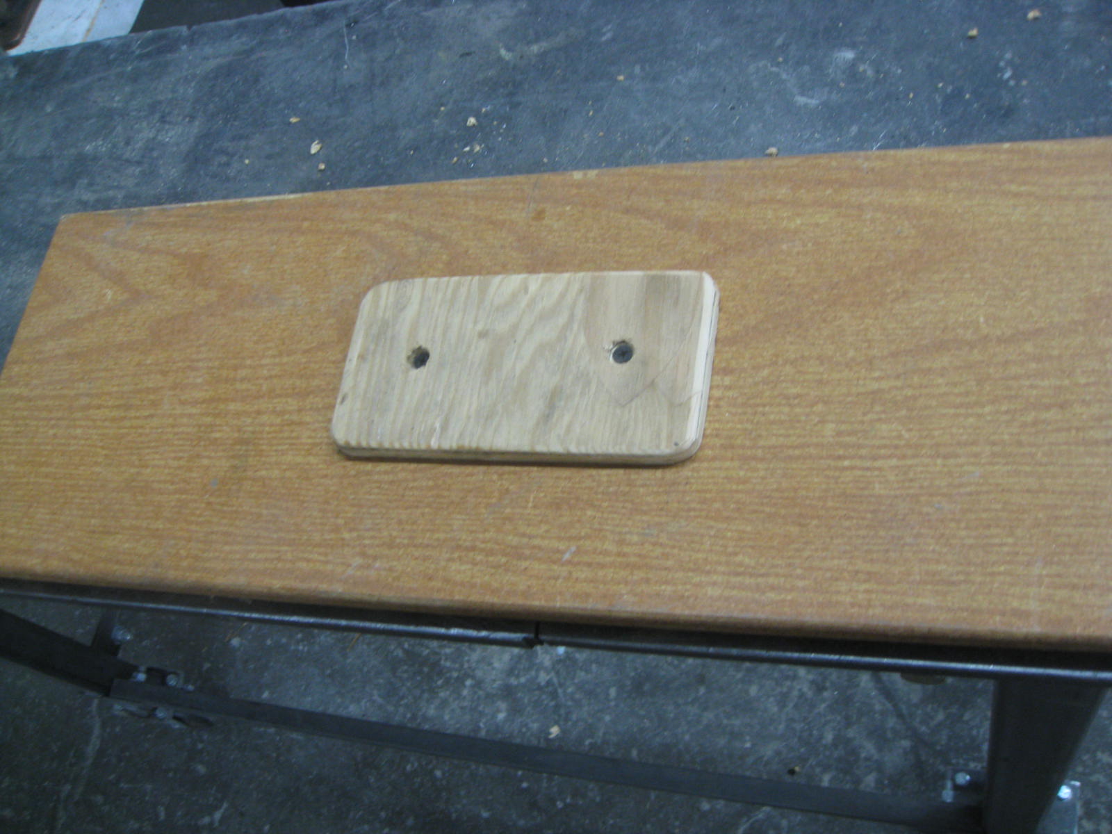

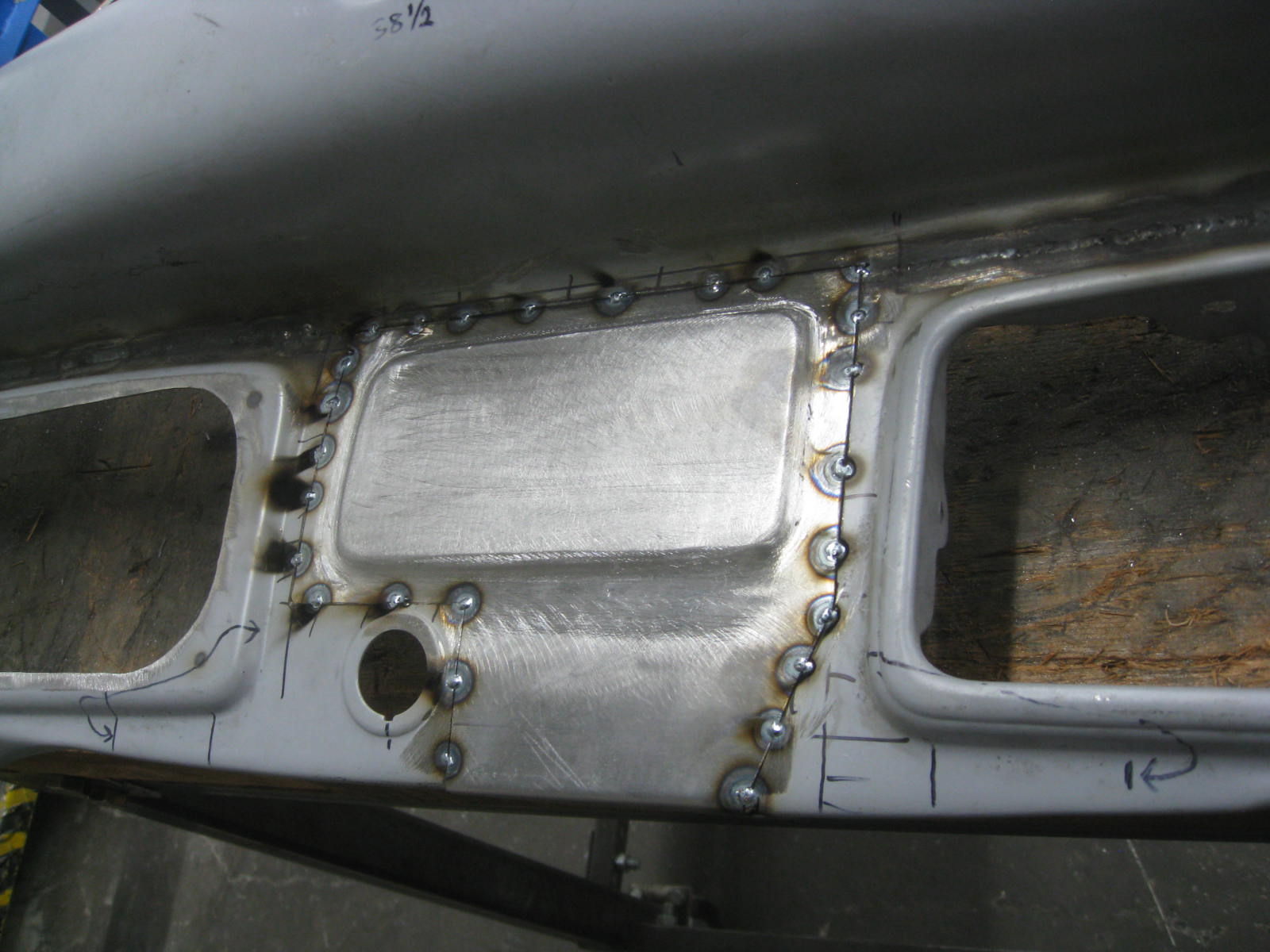

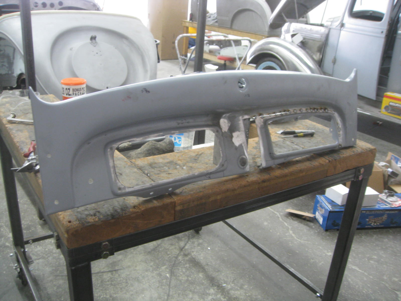

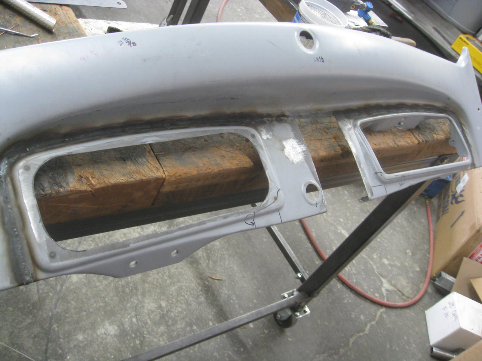

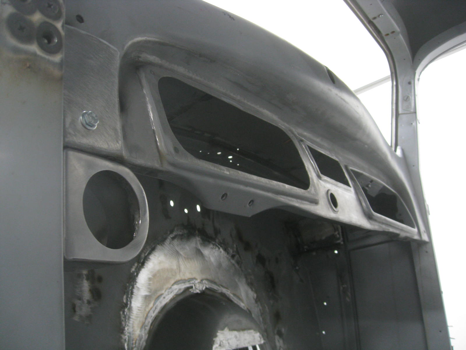

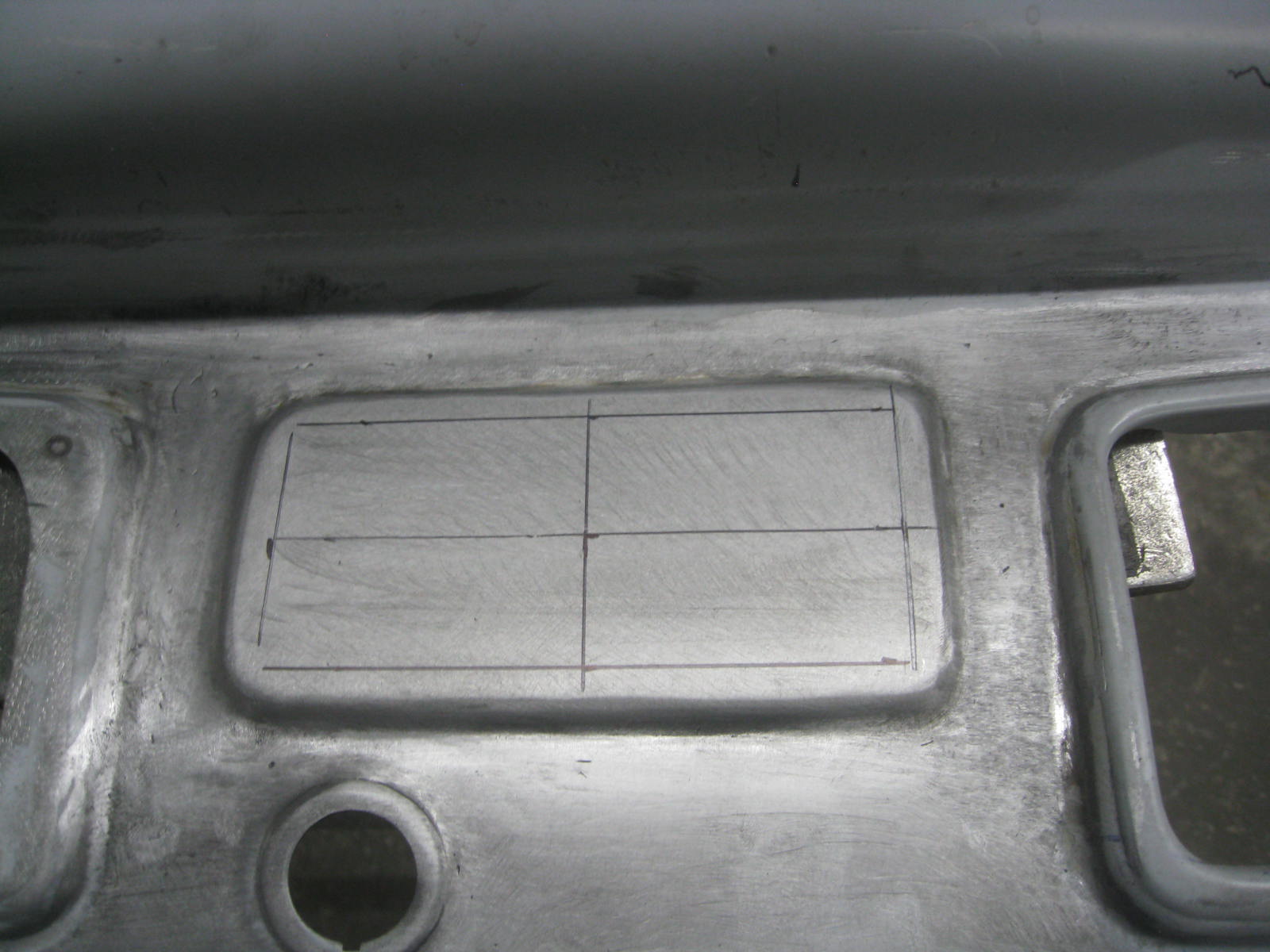

    Onto modifying the dashboard to take the instrument panel.We looked at installing the panel under the dash,but wanted a clean look and the dash lines to stand alone without clutter.
    The panel is actually a cool look piece,and for this panel to fit in the dash face there would have to be some rearranging and spacing of the clock face section and glovebox.To keep in line with the style of the raised sections,i replicated the look for the new instrument panel with the aid of simple wood tooling.
    Pics below show the process.

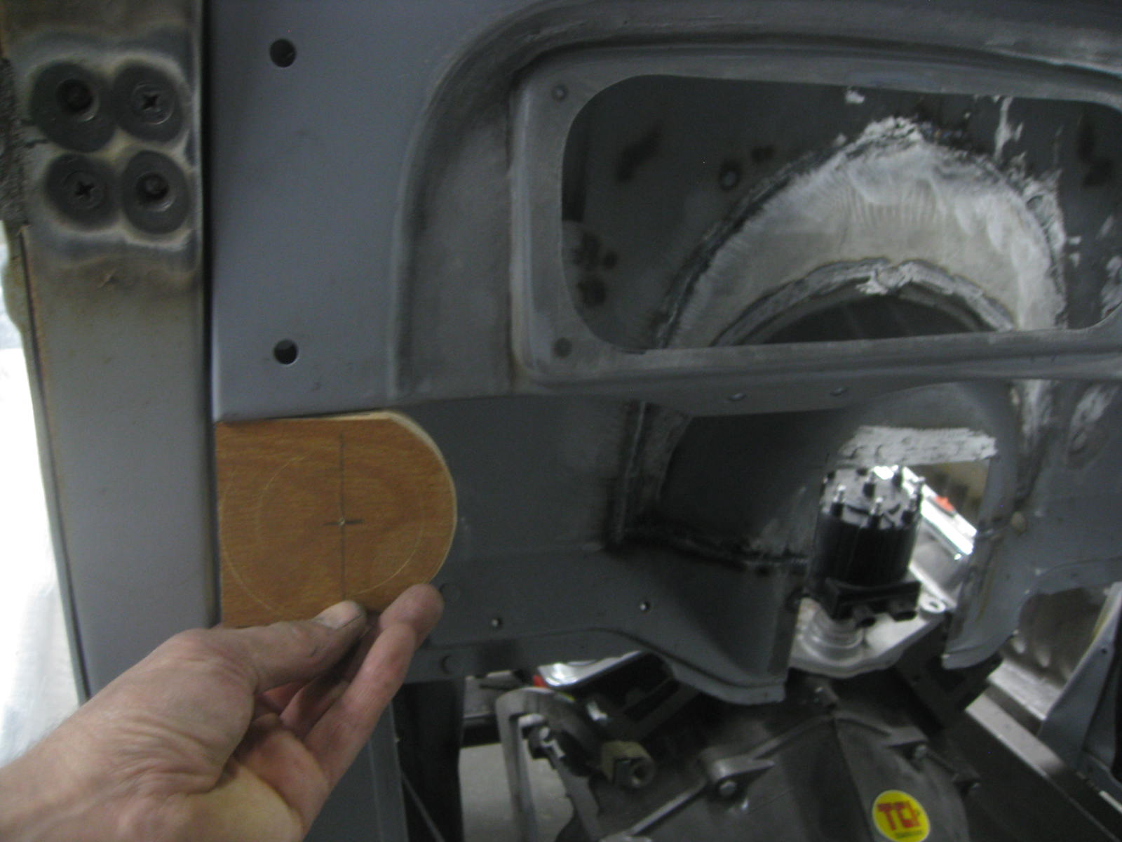

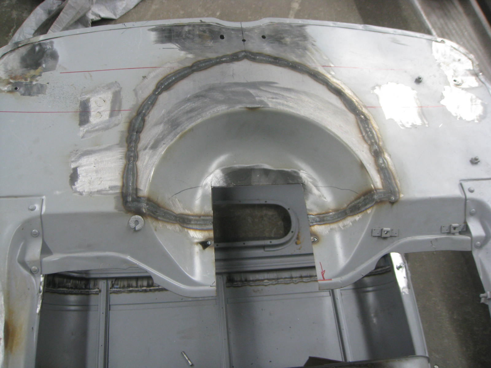

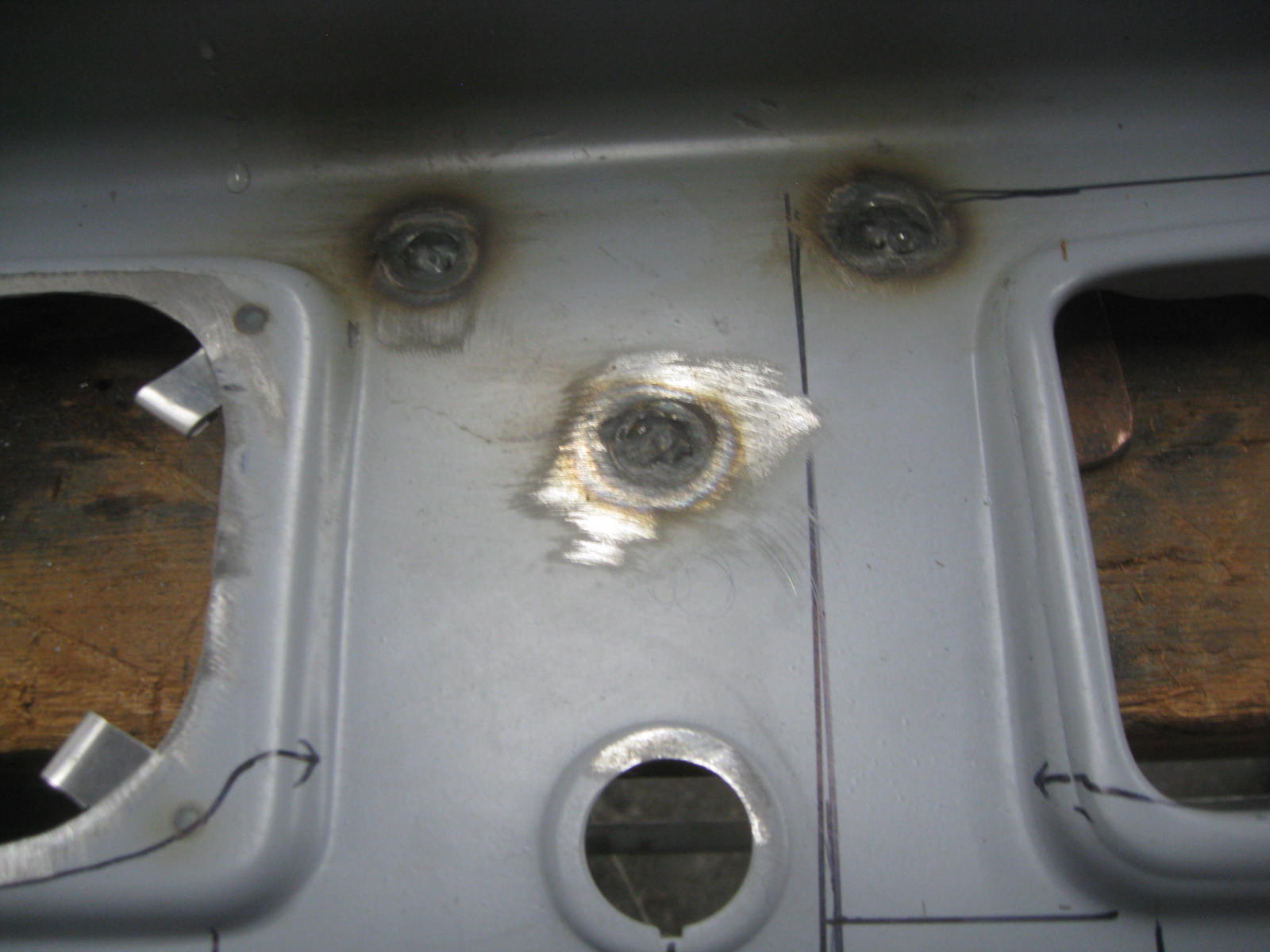

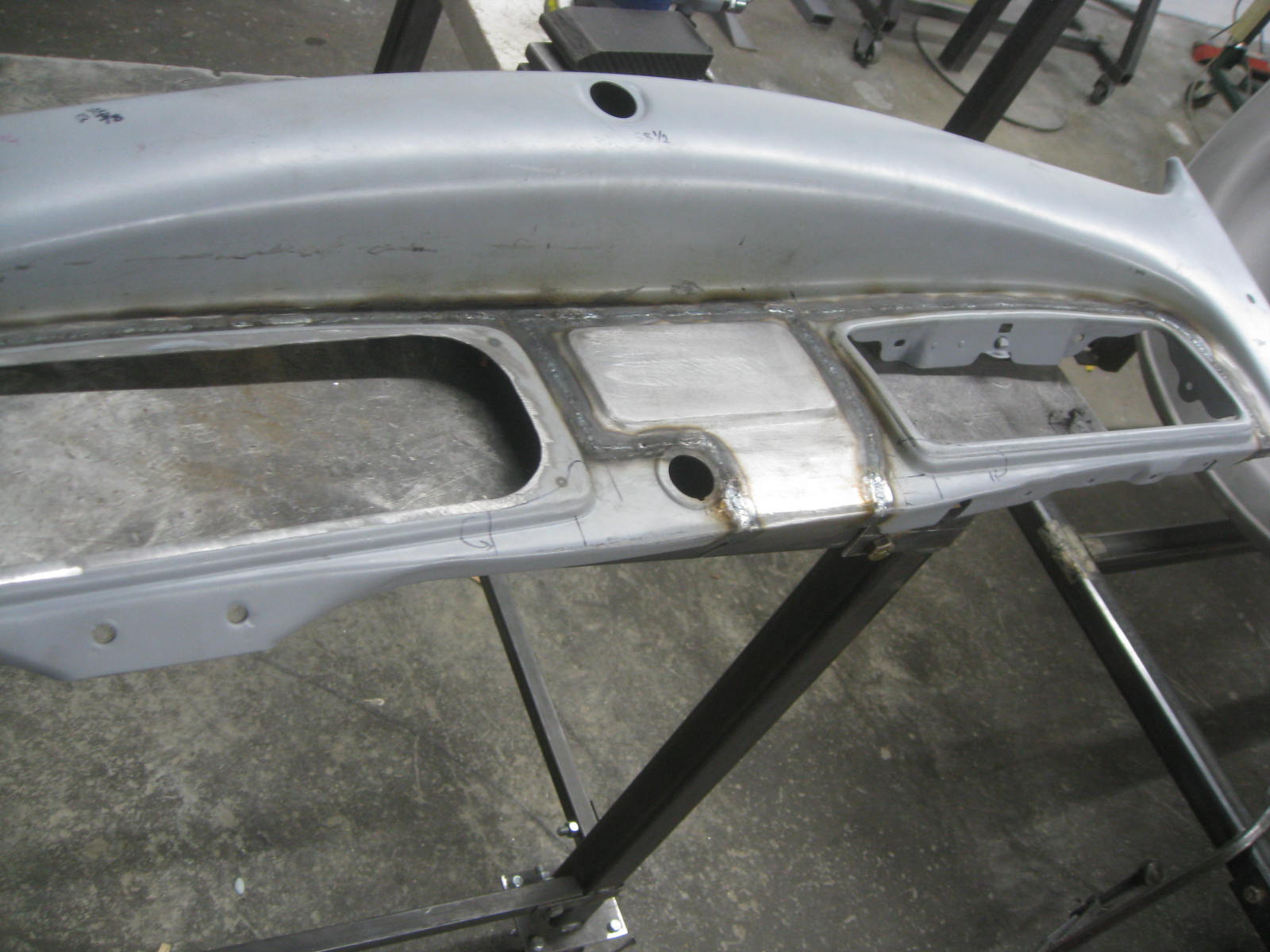

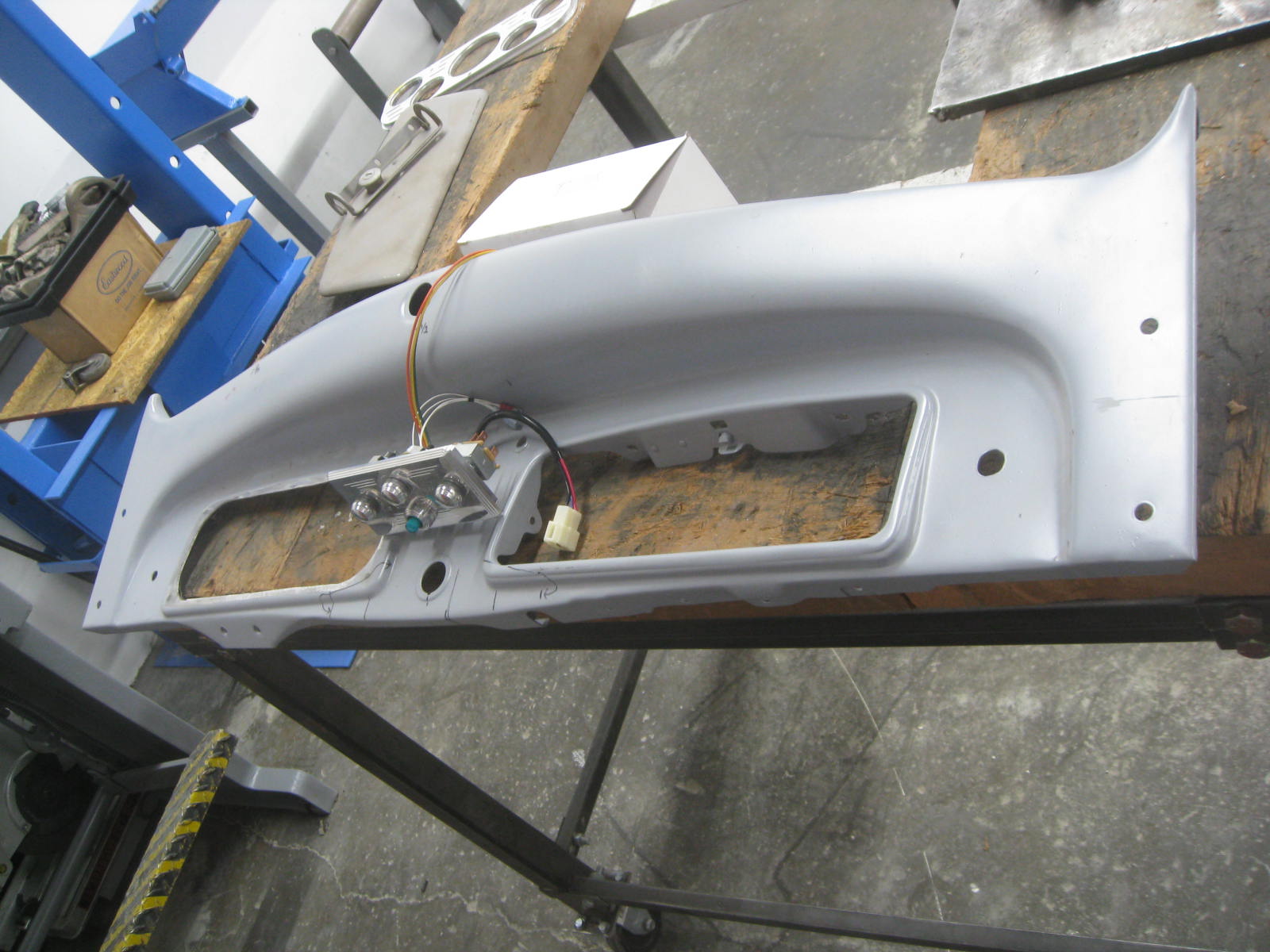

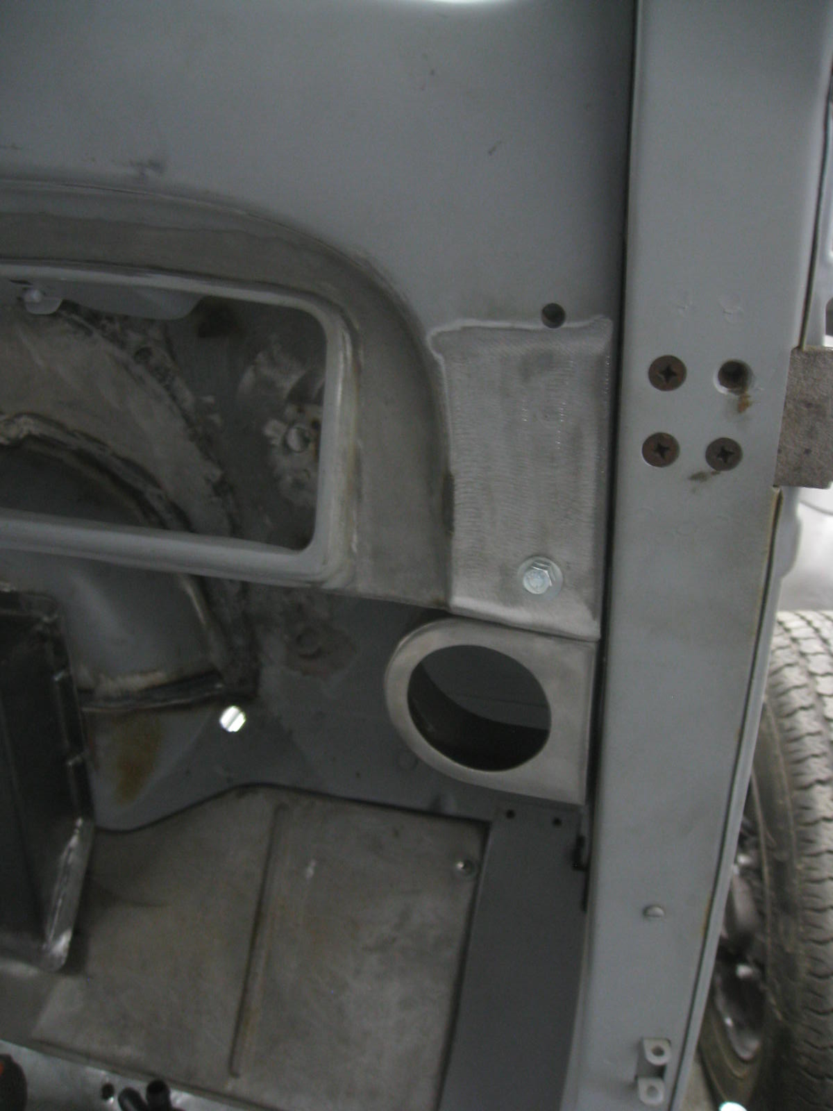

    Next job is to move the depression down as we need clearance under the dash to house the heater,AC unit etc with comfort.Here are the step by step photos.
    my weekly metal work blog www.themetalsurgeon.com

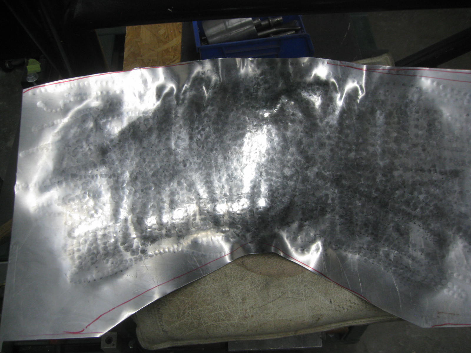

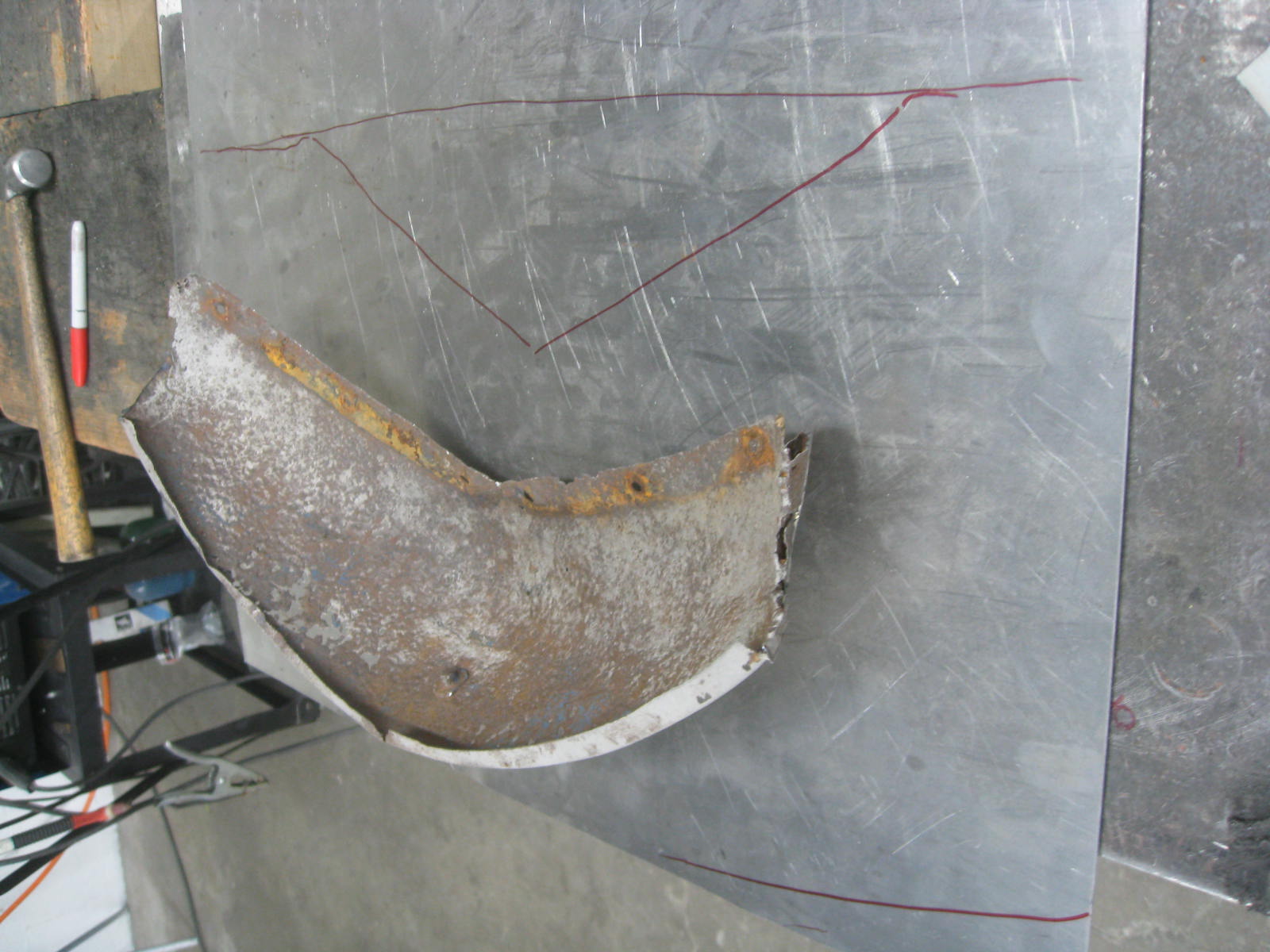

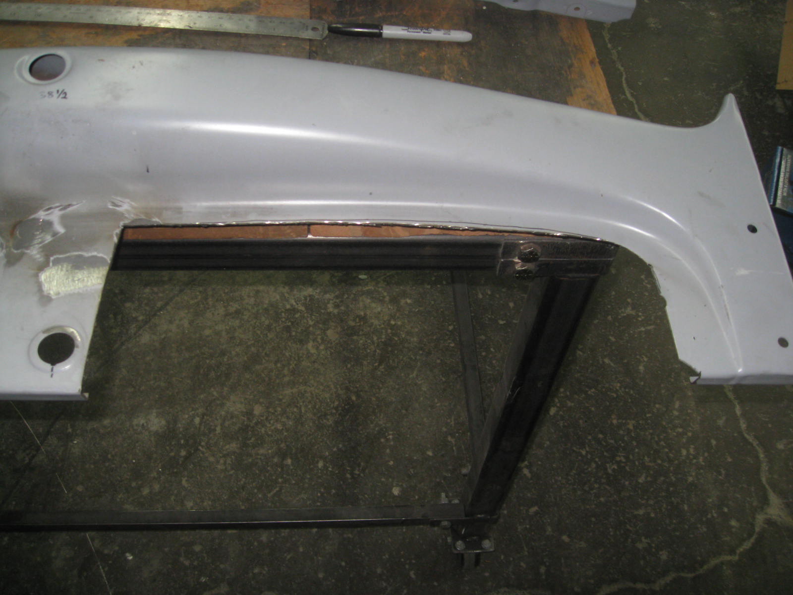

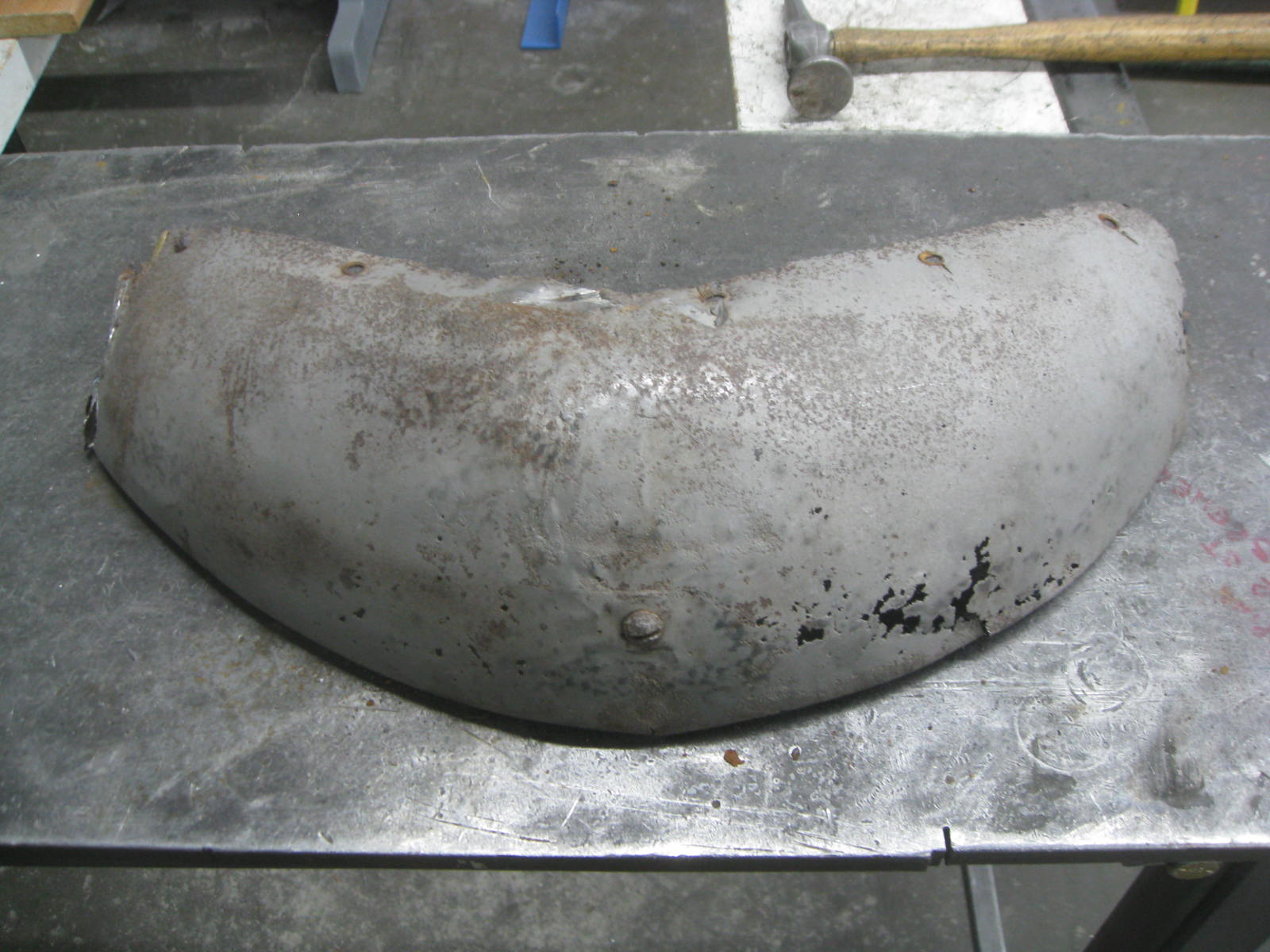

    next up is the panel that sits under the grill.The original is rotted,pitted and weak.There is a replacement available but only in fiber glass.So the alternative is to make one.Here are the first pics of the original panel and beginning process.
