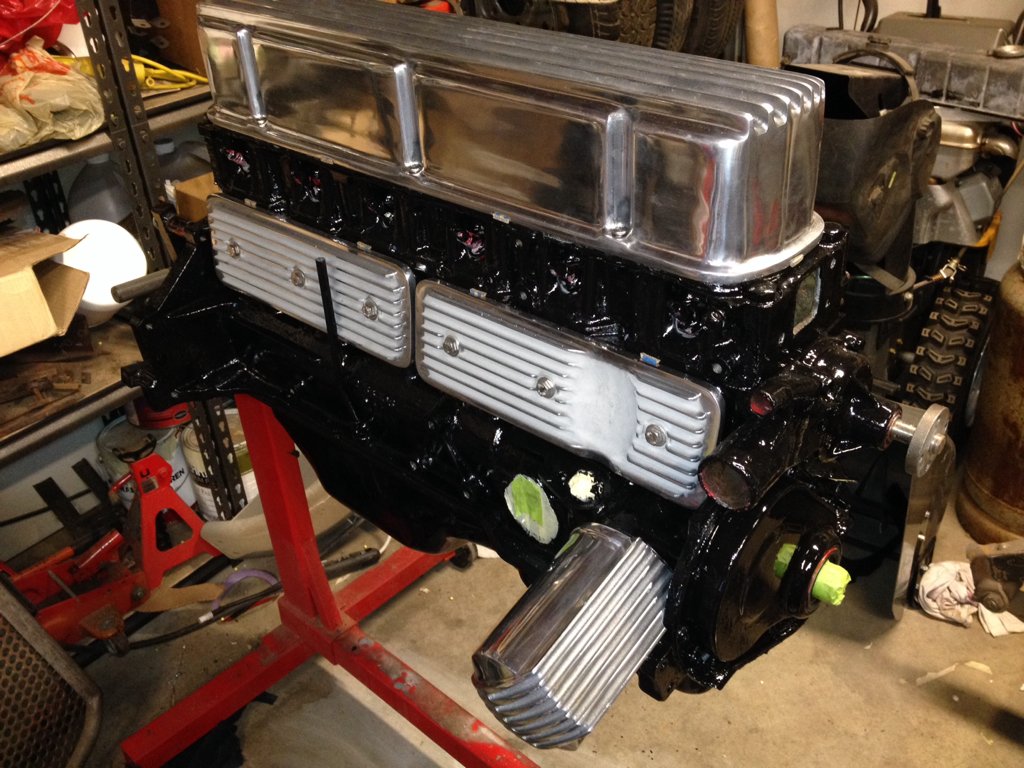

    Well I started back on the ol project. It's amazing how easily you can get pulled from things like this. Also finding more funds to press on is good as well. Been some advancements here and there but nothin noteworthy till I pulled the motor again and painted it up! Have me a chance to bolt on some of the chrome too.

    Another new little problem, that fancy finned aluminum oil filter cover shown above is about 1/2" away from the frame, so no issues with interference but it wont come off with the engine in place....so if I want to change the oil the motor has to come up about 3" to clear the frame....I was not impressed when I found that little jem out, some new modifications are likely required.

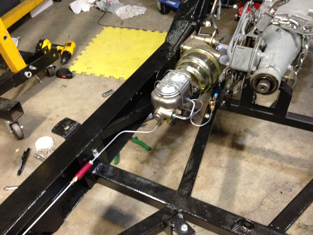

    Been a while since I updated an there has been some progress. Juice brakes!

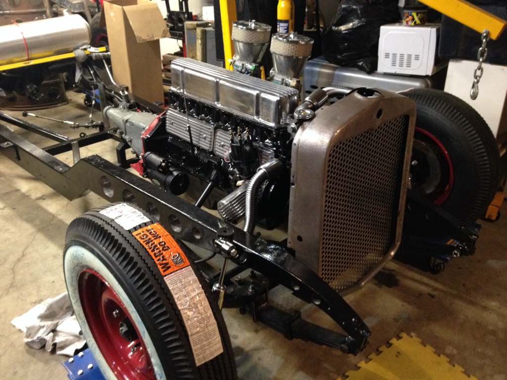

    Also got the rad back from the shop, relocated and offset the fill neck so it was functional and had it re-cored and upgraded to a 3 core, hope that will keep everything cool.

    Rad is in again and plumbed in...mostly

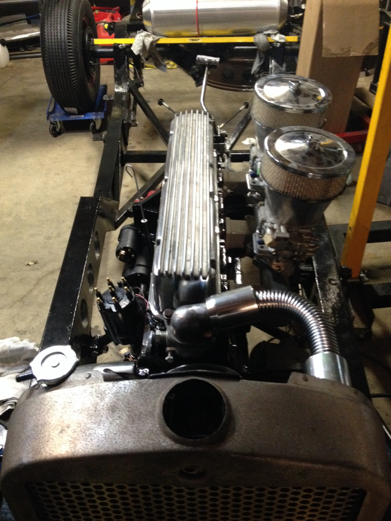

    Copper fuel lines bent, personally I like the contrast!!
    Also got linkage for dual carbs connected.

    Had an idea for cleaning up the plug wires. ImageUploadedByH.A.M.B.1446242262.933985.jpg

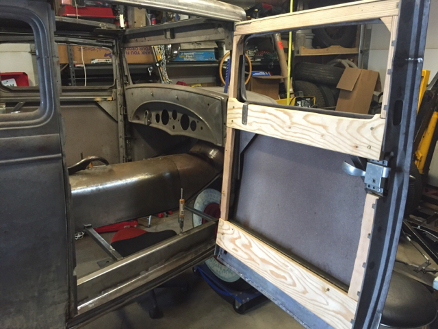

    Another door pic

    How do you feel about your pedal situation? I'm torn on what to do with my 29' Chevy. When it was rodded in the 60's, they used swing pedals and a firewall mounted clutch/mc from a Chevy truck. I wanted to go under the floor as you have with a dual reservoir mc and hydraulic clutch but your pics are making me think twice. I'm running a 327 with a Saginaw 4spd. so there isn't much difference between our setups. Can you post up a few more close up pics? Also interested in seeing your steering box setup

    I love the timber work,looks great ,there should be a great aroma inside,what timber is it ?

    It's all Fir. Figured that would be close to original material.
    I can get more pedal pics once it's together again they are in pieces all over the garage now but yes very close proximity.

    its got nice grain,what was the original timber
