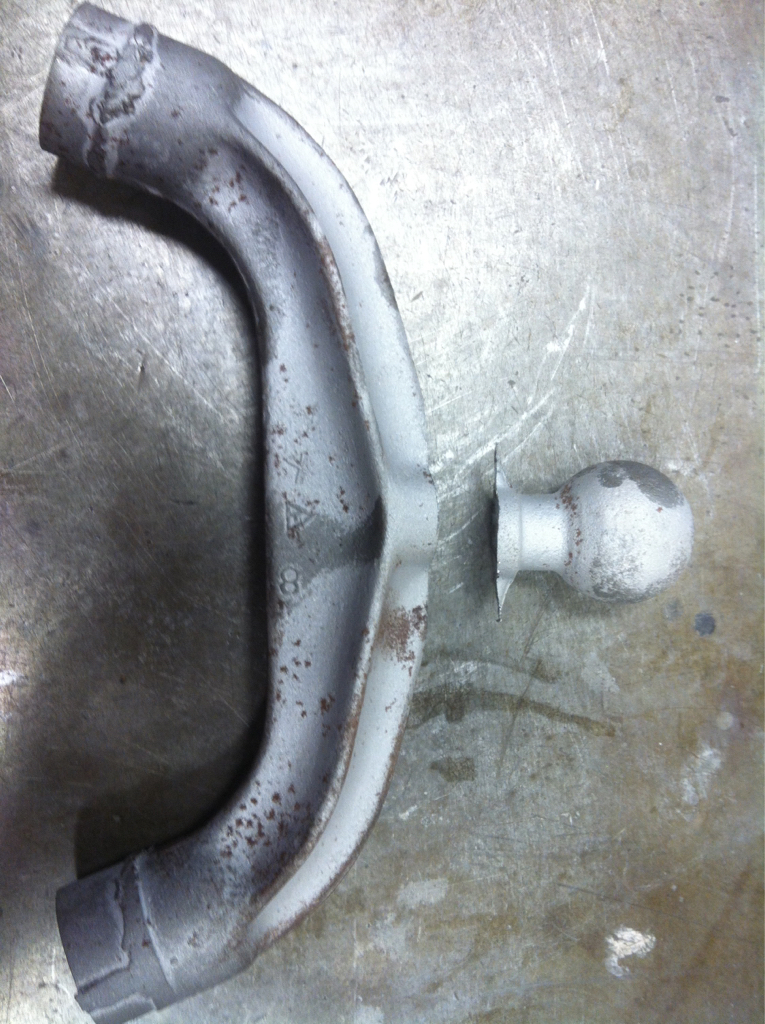

  26. This is the johnny joint I'll be using at the front of the rear wishbone
    Durbinspeedshop and Dog_Patch like this.

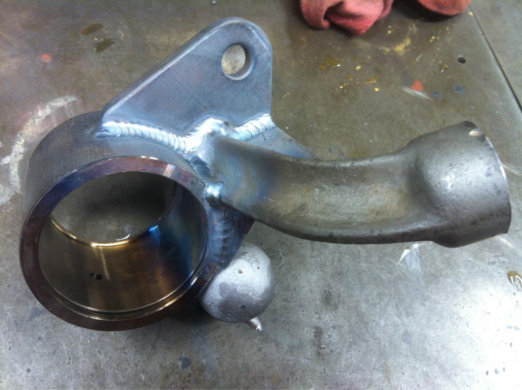

  27. Used the yolk from a 32 front wishbone and we welded the johnny joint to it to tie the 36' rear wishbones together.
    Dog_Patch, lothiandon1940 and Blues4U like this.
  28. We welded a gusset on the yolk with a hole in it for a possible future torque arm
    Okie Pete, Spooky, kiwijeff and 8 others like this.
