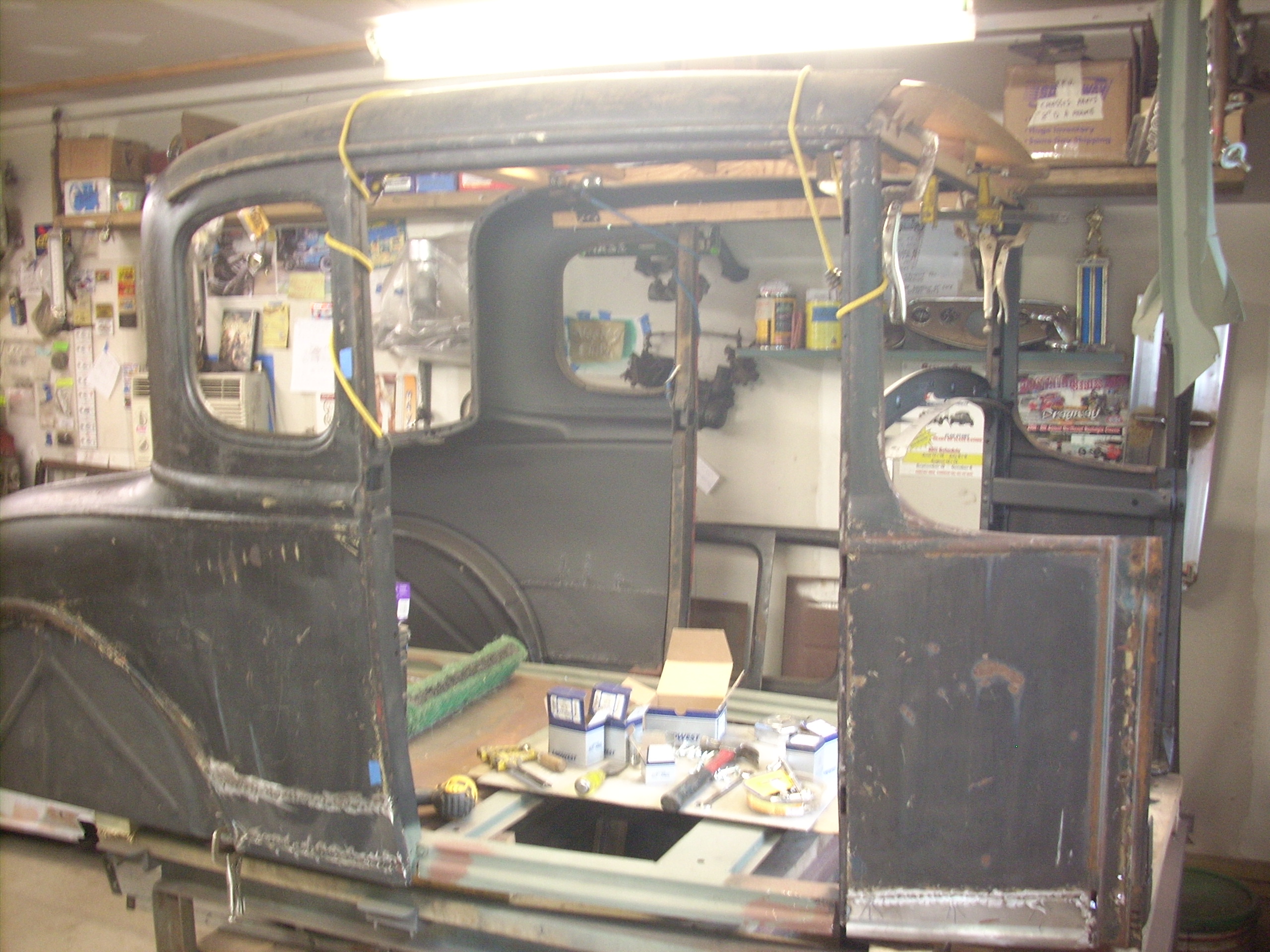

  15. Okay, let's get you going on that body. The first thing I would do is get the body squared up. Now This Being A Model A they have some pretty big tolerances. You don't have to be exact down to the 16th of an inch. But the more exact you are the better your finished product will turn out.
    I would concentrate on getting the doors to meet the body line on the quarter and get them squared up in the door frame. Once you have those in the right places I would use some square tube on the inside to brace everything up and tack everything in place so it remains square when you take the body off. You should basically build a cage inside the car to keep it from collapsing on its self when you remove it from the frame to fix the, subrails.
    Once it's all square and sturdy, remove the body, so you can rebuild the, subrails. I would build these on the frame and remove all the, rust garbage from the, coupe and plop the body on to the new subframe.

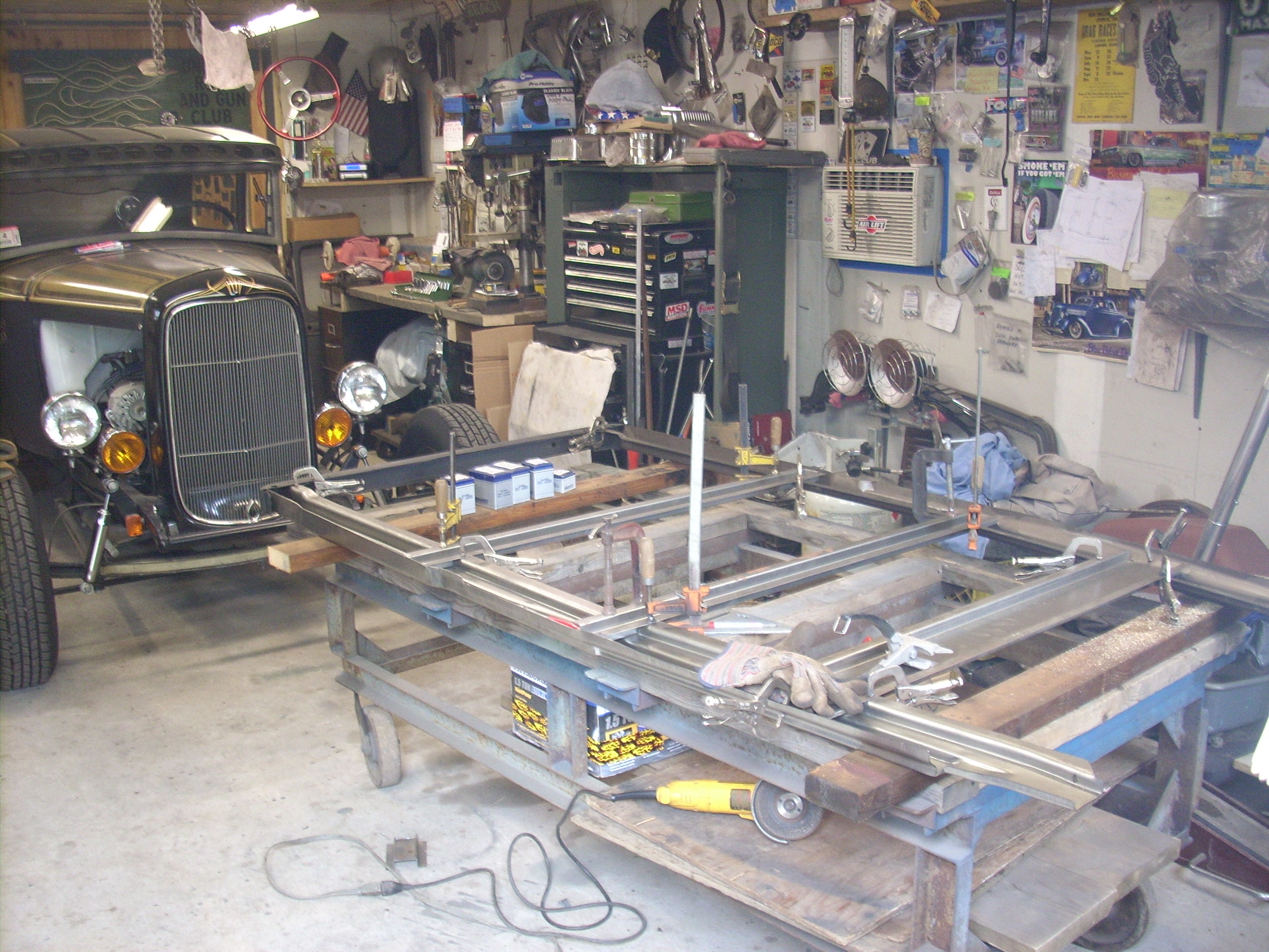

  17. 31Apickup
    Joined: Nov 8, 2005
    Posts: 3,379
    31Apickup
    Never2low, patmanta and BenLeBlanc like this.
  18. I think I saw that before, but I like it! For some reason I really like that kind of work. I really should find out if they make those tables or if it is easy for me to make!

    You just need the measurements and you can make one.

    You can build it any-which-way you want to as long as it does the same thing. You could use an old bed frame or wood with metal bracing, as long as it holds its shape. The 2" tubing shown in the article is probably the simplest way to go. You can probably go to Metal Supermarkets in Woburn and puck up the tubing cheap enough. You can get casters from HF online or in Medford, Salem NH, or Danvers. You'll want something no less than 3" and at least 2 with brakes.
    I'd focus on designing and constructing this rig rather than puttering around on those wheels; the best way to get things done is to figure out what's preventing you from moving forward and attacking it. You can email the guy who wrote that article and ask if he will share his measurements and/or design with you. The link is at the bottom of the page.

  24. Buy the kit if you want it stock. The sub rails are fairly complicated to make your self. Or if you don't care, start welding!!

  30. I'd strongly advice firstly in finding someone who's built a Model A before thats local to you. Secondly, buy the Brookville full subrails and looks like you'll need the cross pieces, as well as the toeboard angled pieces. You might be able to use your original "heavy duty crossmember" - its the one at the rear of the body, with the two holes in the center at the back.
    I'd also get a big large table, and put the subrails flat on it and your cowl and get it all squared up.. then build up from there.
