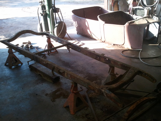

    Today I finally dragged my '21 T Touring body into the shop, along with the '30 Model A frame it will sit on. It wasn't quite a year ago I picked these up from an older gentleman with a backyard packed full of cars, trucks, and whatnotall.
    I'm not trying to reinvent the wheel on this build, just putting together a fun rod to cruise around town in.
    The plan (or whatever we should call this mania which drives me :D) is this:
    '21 T Touring body placed upon the '30 A frame, powered by a newer Ford 302 sb with a BW T5 manual turning a 9 inch out back. Suicide the front axle, and hook up all 4 corners with juice brakes. I still haven't decided what up front to achieve the juice with, so any thoughts are welcome.
    This isn't my first rodeo building a car from the ground up, but this is the first pre-war rig I've built for myself. Should be fun! :cool:
    Here are some pics to start, and I'll update as often as I can.

    Thanks for the tip, DrJ, but those numbers are long gone. LOL This frame is solid, but surface rusted. I'll be sandblasting it to clean metal this week so I can begin narrowing it a touch, building motor mounts, and boxing it in.
    Any thoughts on the narrowing, folks? My plan is to unbolt the rear cross member and just drill new mounting holes, then trim the ends of the cross member. The front is more involved, of course, as it welds into the rails. Is it better to section from the middle of the front cross member, or could I just shorten the ends and weld new tabs in place? The other thought is to just lose it entirely and replace it with straight tube. The spring perch is not an issue, as I'll be building a new one to move the axle forward of the frame.
    Thanks, all. :)

    Don't narrow the frame and then find out your radiator won't fit between them...
    Don't cut X members in the middle.
    All frames twist, and may twist your welds in two.
    I posted a picture of a serial # above.
    If that's rusted away on your frame you don't have much frame left...

    Howdy, y'all. A bit of puttering today ended with a sawzall. :D
    I started by setting the tub up on the frame to see how it all set together. The good news today was that the front will only have to come in about an inch, and the rear just needs a small tweak as well.
    After surveying the corrosion damage to the body I decided that as cool as a touring would be, it would also be far more work than I want to put into this body. Weighing my choices, I realized it will be less work to build a pickup box for the T than it would be to rebuild the bottom half of my tub. A couple snips and this was the result:
    Judicious use of the torch and a hammer popped the hinge pins loose for the rear doors. I was glad not to have to chisel the old hinges apart. :)
    I'm getting closer to a real plan with the rig, too. :) I'm not going to channel the tub over the frame so as to retain room for my size 11's (more to avoid an overly large trans tunnel). I'm shooting for 9 inches of ground clearance below the frame, which will give me 7 inches of clearance below the oil pan. The engine will be riding a bit high, but not too high, I feel. The output shaft will be centered vertically with the tops of the frame rails, which is in my opinion the best compromise between ground clearance, minimizing trans intrusion into the cab, and keeping the center of balance low.
    *Anything at all resembling a plan is subject to change based upon rational thought, necessary compromises, which side of the bed I woke up on, whatever tickles my fancy at that particular moment, and if the wind is blowing.* :D
