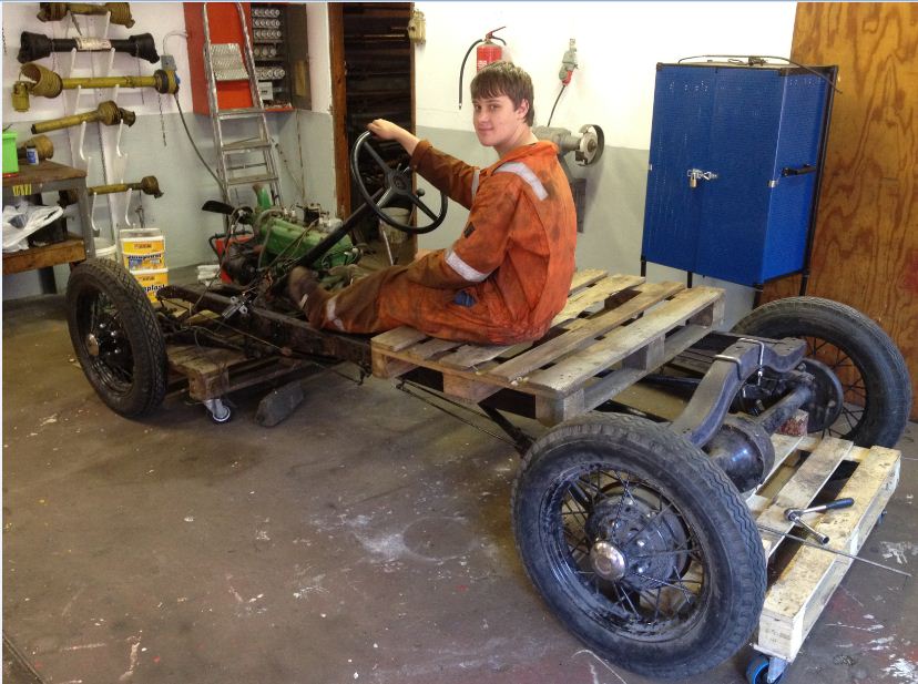

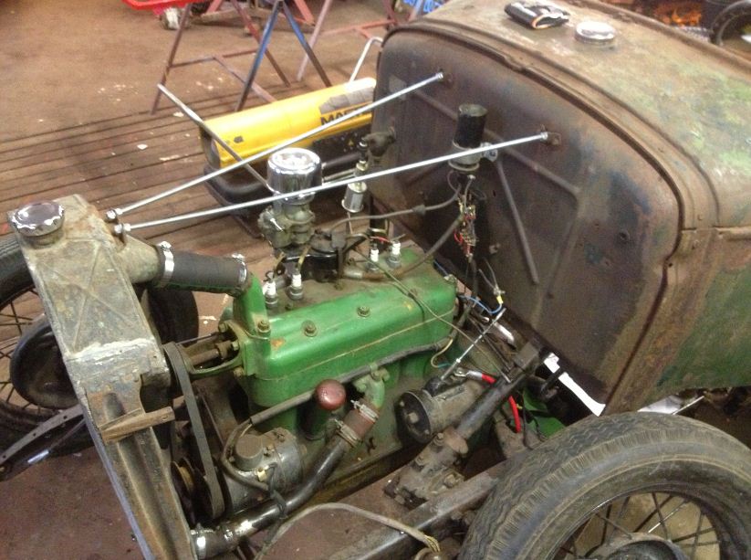

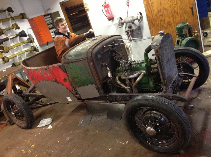

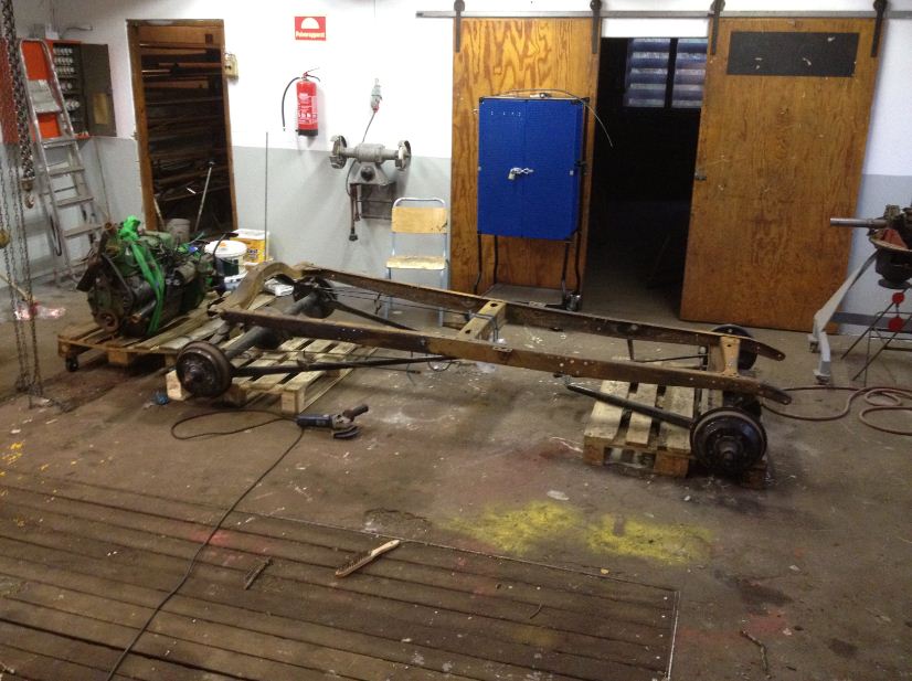

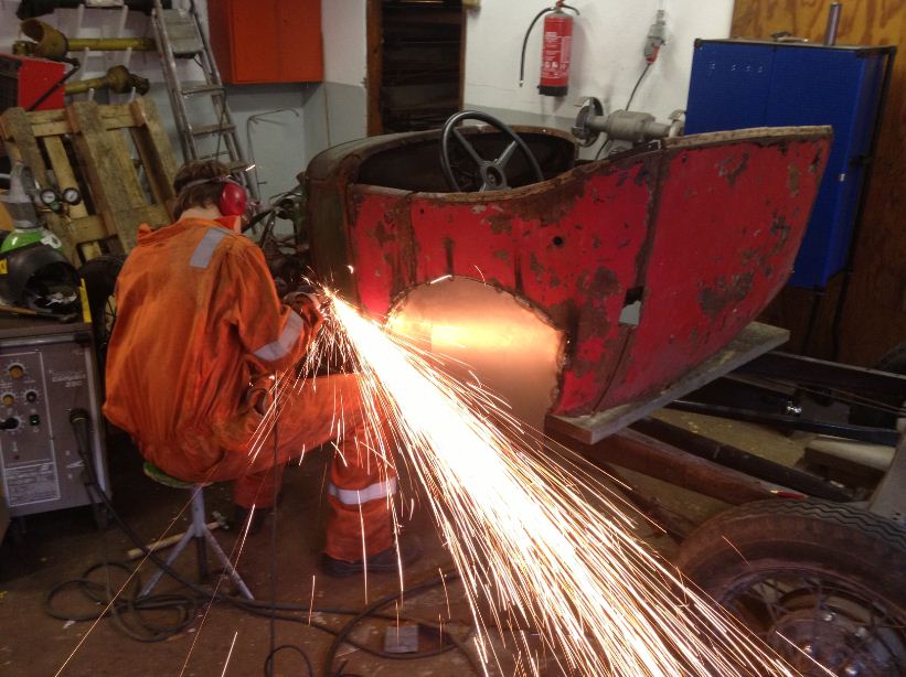

  15. Hello there! :)
    I was 16 when i got the frame for my car, my dad said the same as yours, but as my parts pile grew we had the best father-son time ever.. now 3 years in the build my car is nearly on the road, drive it everynow and then, its a blast!
    we have snow 7 months a year over here, but ill still use the car as much as i can! :) here is a few pictures for you for inspiration:
    This is what 2-3 years of weekend fun and 6500$ looks like to me! :) but i newer did spend more than 1600$ at one time, and that was the most expensive parts.. i got the remains of a rodbuild (he was building a 350 in his model a)
