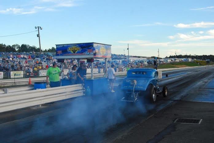

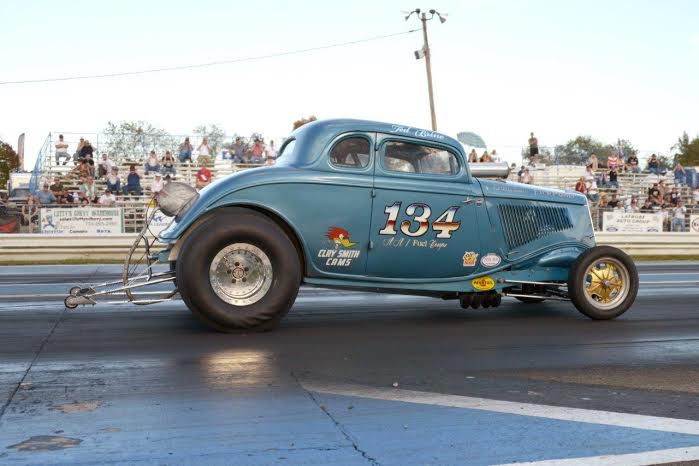

    Made a couple more passes at Pittsburgh Raceway Park's Pittsburgh International Dragway (long gone) reunion late in Sept. Between Epping and PRP, with help from Mark Becker (I was on a business trip to KC), Jeff Little chassis' and Tom Hemphill Racing Engines, we made up a stouter center steering link with heim ends to stiffen up the steering more. Also made some modifications to king pins to get a true reading on caster - it came out at 6 degrees and set toe at 1/8". Made alky pass, burnout and backed up, staged in low and launched. Got up on tires and peddeled, shifted to high and stretched it a bit - all was fine, Went straight as string and stopped. Next up, a nitro pass in high gear with 70%. Just fired, staged and left. Car left OK and then hazed tires (lots of tire pressure for safety), peddled and then climbed back into throttle. Engine pulled like a freight train until all the powerand the clutch came in together. It again hazed tires and made a move to center of track so, lifted and it snapped straight like a good ole thing. Seems we got a race car again! Now, we can focus on clutch management to either smoke em (heavy counter weights) or drop tire pressure and lighten clutch to launch. Off to Bakersfield this weekend and that will be an adventure for us "easterners"! Goldy, Pete Coffield and one of our new buddies from New England, Mark - will join us there. Been a long journey but making it back!! Photos from Pittsburgh Raceway Park two weeks ago!

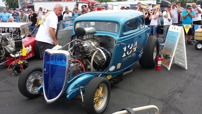

    Couple of more recent photos - @ Don Schumacher Racing where we were invited to participate in their cackle event during the Labor Day NHRA nationals. Think the thing is loud? Check folks in background!! 2nd photo is of Patty DiCicco - her dad, Ron, drove the old Mooneyham & Sharp car and she came out to see us and tell us stories about her dad!

    Two more photos - first was sent to me by a gentleman who saw us run in Milan in the 80's. 2nd was from Pittsburgh Raceway Park two weeks ago. The more things change, the more the stay the same!!
