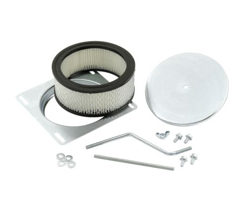

It's one of these, a hilborn "style" scoop. The air filter kits come with one of these little 4in dia filters.
I was thinking Maybe a panel style across the front or something like it. Anyone got any ideas? thanks
I seem to remember K&N making slip-in type filters for prostock type scoops. Was just wondering if theres something similar.
I know i see these on blower motors (in the 2x4 style too). But i also know a 14in airfilter works best in general. Are these just that much of a looks-vs-performance compromise?

The standard Mr Gasket replacement element for those scoops measures 6.5" x 2.5" tall, part #1485. I use K&N part #E-3260, which specs at 6.375" x 2.5" tall, but if you set one on top of the other they measure the same - just under 6.5" diameter. Last ones I bought were just under 30 bucks each, but they are the washable/reusable high flowing filters. I use them in an older MPH brand scoop, same as a newer BDS, but these filters will also work on those fake Enderle style scoops with the butterflies. Here's "Roman" modeling one of mine,Lol.

Ahhhh 6.5" x 2.5 is a little better than i thought they were, With a cotton-gauze type filter this may not be terrible. Even that screen you guys are talking about, I could sandwich one of those "Proflow" type foam filters between two screen and leave the filter out. Hmm.
Have you ran these K&N types in the MPH scoop yet? I'm interested in how much it throws A/F mixture off once RPM's start to climb.
This isn't a max-effort engine, but...It hard for me to do something in which form leads function.
Thanks for the info so far guys, appreciate it.

First off you can't run a filter media across the front opening, as the bases for these scoops don't meet and seal off air from coming up from the bottom side. Second, a less restrictive filter might let them breathe better, but I'm running these same filters on two different cars, and never felt like they were starving for air. One is a 464 BBC with around 550 hp, and it's running fine. If I was really worried I'd take the filters completely off when I race it, but I haven't worried enough to do so yet.
If you look at the size of the air opening on those scoops, I'd bet that the filters will flow as much air as the opening will allow in.
