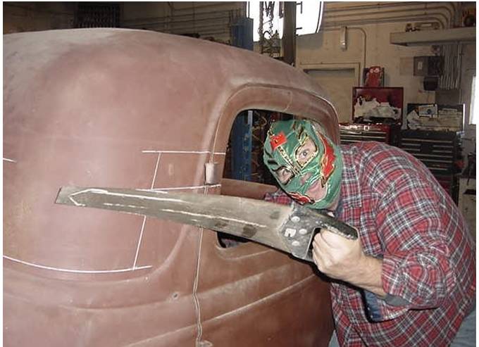

    So lets get into this. This chop technique is not new by any means but it should be noted that there are several ways to chop the top of a 32-34 ford and I hope to explain the differences.
    Street chop: what I did, lowering the top and adding to the roof section to make the A pillars apear straight.
    Lake chop: chopping a bit more and bending the A pillars to make up the difference in length making the front glass lean back.
    I did the street style because it always looked better to me and I also had another roof to cut the needed metal out of.
    In this picture you can see that I am going to cut the 3 inch section out and then go straight down and cut across the belt line of the back of my roof. Once the top is cut this way, you can slide the roof into the body without having to re-weld and re-form the dome section of the roof.
    I have a good friend that cut straight across the rear portion of the roof and is still messing with the re-shaping process!

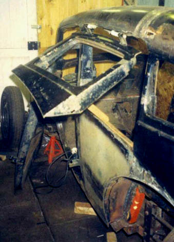

  3. were are we? oh yeah, now you have a chop you like so lets cut the roof in half and make the A pillars match.
    This is where guys like Gene Winfield show their shit because they make all the needed pieces by hand. I had the center section of another coupe and after taching the front in place, I measured and cut original 34 ford steel to put in the void!
    I also used the same technique for the doors.
    with a little tapping and slicing, the back lines aleady look pretty good.
    Notice the large piece of stock used to keep the roof straight as the welding is going on.

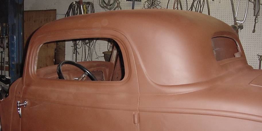

  5. So, after about 60 hrs. of smacking, sanding, and pounding, you should end up with a roof that looks bone stock. I am real happy with the results of this chop.
    I was lucky to have a doner roof to steal metal from. That probably saved me about a weeks worth of work and it would never look as good.

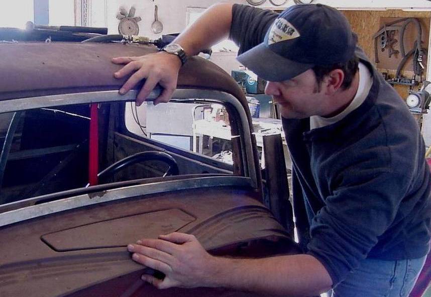

  7. the front window is kinda easy. By simply unscrewing the frame and pulling out the corner braces, the frame can be re-chopped at 45 degree cuts and the corner braces are then slid back in and screweed together.
    In this shot I am re checking the fit before it goes to the glass guy.

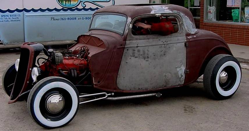

  10. well thats it folks, this is a shot of Chopper Vern's super chopped 34in the lakes style. The chop is not hard either way you decide to do it. The hard part is cutting up a body you just payed ten grand for!
    Take your time and do your homework over and over and over! I studied this car for 25 years and I am only 32! I love 34 Fords.
