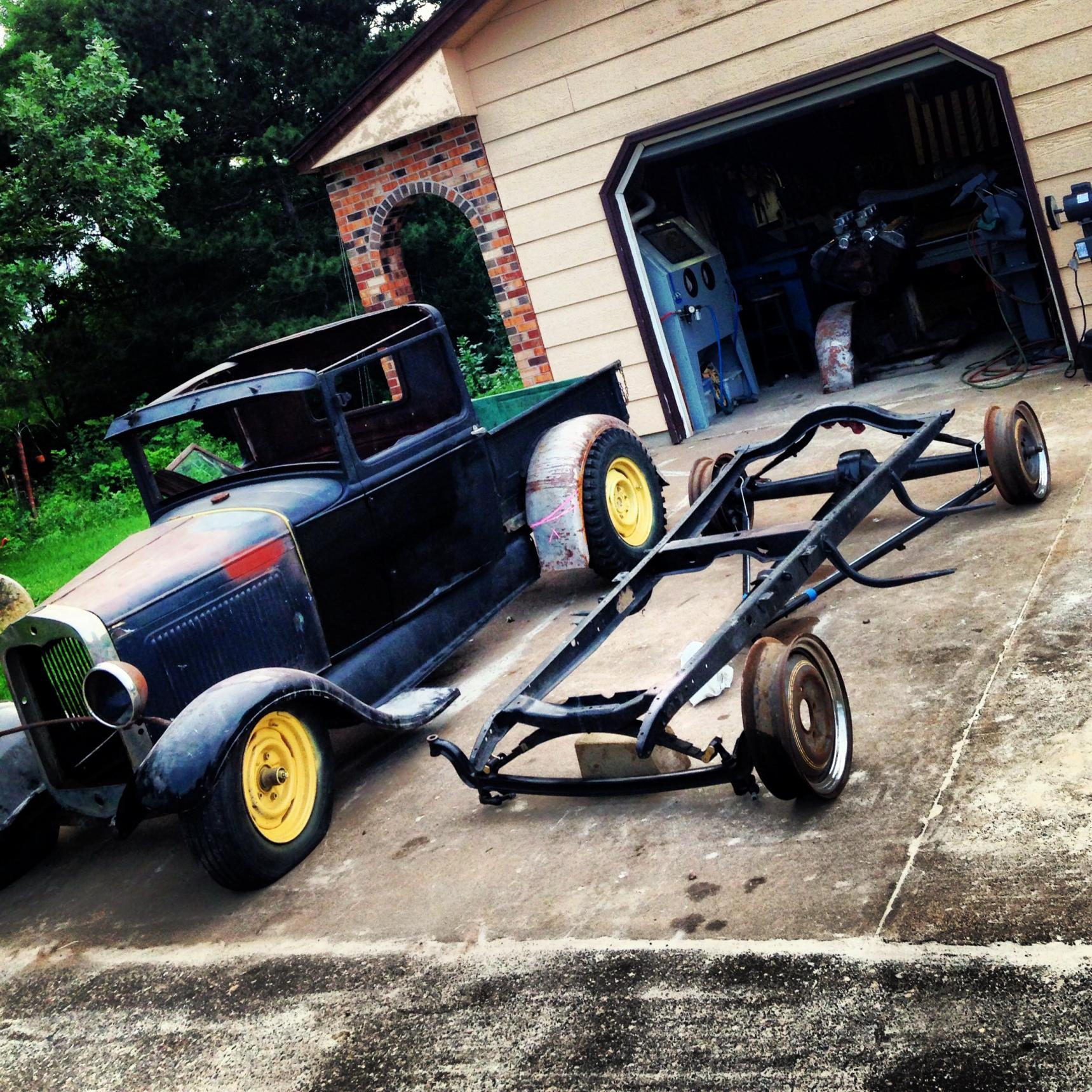

    I wanted to keep this build as simple as possible-
    Idea being you change one thing you end up changing two others... so I was trying to keep this A frame basic- like how tardel would build an AV8 in that traditional hot rod book-
    I had to come up with some sort of cross member but didnt know what-
    I ended up buying an extra x member at a swap early on in the summer for my roadster... and was thinking... if I cut it in half I could make two K members out of it...
    So thats what I did...

    The X member is much wider then the A frame so I made some boxing plates that dropped down for the split A bones-

    Back outside to do a mockup... made a front motor mount and bolted the engine in-
    Its in the perfect spot- need to alter the firewall to a flat one.. but other than that... fit like a glove.
    front motor mount attaches to the crossmember in the center- im almost finished ill post pics when its completed.
