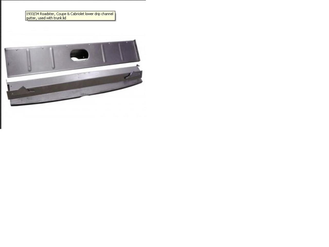

you need a couple of pieces available through a couple of vendors but Steve's Auto Restoration comes to mind
the 2 end pieces connect w/the side rain gutters(shown laying on the bottom panel in the image below). The piece attaches between the floor and the upper inner edge of the outer panel. It covers up the inner panel. Not used w/rumble seat
