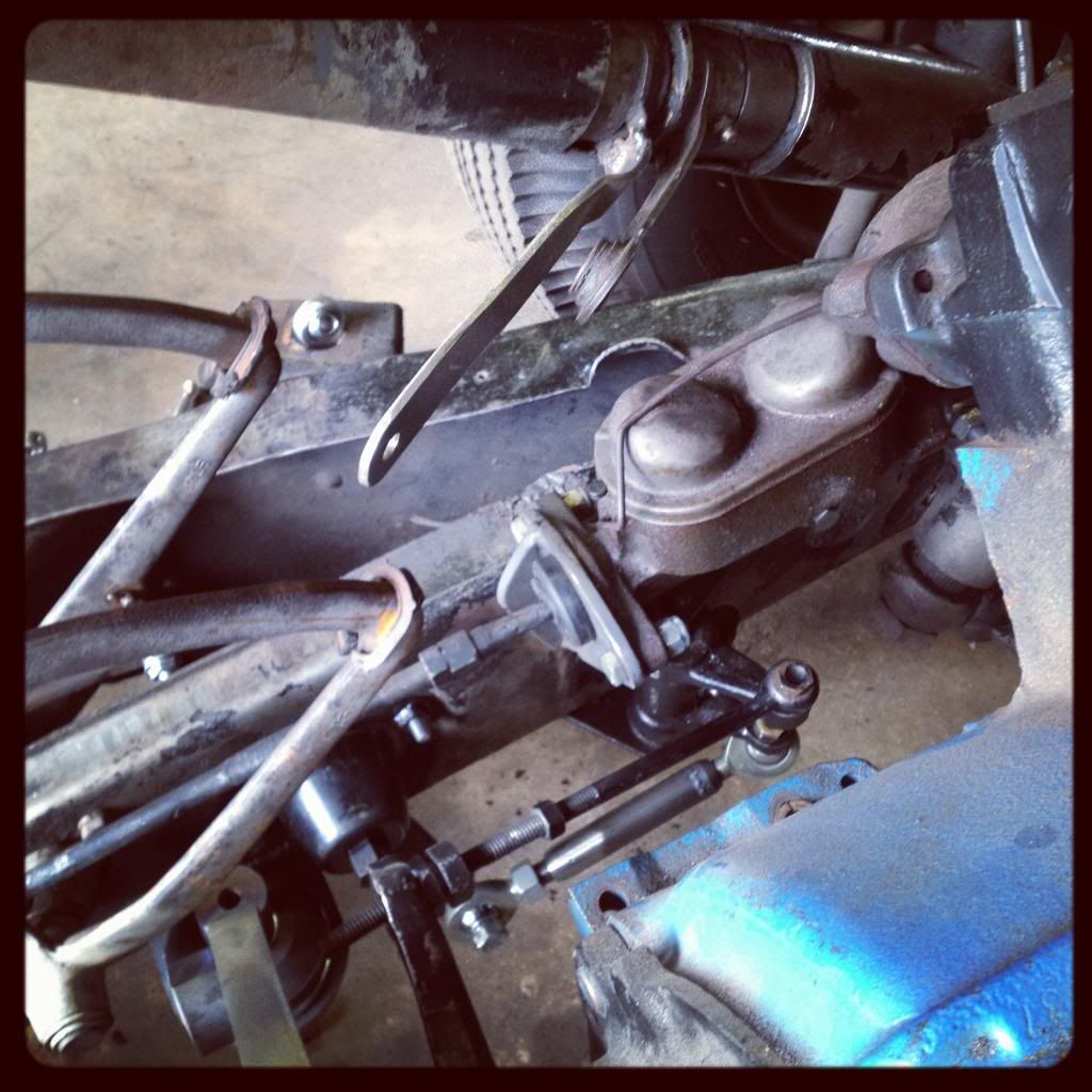

    THIS is what a simple engine swap turned into.
    i had gone round and round with what engine i wanted to put in my merc, but in the end the 331 cadillac and 3 speed lasalle was the combo of choice
    LOTS MORE TO COME!
    the engine was worked and built by my club brother shawn Mull....this little mofo will be plenty roudy!
    once the engine and trans were mounted another club brother
    hotdamn (delton) and myself proceded to do a notch in the rear of the frame. after the notch was done (sorry i lost the progress pics)
    i moved the leaf springs to the inside of the frame rails to get the ride hight where i wanted it.
    I used a 50 olds bell housing to mate my lasalle to the back of the cad mill so i could bolt on mid mounts

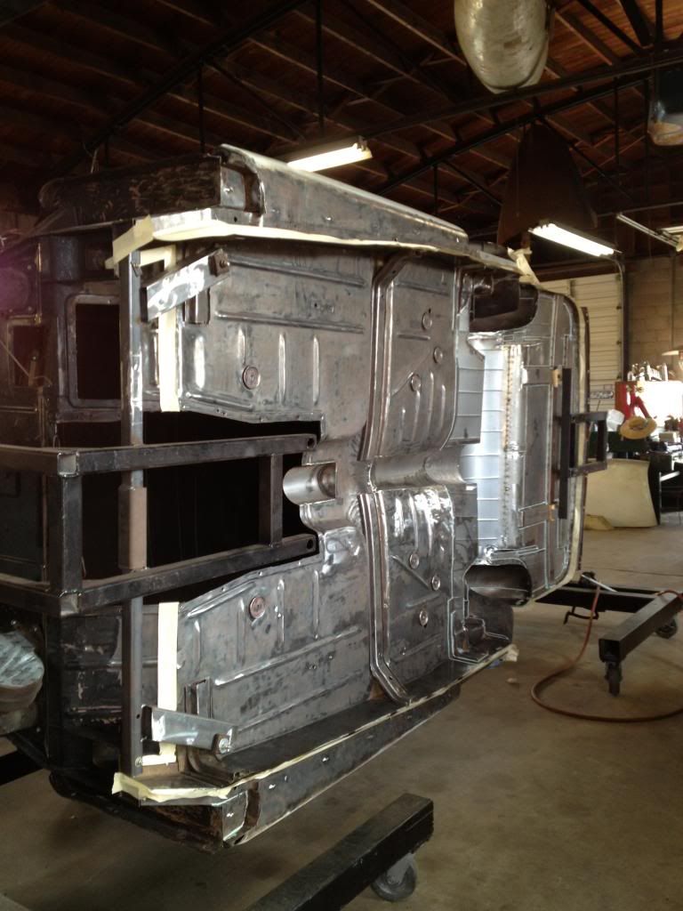

    with the frame painted and the floors finished up the under side of the body was next on the list.
    so hotdamn and I put a weekend into getting the floors preped for seam sealer, etch, and undercoating.
    with all that work out of the way it was prime time to starting going back together.
    again with the help from hotdamn and the guys in the club, body was united with frame once more.
    more to come... CHOP CHOP
