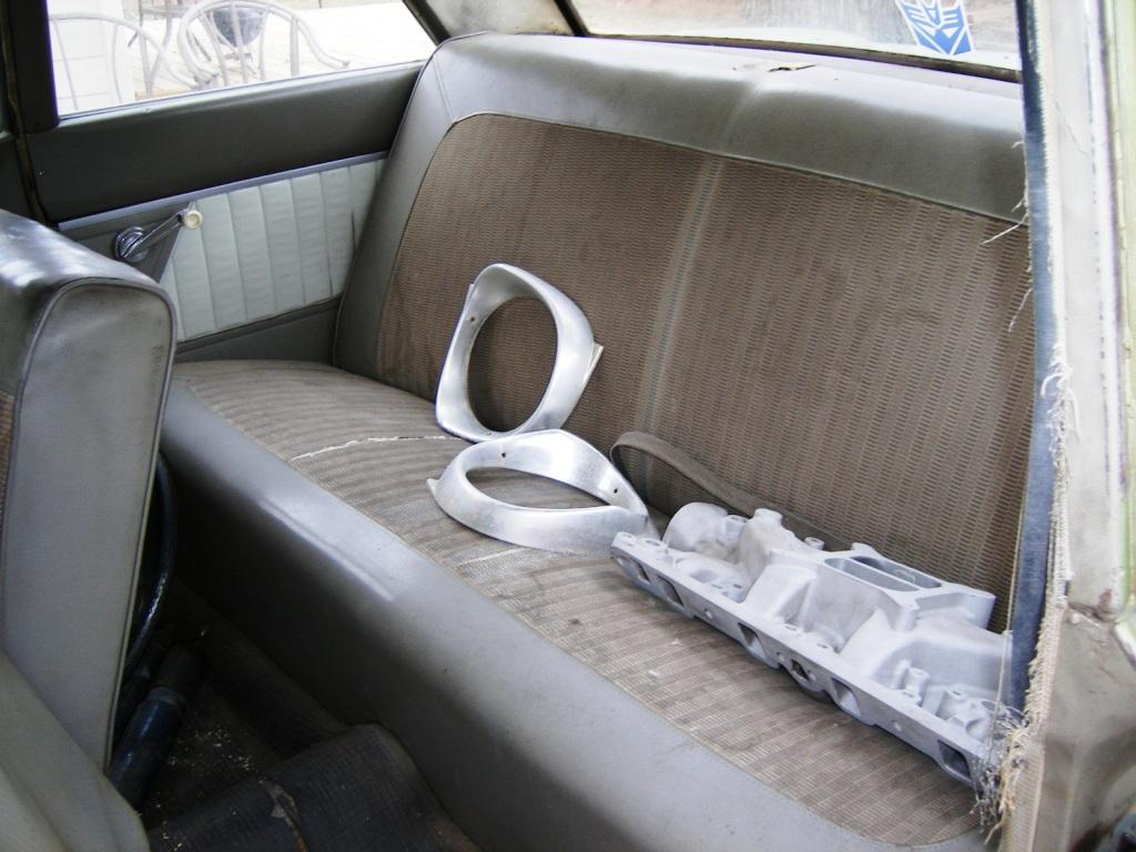

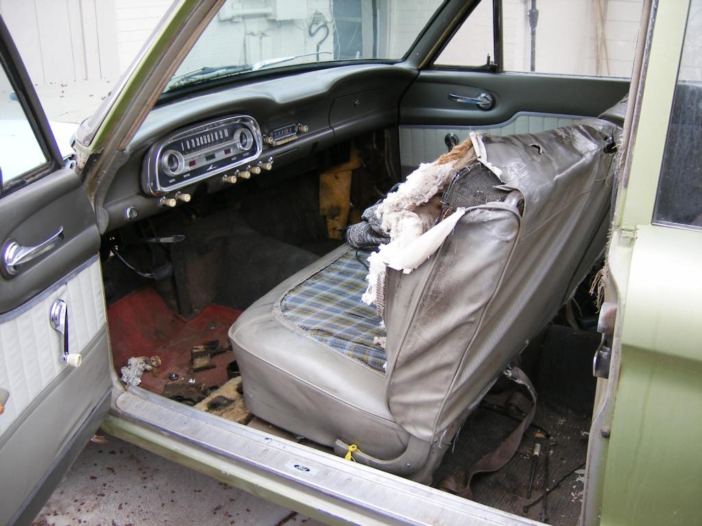

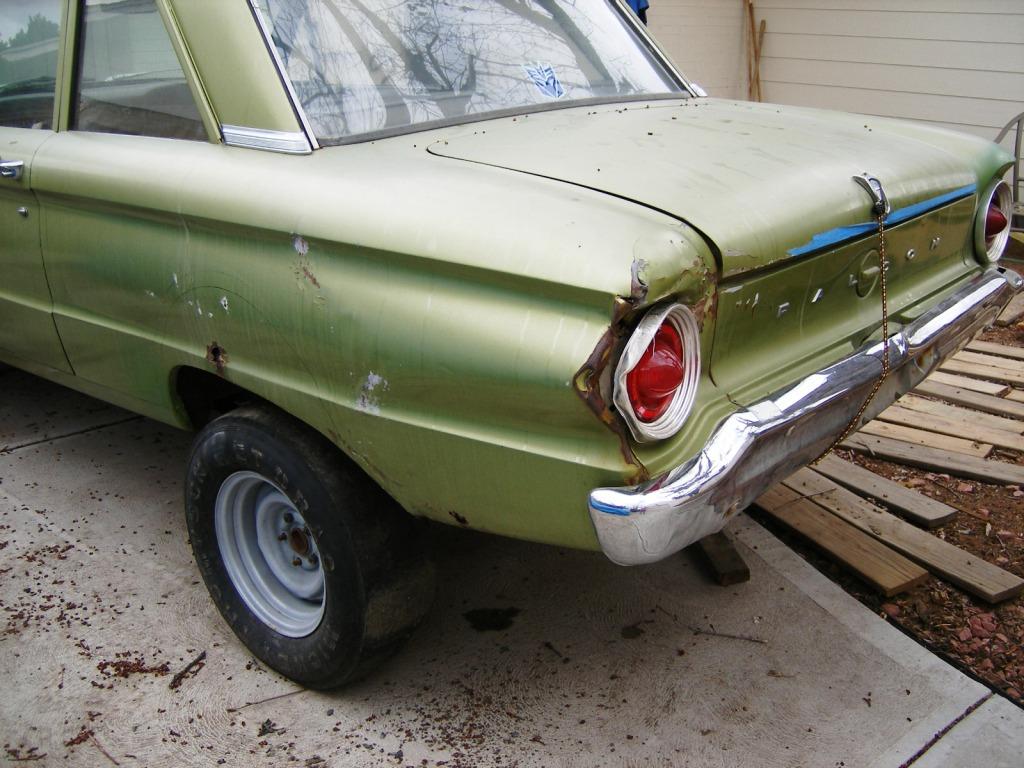

    I started with this gasser project I bought years ago. It was a perfect find as the straight six and 3 speed had already been removed and the purchase price included a complete front clip from a 62 wagon and some other body parts. As it has turned out, I really only used about 40% of what you see here. There was extensive rust over the rear wheels and a the car had been tagged in the left rear. The floorboards were solid however (in the end that didn't matter).

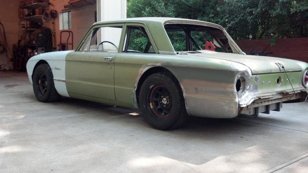

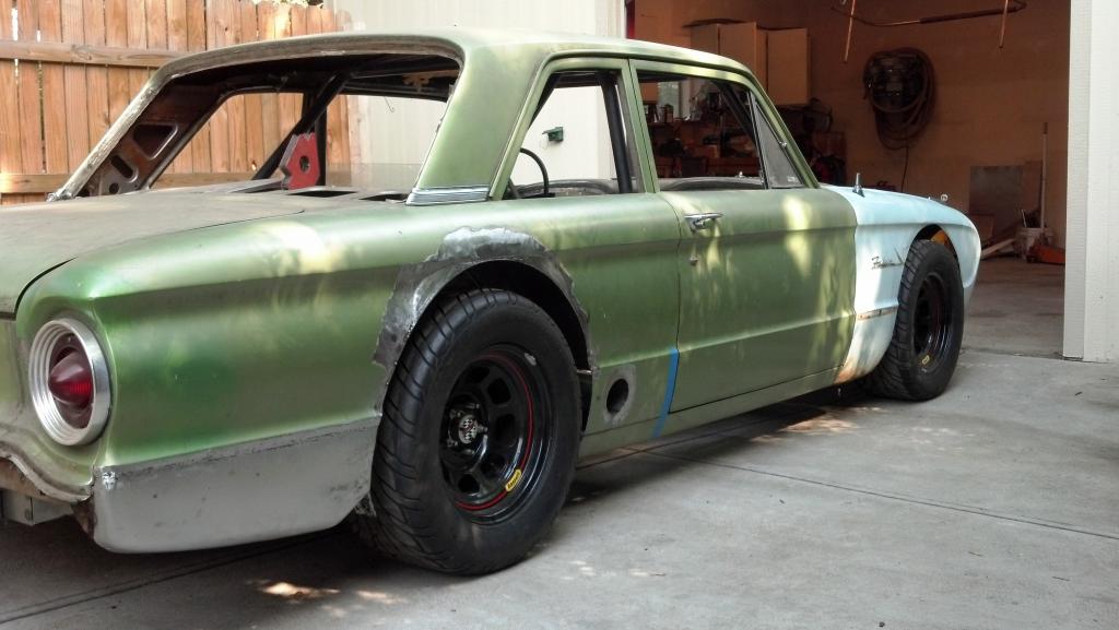

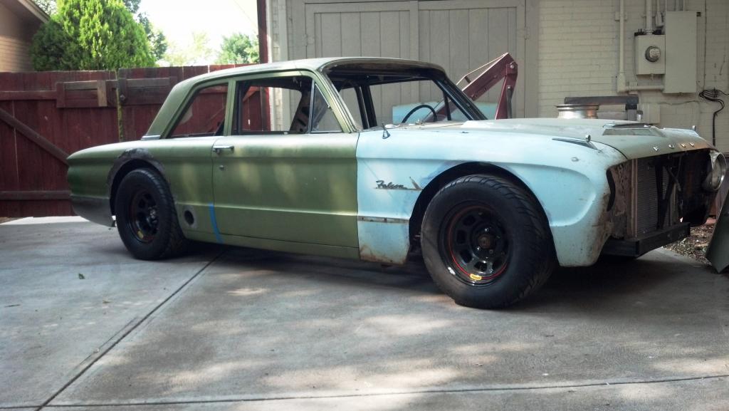

    Cutting to the chase, this is what the car looks like as of now. These photos were taken quite a while ago but all work that has been done since then is really under the skin so the appearance really hasn't changed.

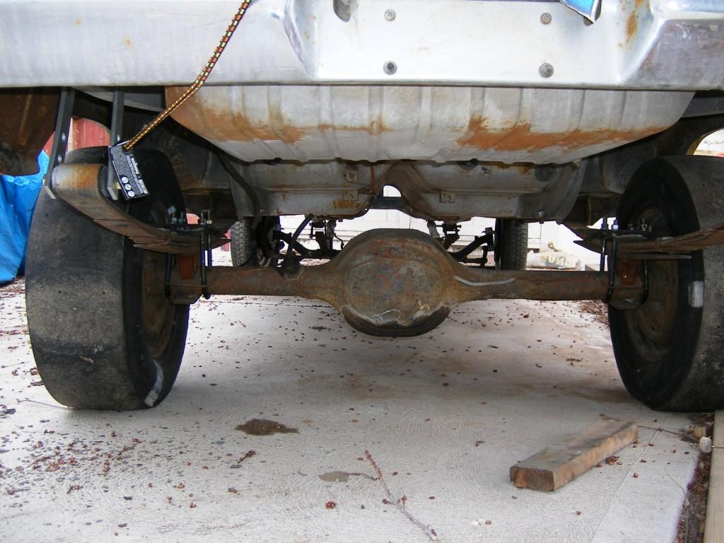

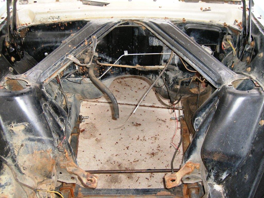

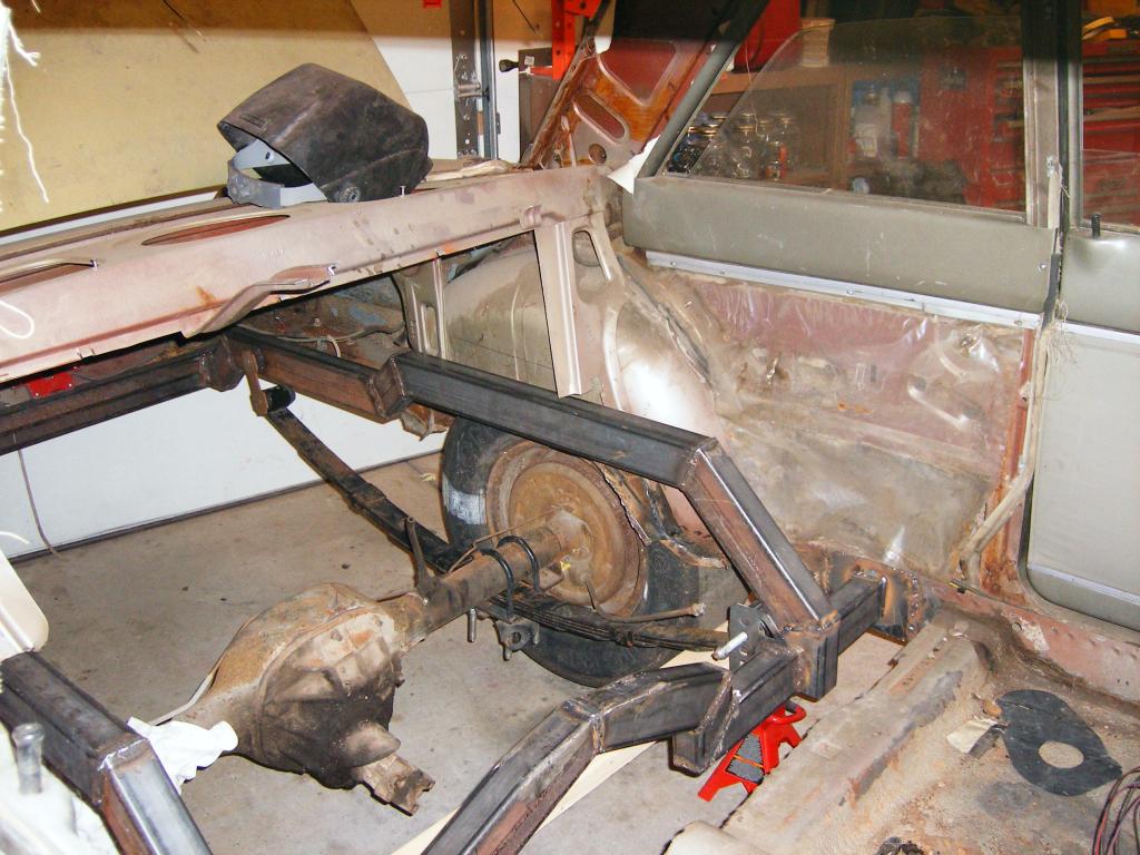

    I started by cutting out the shock towers and installing a Pro Motorsports Mustang II front suspension with adjustable coilovers. I also installed lowering leaf springs in the back. This gave me a 3 inch drop. After cutting the fender wells and and adding the wheels and tires I wanted, it was clear to me that it needed to be lower. I figured lowering a full six inches would be ideal. Going lower than three inches would not be possible within the constraints of the exising unibody so I decided to build a tube frame. First, out came the floor.

    I started with the front of the frame first. I had to cut out the Mustang II crossmember I had just welded onto the stock chassis. The cross member became the reference point for the rest of the frame. This is the beginning of the frame. Note that this frame was only going to be as straight as my garage floor was flat.

    I didn't take a lot of pictures as I was building the frame but the following show the rear part. Later, the rear cross member you see here was removed and I went with a different design. Aside from not having enough clearance for the driveshaft, it was just plain clunky.

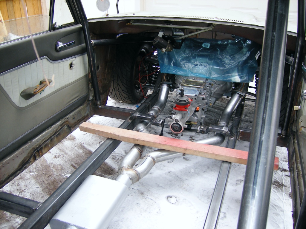

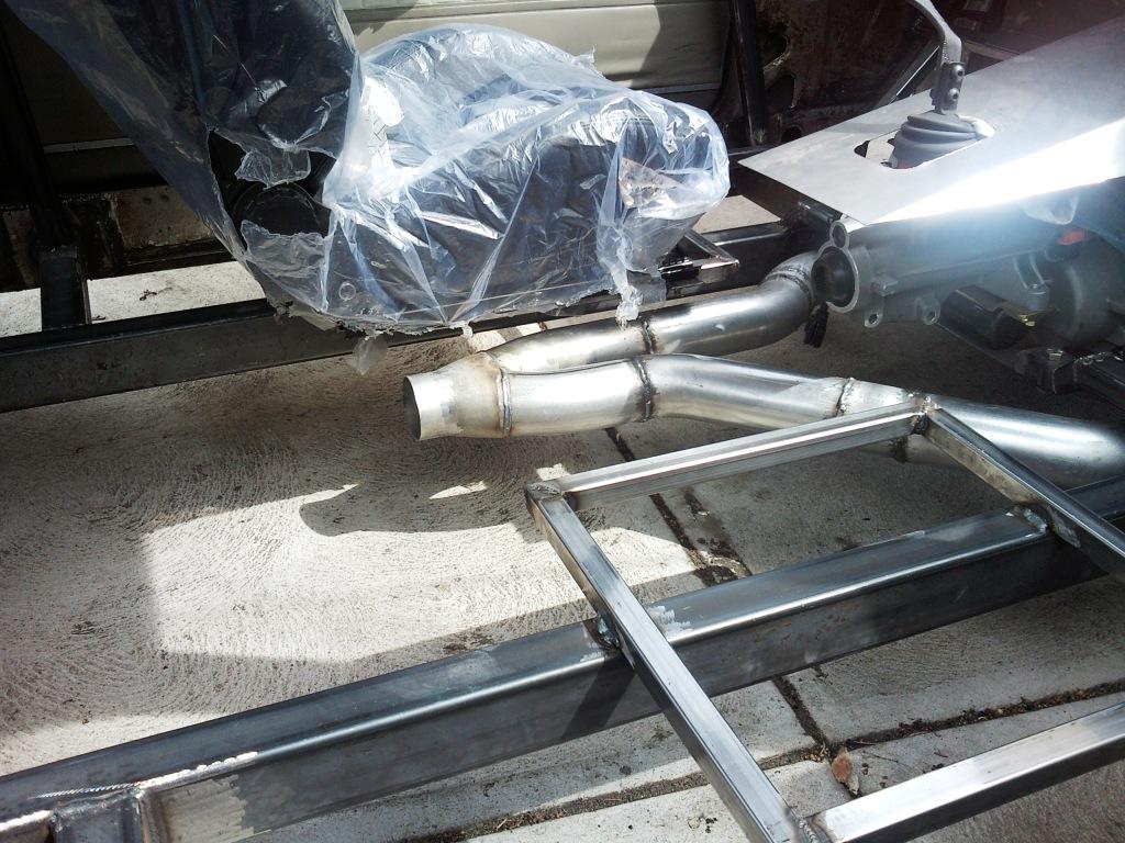

    One thing that was an absolute must was a single side-dump exhaust through the right rear quarter panel. The first picture shows the front part of the exhaust and the second picture shows the exit. I didn't get a picture of the middle part which is unfortunate as that is where all the "fun" was. From the muffler behind the driver's seat I routed the exhaust up over the driveshaft, added a resonator, and snaked the tubing through the right side of the frame. The tubing is three inches in diameter. the side exit in the photo is a short section of 4 inch tubing inside of which, and recessed back a few inches is the the end of the three inch exhaust tube.

    Nash510- all of this just brings back nightmare of build exhaust , I used a NASCAR 1" x11" x 36" boom tube flush with bottom of rocker panel, I don't want to do it again, I feel for you, it is not that easy , packing it all in there ! Keep goin it will get done

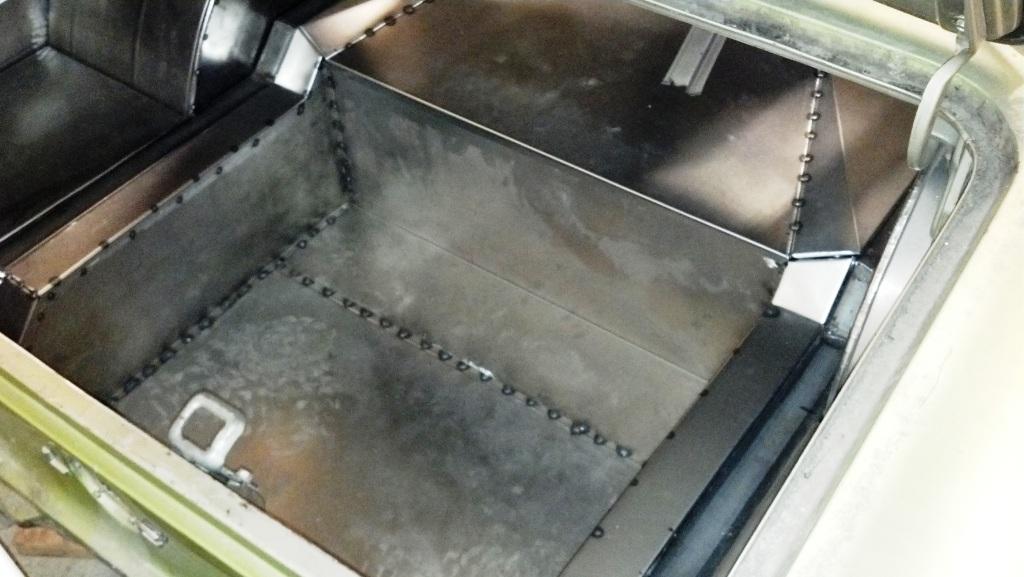

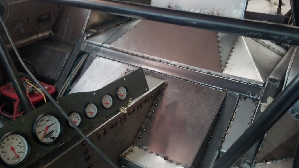

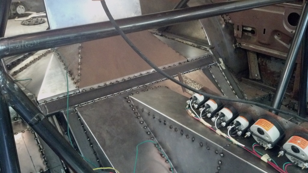

    Funny you should mention the tin work. I think your description of havoc is appropriate. I had to work within the contraints of the frame I made and my crappy little sheet metal brake which can't seem to handle anything longer than about 24 inches. Therefore I was forced to make my floor little piece by little piece. Each section fits within the frame so that the top of the frame becomes part of the floor itself. One thing I learned was that triangles are your friends.
    The first picture shows the seat frames. The rest of the photos are of various sections of the floor.
