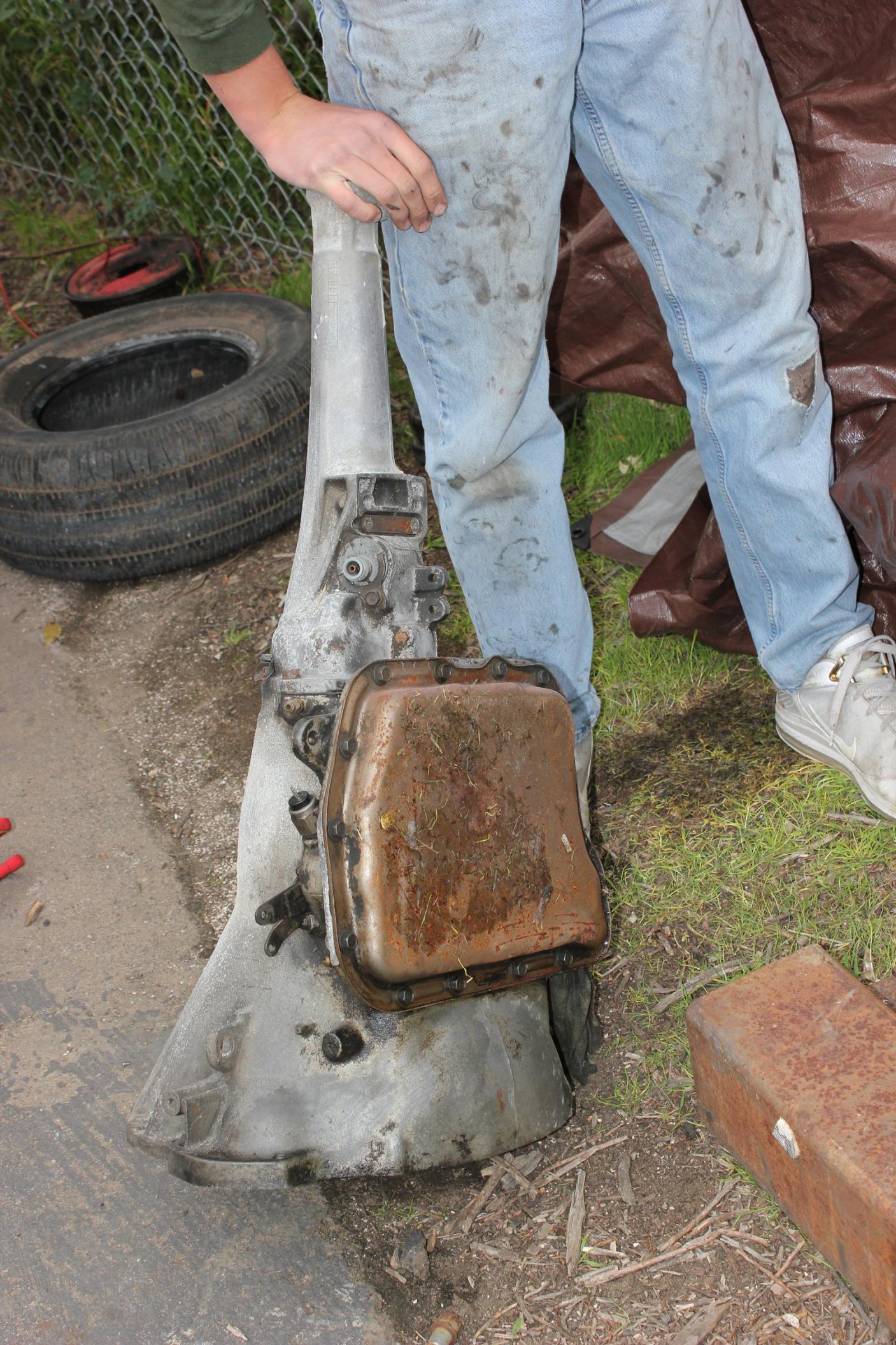

  8. I was told the transmission needed a rebuild when i got it. This is what it looked like.

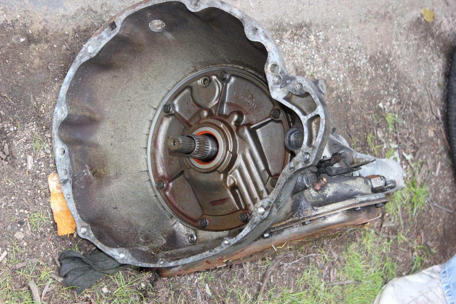

  9. After teardown
