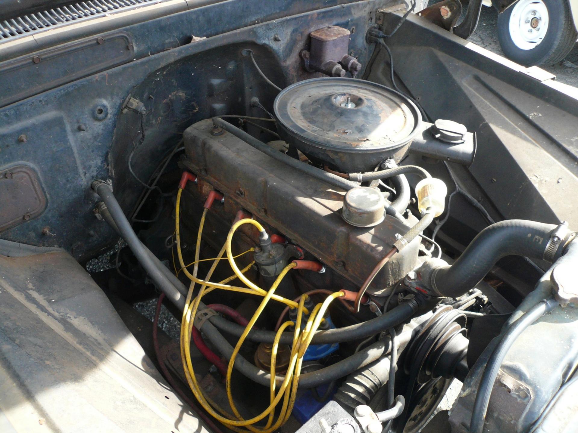

    She still has the stock 4spd, but the engine was swapped out for a 250 six. Anyone know if the sbc will bolt right up, or am I going to have to change things around to fit it in there.
  4. belair
    Joined: Jul 10, 2006
    Posts: 9,015
    belair
    It will fit.
  5. If it is a truck 4 speed you will likely only need a bellhousing. She is 51 this year? [born in '62] Likely the 6 cylinder bell won't match up. Not to dispair those old truck bellhousings are plentiful.
    The ol' mare looks like she was rode hard and put up wet, if her spirit aint broke she'll make you a good ride. She already knows how to take a beating. ;)
    Ok you're posting answers faster than I can ask questions. The 250 shares a bell with the V-8.

    At some point in life the 235 was swapped out for the 250. If the planets line up right, the 250 will fire and get her running down the road again. Then it will be time to decide if the 283 goes in or something else.

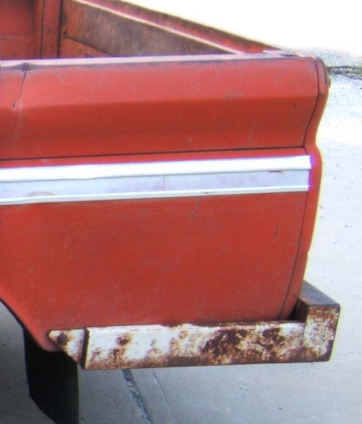

  9. Chassis should be the same from step side to slab side. it make have to do with the actual width and how it relates to the body itself.
    There is a kind of a deal on those old trucks that a lot of people donot recognize when they put a step bumper on them the outer sides of the bumper were bolted to the body. Let me see if I have a decnt pic of what I am talking about.
    Anyway the hitch may mount up in the same fashion.
    Found one here is a slab side with a step bumper. Really comon for the '60s.
    Does what I am saying make any sense? They may want to tie the hitch in the same way.

    I really don't like those bumpers like P&B posted. They will tweek the quarters a lot worse and easier than a regular bumper.
