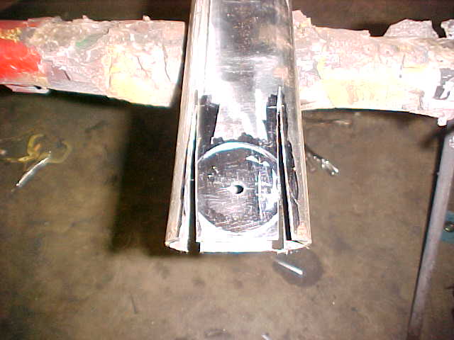

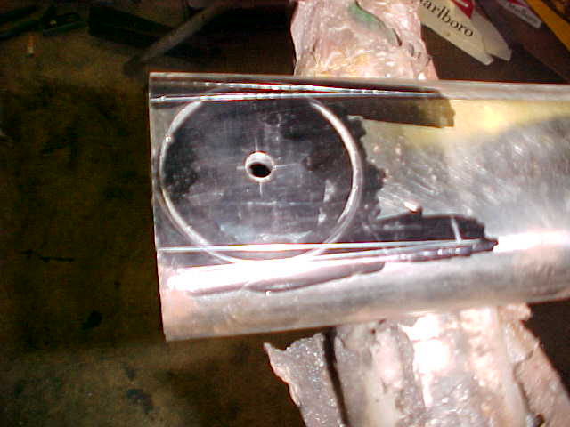

    start by cutting the old end off i used my band saw and just cut deep enough to go threw the wish bone.
    next i mark the center hole where the bushing will go, center punch it and head to the drill press.

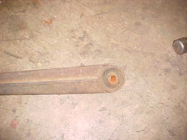

    grab what ever you are getting your bushing from and remove it and cut out the sleave if it has one.

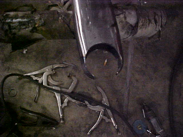

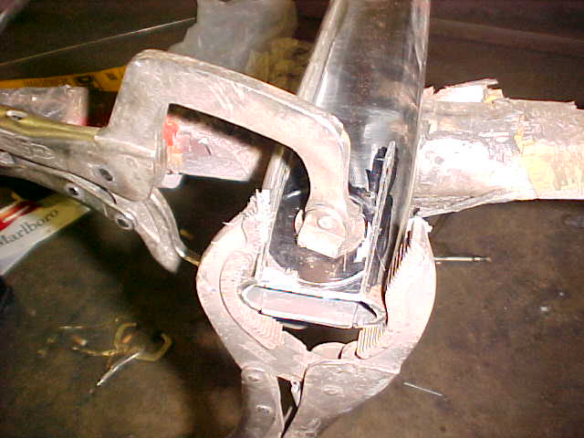

    the bones where too large at the end and i wanted them to wrap around the bushing sleave.
    i laid out the od of the sleave and marked out where i wanted the taper to begin.
    i used a thin cut off wheel to make the cuts . clamped it together also squeazing them together so the radius line up nice. bevel for welds and weld together only up to the part where the sleave will go. welds are a little tuff on the whole saw.

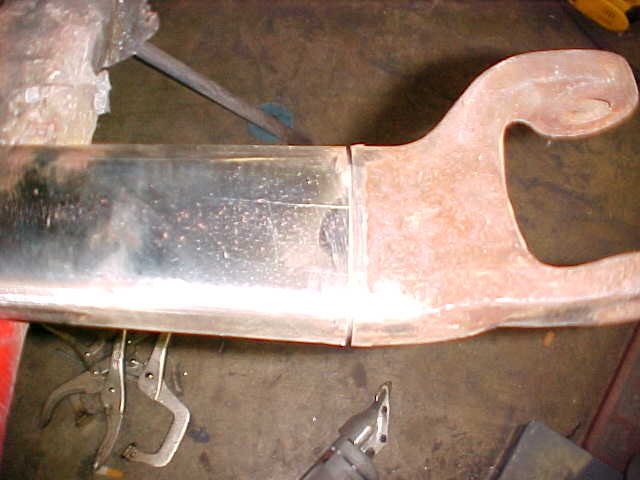

    take over to drill press and using a hole saw cut the holes for the sleave
    grind the tips down to a nice taper. I had to end mine short or they would hit the control arm.
    i found a nice solid rod to beat the crap out of the ends to get the shape i wanted.
    fit the sleave and center it.

    the bushings came out of a jaguar rear control arm. They are kind of soft for a regular rear set up. new they are under $30 new from the dealer.
