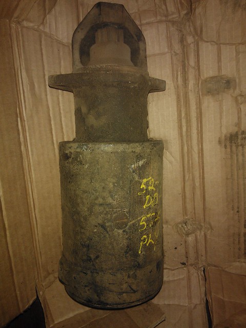

    However, HURRAH! I found a compatible starter motor in Kingsbury, California. Thats currently being shipped to me. As soon as I've got it, I'll turn her over and post a vid. In the meantime I've been assessing the rot and rust while having a closer look at the engine and running gear. These pics show the floor pan after I pulled the seats out:

    So some of you may be aware that I had purchased a 1953 Plymouth Starter that would be compatible with the flathead engine in my 1930 Chrysler. I waited weeks for it to arrive from California and had every intention of bringing the car back to life. Well it didn't go my way today.
    I took the starter, placed it in the bellhousing mounting and... it didn't marry up! It appears that the body of the starter is too wide to sit in and sit flush with the engine block...
    At first thought I had something wrong but I'm not sure that I do. The engine is definately a 1953 Plymouth 218 (block number p24) and the starter is definately the corresponding one for the engine.
    So I've scratched my head, spoken at length with my Dad about it and rung various friends to ask for points of view.
    Here's what I've cobbled together in my brain: There are two components at play, the engine and the bellhousing. I now think that the bellhousing is actually the original 1930 Chrysler CJ bellhouse. The reason I think this is that the original 1930 Chrysler engine was lacking a water jacket on the side of the starter motor therefore allowing tolerance to fit a starter closer to the block on the bell house mountings, see pic of 1930 Chrysler Block below:

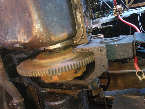

    My block below and starter placement:
    I toyed with grinding the side off the starter to make it fit but I now realise that it would probably foul the electromagnetic properties of the starter.
    Here's where i need the advice, should I now chop out the bellhousing, and fabricate my own so that the starter will mount correctly? Any other ideas, most welcome.

    In looking again, would the starter gear work even if it fit? It seems the flywheel is near the middle of your hole but the starter would need to be mounted out further? I can't really see.
    Maybe make a wooden piece the shape of your starter nose and see where it would need to sit & work back from there. There are some auto trans and various newer manual trans swaps people have worked out so maybe try to find those & see about starter measurements.

    You won't find a starter to fit that combo of parts. Looks like the flywheel that was on the later engine stuffed in the old bell. The ring gear is out past the center of the starter hole, where the starter shaft should be. You need a smaller flywheel.

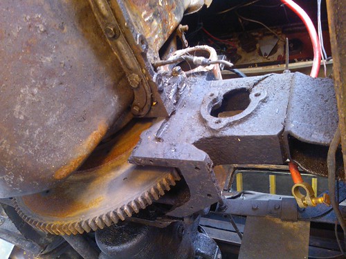

  30. Over the weekend had a brief look at the car and asked a few questions on p15-d24 forum. Not really able to make any progress presently but the learning curve is pretty good.
    The problem remains: Starter and Bellhouse... its almost getting boring :p
    From the picture below you'll see that the bellhouse is not fabricated in the modern sense. The original 1930 bellhouse includes an integrated master cylinder mount as well as the mount to the chassis. This means that the location for mounting the starter has well and truly stitched me up.
    And from below:
    Just replacing the bellhouse with one from a 53 Plymouth (to match the engine) is not a straight forward job because of the frame mounts. I would have to fabricate the mounts myself, though not impossible, not ideal.
    The suggestion is that I find a 1939-1947 truck bellhouse as these would have the required frame mounts and be somewhere near compatible. The width between the frame mounts is 600mm. So if anyone has a spare one please PM me?

    For a little more clarity you can see how close the starter is to the block below:
