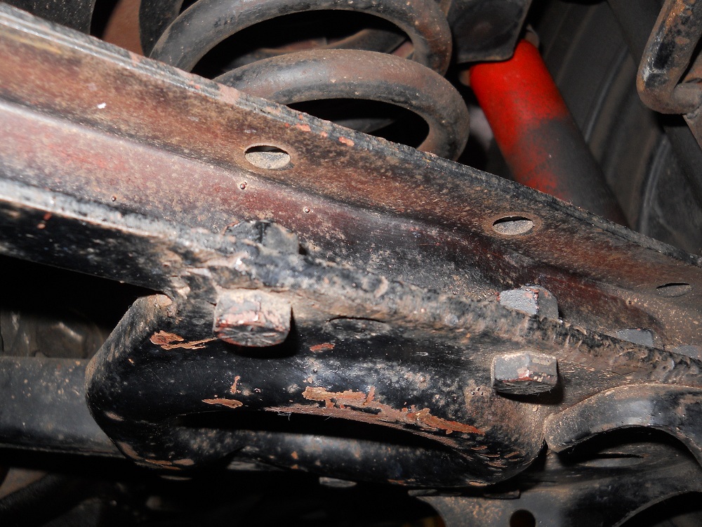

    I was greasing the pink car today and realized I have not seen this tip on here.I did this in 1990,so I must have gotten it out of one of the old Tex Smith books. Can you see what I did here? Mopar A arms are rivited together. Stock the plate that the coil spring sits on is on top of the A-arm. I ground off the 6 rivits that held the plate on. then using the holes forthe rivits as a guide, drilled 6 new holes. Taking the plate from the top and then bolted and the I welded the plate to the bottom. DONE. The mount for the sway bar I think just swapped side for side with the sway bar. I got a 3 1/2 drop out of this--but a great ride.What it did to the coil spring waslike the opposite of cutting one. Instead of a choppy this old car floats like a boat.

    I've thought about doing this with my '53 Desoto. I can't believe you netted 3.5" from doing this, thats insane. Next question... Did you do it all on the car? or did you remove the piece?

    Took the A arms off---easier--only way probably

    Good and easy , got me thinking. It would be real easy to return to original ride height if you ever wanted to.

    Posts: 4,631

    Escaped Amarillo, yes----I left for the last time--A friend drove the pink car for 350 miles--said it floated down the road
