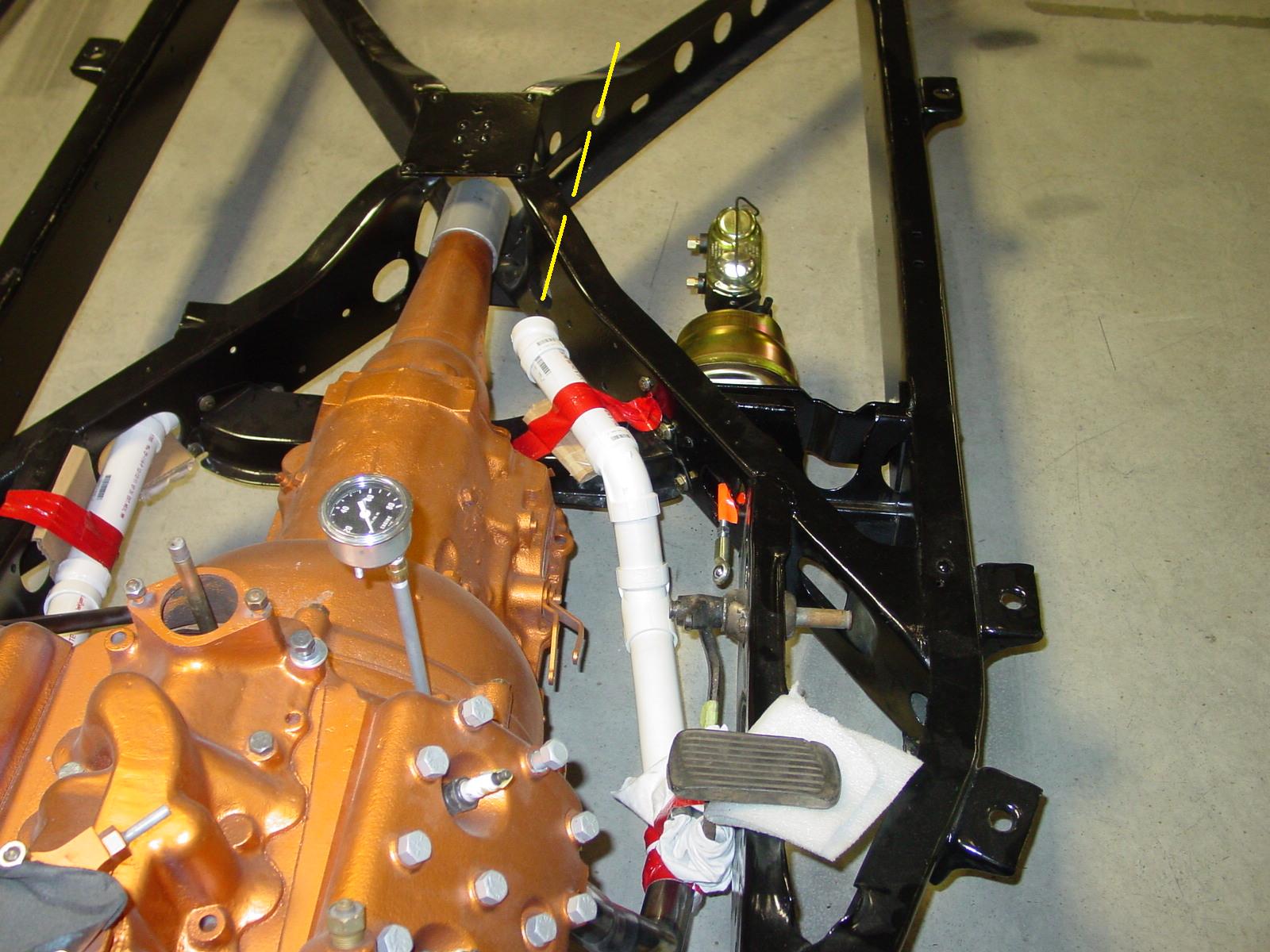

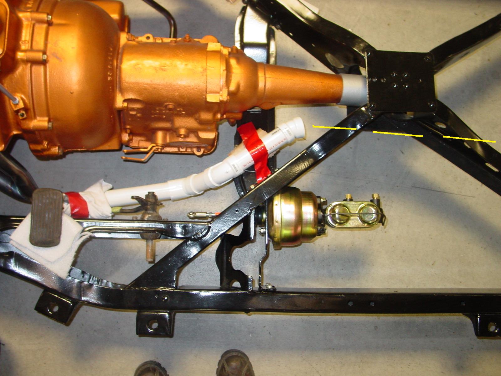

    I'm fabricating an exhaust for my 1951 Mercury. It has a Flathead with Red's Headers and a Mercomatic transmission. Mufflers are 12" Brockman Mellowtones just forward of the axle. Would anyone with more exhaust knowledge than I care to offer their opinion and/or suggestions for the routing on the drivers side? You'll see it's pretty tight. I've upgraded and relocated the master cylinder, which limits where I can pass through the X portion of the frame. Exhaust routing would continue where yellow lines are. Is this routing too close to the transmission and/or master cylinder, or would I be better off going under the frame?

    If the car isn't too low I have always gone under the frame at front then thru the x-member in the back before going over the axel. If you use a connection at the header you will have a point to disconnect to pull the trans crossmember out. Nice looking work. Keep it up!

    IMO, you have plenty of room. I ran my exhaust between my trans and m/c on my 39, it is a lot closer to both of these than yours will be. I don't see where you will have any problem.
    Compared to my car, you have a freaking mile.

    From a structural stand point you look good to cut thru the frame "X" there, I would just recommend you keep the new hole opening as small as possible.
    A good rule of thumb for clearances regarding heat transferrence is -
    * Non-Coated pipes - 1.00 inch, Ceramic Coated pipe - 0.50 *.
    Always try to plan for more space, but when things get tight I have found this is a good rule to follow.
    Can you add in a "bolted flange section" so that the piece you need to ceramic coat could be saller then the entire pipe, say just enough to get by your issue area ?
    You could then have that section ceramic coated inside and out which would allow you to get closer or just provide you with a little less worry(=stress=high blood pressure=??).

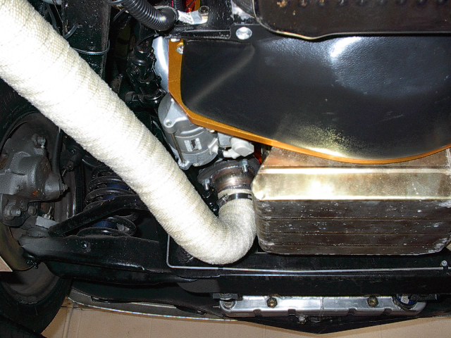

    While mine is not a 51 merc I wrapped my 40 ford pipes with exhaust wrap at the pipes from the headers back to the H section no issues the past 7 years. My pipes are stainless steel also. I added some pics I also exited at the front of the rear wheels.

    Well for one I think your exhaust you have there is gonna melt .......;)Your clearance should be fine. Those damn master kits are right where the exhaust should route through the frame. You can run on the outside of frame but it can get real tricky by the rear leafs routing around them unless you have the rear linked. I did that on the last Merc and just had it dump out by the tire to avoid the issue.. On another I shoved the master to the side and made a swing set for the brake linkage to jive...
  14. I ran my 50 Merc exhaust under the frame because I am running the same MC kit you have. If I had it to do again I would take the route you have now. I do not like seeing my exhaust pipes peaking out in every side view picture of my car. Another tip is you should run a skid plate over the master cylinder as it tends to hit the ground easy.
