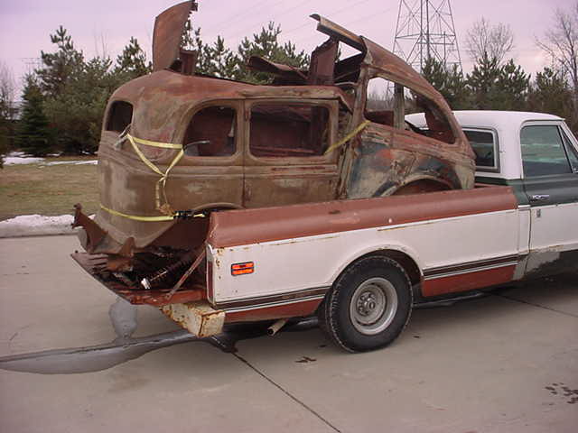

    There I was... already knee deep in half completed projects when my ace homey JeffreyJames sent me a pm stating he had a rough 34 4dr body, frame, and a pile of parts for sale... after a few anxious days waiting for pics he got the answer: I'll take it. I'm such a sucker for these "back from the grave" type projects and I've wanted to build a hammered 5w for a while now... so my good buddy Jrblack30 and I saddled up over thanksgiving weekend and hauled balls down to NC and back in 36 hrs... just enough time to drive down, load up, grab some munchies with my iron lords pals, and boogie on back home. I immediately shoved everything else aside and tore into the project. Gonna be a no frills cheap and simple build to drive to bonneville 2012... yes I am actually going this year!:D

    My first surprise came when I lifted the body off the frame for the first time... why in the hell is this thing so HEAVY? oh, maybe it's the .125" thick plate they used to fill the roof!!
    or the 14 ga patch panels...
