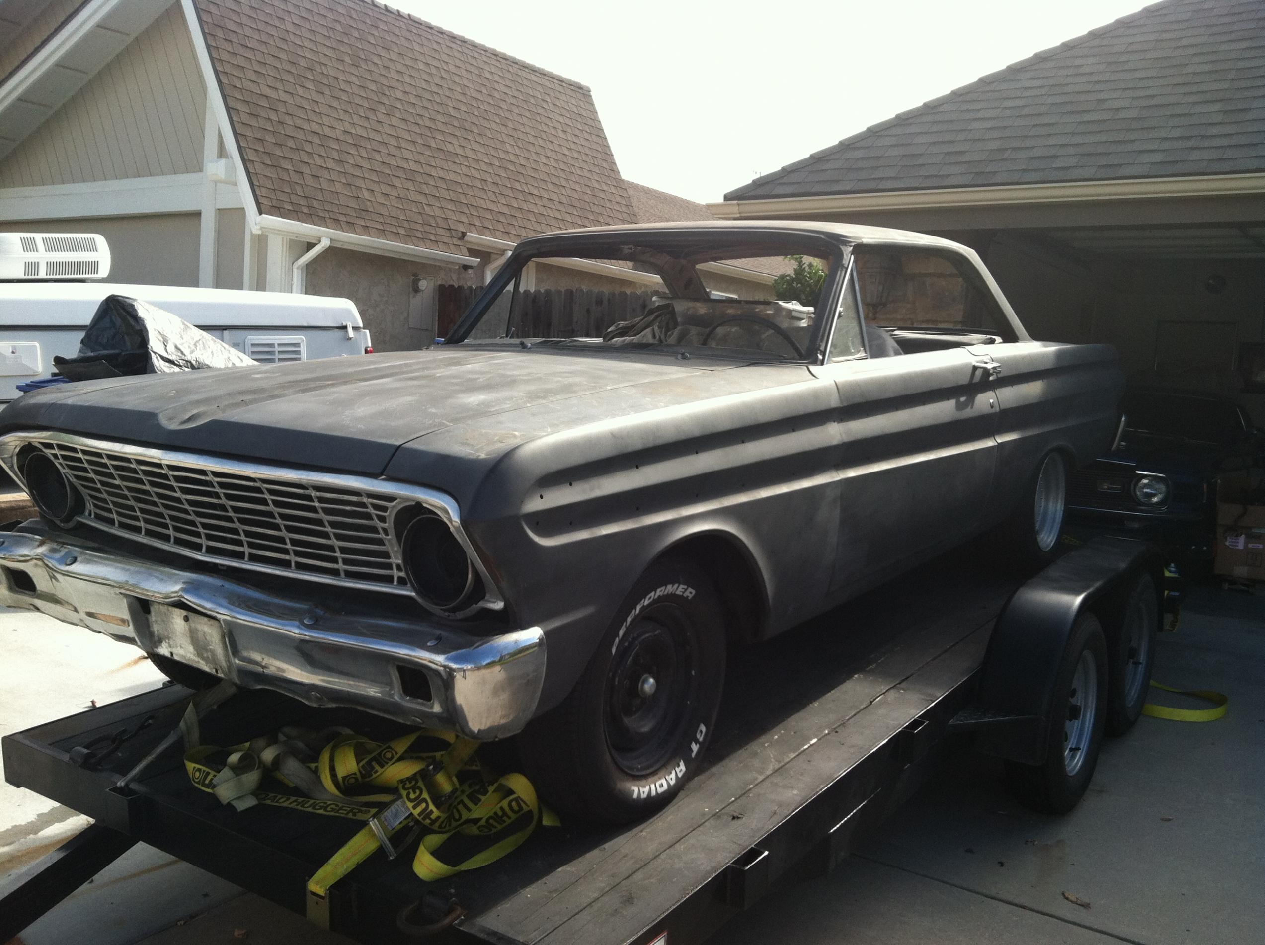

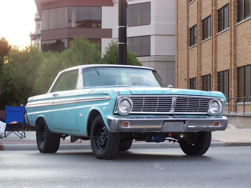

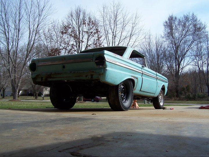

  1. I have been doing a lot of research, prior to starting this build. I don't need my car to be a 100% show car/ wanna be racecar, but I want a nice looking car that is period correct and runs decent. If i could get close to "the rocket" 64 comet or Roy's "65 comet" I would be super happy(fellow hambers and cars I saw at this years "Hot Rod Renion" in Bakersfield.) Thank you Fast Eddy for tire size recommendation.
    I am starting with a 1964 Falcon Futura. It currently has a 289, metal 4 speed hump, bucket seats, console, all the trim in the trunk and no rust or body issues. It is a stong running 289/c4/ 8" rear combo, I picked up for $1800, so I am starting off with a good platform car/ money wise.

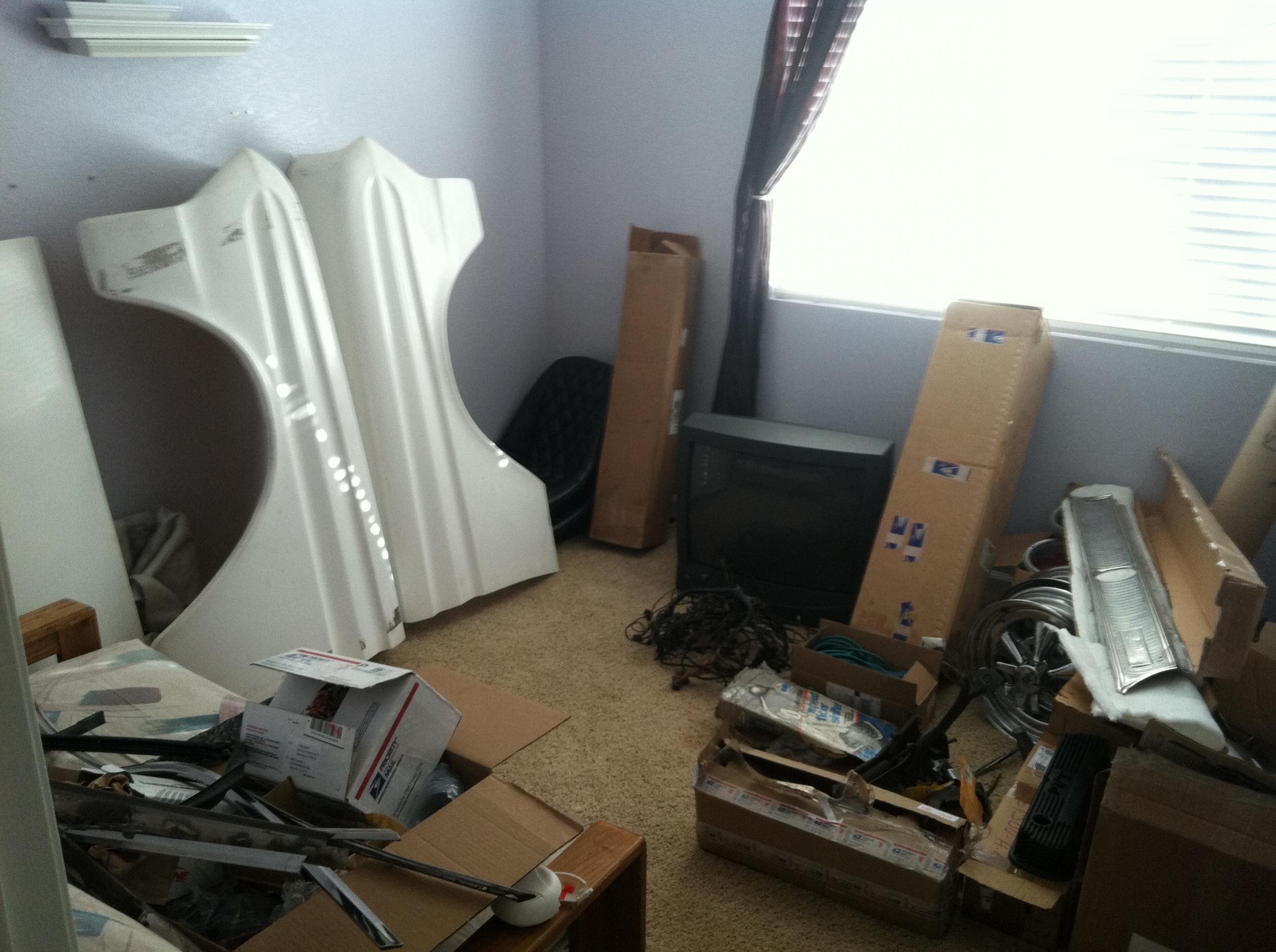

    Parts I have collected so far:

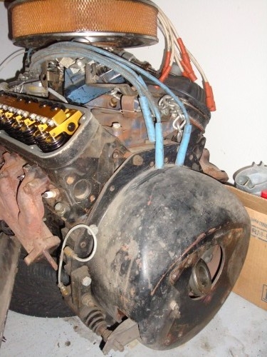

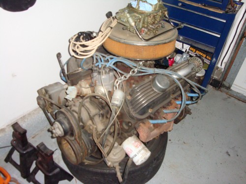

    I have a 69 tunnel port boss 302 engine with 351w heads with a blowproof bellhousing, correct narrow bolt pattern falcon toploader and 9 inch rear end ready to go in the car.
    Other cragar ss rims for the front, fiberglass fenders, front bumper and trunk lid (craigslist find), dodge a100 seats, Hurst pie-crust cheater slicks. (refer to picture of parts room).

    I thought anything tunnel port 302 related stuff came out in '68... How about some more info on that '69 302 block???

  7. Dueces this is what I found out about the block it has a good back story I will post a little later. The casting numbers are C8FE-6105-B date code 3A9 it does decode to a 69 boss engine. But withe c8 number you are right

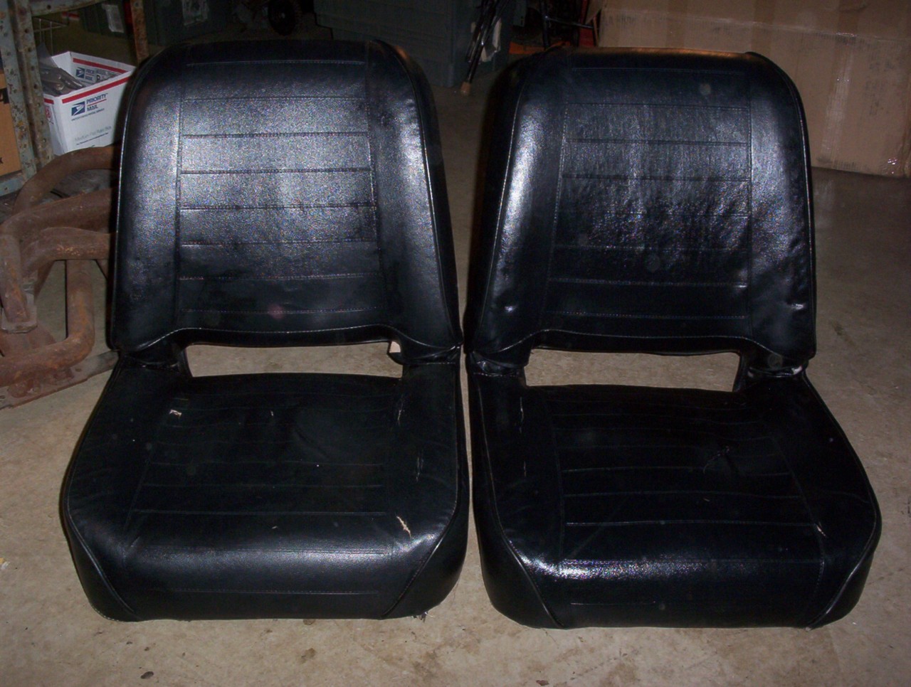

    OJ- The seats are Dodge A100 seats, the same as the Thunderbolt, I attached a photograph of Mickey Thompsons Original Thunderbolt which had both front seats (A100), as well as a rear seat. This is a different class though than b/fx, where other modifications were aloud.

    As far as the engine, I saw a local craigslist ad that adviertised a "4 bolt main for engine with scattershield for $600". I made the couple hour trip and met the owner, Bob Parsons. Bob is was a circle track racer in the 70's and 80's who ran a 69 fastback mustang bodied car with a boss 302 engine. I included a picture of the car, i will attach a better one later. Bob said he sold the car and put the engine in another modified type car, but with less than one race on the engine, the car was wrecked and the motor pulled. THe motor sat in his garage on a pallet ever since, until I came along. I have all the receipts for the engine build and a lot of money was put into the thing. I attached a couple pictures of the engine as well.
