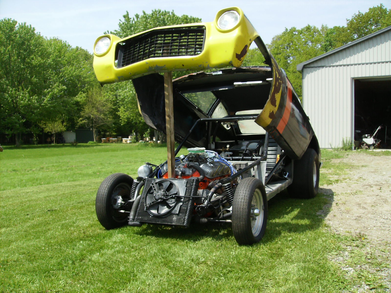

    This past weekend..Candy-man and I went to see some good friends and enjoy the day with these guys we don't get to see very much(distance)
    We met these guys thru the local Drag racing scene and there history spans decades.
    Anyhow.Paul Dunbar is re-building a drag car(resurrecting and re-storing) the old Rydell,Hope and Lang Vega.
    (Yes, the car is O/T,but I am more interested in the driveline for this place.)
    The car is an original that never ever saw the street and was a home grown flip top.
    What is very interesting is the Chevy six with the V/8 spliced Chevy head.
    I never heard of such a thing, nor saw one.These guys apparently were the first to do so.
    By cutting a V/8 small block head in half and welding them back together..it fits on a chevy 292 six.
    the original head was off a unknown late sixtys car... but this head is a race head(aluminum) and welded together.The bores are the same.
    Pretty neat info and would be wicked in a hotrod or custom.In this application.. the set up is injected and on alcohol.Stock rods,stock crank, and (forgive me) a piston of which I cannot remember the details.
    This car will just be an exhibition deal as Paul is building it as therapy for an illness he is battling.
    Anyhow... Wes(James Boys) grabbed some shots of a great Saturday and it was a super day!Many thanks Wes for the pics!!
    Many thanks to Paul and Sandra Dunbar,Jim and Wes McClelland and of course..Mr. Chevy...K.S.

    The spliced V-8 head swap on inline 6's was banned from certain NHRA classes about 35 years ago because they were winning all the races.
  7. Candy-Man
    Joined: Mar 21, 2006
    Posts: 1,715
    Candy-Man
    You are correct... Mr. Santucci actually wrote about this Chevy Six (which Jeff has posted above) in his book !
    The first time out for this six, using now very very rare and expensive Corvette heads, which would be worth a ton of $ now, ran over one second faster than the record in H/G at the time....
    What you do not see in the pic's is the custom side covers (below the V8 Crower Injectors also cut in half) are angled, for the push rods exitting the lifter bores, on a slight angle, to enter the V8 head... The front and rear cylinders were cut and re-welded together much like the valve cover.....

    I was just in Wes Rydells shop on Friday and saw the aluminum head they built for the 6. It was on a shelf above a photo of the car. Is this the head you are referring to?

    I could be wrong but I think Rydell, Hope & Lang had this same setup in an Anglia before the Vega. I went to Indy to watch and theres the V8 chevy head on their car and the Cleveland V8 head on the Preperation H 300 ford 6 Maverick along with a $1000+ worth of Weber side draft carbs. At the time I had a 300 ford 6 powered Anglia and I remember thinking that I just got priced right out of the 6 cylinder classes. There was no way I could afford what was rumered to be a $3500 head
  16. 6inarow
    Joined: Jan 24, 2007
    Posts: 2,363
    6inarow
    Yep - that's the head I saw at Rydell's. the picture was of an Anglia. I asked Doug Peterson about it and he told me it was a pair of aluminum Corvette heads that the got directly from Chevrolet through the dealership. they chopped them apart and welded them together. Had what looked to be a Hilborn set up on it too. They cut and welded a pair of aluminum corvette valve covers for the head too.
    Must have run OK - the picture of the Anglia had its wheels off the ground a long way!!

    The original head on the six was a cast iron head, arc welded, from what I have been told.

    The Chevy six was originally in the Anglia, then the Vega....
    It ran both Crower and Hilborn Injection....

    I thought that the cylinder head I saw was aluminum and Doug told me that was the one they made for the car in the picture. He also told me the trouble with that particular head is that the compression was so high that they were worried it would knock all the seats out of it. He never said if it was a problem or not - just that that head was not run on the strip as much as they would have hoped.
    Maybe I was mistaken - maybe it was iron but I could have sworn thats what he said.
    Custom aluminum valve cover too. Saw that with my own 2 eyes

    You are correct, the one you saw was aluminum, however; the ORIGINAL head was cast iron from what I have been told....
