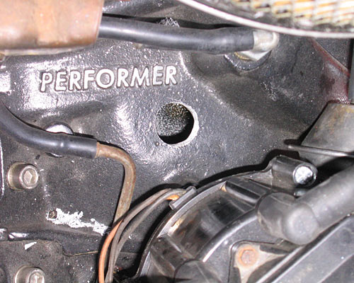

  2. Okay, next you drill a hole. If you actually do this, study this hole placement carefully because the very middle of this flat area is where you want to drill. The curved down area on the driver's side is a runner, and you don't want to drill in to that!
    Get a shop vac and turn it on to suck up the aluminum shavings while you're drilling. I would be hesitant to do this with a steel (or iron or whatever stock is) manifold because if you lose any shavings in the valley they can do a lot of damage. But this manifold is aluminum, and aluminum, as we all know, is mainly made out of beer cans, and since I can crush a beer can on my head, I figure the shavings are soft enough for the engine to grind up if some tiny shavings fall in there. Fortunately, none did. There is a small ridge that needed a little grinding on the underside so that the grommet would seat well.

  7. If you're not carefull, you will drill right into the plenum, but I didn't. Optimally, I would have done this with the manifold off so I could see what was under my drill, but I figured that if I drilled into the runners, then I had a good excuse to ditch this swap meet special and buy a manifold with a breather/oilfill in the front like I want. :)
    For you see, I have these really bichin' Cal Custom rocker covers that I can't bear to drill holes in. They have super cool Moon Engine Compartment Oilers (or "breathers" as they are sometimes called) on them, so I decided to put the PCV valve in the valley by the dizzy. Can anyone find that great PCV tech post from a couple weeks ago? After reading that, I thought that this would be a good location.

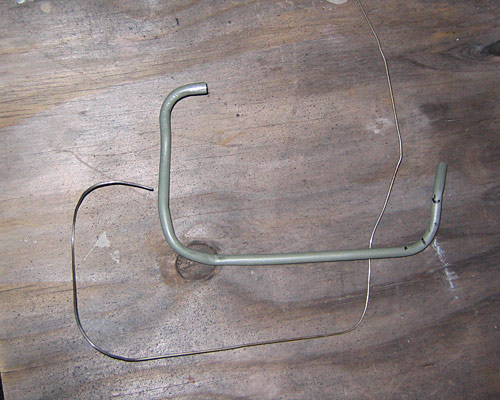

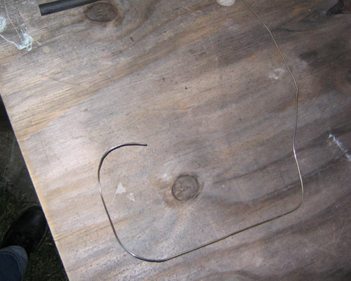

    Okay, so next step: Secure a Malleable Tubing Plotter (Speedway PN# 1313-666, or I sell them for $17.95) and come up with the routing to get your crancase gas up to the front of your carb. Try coming up with some idea that will look totally OEM. Make sure to include impossible bends that you can't possibly make right with a cheap tubing bender.

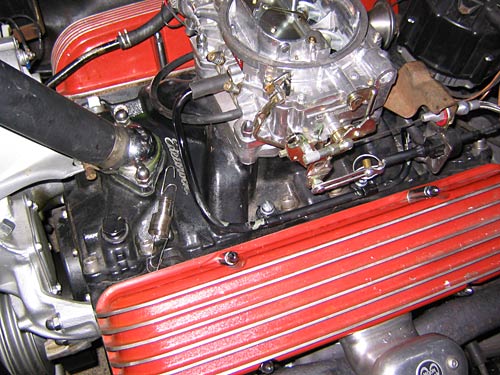

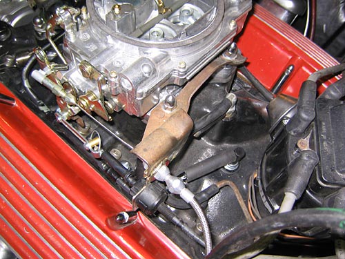

  10. I had to take a utility knife and cut another 1/16th of an inch out of the groove in the grommet so it was wide enough to accomodate the manifold. Then I put it all together... but I didn't let the paint dry enough on my tube so I'll have to redo that part. But overall I think it looks fairly clean.
    Oh, yeah, and it runs great. I was running really rich, and was going to re-jet, but I figured I ought to do this first. It leaned out the mix.
