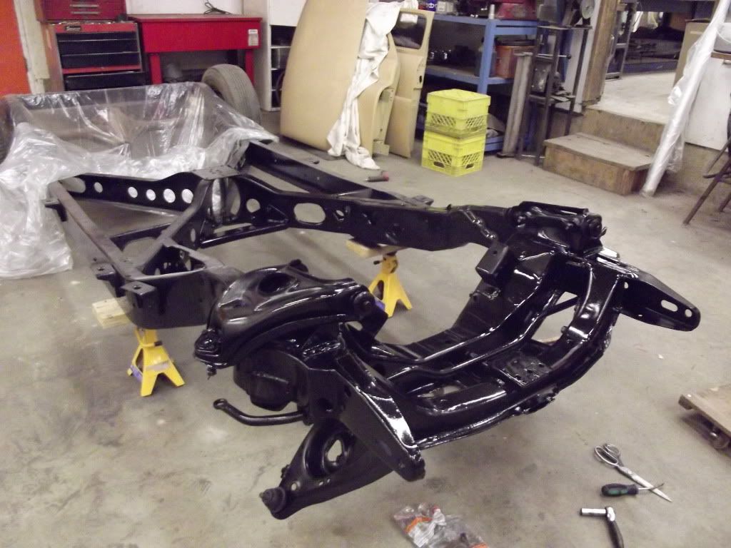

    some more pics , sandblasted, epoxied top coated frame

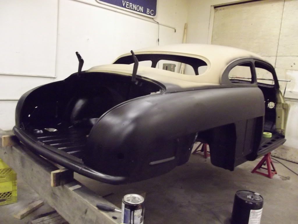

    body is back on frame
    had to make headers, I showed some of these pics arround already, but thought I would do an orderly expose'
    I redrilled the rotors to 5on5 and will install a 57 merc 9" which is the right width and will also have the 5on5 pattern so I can run 52 caddy rims and sombreros
    fitting more tin

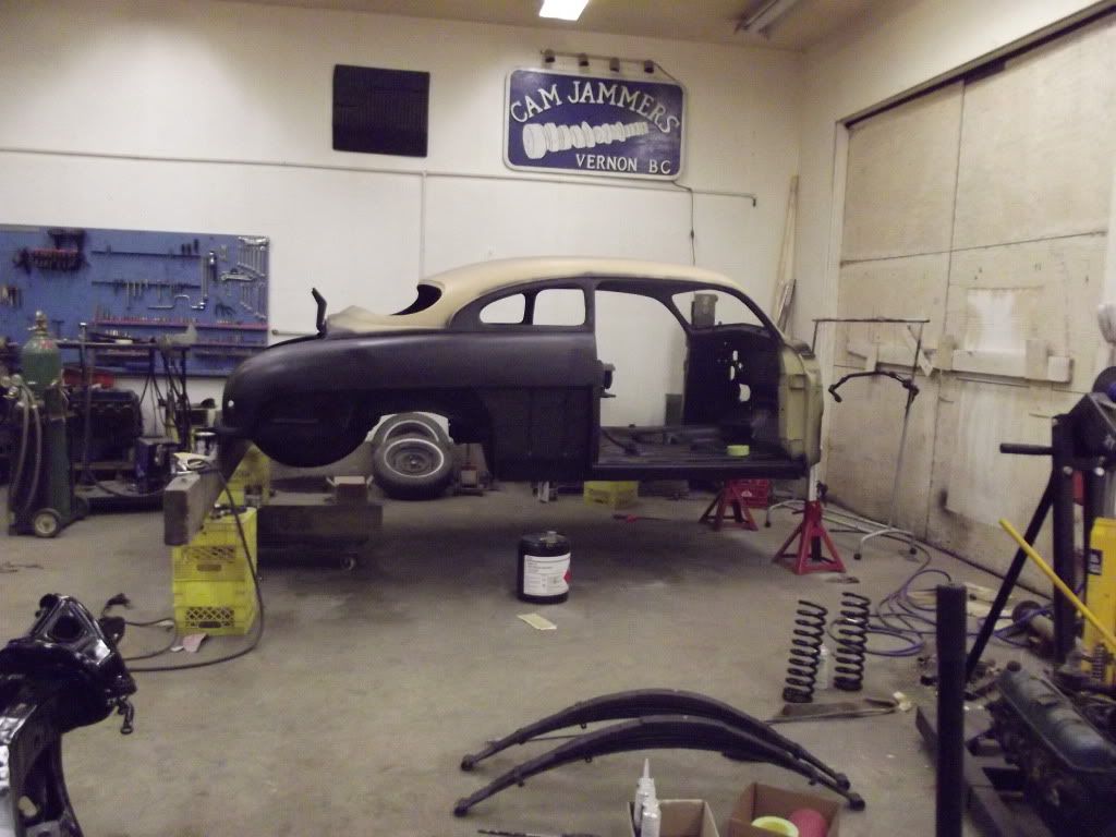

    worked on putting the engine, trans and shifter in place.

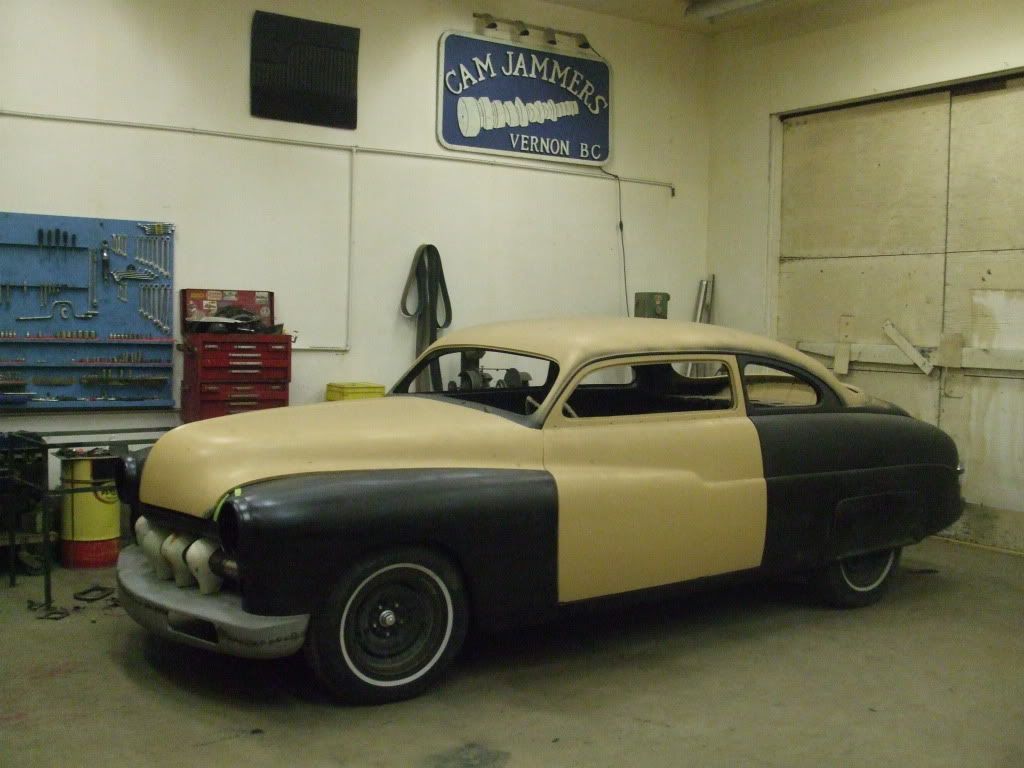

    it,s coming together, got the brakes and handbrakes done, 57 merc rear end installed, sheet metal going for a dry fit, front and rear pan just about done, steering column sorted out, working on the grill.Wiring fuel tank and fuel lines just about sorted out.

  28. Suggestion....If you are gonna keep the stock taillights,lower them. It looks much better.
    Love that nailhead!!!!! They have TONS of torque!!!
  29. desotot
    Joined: Jan 29, 2008
    Posts: 2,036
    desotot
    yer grandmother wears army boots,,, ok ok you are right so I lowered them,, any body ever tell you should have chopped your car a little more?
